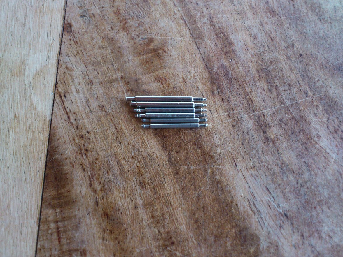

    Last evening I wanted to change strap on my Omega Seamaster 2892, but I couldn't get the bars to budge, and not wanting to gouge the lugs, I left it for today. Another try went unsuccesful, and I got serious and brought out my Proxxon mini drill. Having sawn (caaaaaarefully!!) through the first, it dawned on me why they were so difficult to operate:
    The correct springbars I had ready are at the bottom... ::facepalm2::
    Taking into consideration that I have removed a milimeter or two, these are enormously oversized! How the seller even managed to get them to fit is anyone's guess. They are probably suited for a 20-22mm strap!

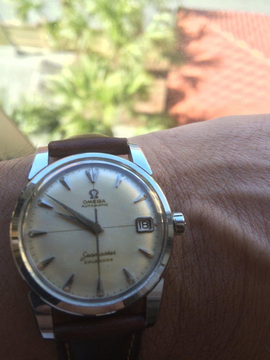

    On the other end of the spectrum are the next specimens. I recently sold my Seamaster Calendar 2849 (now residing with @Schmedsc in the US) and the strap I had used almost exclusively was a Hadley Roma which had aqcuired a lovely, deep brown patina from use. My favourite strap for one of my best watches, a really great match.
    However, when I wanted to put the strap on my Tissot Chrono the day before yesterday, I couldn't! It just wouldn't sit firmly between the lugs. I grabbed some new spring bars, and the problem disappeared... In the next photo, they are at the bottom, and the 18mm are in the middle:

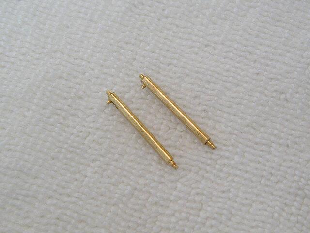

    Oh, you have it easy...

    They look wicked. Haven't come across anything like that yet...
    These are the first I've had to cut out, and it was only because of the siz; it wasn't possible for me to compress the spring enough to remove it from the lug holes. Did hold my breath as I lowered the buzzing saw disc down on the watch!

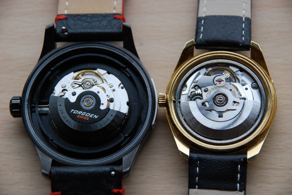

    Look at your Torgoen a little closer then.:whistling:

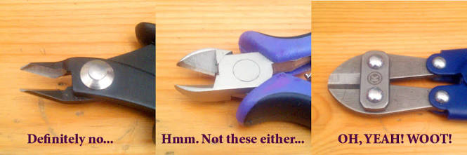

    No way I'd have the balls for that. Time to break out some small bolt-cutters?
