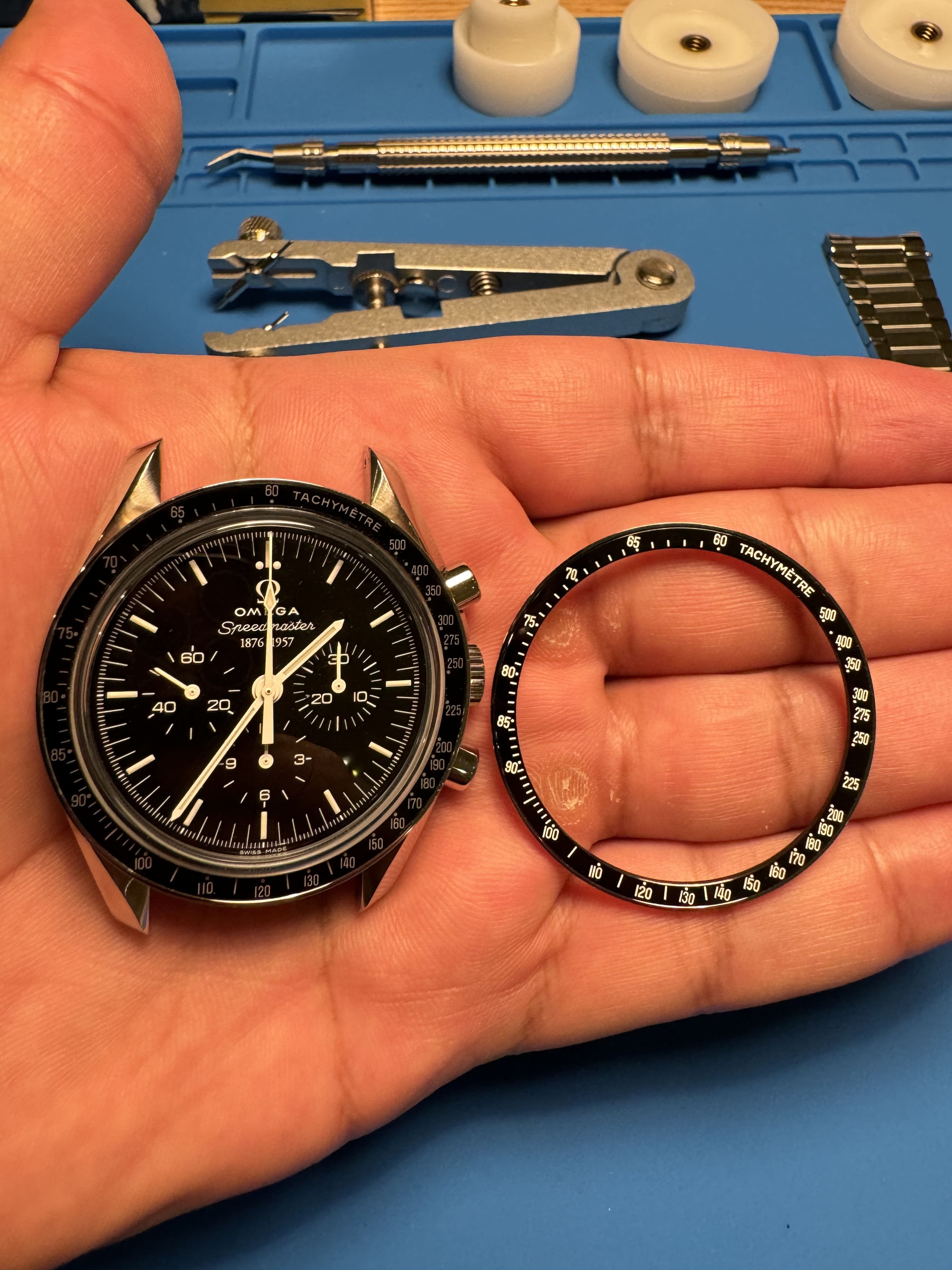

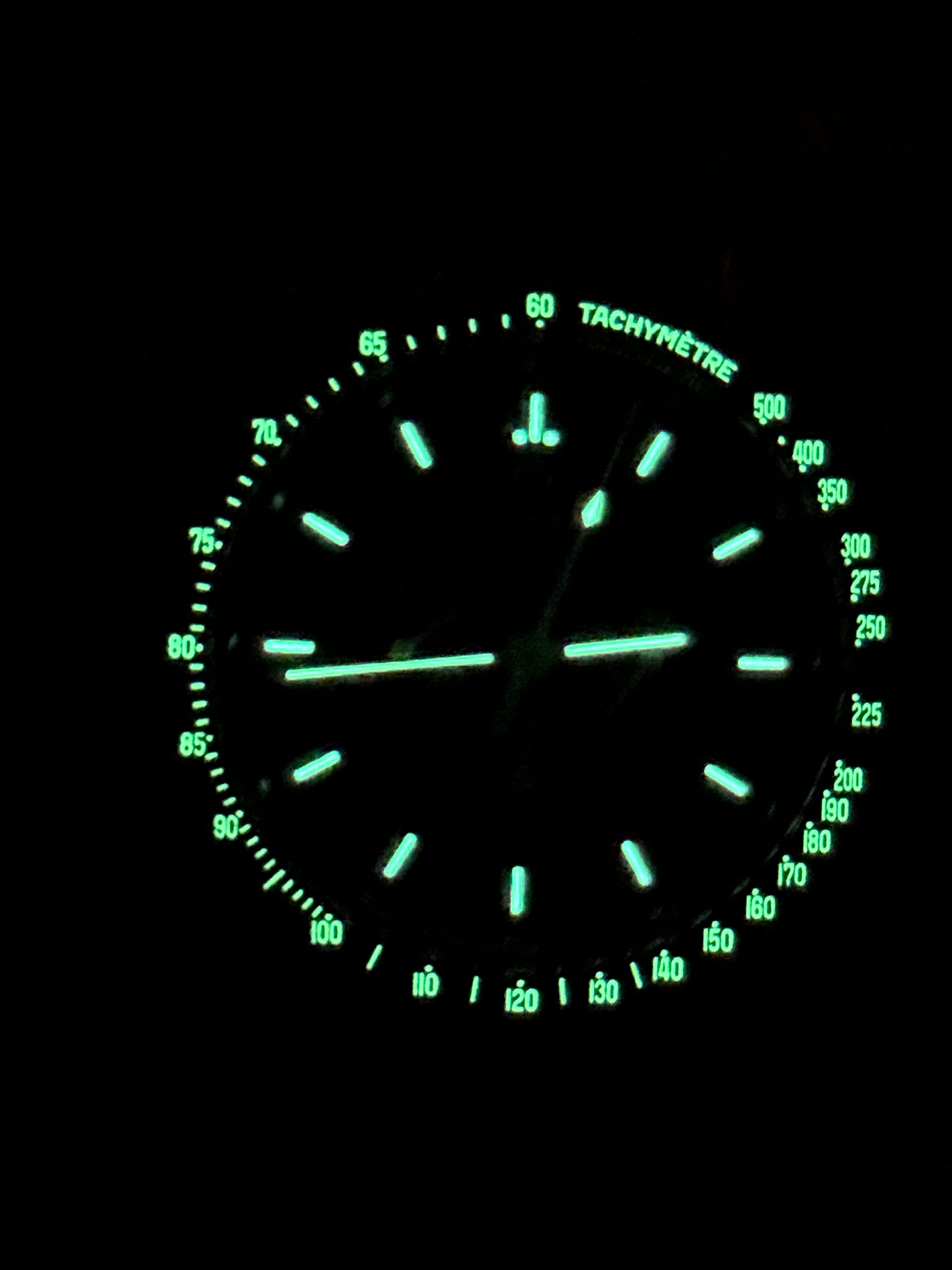

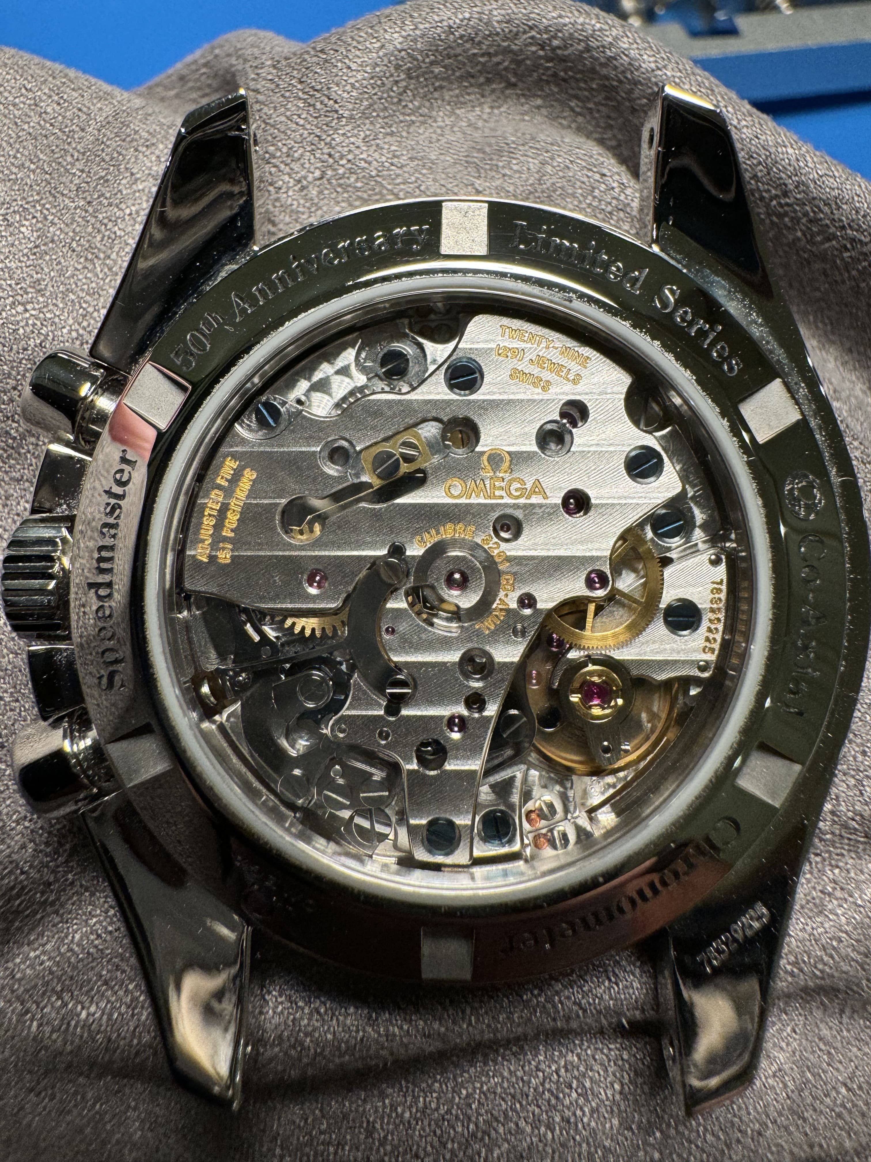

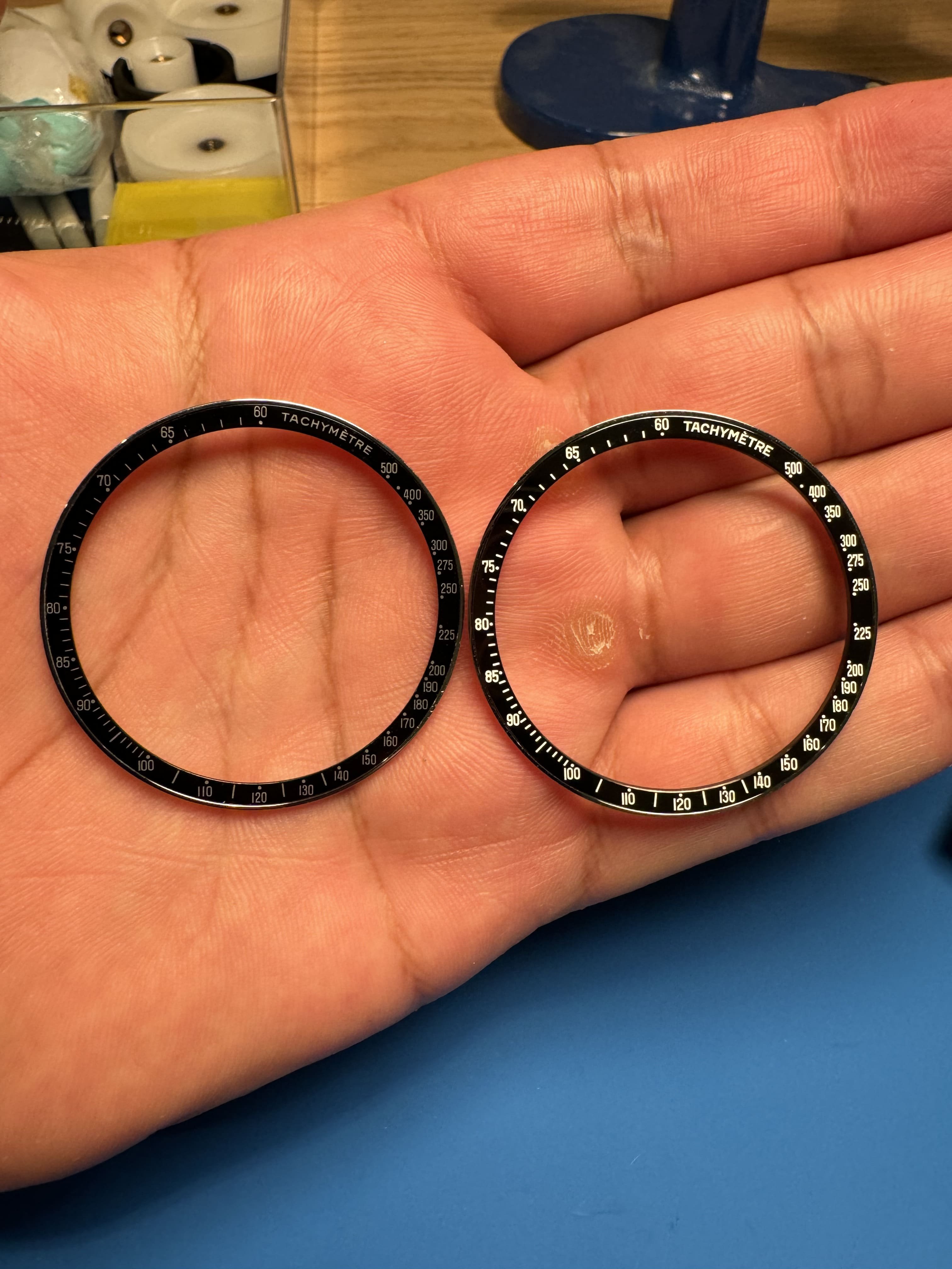

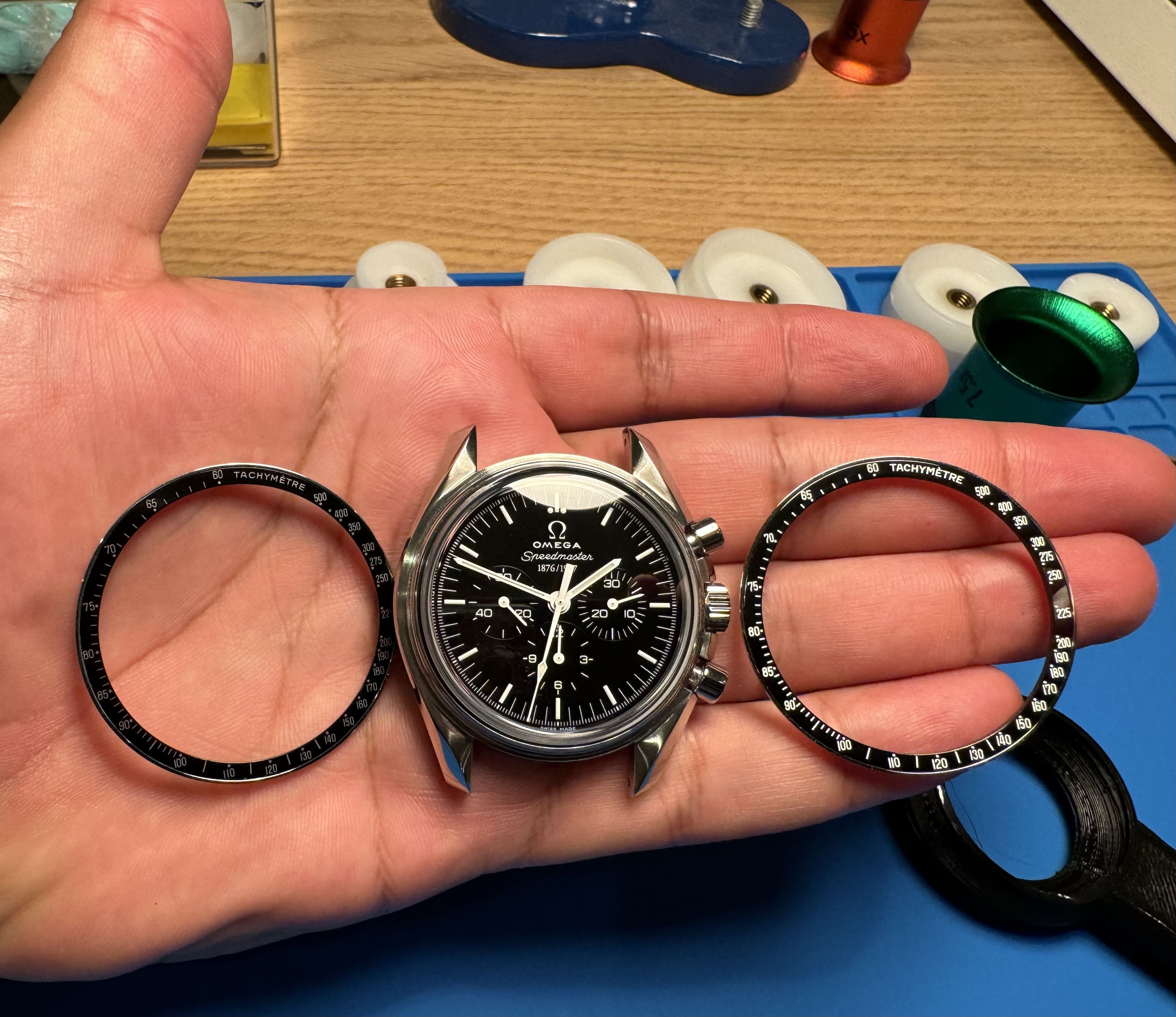

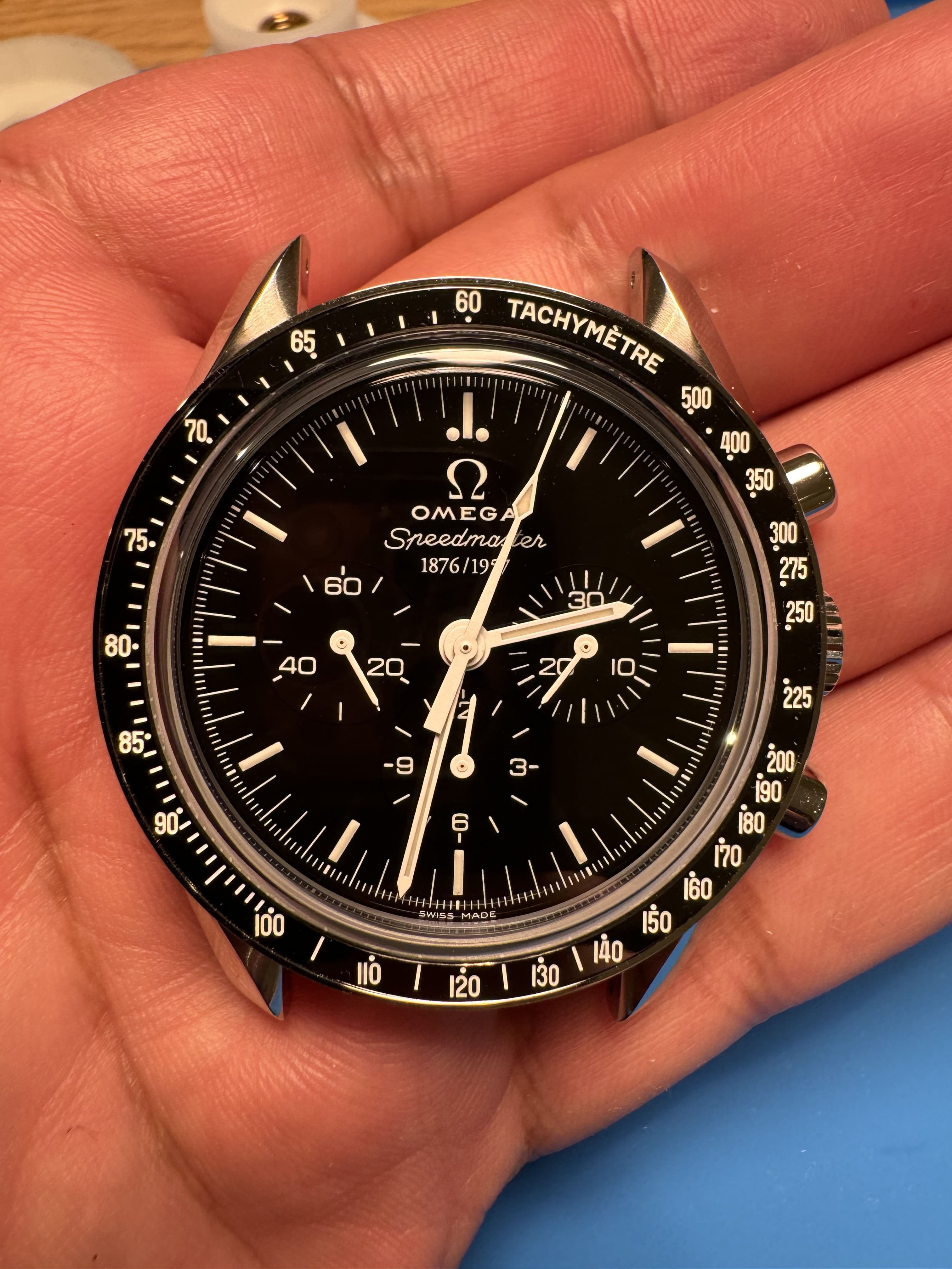

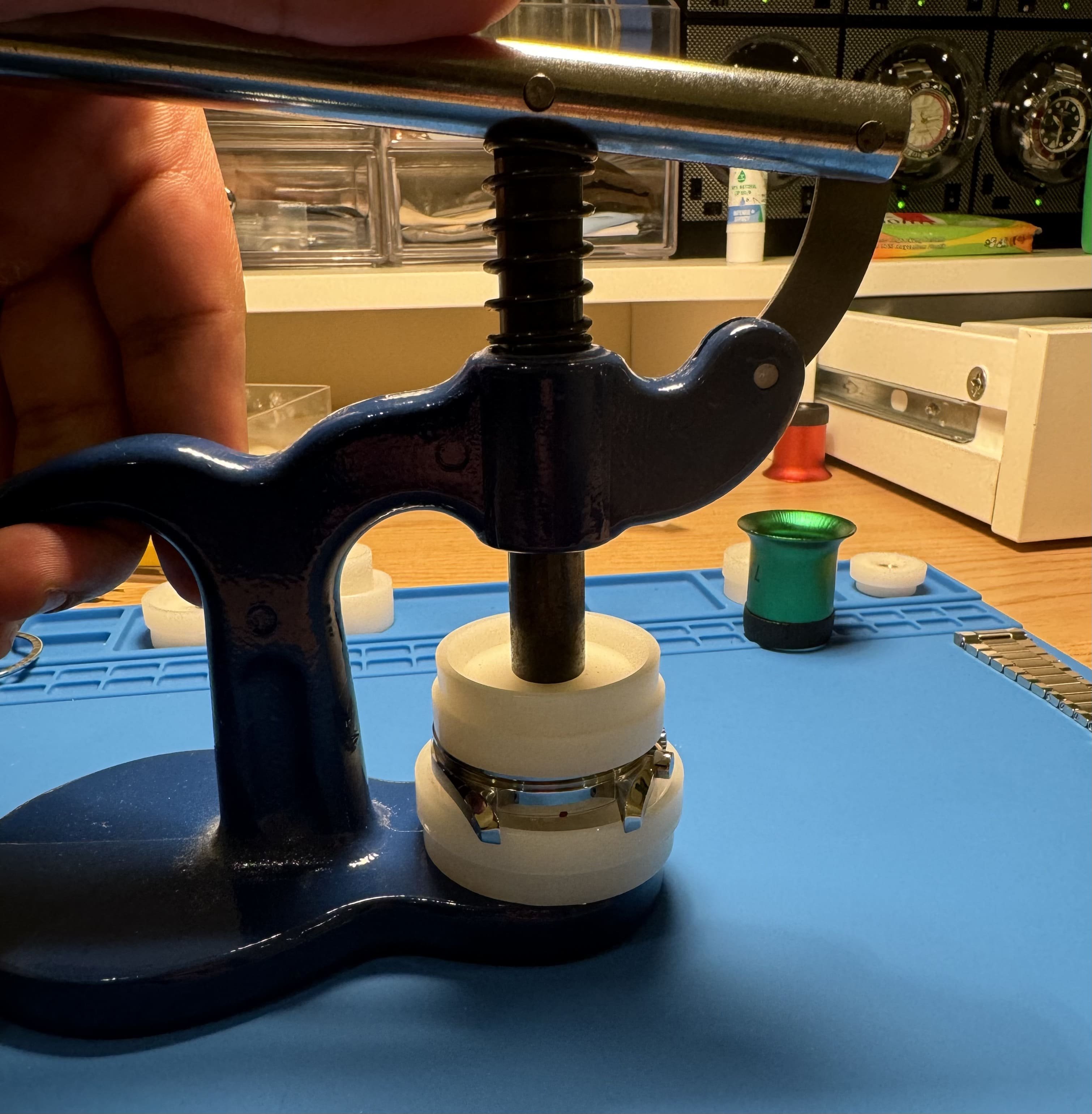

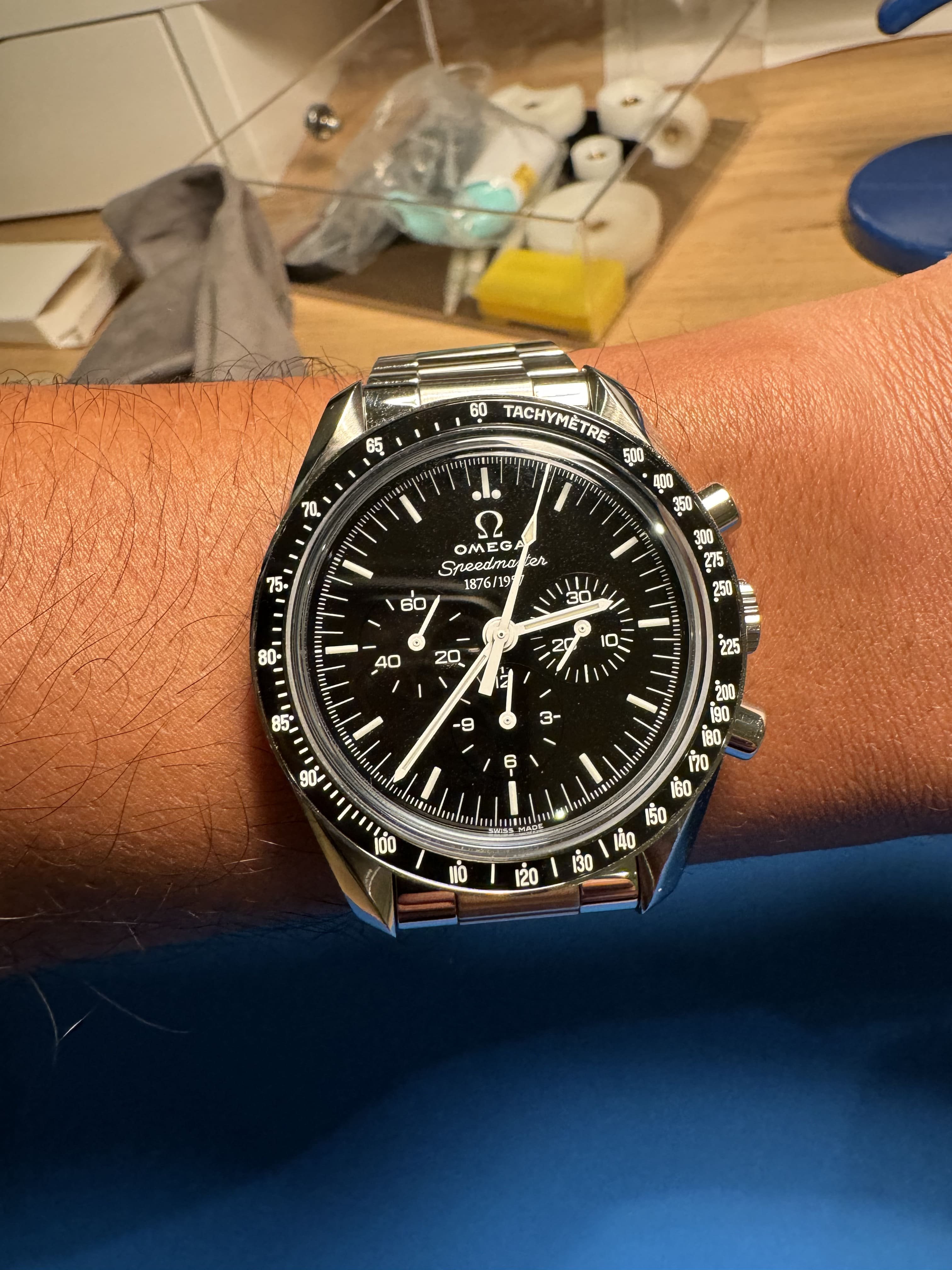

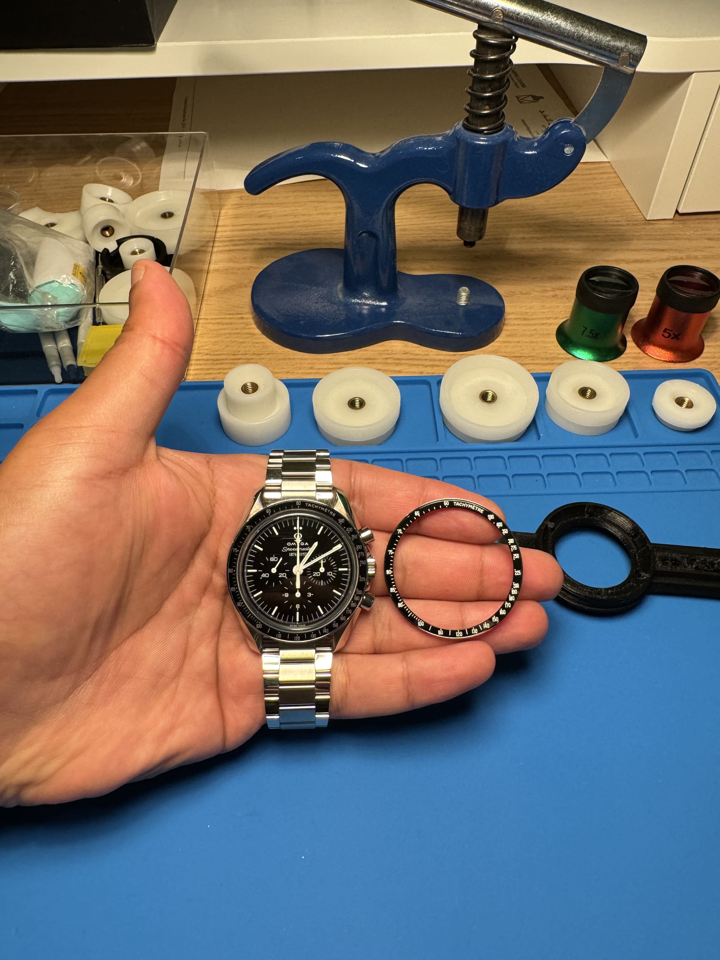

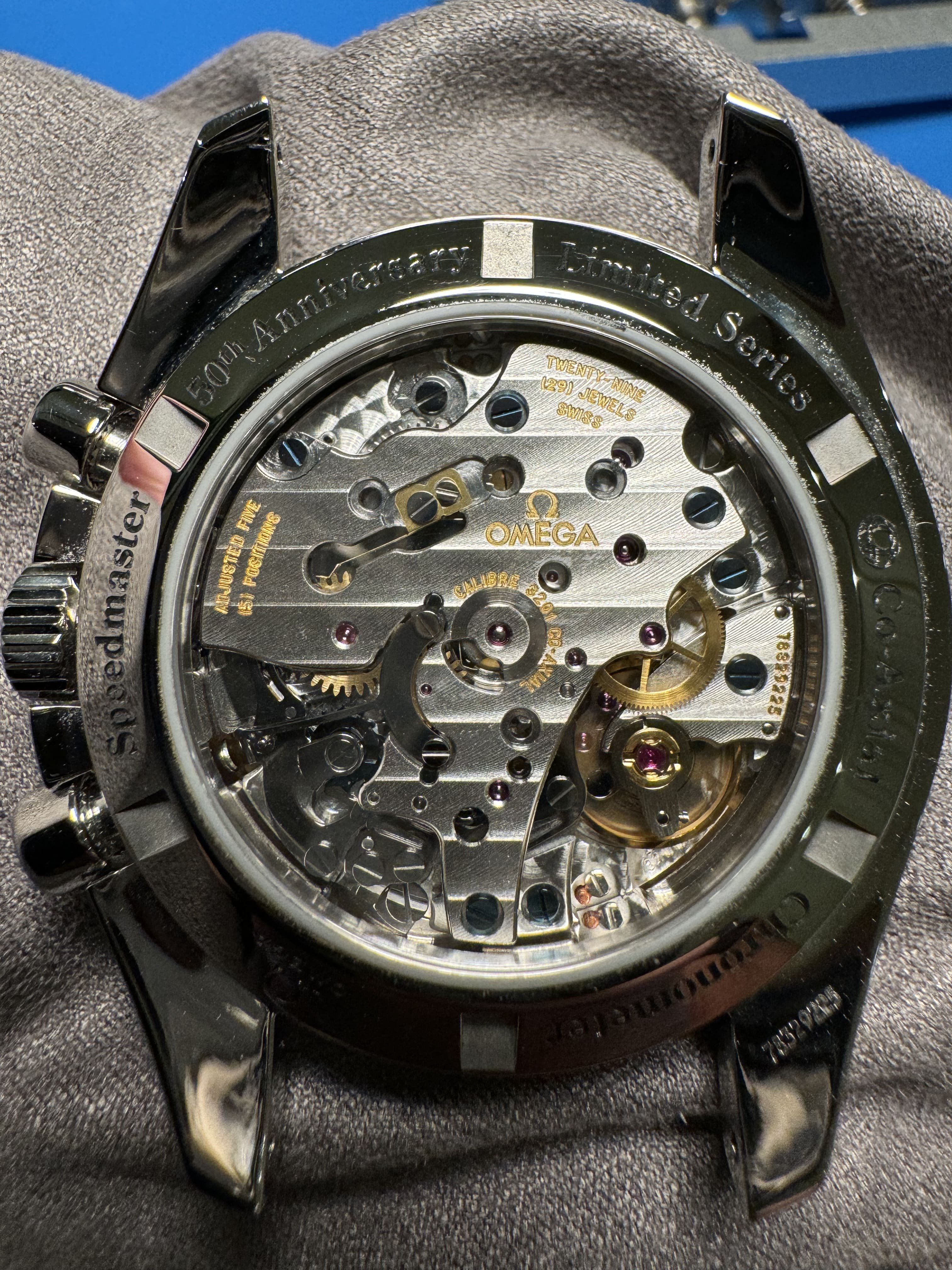

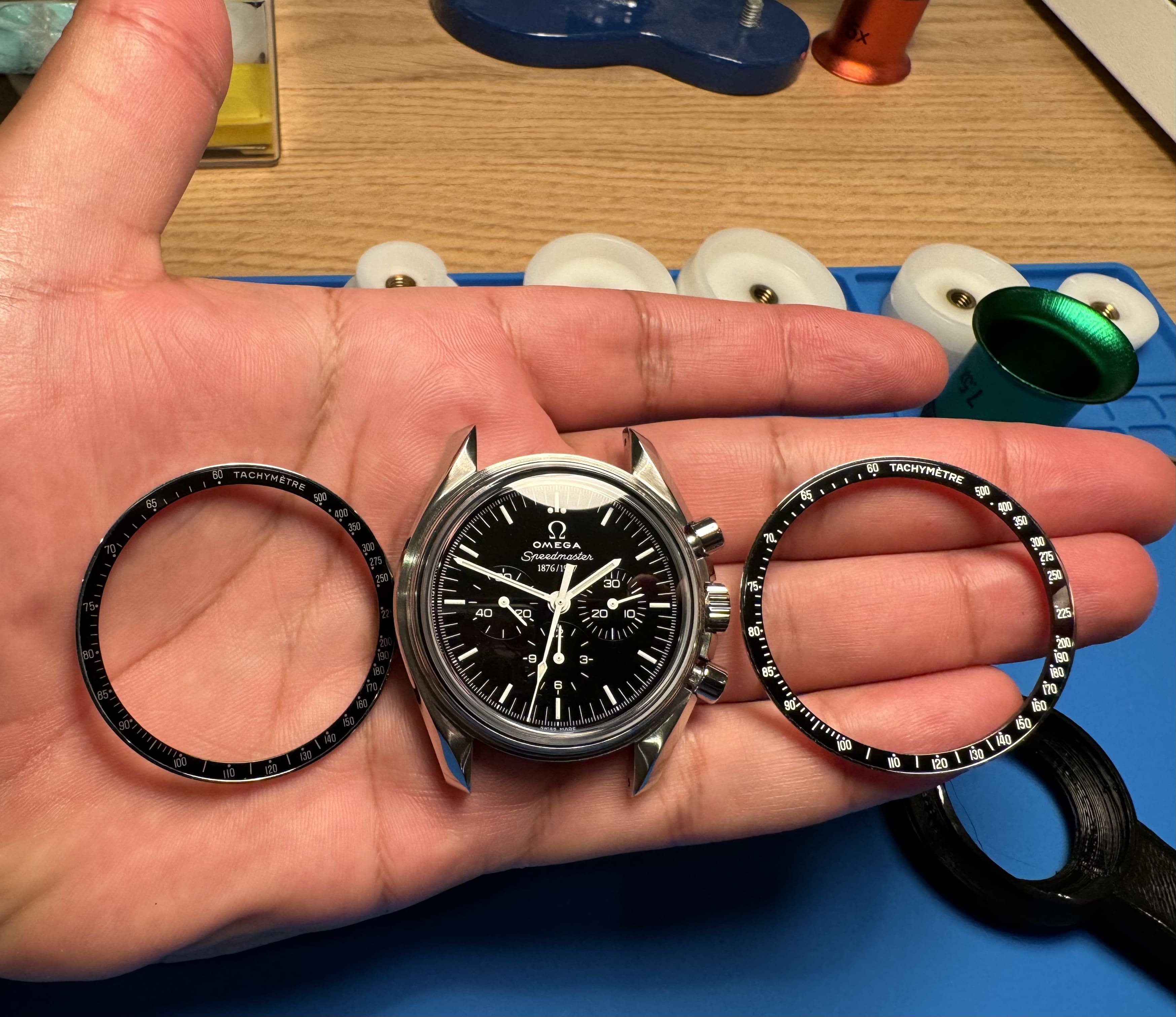

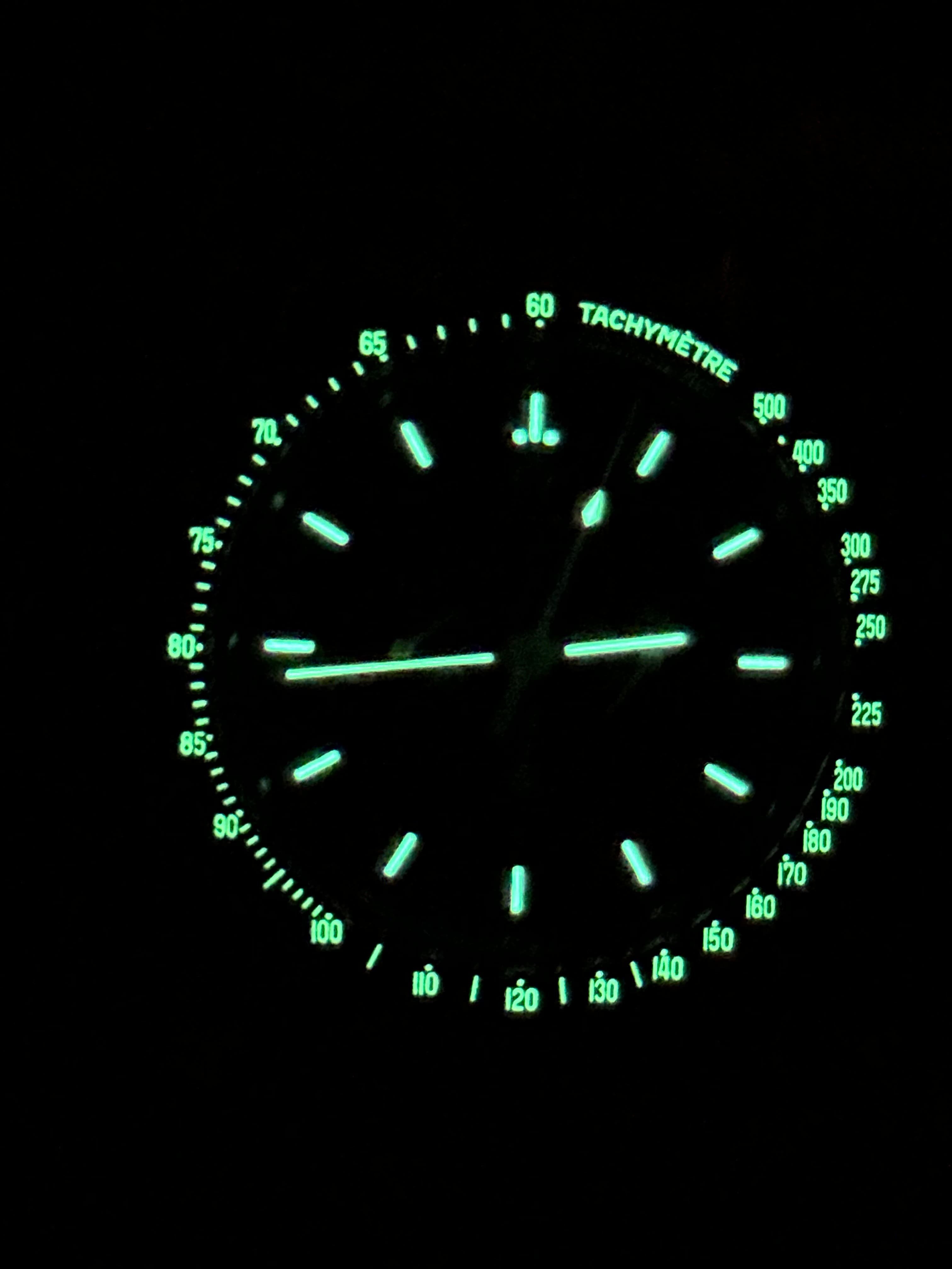

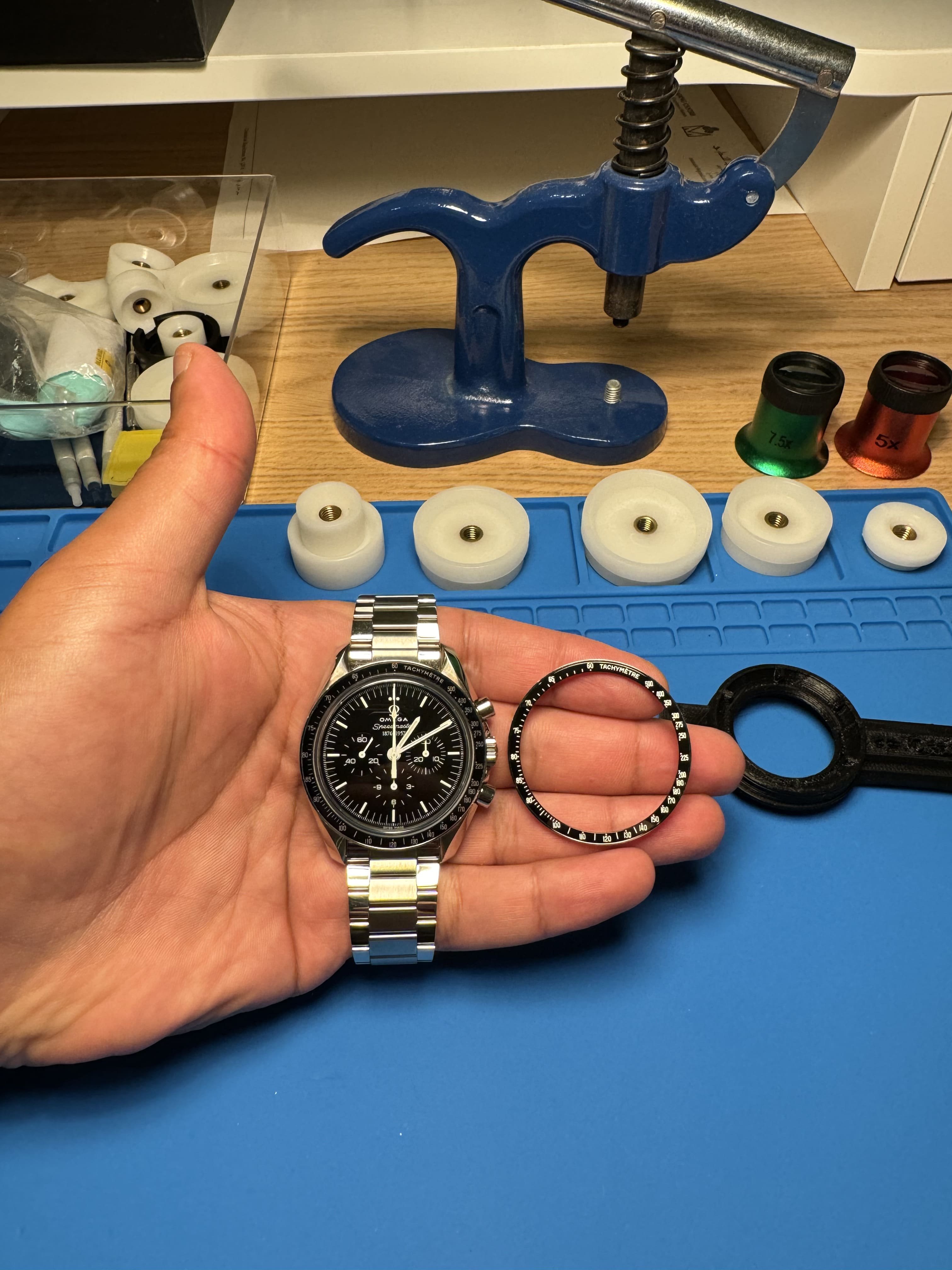

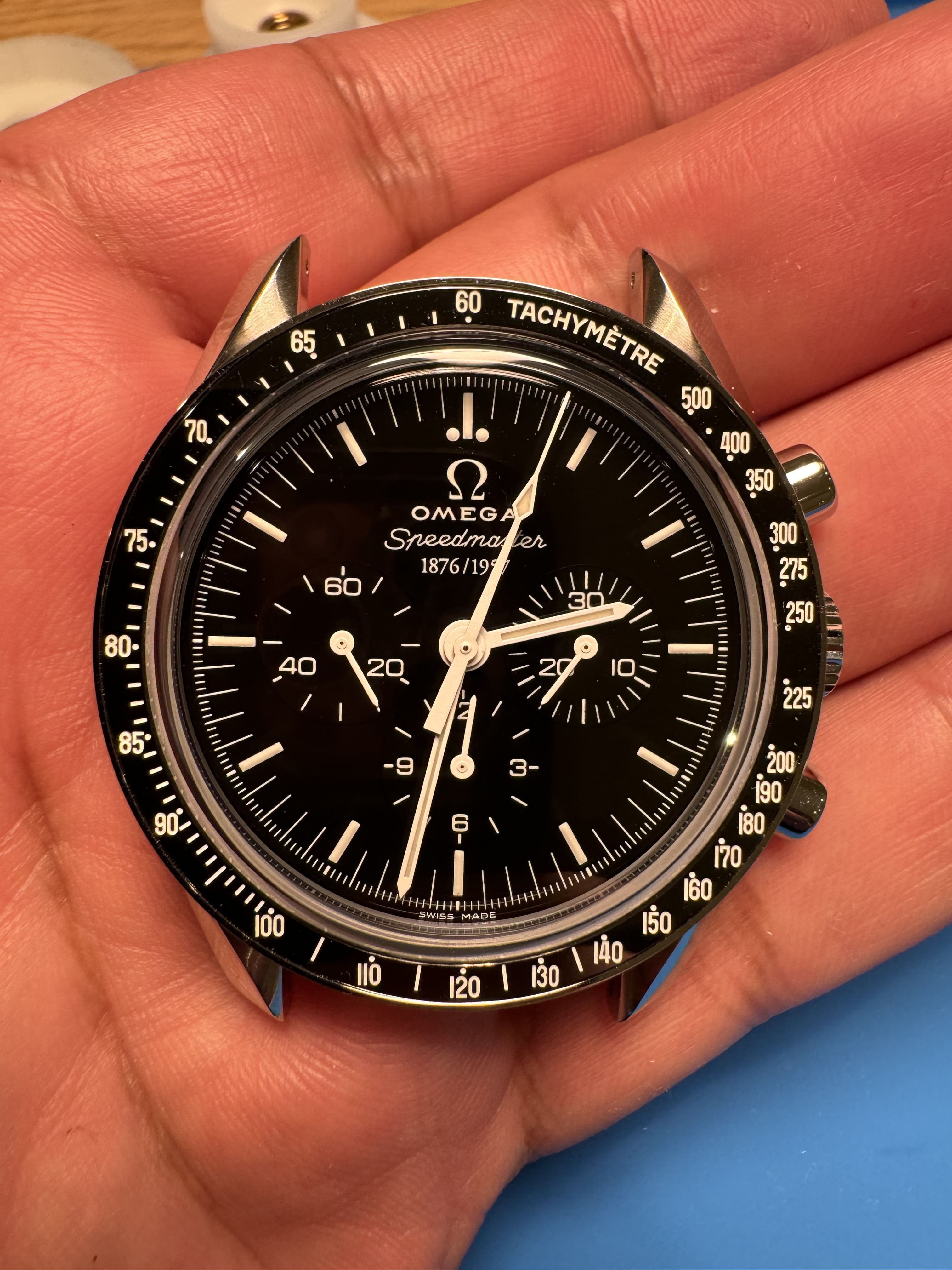

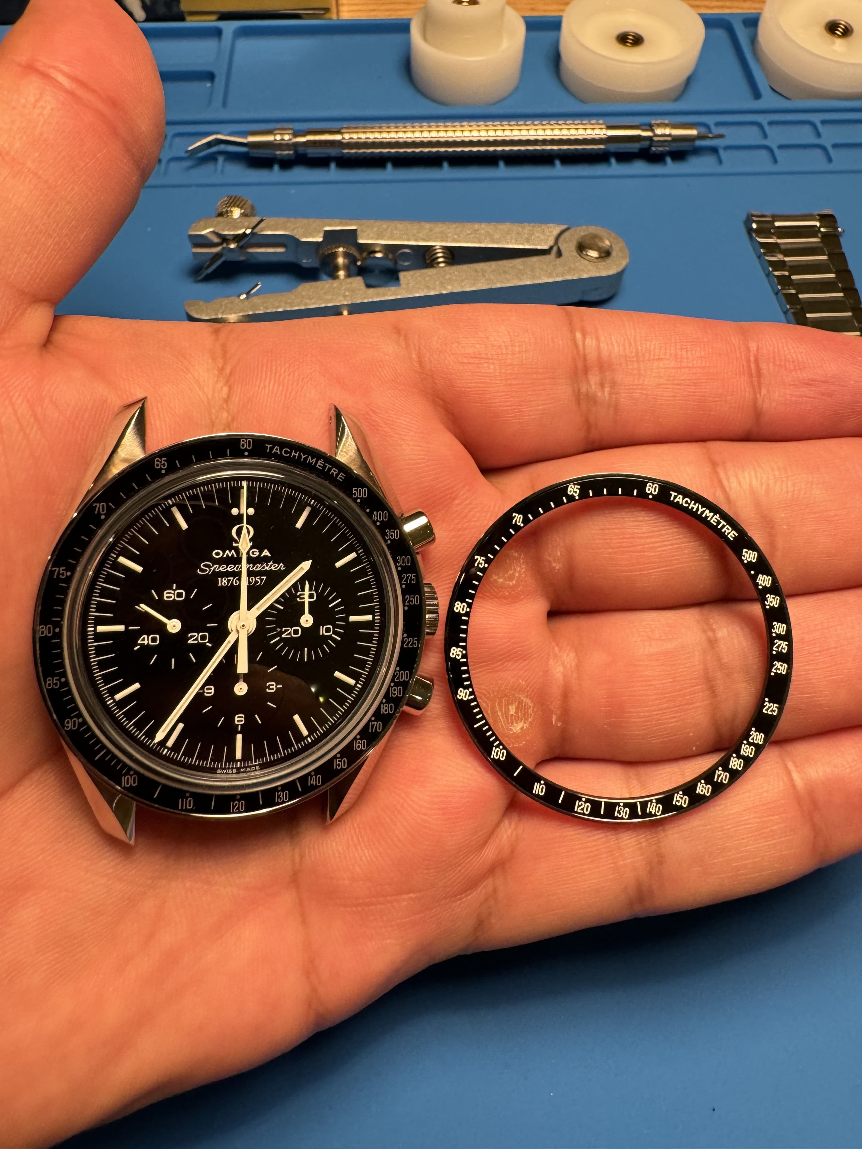

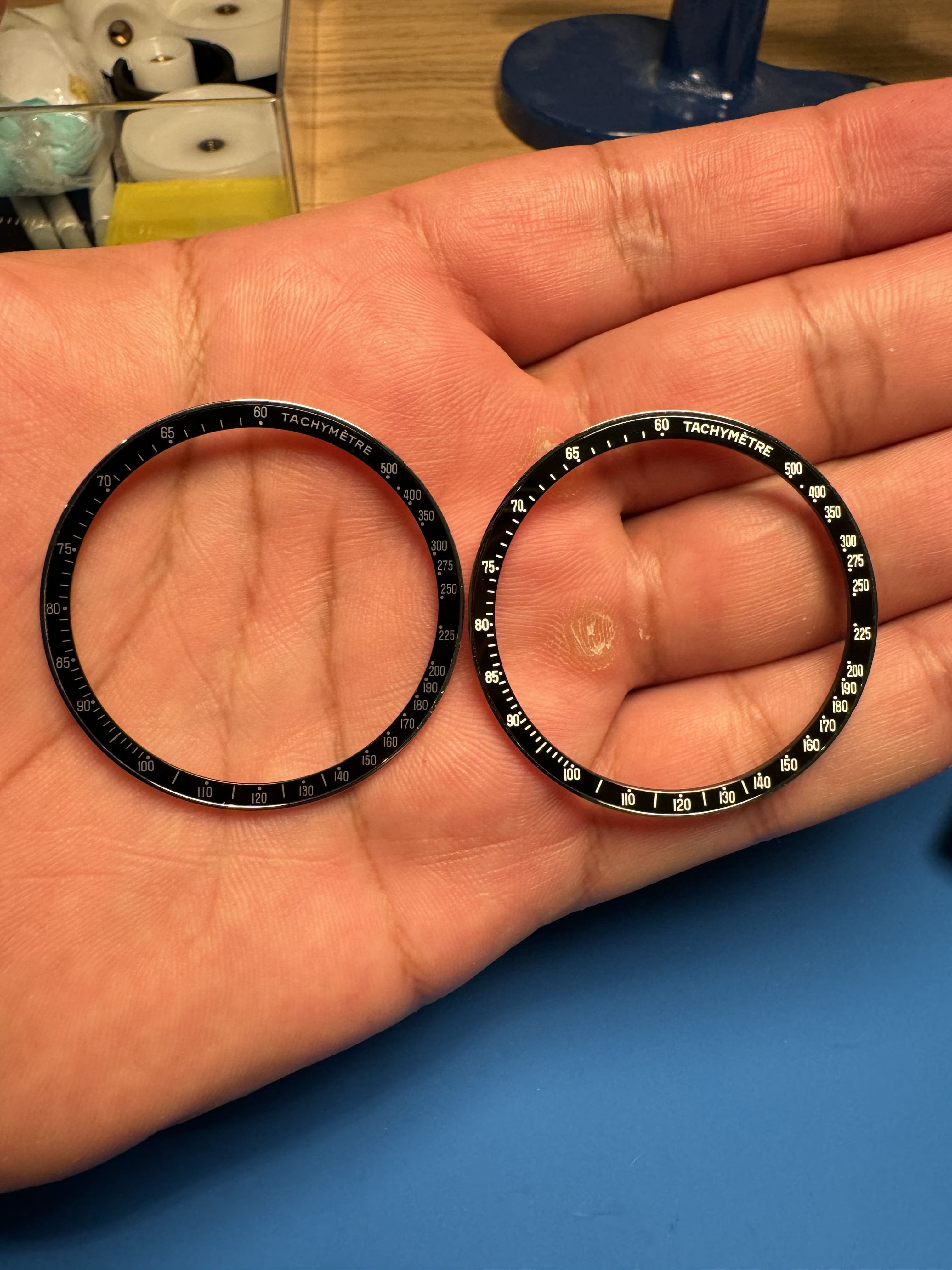

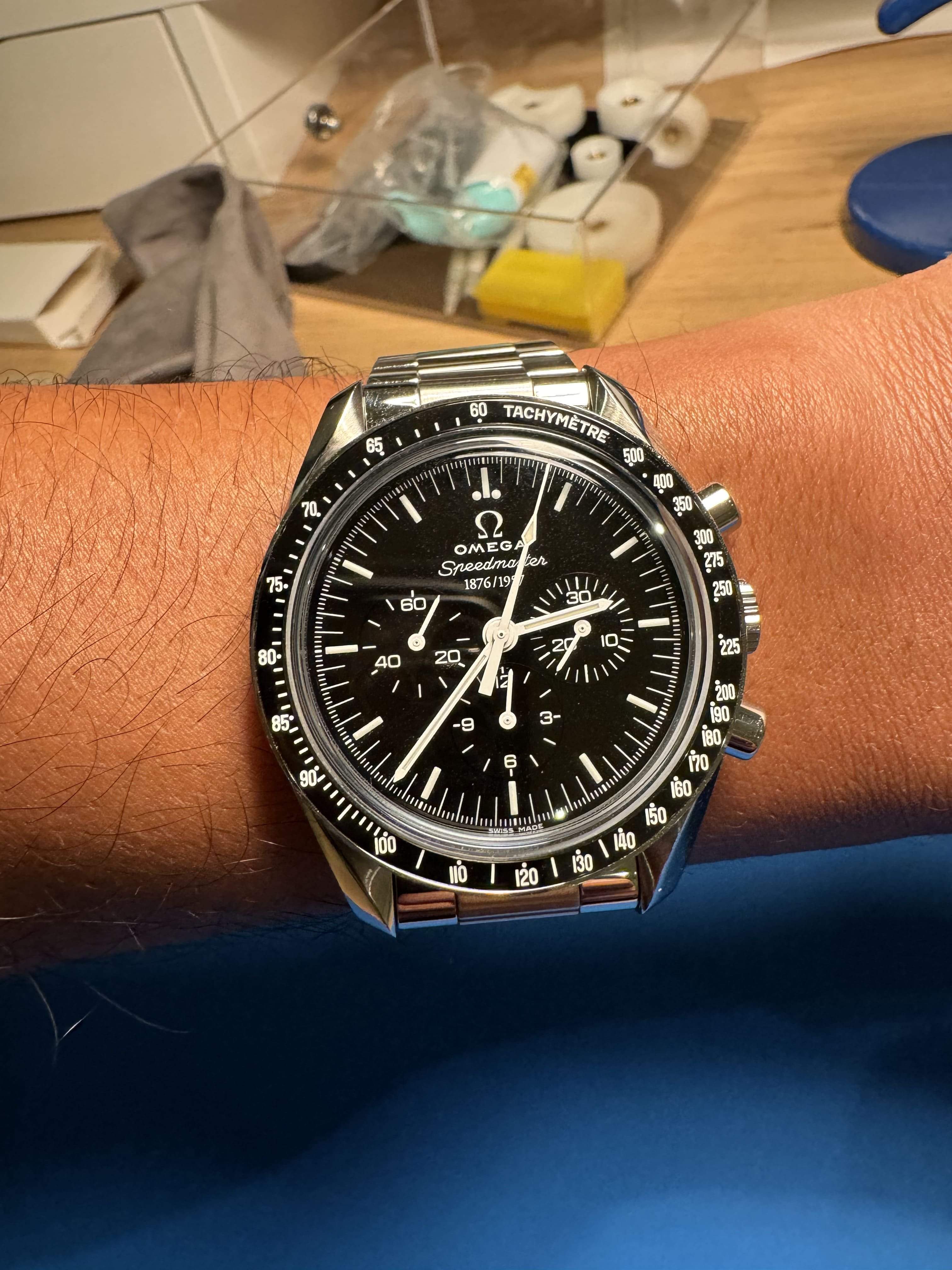

Welp, I couldn't help myself. Overall, its a nice mod, easily reversible, the quality is good, the writing/numbering is noticeably whiter so it uplifts the watch a bit, and the ceramic looks cleaner, lume brightness was ok nothing special. Was worried might not fit the 50th Ann as it uses a different movement (3201 FP vs 1861) and the watch itself is significantly thinner than the 1861, but thankfully it all worked out.
Bezel removal using the tool they provided was quite easy, install I couldn't do it by hand, had to use the crystal press tool. Aligning the bezel took a couple of tries removing and reinstalling. Overall I would say it was easy to do if you have basic DIY skills.

Nice mod 馃憤
Would also be interested in a detailed review of that special 50th anniversary edition 馃槜

its my favorite speedy in my collection, released in 2007 as a 50th ann since the release of the speedmaster in 1957, has an enamel dial, column wheel frederic piguet co-axial movement, thinner than sapphire 3861, 100m WR. Wasnt a huge fan of the original bracelet so I installed the Apollo 50th bracelet and now its perfect.

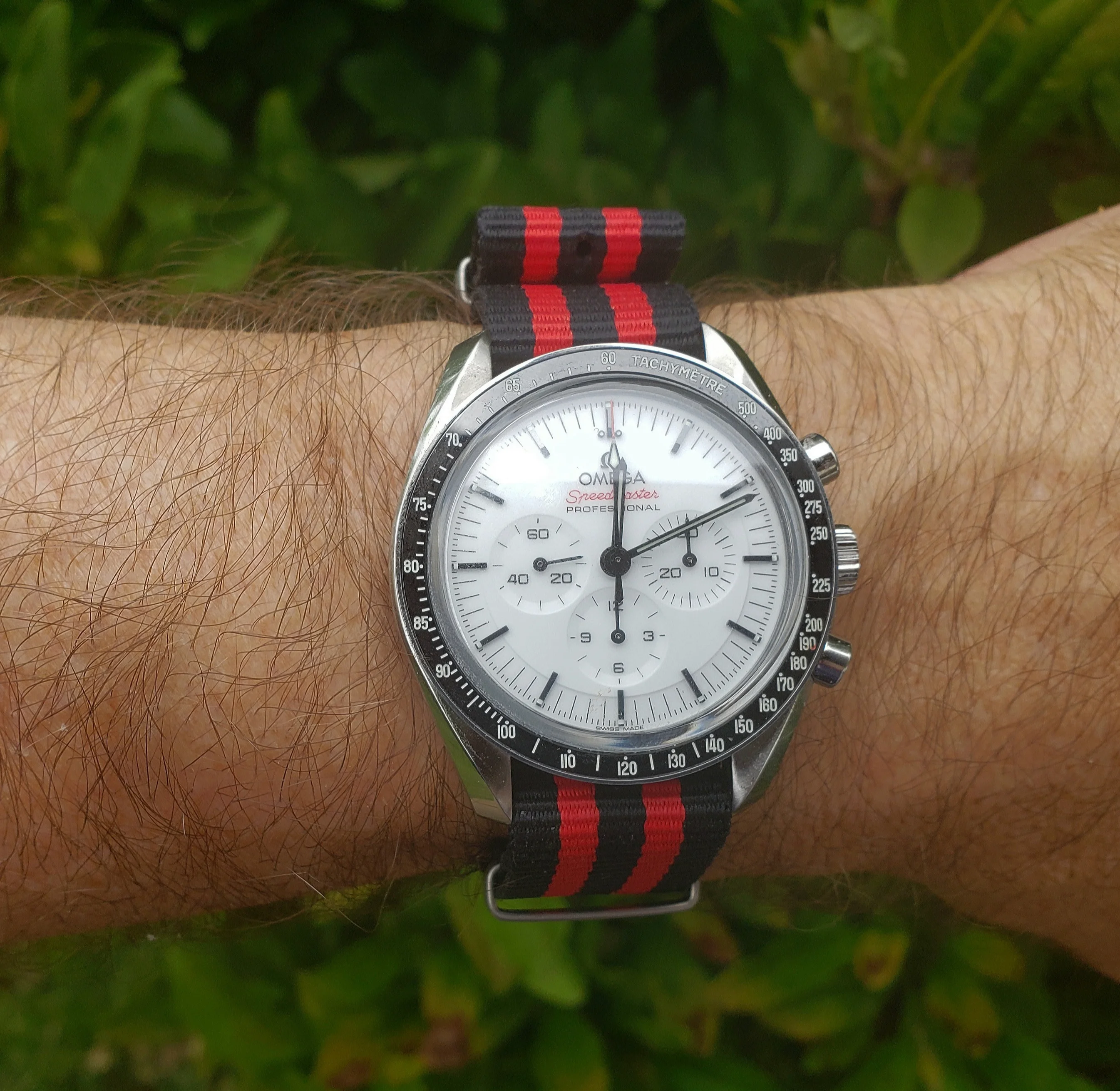

just fitted the spiralwinder bezel to my 3861 white. took 5 minutes,no stress job .

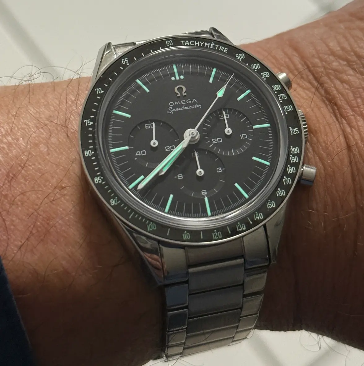

Nicely done! Just installed one on my FOIS 1st Gen Ed White Mod 馃榾

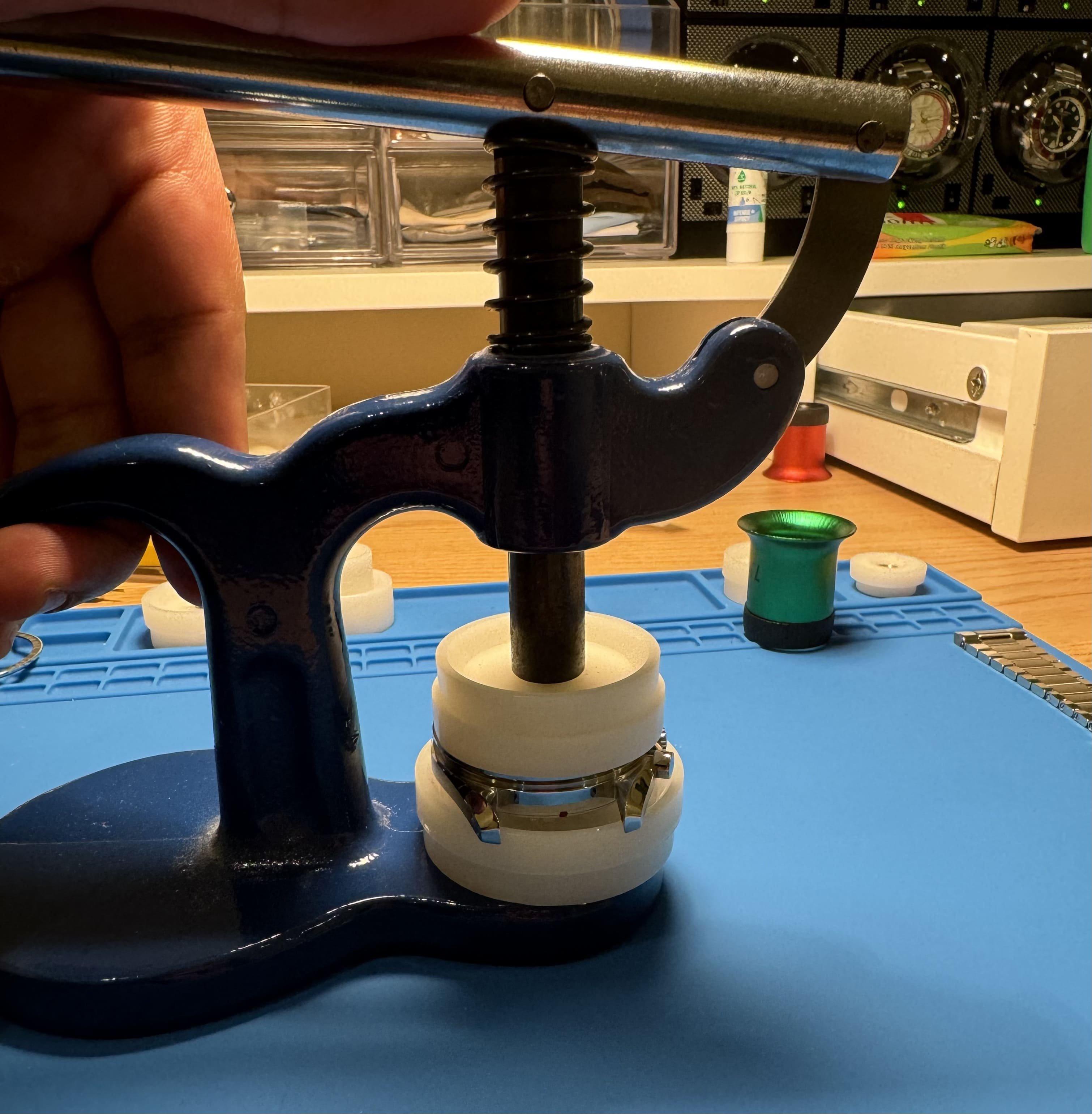

I鈥檓 confused, is this an Ed White?
No, it鈥檚 a first gen FOIS with the Speedmaster replica dial, alternate hands and Spiralwinder ceramic bezel
