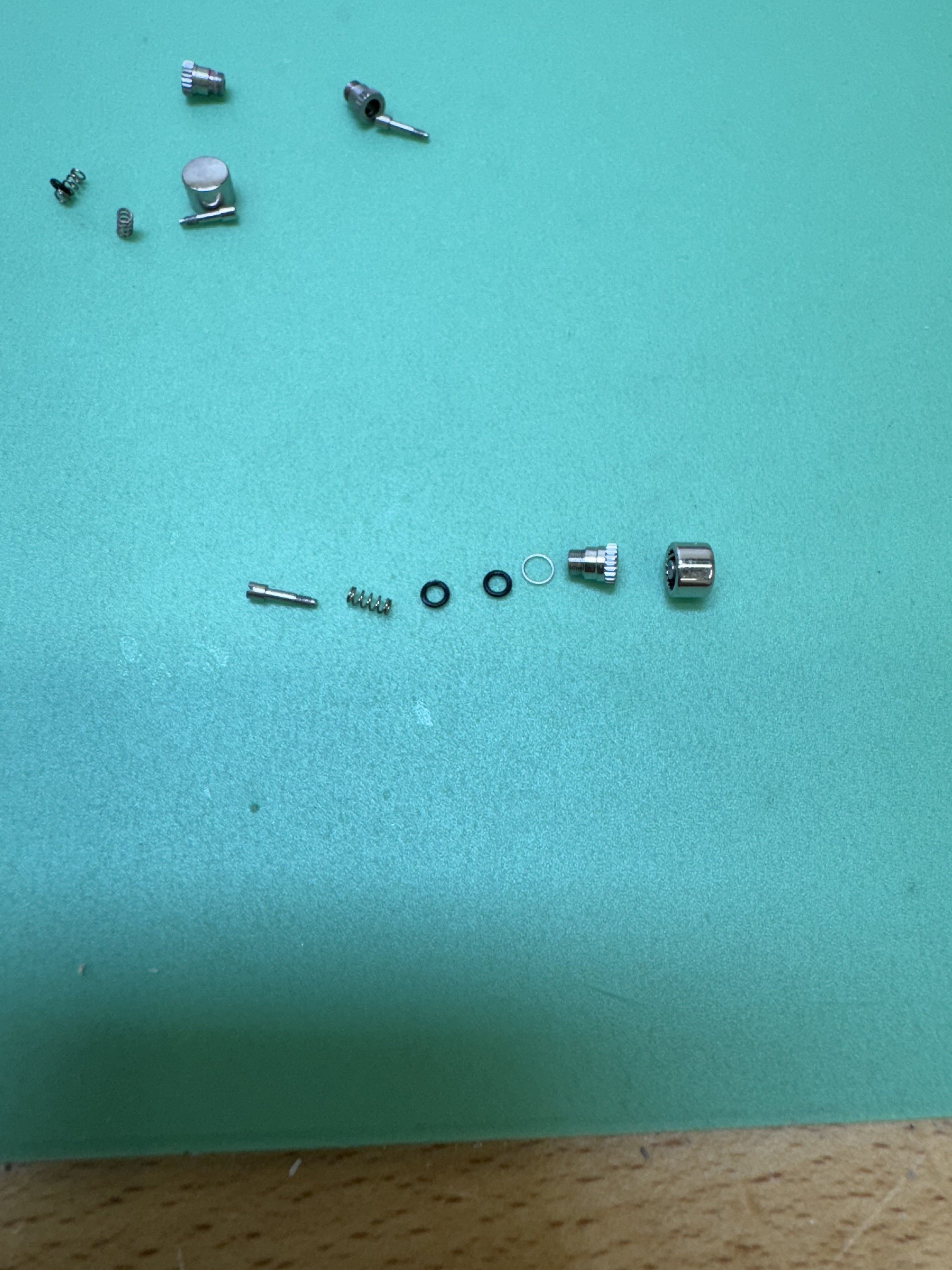

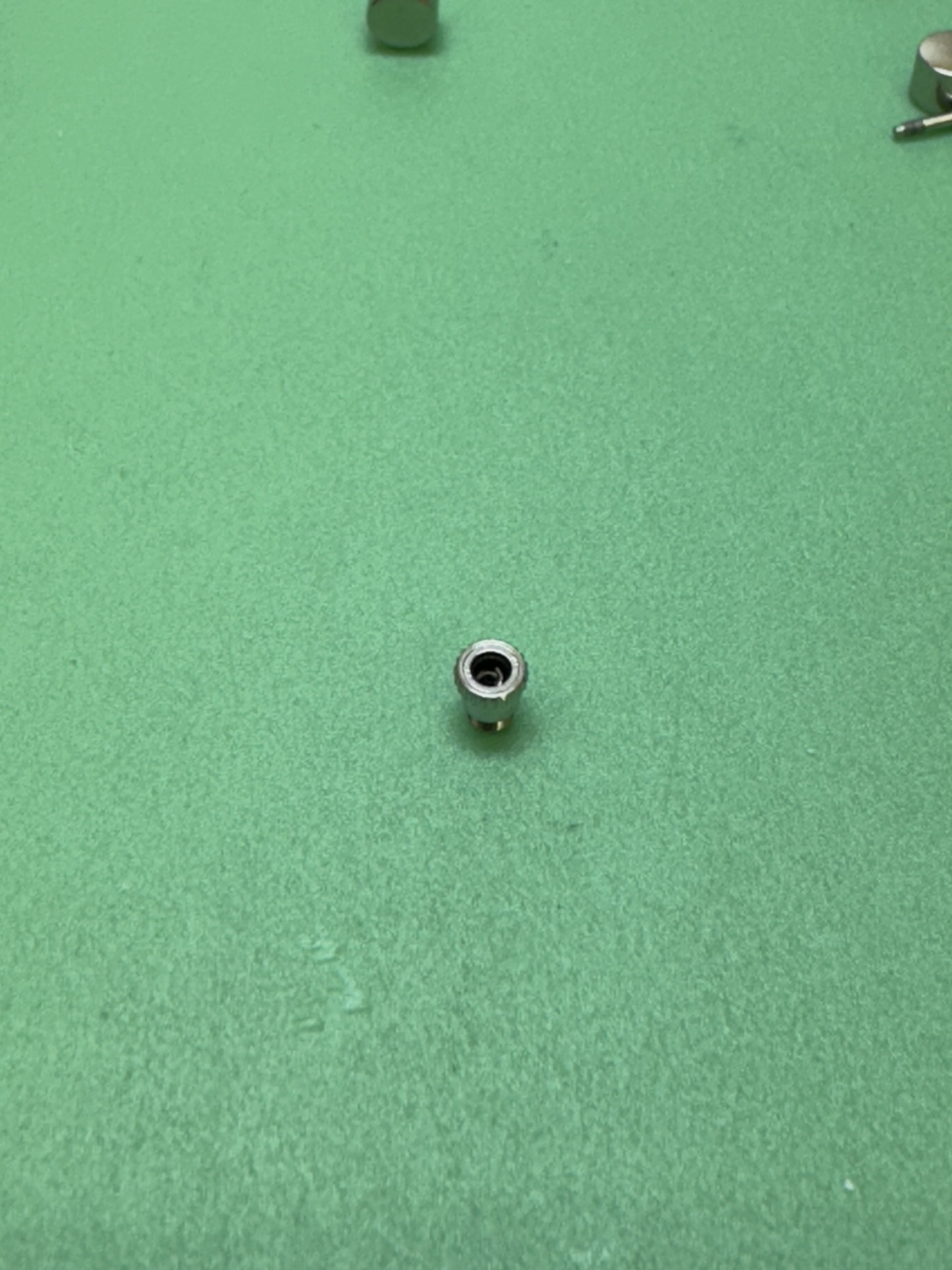

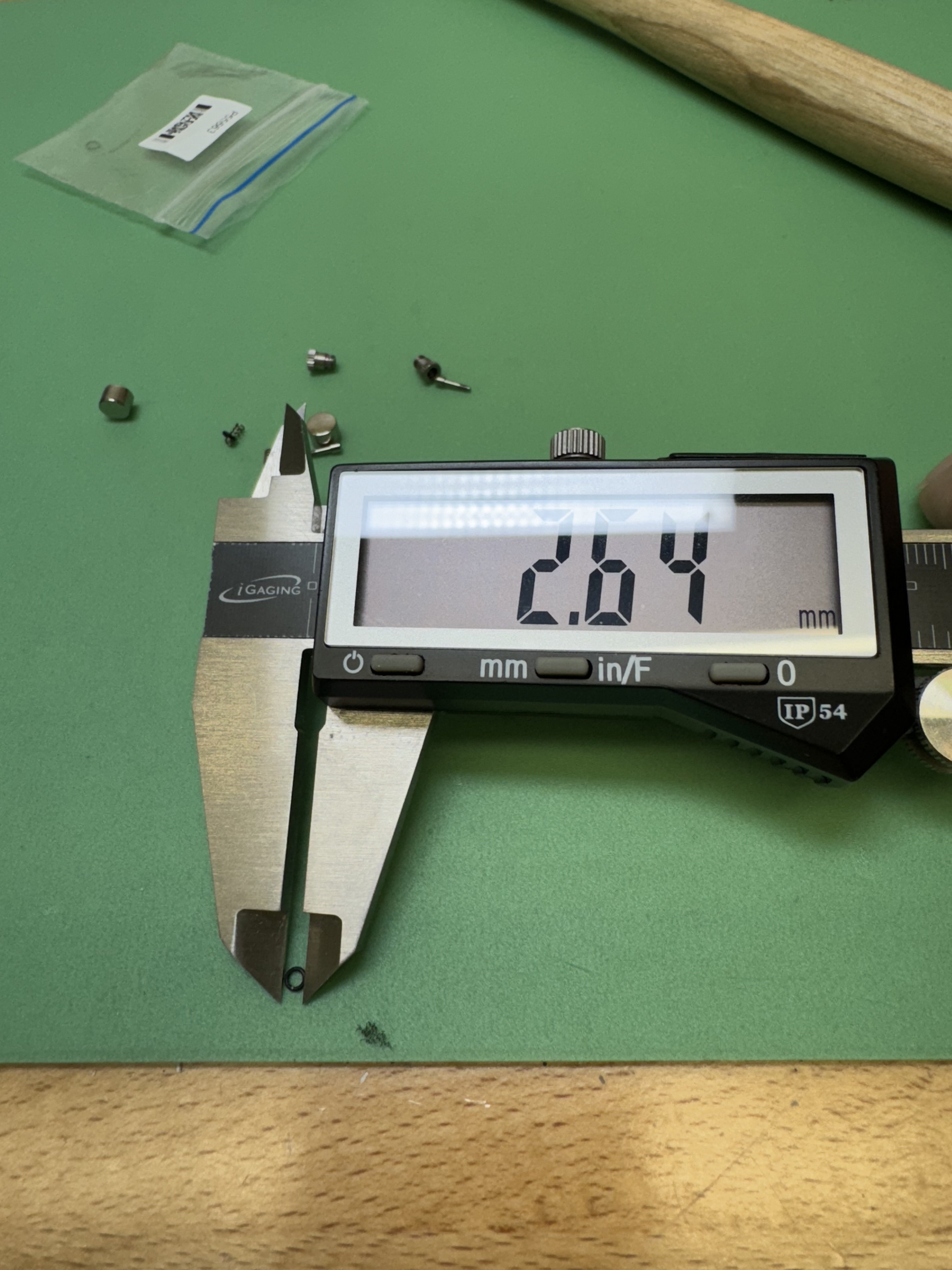

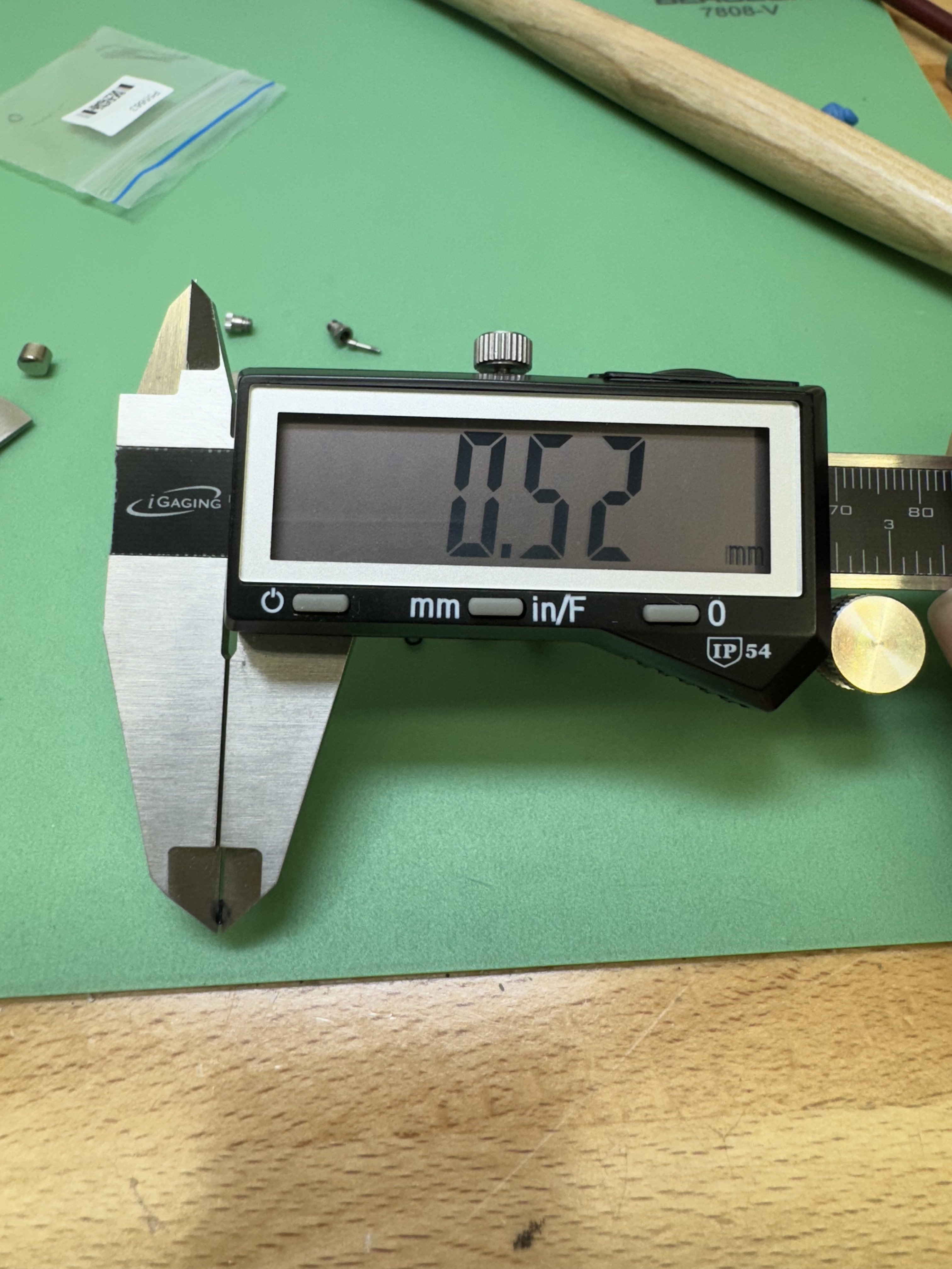

Normal procedure is to replace pushers, which is what I normally do. In the case if this Mark II, this is what it had:
2 o-rings around 2.64 OD .52 thickness.
