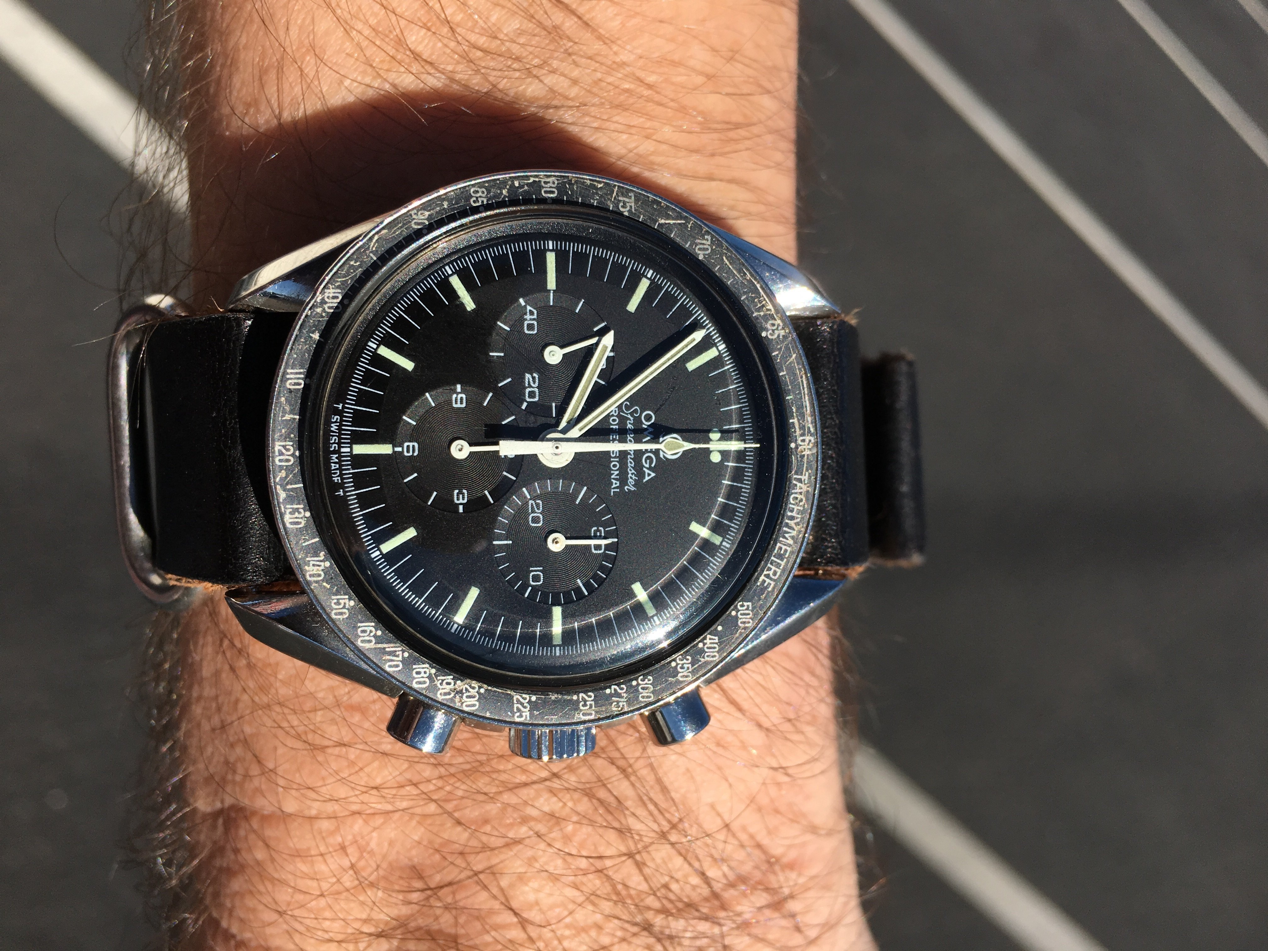

Odd my original-76 has green tinted original tritium lume...
Tritium can age a few different way depending on humidity, temp range and light exposure.

Cool -76! I would have certainly guessed luminova had Omega not helpfully printed those T's on the dial. 😁
Oddly I purchased this one from @abrod520 and you quoted both of us. I can assure you that this is tritium and it behaves correctly by a quickly fading glow after exposure with basically zero glow after 10 seconds. There are other examples out there of tritium that has aged this way, but they are not as common as the more usual brown/yellow, its not exactly rare either. Tritium after about 8 years on a watch is not working at all just so you know.
Thanks for the complement on it, I can assure you that in person it looks even better, the lack of puffy lume and no "moss" pops it. The bezel in person has an amazing warmth to it that is not conveyed in pictures at all, in pictures it looks beat up, in person it is a warm ghosted bezel with a nice fade from the inside to the outside and the scratches are not as prominent.

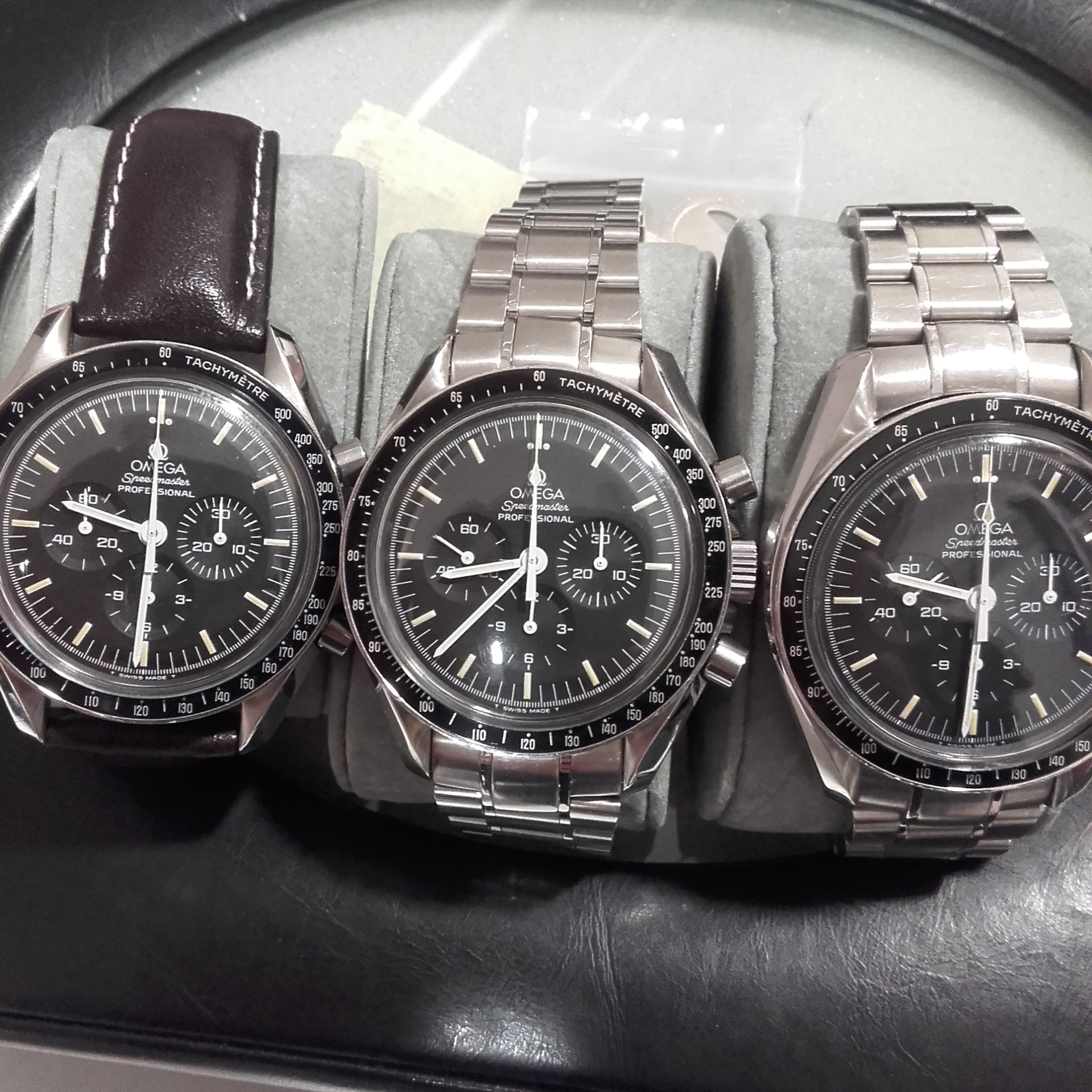

OP:
I have, all are "t swiss made t":
1996 with 861 cal
1998 with 1861
1999 1861 serial 483729xx (middle on pic)
