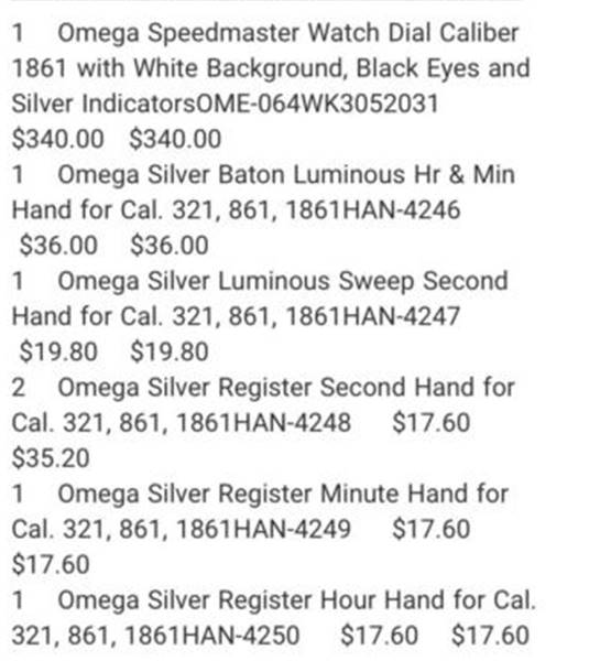

    Recently I obtained a Mitsukohsi Dial/Hand package kit for a conversion project I wanted to do on my modern 3570.50 (watch purchased new in 2013). I purchased the full set of dial and hands in one bulk buy from someone who original bought from Offrei but never got around the doing the project. Attached is the receipt of the items when the seller purchased them from Offrei.
    I sent the watch off the my local maker a few days ago. Today he says the dial is not fitting correctly and the hands wont fit.

    The 064WK3052031 Dial is intended for Cal 1861 movement right, which mine is. Is there something else here that could be an issue or incorrect compatibility, or does he need to apply additional 'encouragement' to get the dial to fit.
