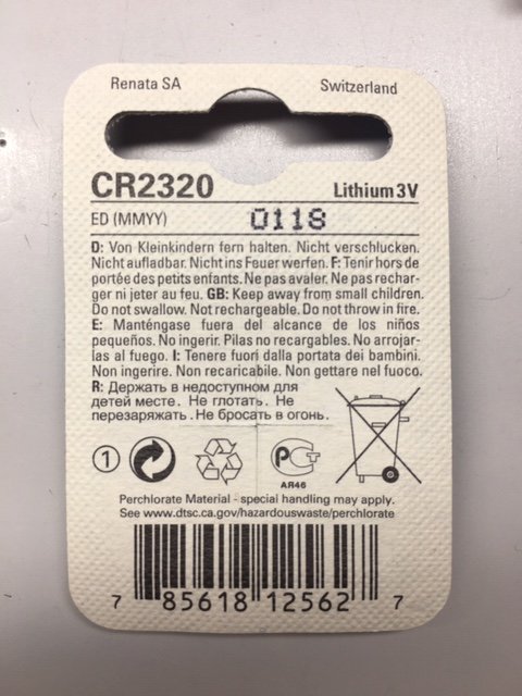

There should be an expiry date on the battery package:
In this case January of 2018. I recommend buying batteries only from locations with very high stock turnover.
However I'm not convinced this is related to the battery age. I'm assuming you changed this yourself? Did you put the watch in the battery change mode before removing the old battery? Did you position the contact spring in the battery insulator opening?
