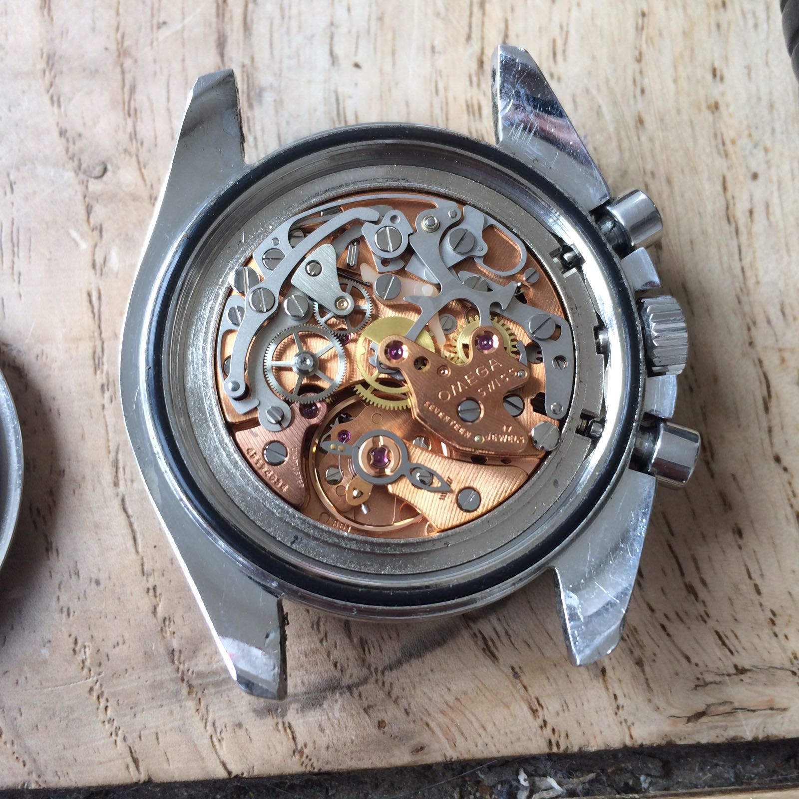

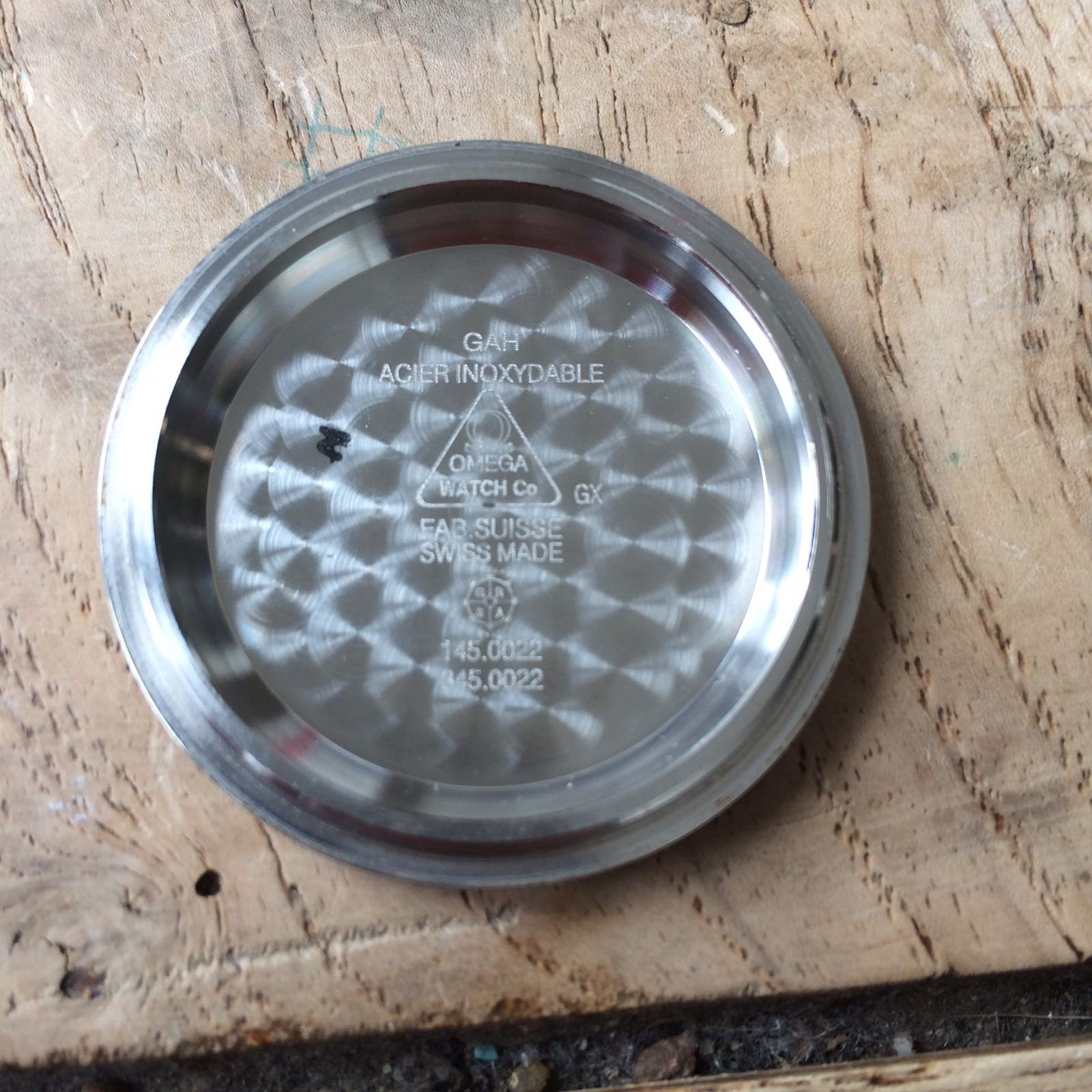

    Hey guys,
    a friend ask me for help, but I am confused myself. He showed me a nice tropical, what seems to be Speedy 145.022- 69 on some pics. Today he got the watch, opened it and there is the confusion. We have a 0022 caseback, a 45.XXX.XXX Serial, a DON and a 69 dial. The hands are Tritium as well.
    Is this is mixed up part watch or was it just a serviced in 1984 and got a new caseback and movement?
    Maybe you have some ideas.
    Thanks Nico

    Without a paper trail, it's a franken...

    Without proof that services were done to put it in this state (and even with given the complete movement swap, it's a franken/build/just not correct.

    Ok, let me asked the other way around. I it possible to say, that caseback and movement where swaped at the same time? Any caseback specifics for 1984 / 85?

    It's a modern, laser engraved caseback, I believe the 345.0022 was introduced in 1987... so from then, or some point after.
    And a movement produced at some point in the early 1980s.
    Again, without documentation to show what was done when and where, it could have been done in the 80s by Omega or it could have been done last week by a guy trying to build something to sell to the uninitiated.

    With a dial that nice, I would hope this wasn't a recent put-together. Would be a shame to not do it right. I personally think that if the caseback were swapped for a correct one, it would be quite enjoyable. Yes, the movement isn't the right serial number range, but I personally could look past that if everything else were basically correct. The only real issue with that is if I recall the way of telling if it is an authentic -69 going tropical (and not a dial that has been tinkered with) is by movement serial range.
