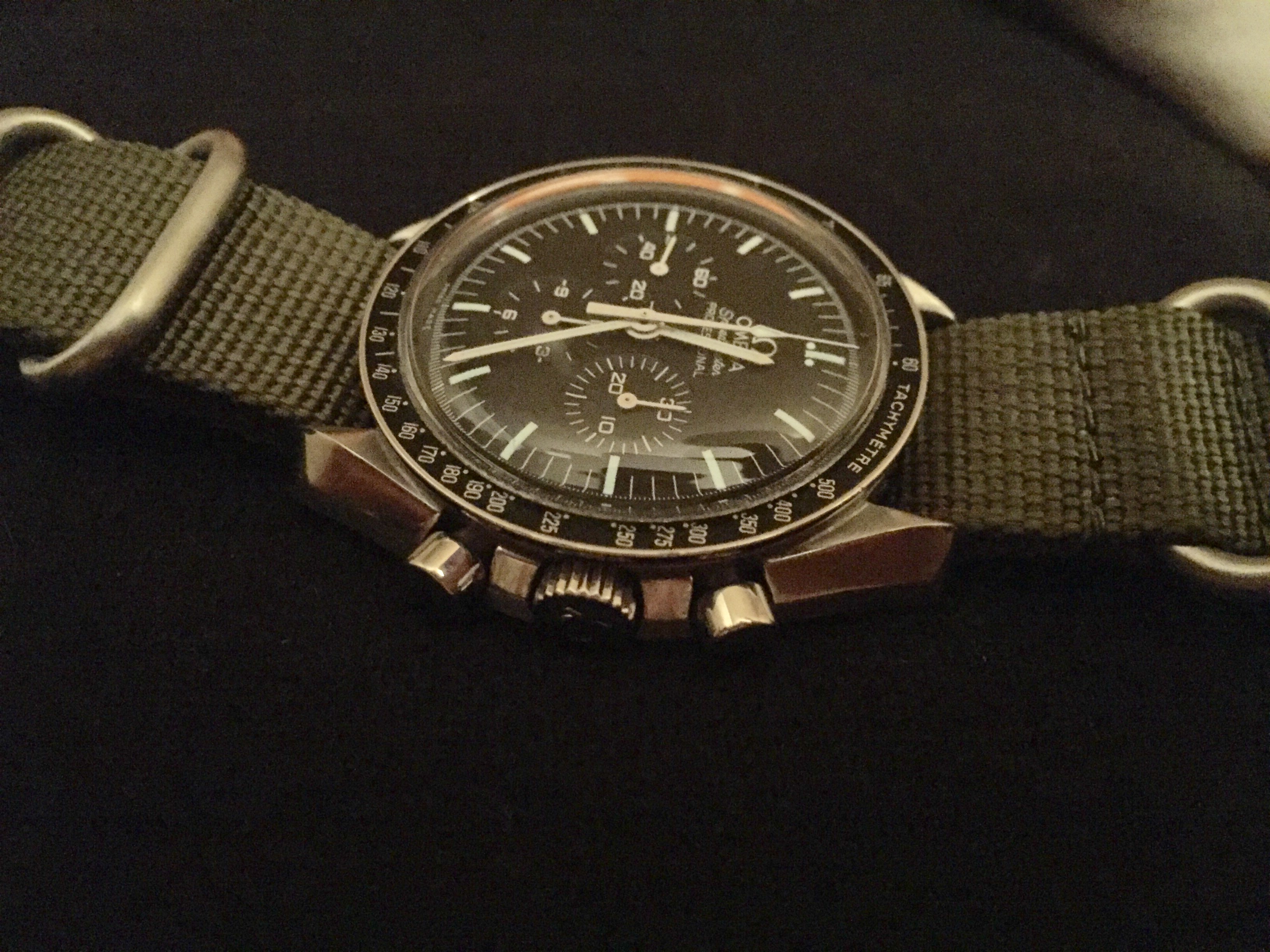

  8. caminator Oct 23, 2015
    4
    Thanks! Really enjoying the military green zulu strap I got for it. Not the best picture but here it is. Feels great having it back. Can't imagine ever selling this one.
