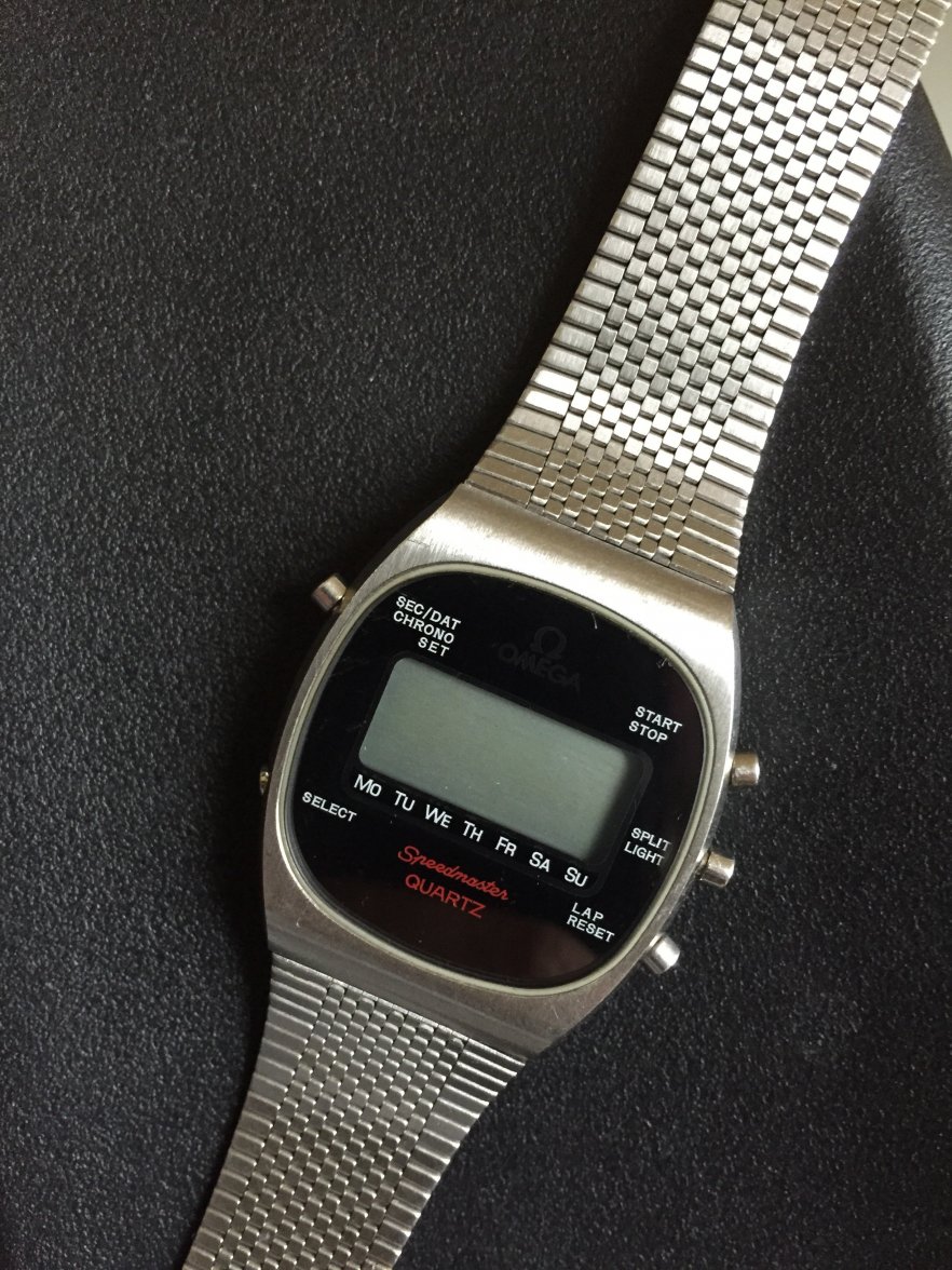

    Just bought this one and decided to try fitting a leather strap to it. When I removed the pin I must have accidently pressed the sec/dat chrono set button and the display turned off. How do I go about getting it back? Was working fine before I fiddled with the band. ::shy::

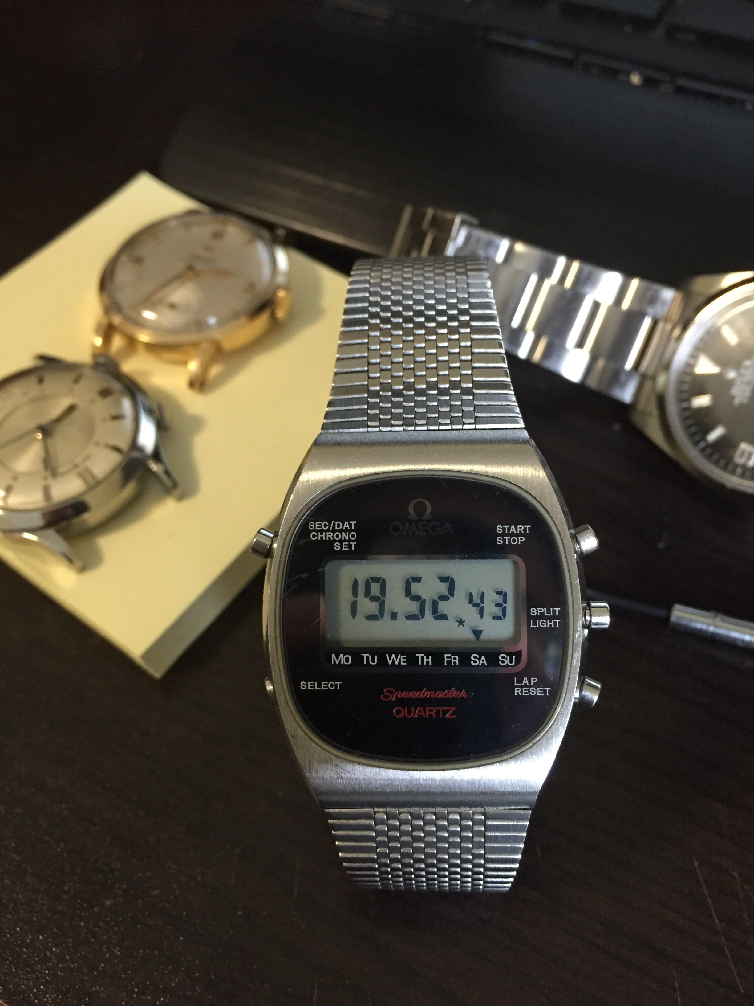

    And now it's back on after I didn't touch anything...:confused:

    ...maybe it doesn't want a leather strap...

    New battery? Dodgy circuit? it could be a woman...they are temperamental :cautious:

    It's a contact issue, common with the 1620, take the case back off using a case back knife (press on) and give it a blast of compressed air then pop the movement out (drop in with no screws) and clean the contact with a cotton bud, usually does the trick
    I've got a few of these (great watches although the build quality leaves a little to be desired)
    Hope it helps, PM me if not
