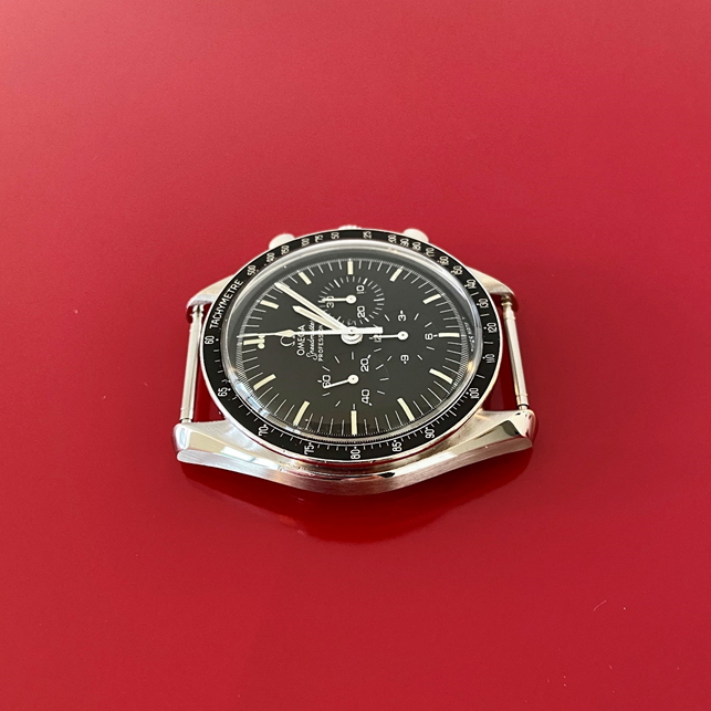

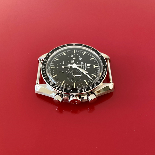

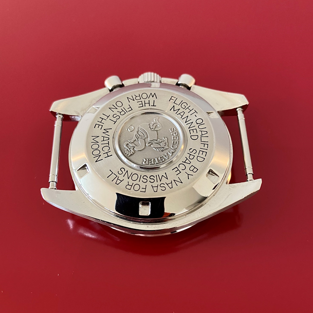

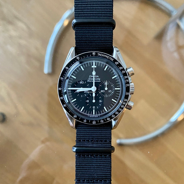

Dear forum members,
after reading through some posts on the several versions of the Moonwatch, I started to look for a watch made in 1983 (my birth year) so if I'm correct it should be a 145.0022.
I expected it would take ages before finding one but I may have met one just yesterday night.
Here we go with some pics and details:

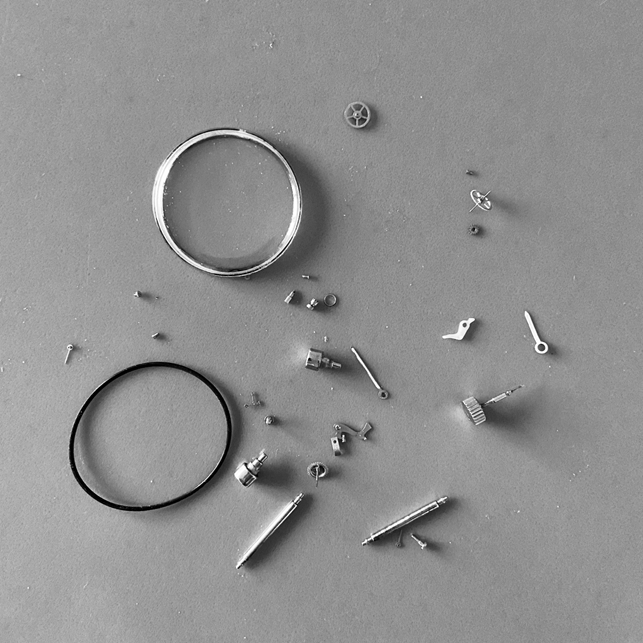

The watch has been fully serviced this last January by Omega and these were the parts replaced:
The owner showed me the purchasing receipt dated March 1983, however the serial number is 4558XXXX which I understand from tables online that refers to 1984.
Movement is confirmed to be the 1861.
Price Tag is of eur 4,000.
Two questions if I may ask your advice:
1. When it comes to the production date, is this as close as I can get to a 1983 speedmaster? Can you ever be 100% sure of the production date without having an extract from the archive?
2. Do you think it is worth the money considering the degree of authenticity and condition or I should steer clear from this generation and look instead for a 145.022 or a completely new one (of course it would mean to forget about the birth year thing)?
Thank you and kind regards
Elias

Looks like a very nice 145.0022
It would be nicer to have better quality photos.
Bezel looks correct to me.
Dial as well.
Caseback too.
I would not bet on the result of Ilovemyspeedmaster table. It is not 100% accurate.
I would take it to a shop, Open it, take the serial number and wait around 2-3 weeks for the extract of archives form Omega. It cost 120 Euros if im not mistaken.
The only big doubt for me is that the seller is showing you this Pictogram card which did not exist back in 1983. So as mentioned above the watch might be correct in all aspects but 100% sure that Card does not belong to the watch unless the movement was replaced.
From the quality of the photos the case seems good and some nice patina in one of the angle photos.
