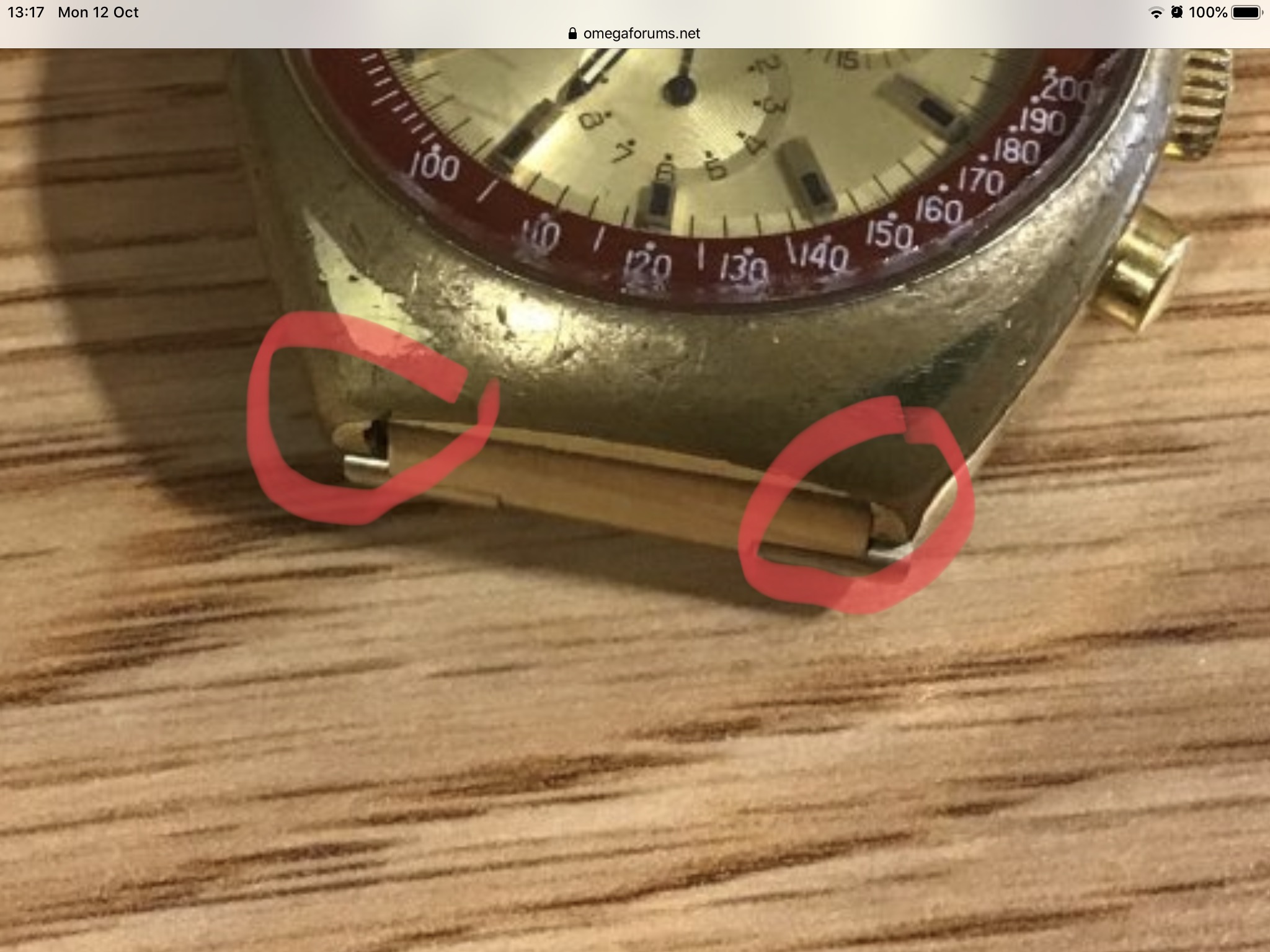

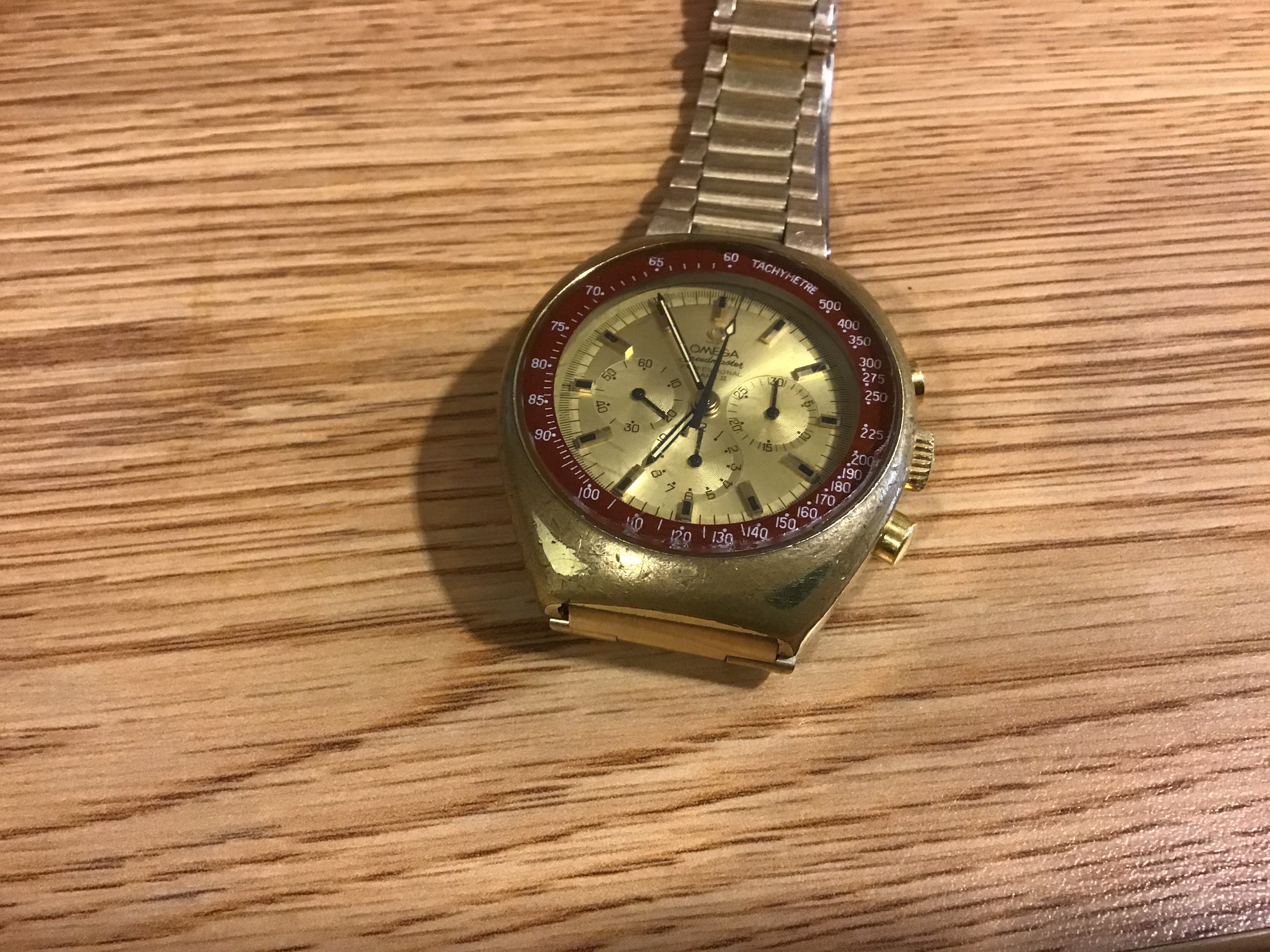

Hello,
I’ve just come across my fathers old Speedmaster and am wondering if there is a realistic chance of refurbishing the case to the original starburst finish.
As you can see it’s pretty beaten up an I wouldn’t wear it unless I could return it to near its former show room glory. Obviously the watch isn’t that valuable so I would like any work to be economical.
thanks in advance.

I think that may be just too far gone. Not only is it like a bar of soap, but it is gold plated so you have in essence 2 major problems, how to put material back, recut the original profile and then reinstate the sunburst finish. Then you need to replate the result.
4,593
10,813
I love it as it sits. The work you're looking for could be done but it needs to go to a place that specializes in Omega case restoration, and then replated afterwards. That isn't going to come cheap. If you're going to refuse to use the watch unless it's mint, and expect an economical restoration, then you're better off either putting it away or selling it and put the money into something new.

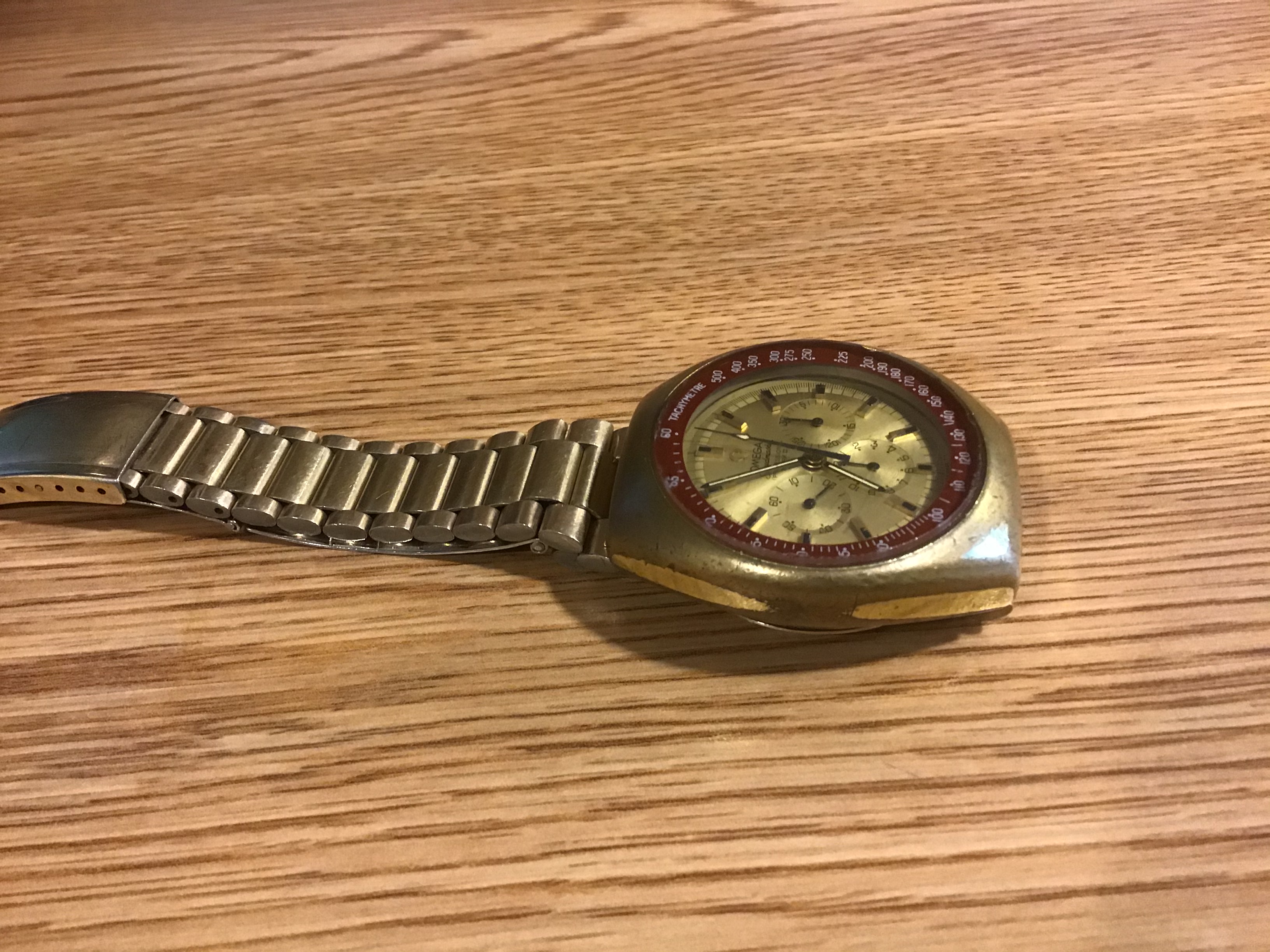

Thanks for your replies. If refinishing it to its original finish is a non starter what would you recommend? I don't want to wear a watch that is badly scratched but I suppose I can't polish it because of the gold plate. I believe I can get a new crystal and tachymetre for approximately £120 and I would like to fit an Omega leather strap but I can't find the original spec ( the official Omega site states it was originally supplied with a leather strap). What sort of price would I be looking at to tidy the case up, and what are the do and don'ts of cleaning it up with out losing any value?

At this point maybe you should define the term "economical" you used to describe the amount you are willing to spend on the restoration. What is the dollar figure you were thinking of?

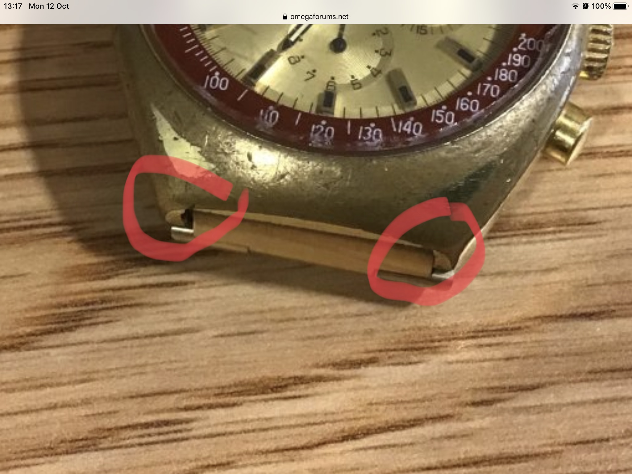

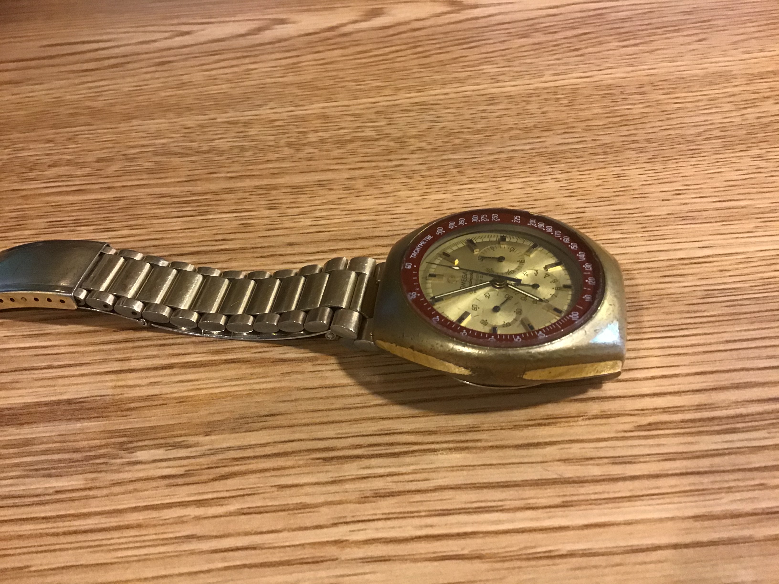

I think that case is too far gone - its been polished to buggery
there seems to be almost no metal left on the lugs at all at the 6 o’clock end, and i suspect the 12 o’c end wont be much better
a new case might be the way to go here, on a new leather strap (Just save the original bracelet, but you can see that its a different colour now to the watch, so it too is well worn)

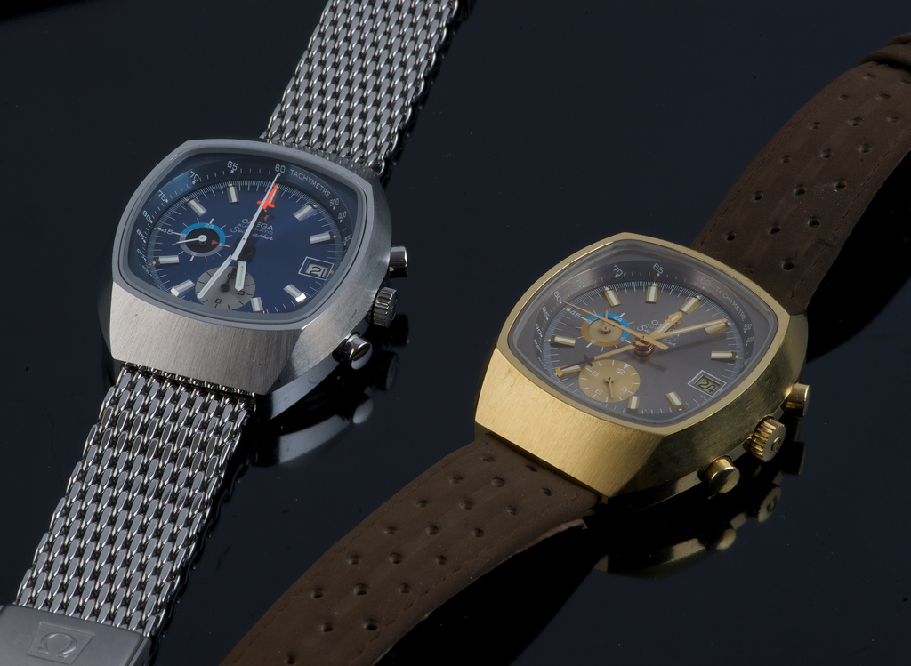

Ps - gold plated cases get a bad rub, but when new they looked spectacular
please see picture borrowed from internet (from Dogen’s World class Omega collection) - these are not Mark IIs, but the case is closely related

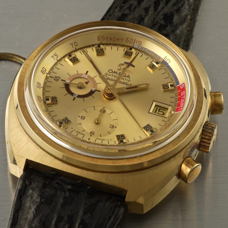

Ouch, it hurts to see this case. Same as the others: it is too far gone to be able to save the case at a reasonable cost 🙁
What surprises me is that @Sherbie said, it looks like there is barely no metal left on the lugs. Now, to reach that amount of damage, their should be no gold plating left. Why polish it that badly while taking care of replating it?
Either it is a rare solid-gold "BA" version (unlikely - and it would be even more a shame...), or, the pictures are misleading us and all hope is not lost

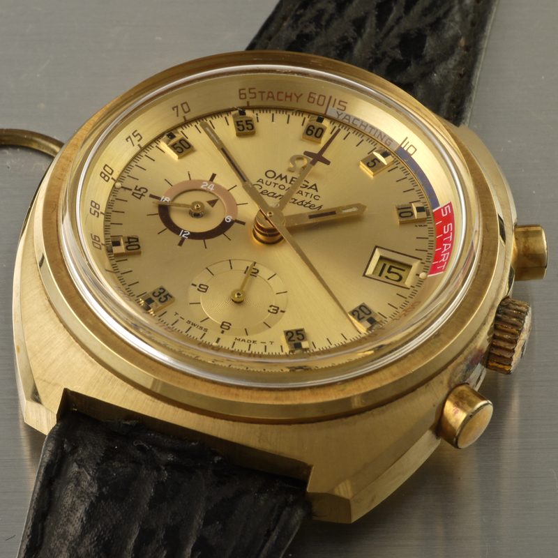

edit: you have to show a Seamaster Yachting when taking about gold plated watch!
(from: https://www.timeline.watch/watch/1973-omega-ssemaster-yatching-ref-176-0010)

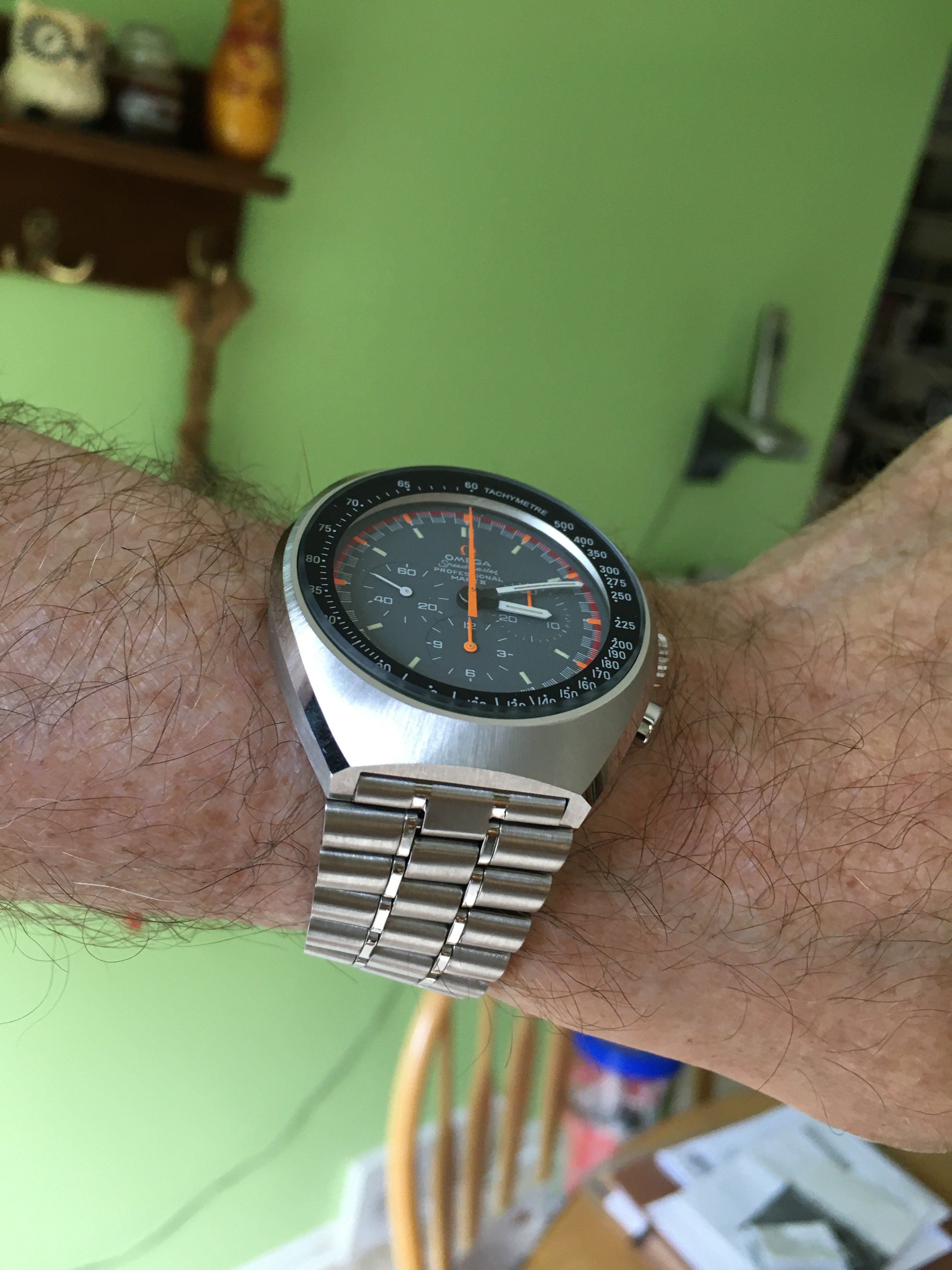

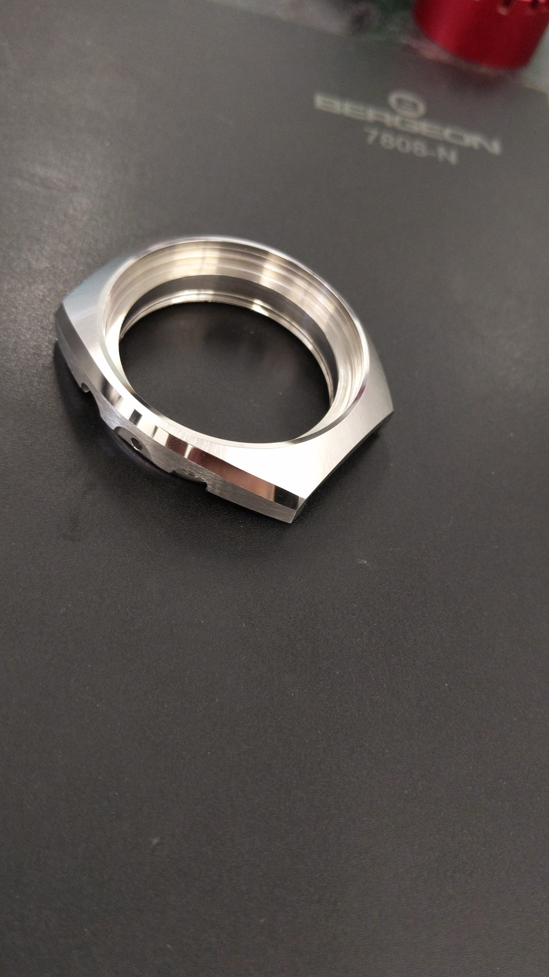

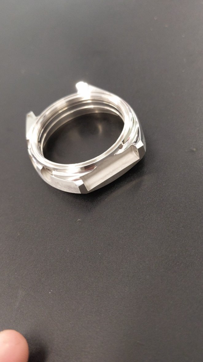

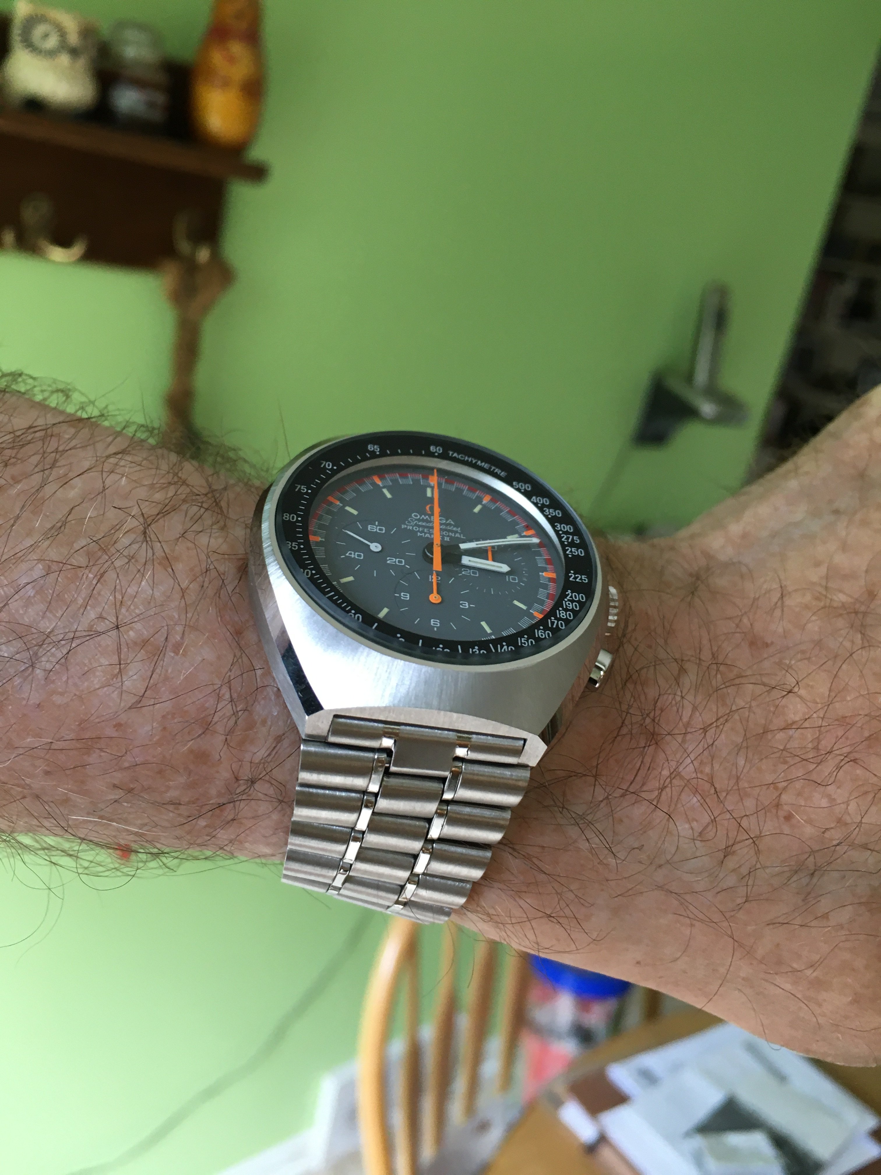

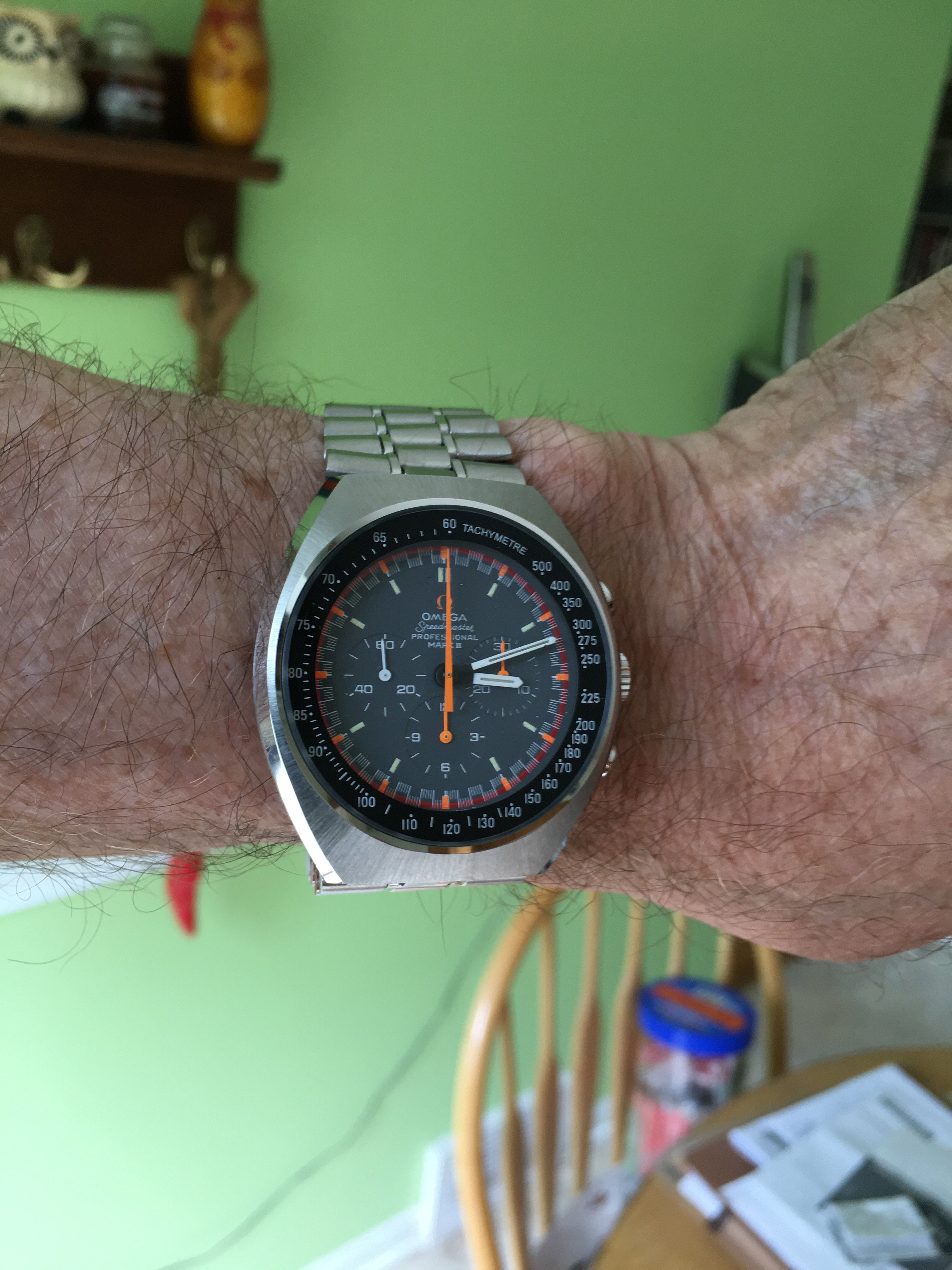

Assuming you're looking at a stainless steel case there are people that can laser weld material back on.
I had that done to my vintage racing MarkII earlier this year by Tanner Morehouse of tmwatchco.com. SWTC ground the hell out of the case during a service in the 90s and I never wore it much afterwards. Tanner specializes in restoring these particular cases. Regarding the p!ating, you're on your own.
I'll post some pictures in a minute when I can get to the correct device.
Good Luck whichever way you go.

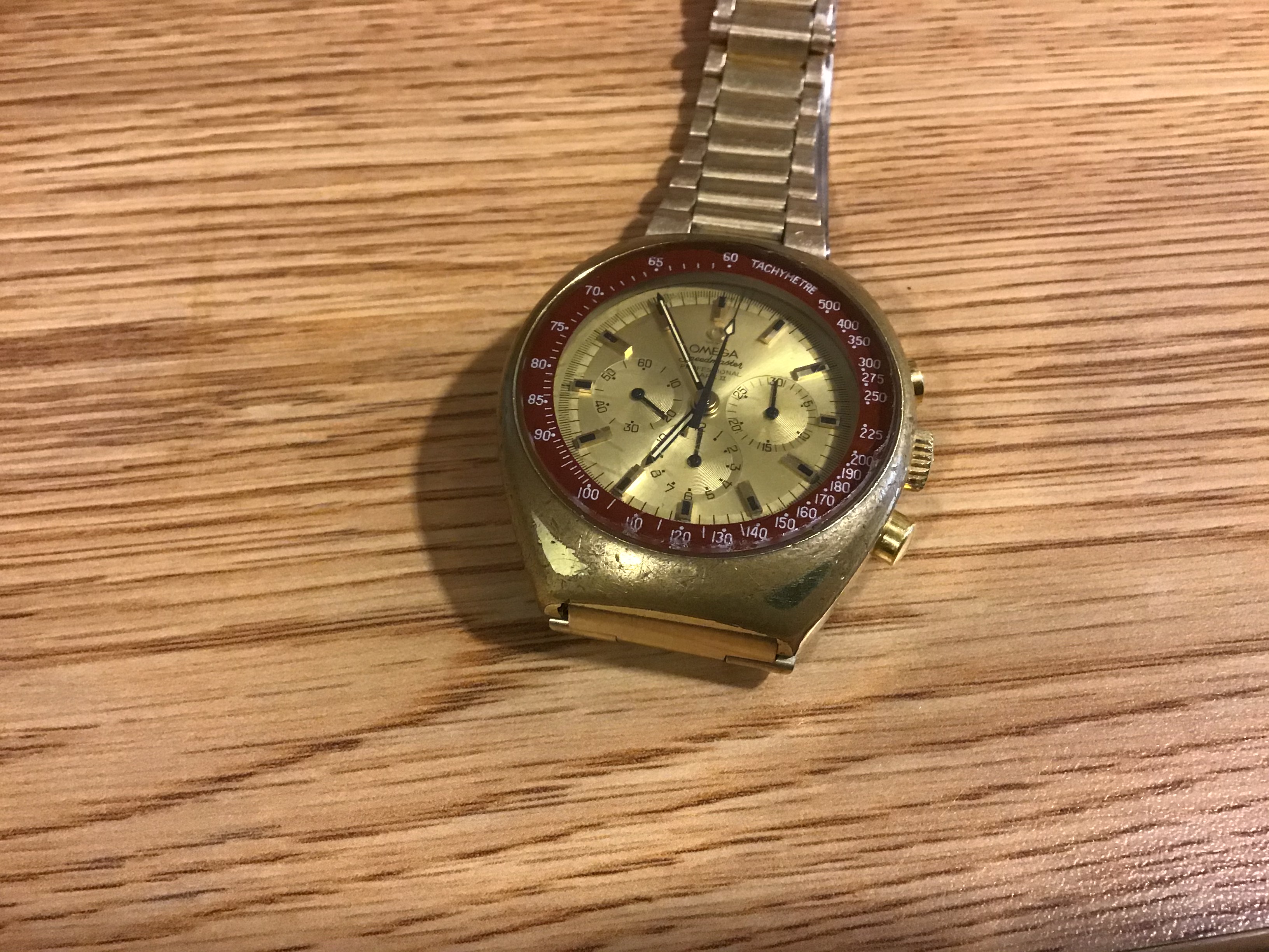

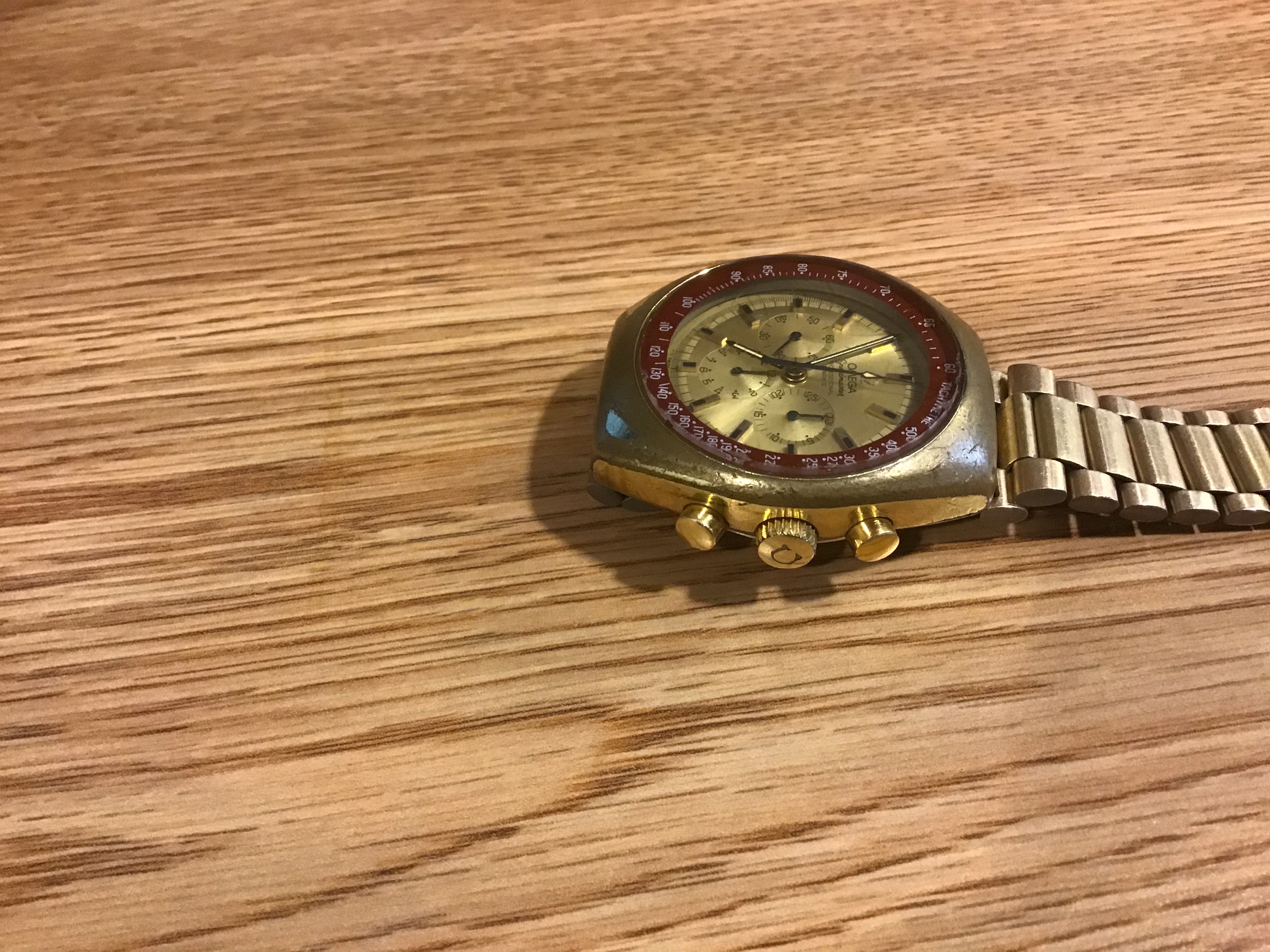

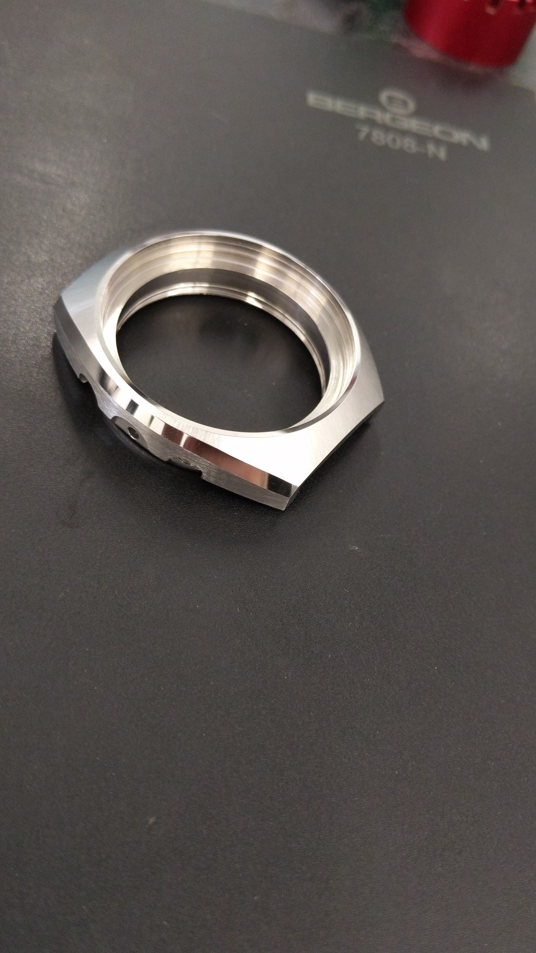

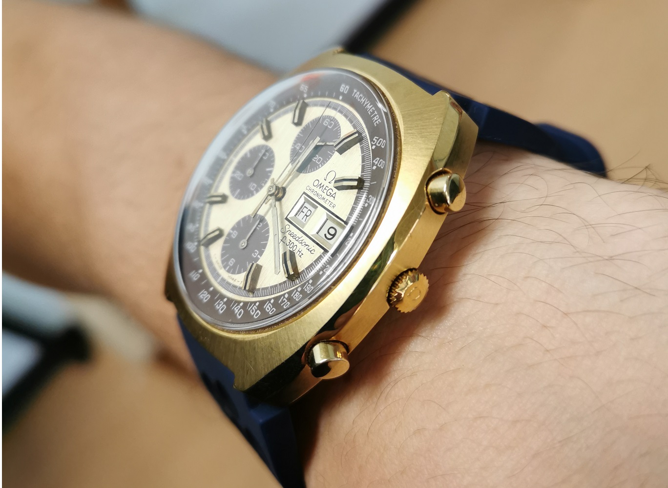

I would send it to Re-Plate it in Canada. https://www.replateit.com/
They have done about 20 cases for me at very good cost.
This cost me roughly $150 CAD to replate.
They filled the holes, restored the profiles. They know all the old omega profiles. They do a remarkable job. Especially if you pay extra for repair rather than just a strip/brush/plate.
Gold plated cases are not salvageable at home. Despite what people tell you, a well refinished one is still worth money. If it is the difference between wearing and not wearing, I know what I would do. Especially if it is a heirloom.
Their work is so good that you can still read 20 Micron O.R in between the lower lugs.
My case was in worse condition than yours. I had to source new pushers and crown from ebay, but you could get the old ones replated.
I have more photos if you wanted to see.

V nice indeed. Can we see a before picture? I am finding hit hard to visualise how it could be worse than the OP watch originally.
1,344
1,971
The OP's case does look slightly beyond repair. The GP cases are brass, so where the gold has gone it is still yellow in colour. It really is a bar of soap judging by those pictures
