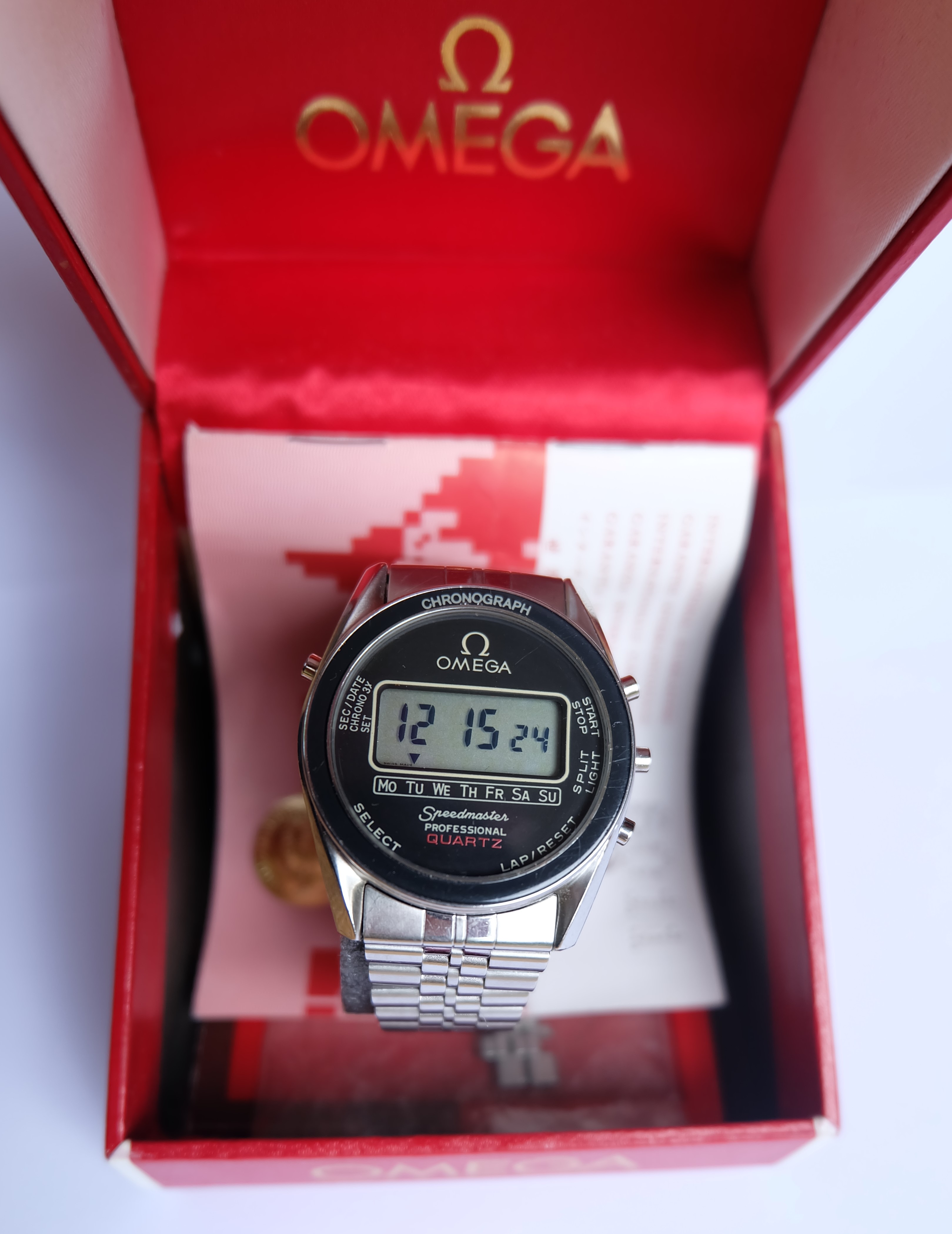

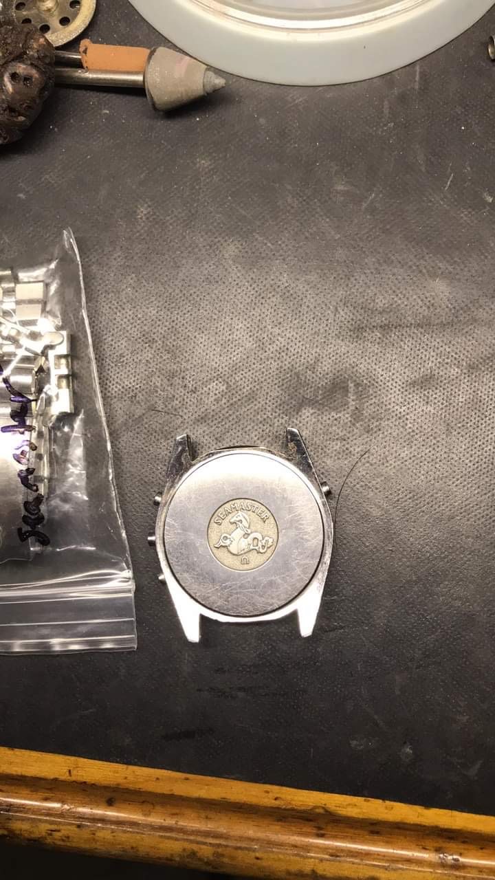

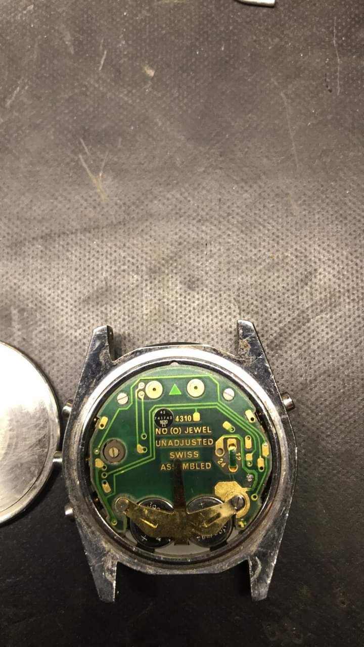

For those of you who have looked at my other thread in regards to the Seamaster I also picked this watch up and dropped it off with Tanner as well. I am not quite sure what to do with this one yet as I have never been a LCD guy. I am having Tanner give it a good cleaning and make sure everything is in order. It came with the original bracelet which is nice.
I have read a few pages in reference to this model and found it all to be really interesting. Does anyone have any additional info on them that I may have missed while cruising the net? Are they wanted models or just kinda cast to the side being a quartz speedmaster? I think it is pretty neat given the history of the model. I am curious if parts can be found if needed down the road or even if Tanner finds something that needs replaced during his cleaning/testing.
Thanks in advance!

Mine has a few pixels missing on some of the LCD digits and it runs a bit slow (around 15 seconds) My local watchmaker said that it is usually due to the way the quartz was mounted and is quite common after so many years.
I wasn't aware that Omega still service them and that might be an option then.

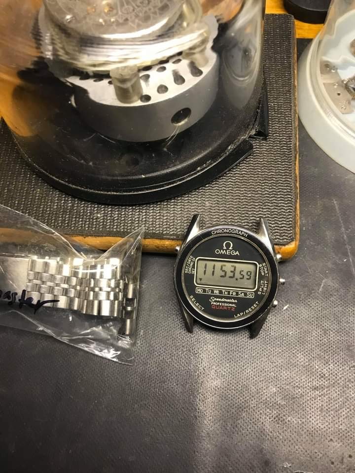

Well, Tanner fit the bracelet to the watch today and while the bracelet is correct the end links seem not to be. Are the 741 end links correct for the watch? And if so, any leads to finding a pair or at least a suitable replacement?

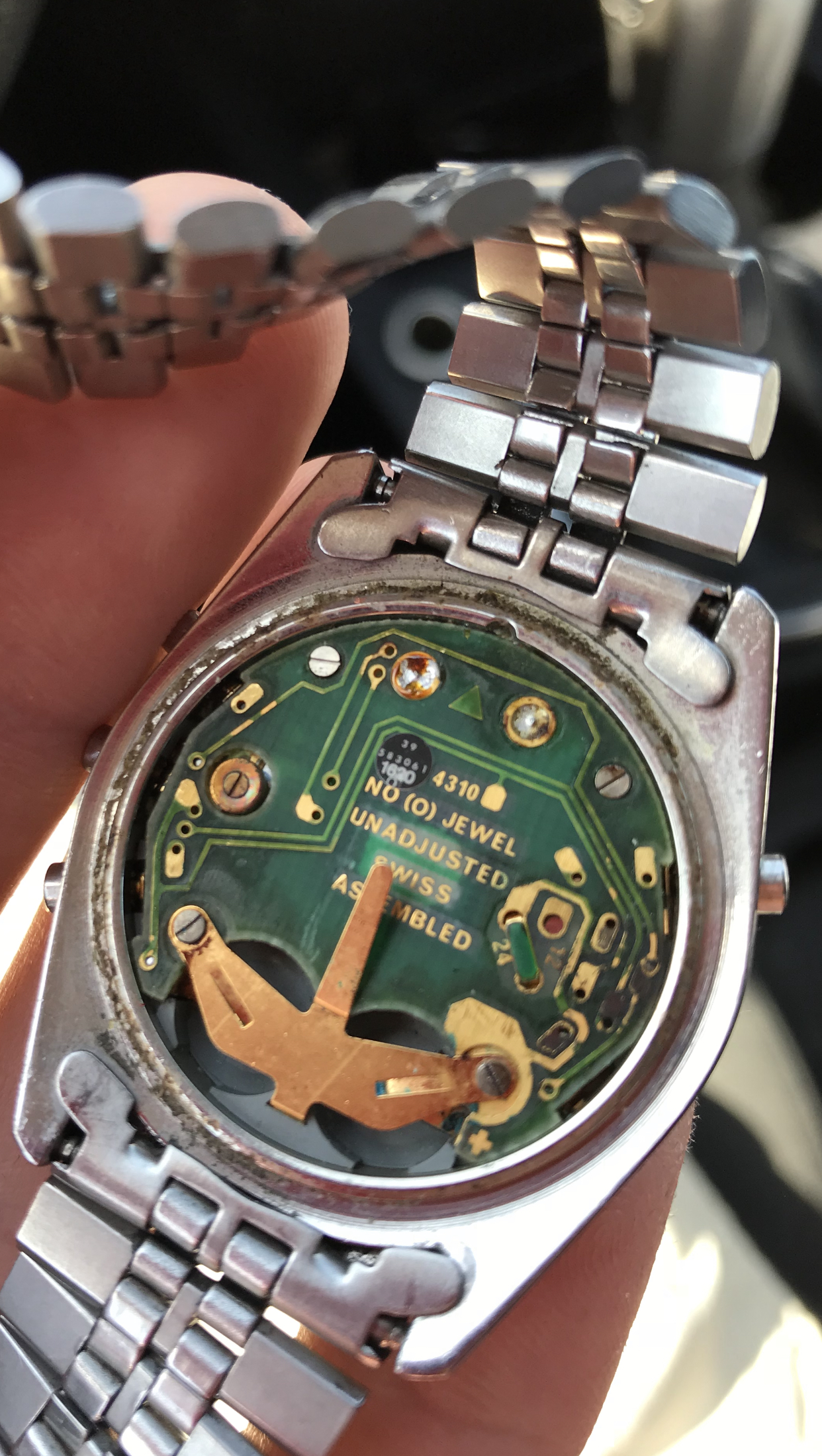

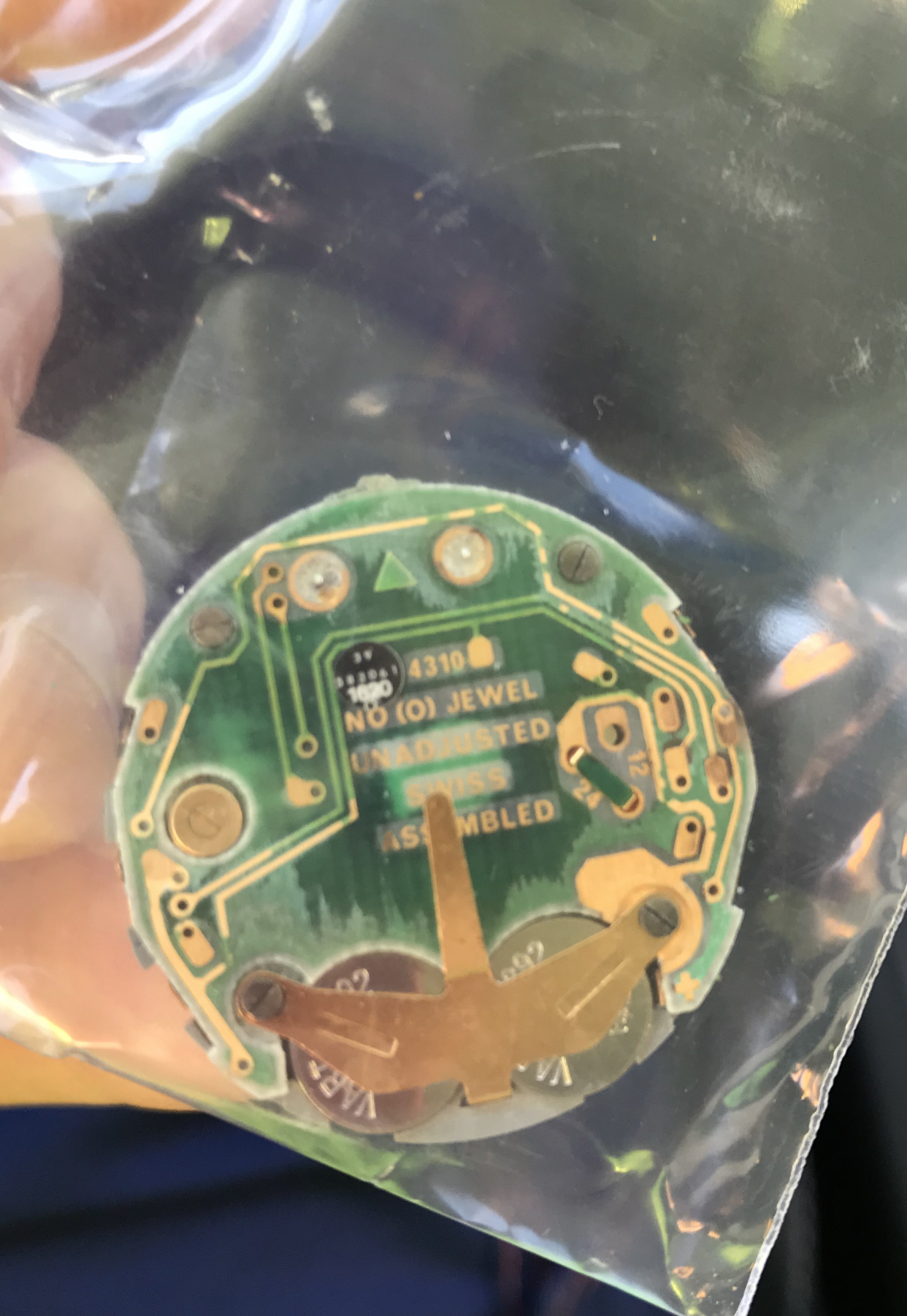

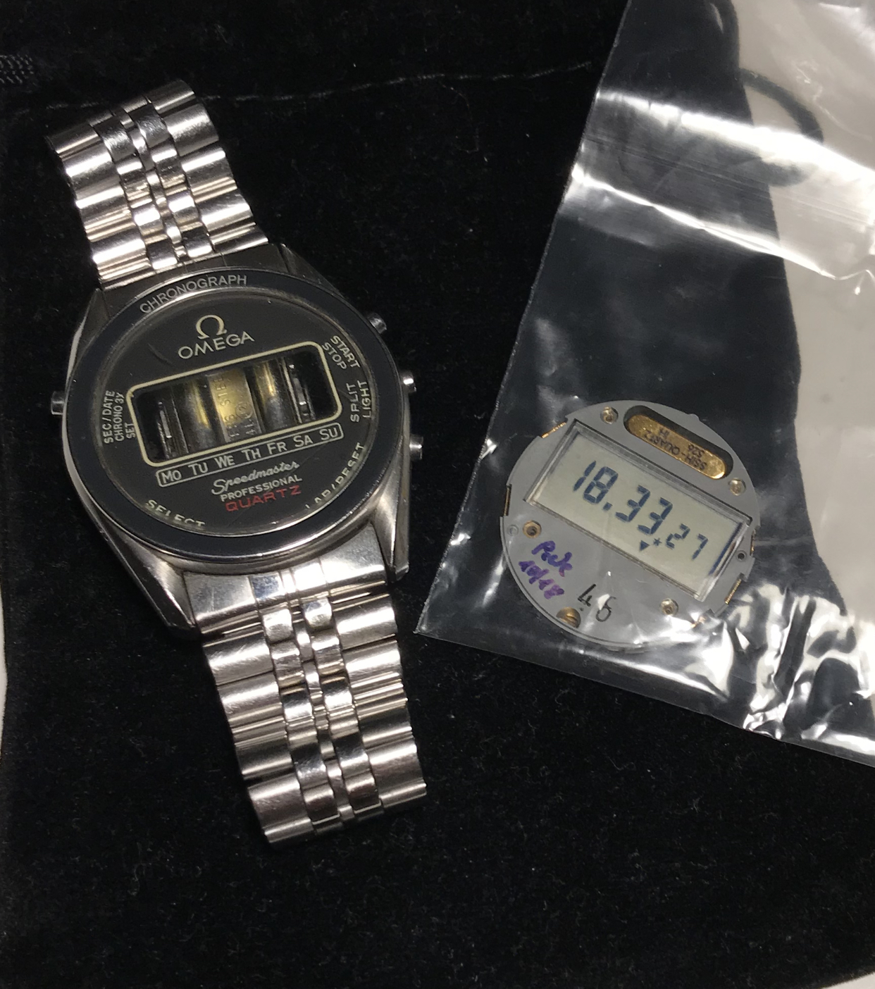

I Just had this one repaired by him:
147
1,273
And here is my contribution to show how good he is. The first picture shows how the module looked before repair. The module was completely dead due to battery leakage. Ill provide some pictures after repair as well. The circuit looks a little matte as it had to be cleaned from acid remains. Has worked as a charm since two years back.

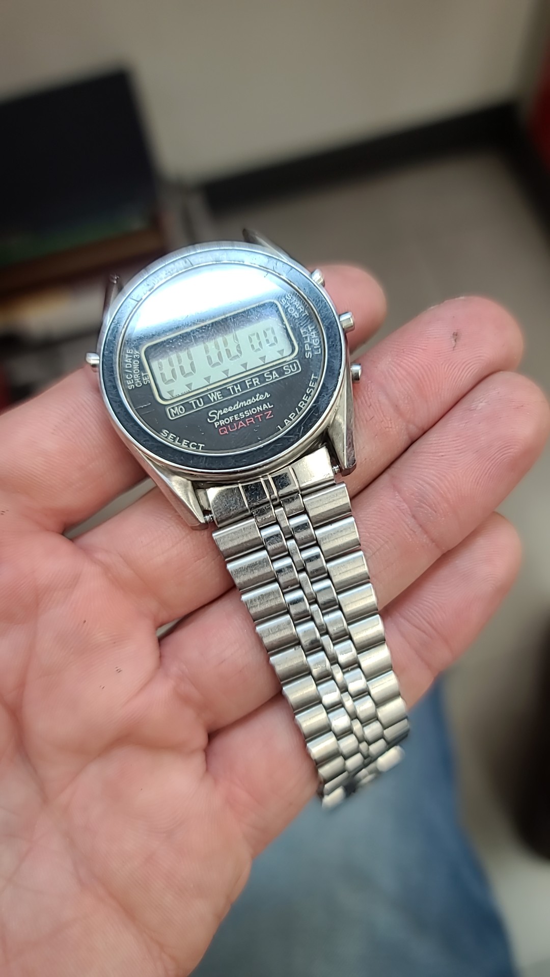

I was trying to make sure the 741 links are the correct ones I need to source, I’m waiting for a reply to see what’s on there now but, as I said, they aren’t correct. Here is a photo of what the end links that came on the bracelet look like fitted.
4,106
16,321
They are correct but they’ve been filed to death 😵‍💫
