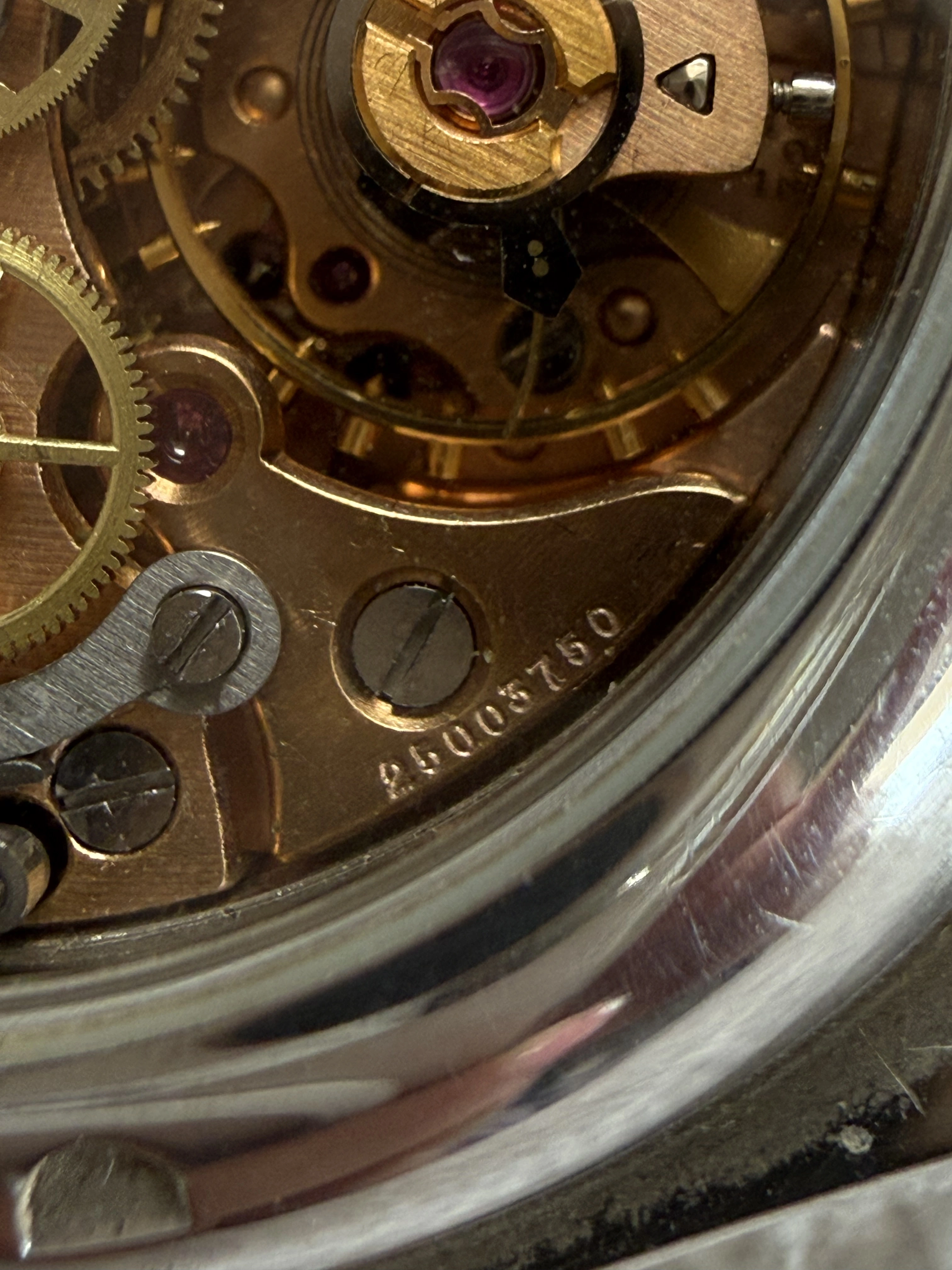

I’m checking out details of my late spouse’s Omega. He enjoyed collecting and learning about the watches, especially the moonwatch connection.

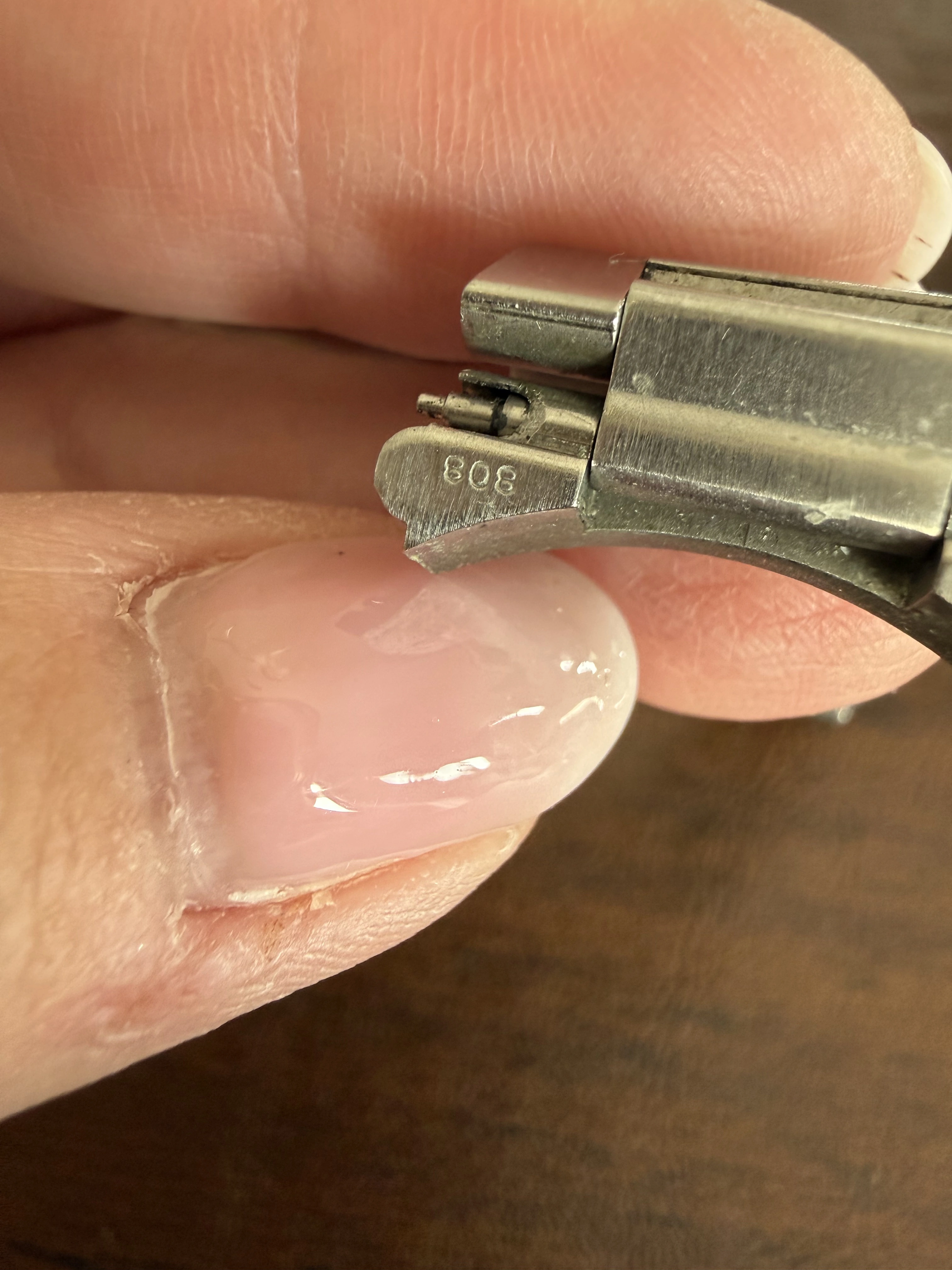

S/N 25003750 cal 861, bracelet holy grail coffin 1450-808, case 145.014. Is this considered a Moonwatch? Thinking of selling, perhaps through Graizlee. Thank you.

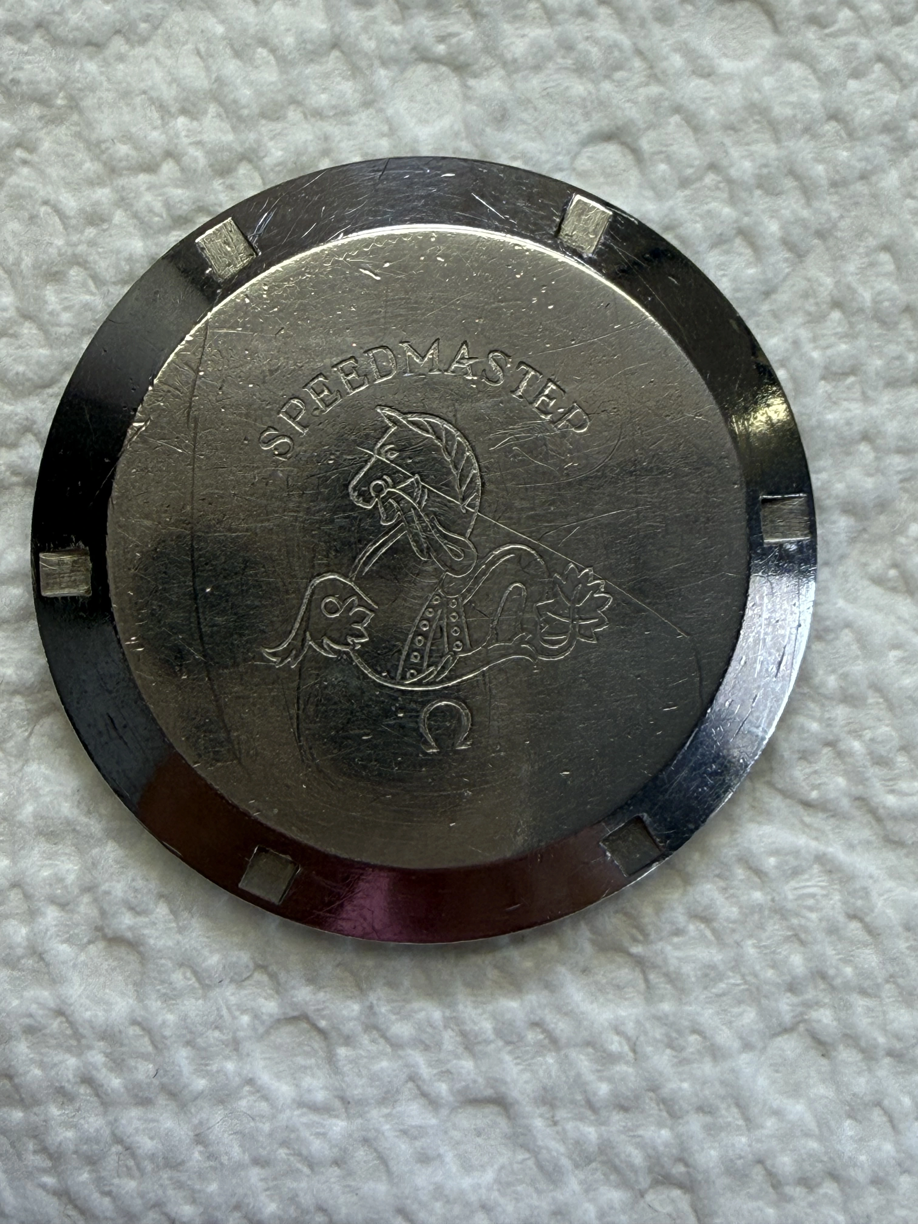

My only comment is that the caseback is wrong for the watch which is a "Moonwatch", it's for a MKII model (not a Moonwatch).
I notice your Speedie has an aftermarket see-through caseback, so maybe he got casebacks mixed up when the see-through was installed.

I agree the solid case back is not what this watch originally came with. The 145.014 is a different watch.
Some parts of this watch, like the dial, appear to be from an early Moonwatch and this has a 321 movement. These can be very collectible if they have their correct original parts but it appears this watch has replacement parts.

Thank you for your condolences, it’s been over 6 years and I’m ready to let it go. Thank you for the info on the caseback. I remember he was trying so hard not to create a frankenwatch so he must’ve thought it was correct. I’ll keep looking for more replies.

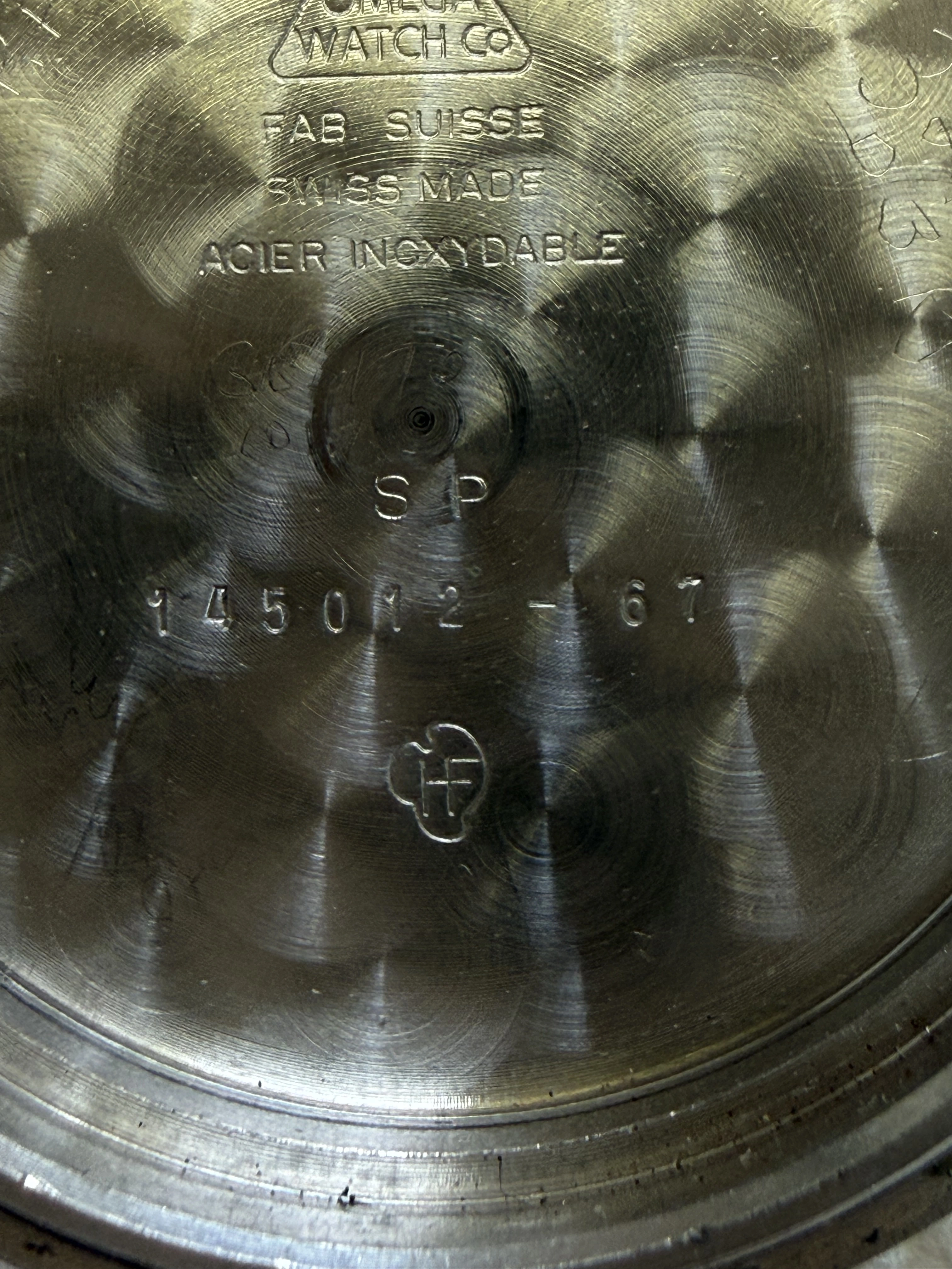

Since no one else has mentioned it, the hour and minutes hands are incorrect for a 145.012-67. They appear to be for a Mark II and have been repainted.
1,073
6,215
OMG, I found it! Caseback 145.012-67. You are a genius!!
That is more likely the right case back for this watch. But noting another members’ comments about the hands, this may have been a project watch that your husband or someone before him was assembling from various parts.
Since you found that other case back, is it right to assume you are dealing with an assortment of loose watch parts in his collection of things?

I do have watch parts. I don’t know why he had the caseback for the Mark II. Perhaps the watch had that back on it when he bought it. I’m thinking he must’ve sought out and bought the correct caseback. He had the clear backs on a couple of watches, he liked seeing the movement. I’m surprised by the post about the hands being incorrect. I have some other hands from his parts box.
