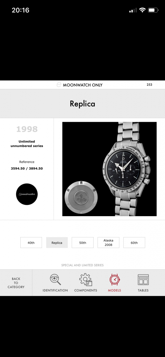

Got a full set of modern broadarrow hands left over from when i made a “replica” of the broadarrow Speedmaster (34940.50, i think) Mine using watchco parts.
I think it was a spare cal 861Speedmaster case and movement i used but can’t actually remember.
Question is, when I’m going to sell these, can i advertise them as fitting both calibres or do I need to try and find out which particular one it was?
correct model i was “making” below
