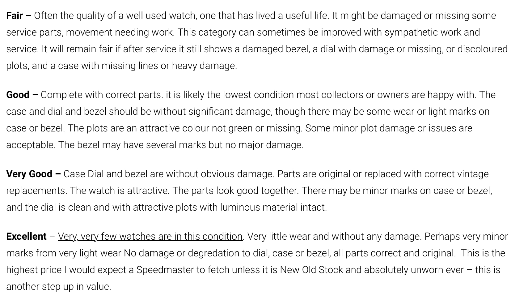

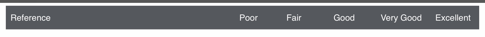

With the recent addition of a new condition category, I’ve been studying pieces and weighing the words of the definitions. 📖 To me, the most difficult ground is between Good and Very Good, particularly when I’m looking at a specific watch. 🤔
Maybe the real issue is how much room between these two labels there really is. How do you place all those pieces that fall in the middle?
https://speedmaster101.com/price-chart-2/
Obviously, despite the objective criteria offered, there’s still room for a lot of opinion.

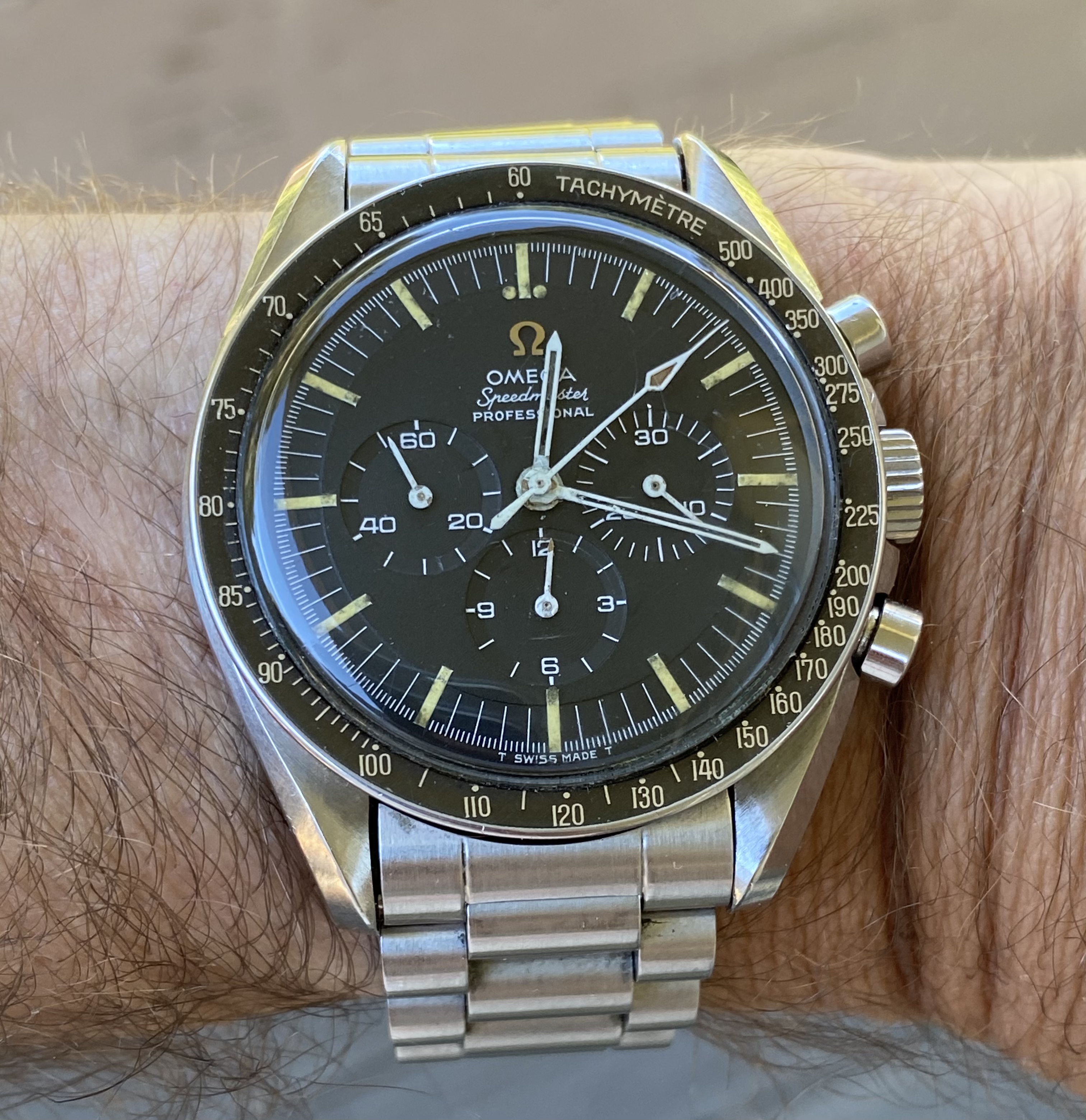

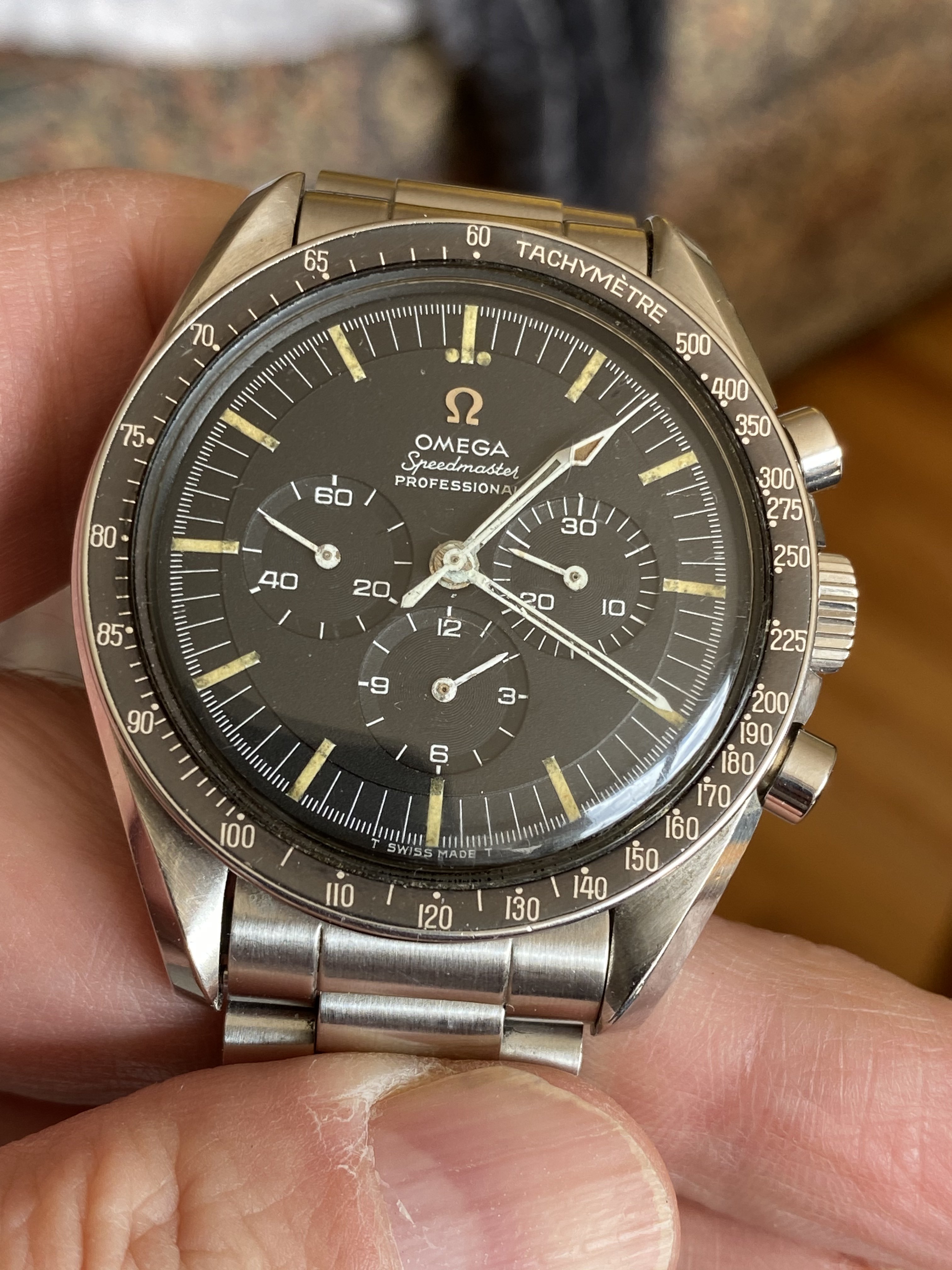

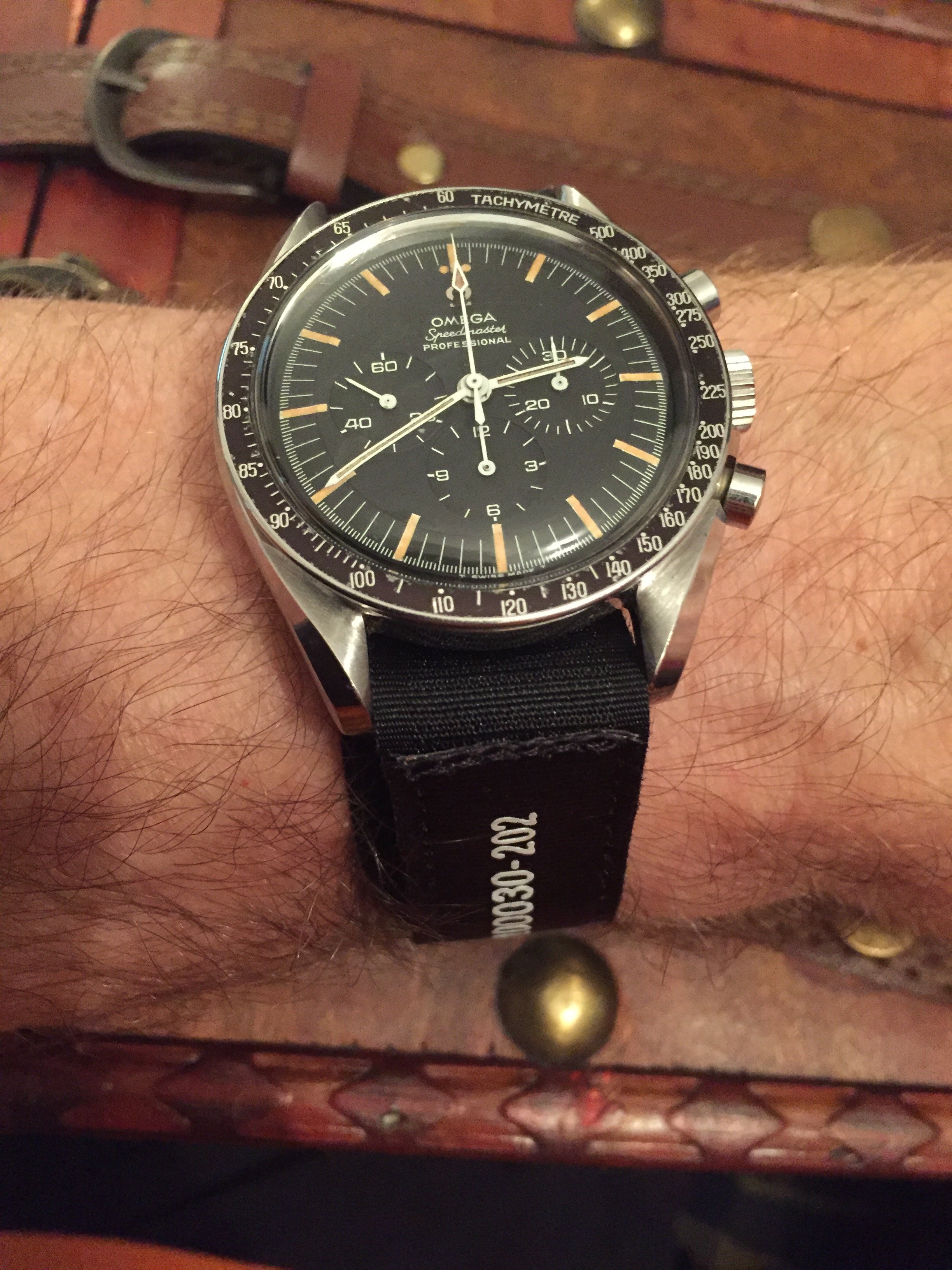

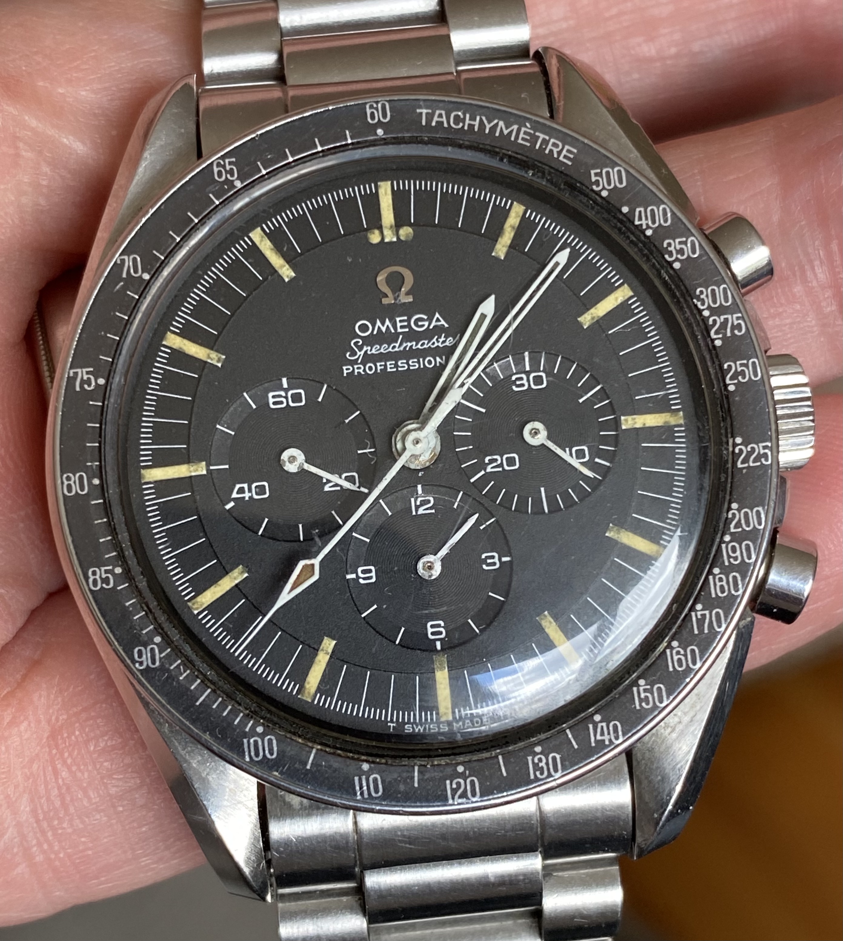

Today’s subject is a 105.012-66 HF that I’ve owned for a couple of years. I’ve had it serviced, but it hasn’t needed any parts and, other than polishing the crystal, it is as I found it. And, no, I’m not looking to sell it - I’m looking to sharpen my skills. (Please ignore the 1480 bracelet I’ve put on it. 😀)

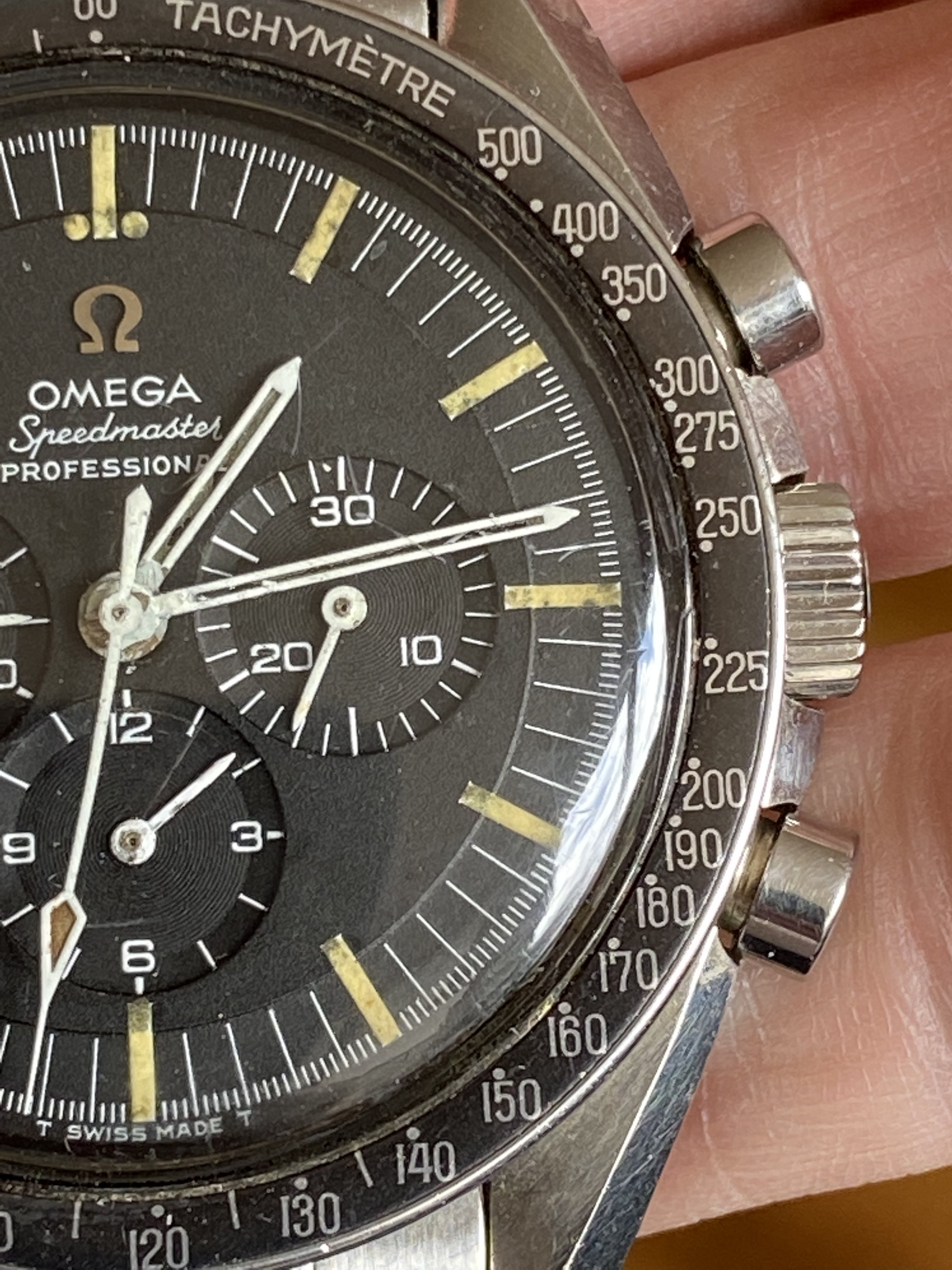

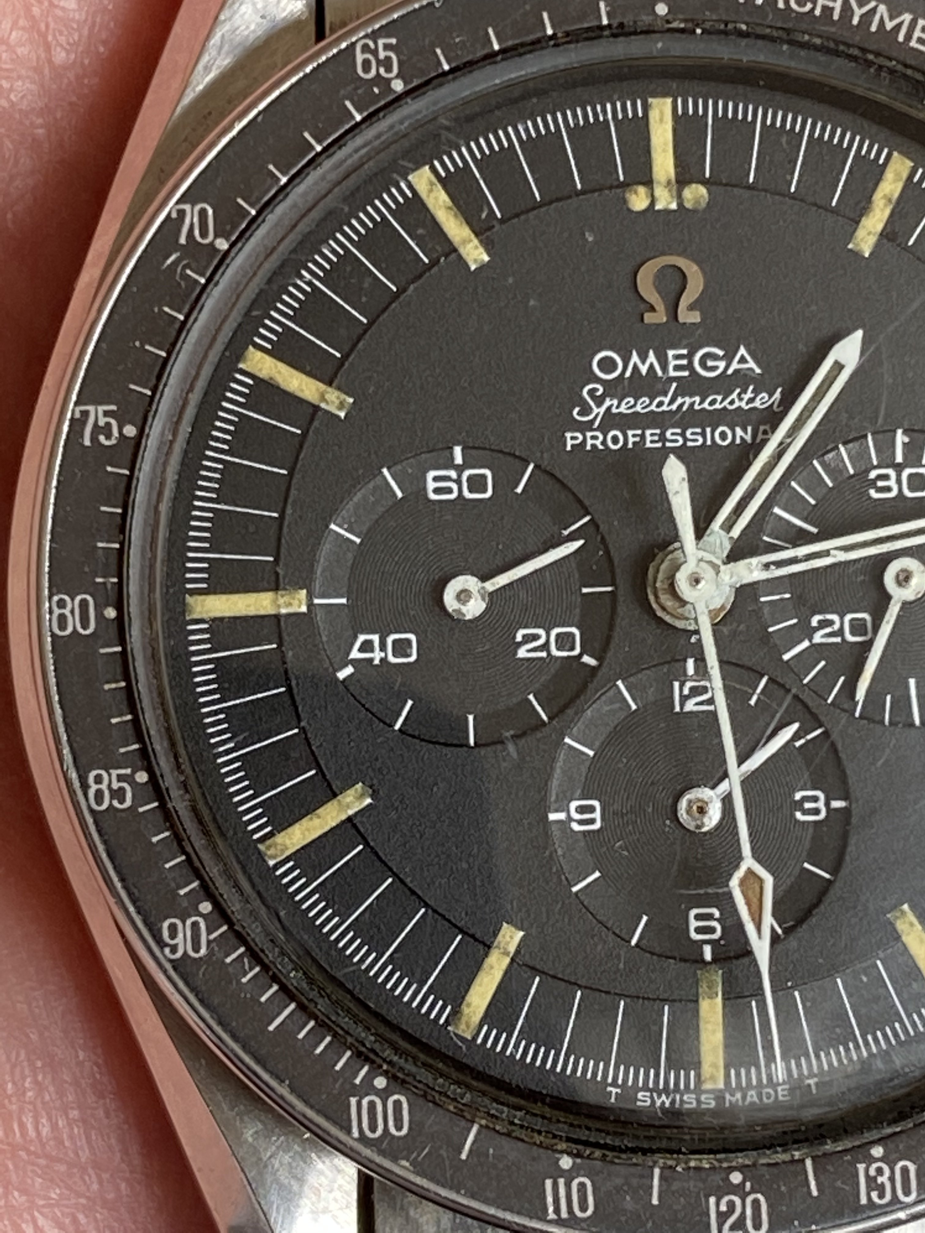

Dial: Correct B3 dial. Other than a small drag mark in the upper right quadrant of the hours subdial, this dial looks pretty clean to me and free of damage (the crystal is flecked with small scratches). Dial lume looks original and complete; it’s sort of attractive. Crystal is, I assume, the original mid 60’s logo for the watch. (Whoo hoo!)

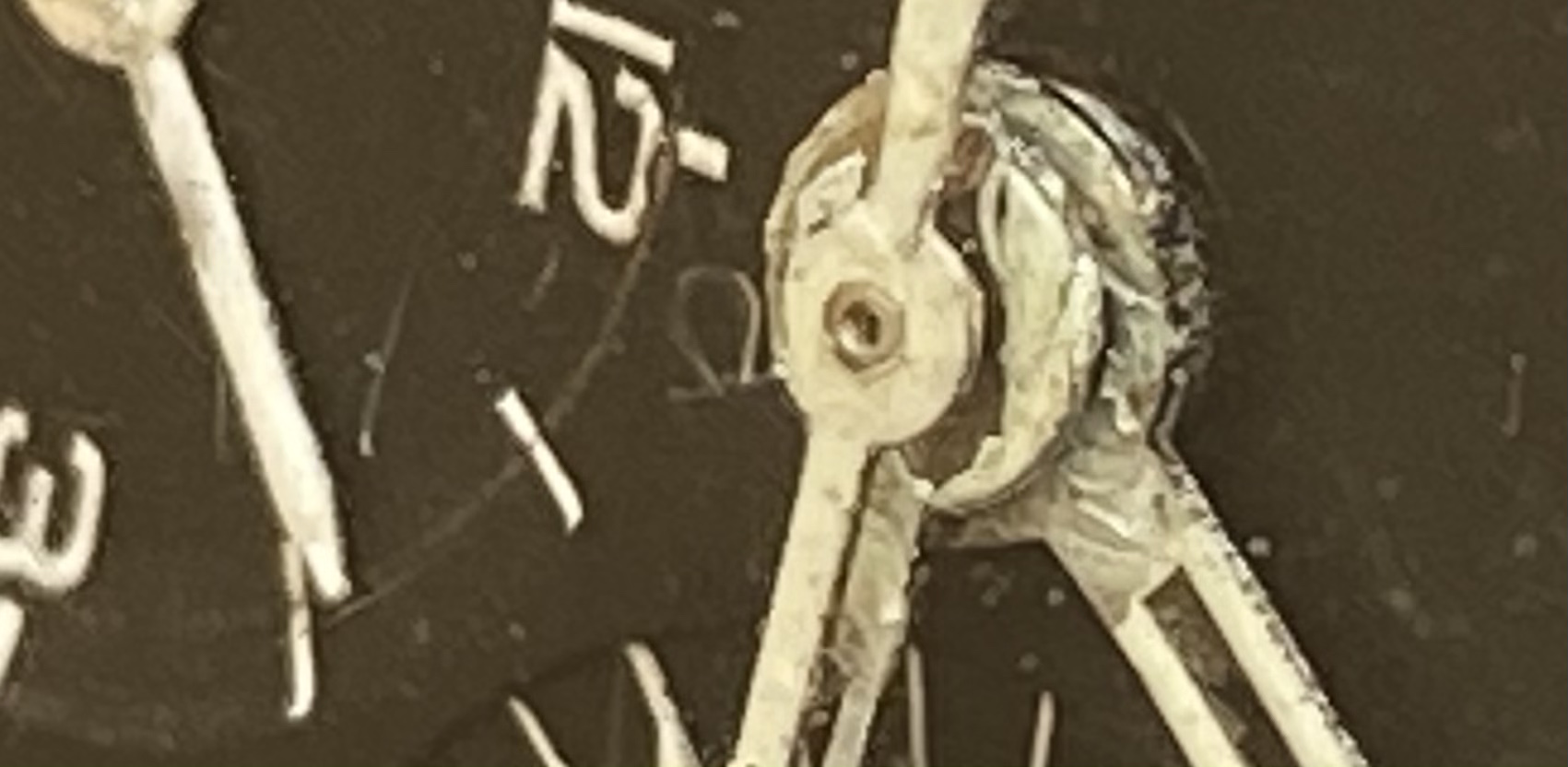

Hands: Correct but battered. Minute hand has lost most of its lume, hour hand some. What’s left matches the chrono second hand.
Bezel: Faded DON without any significant damage.

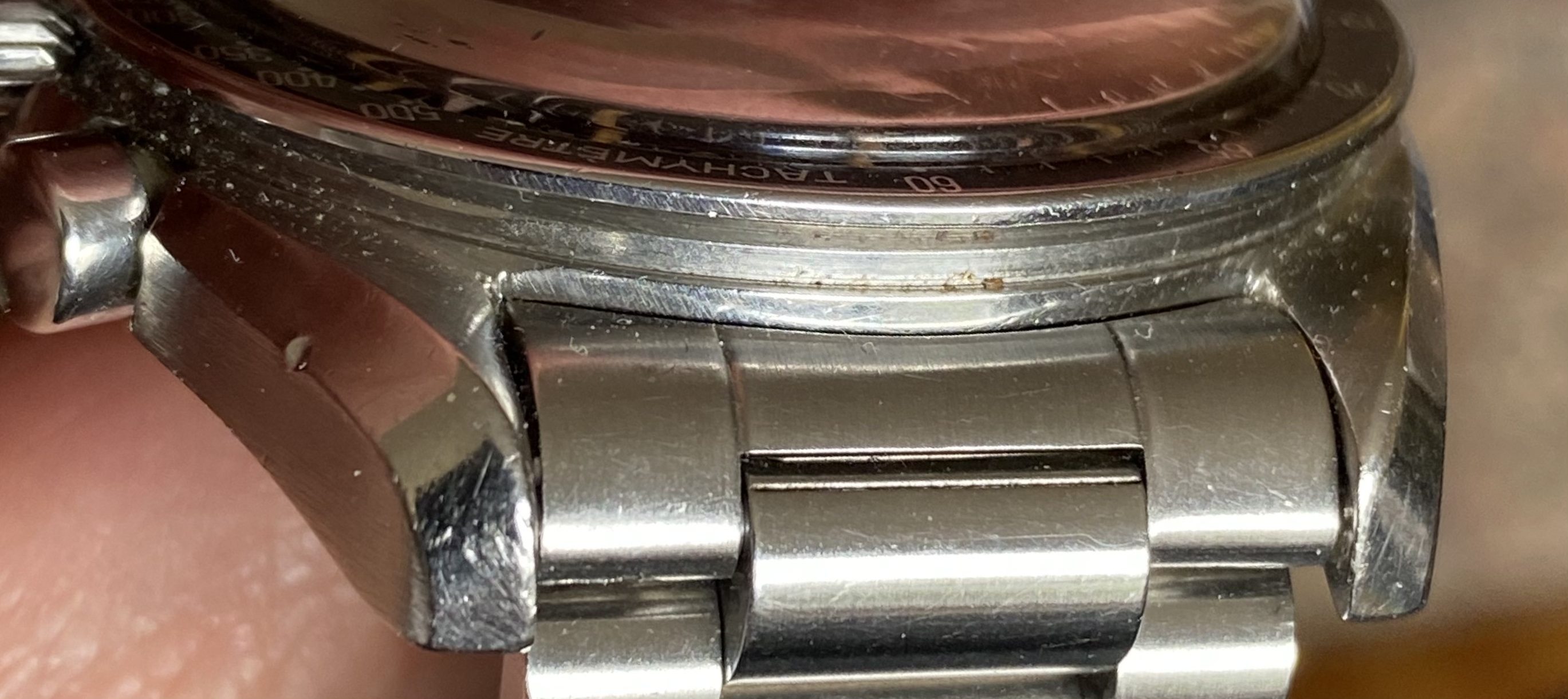

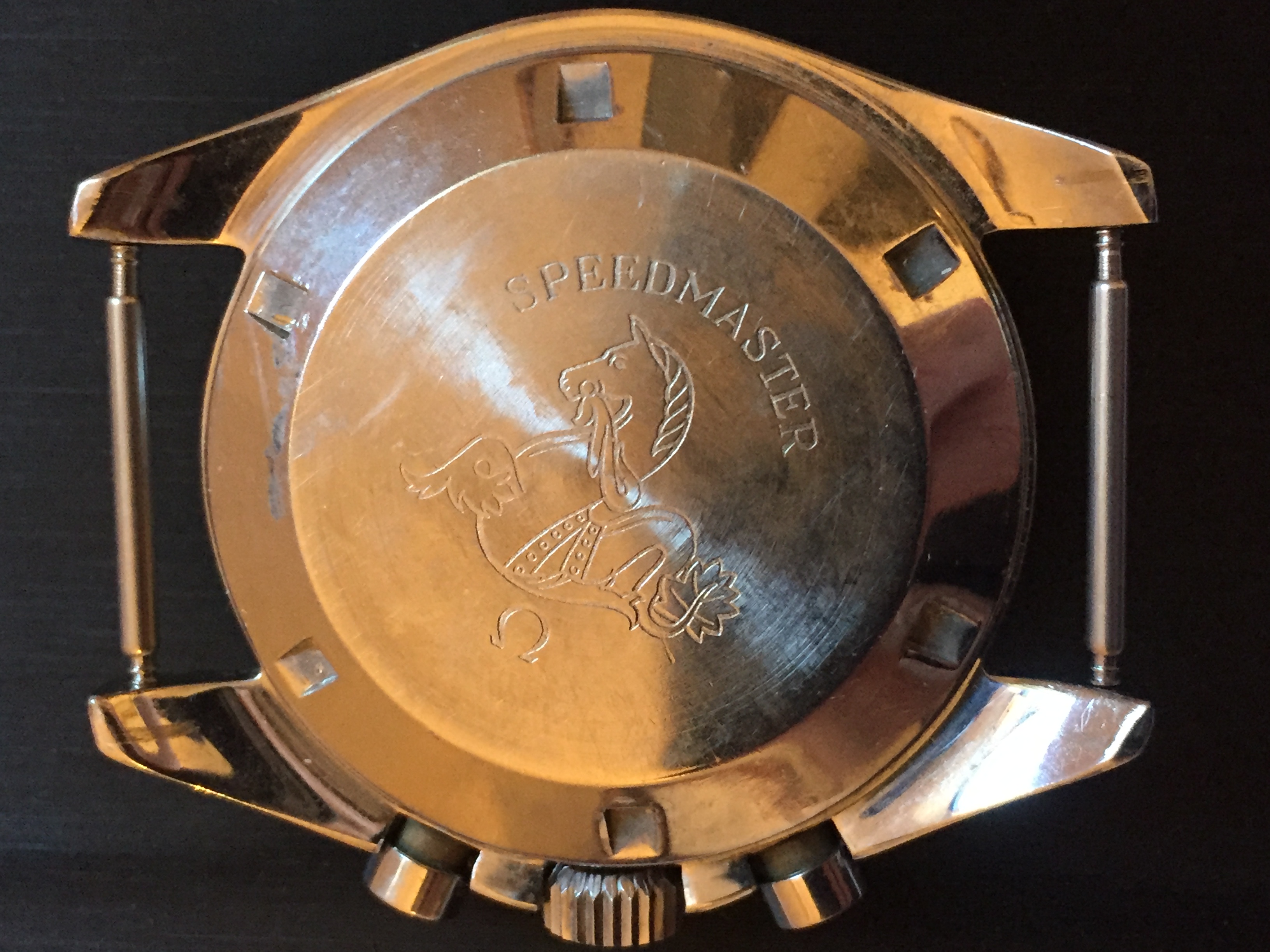

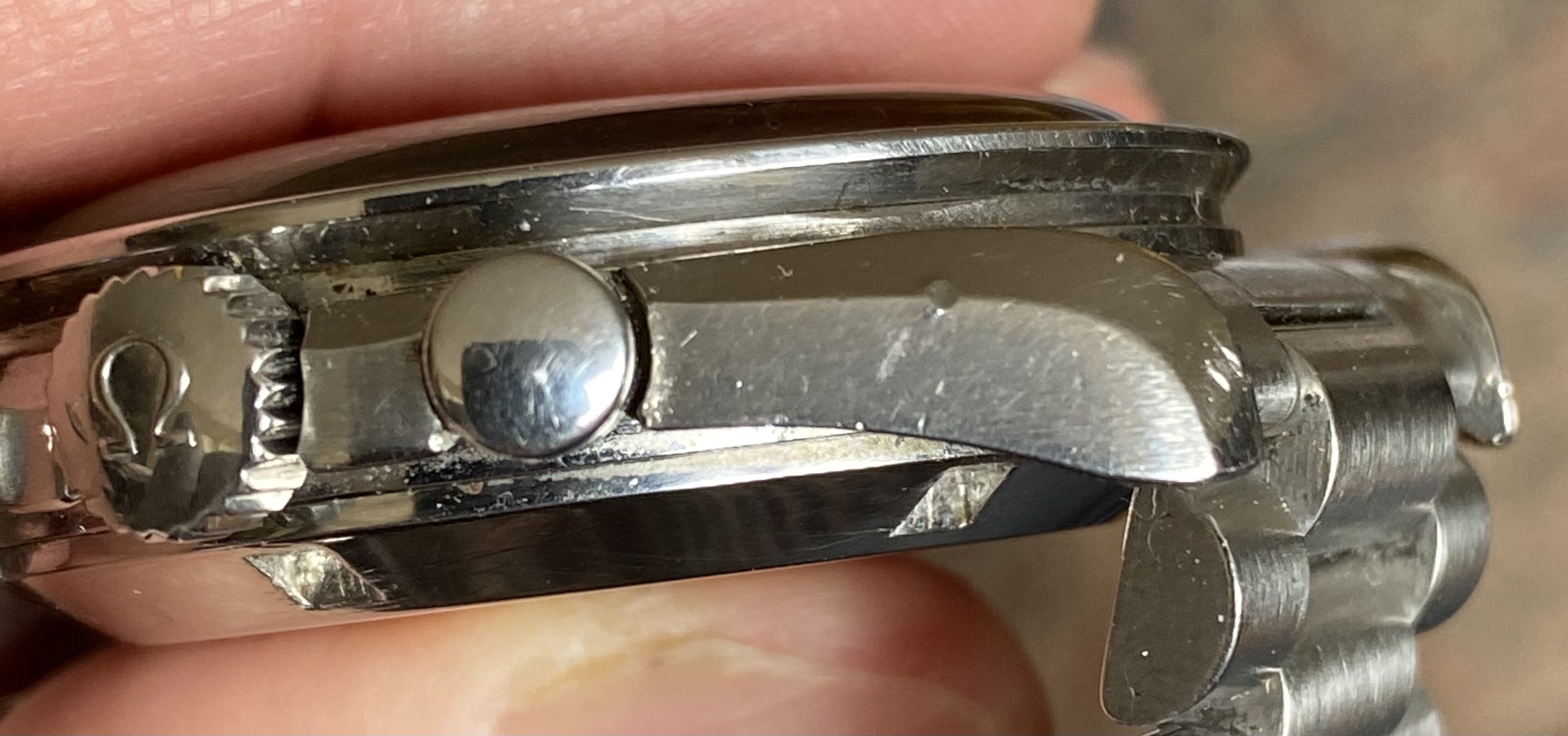

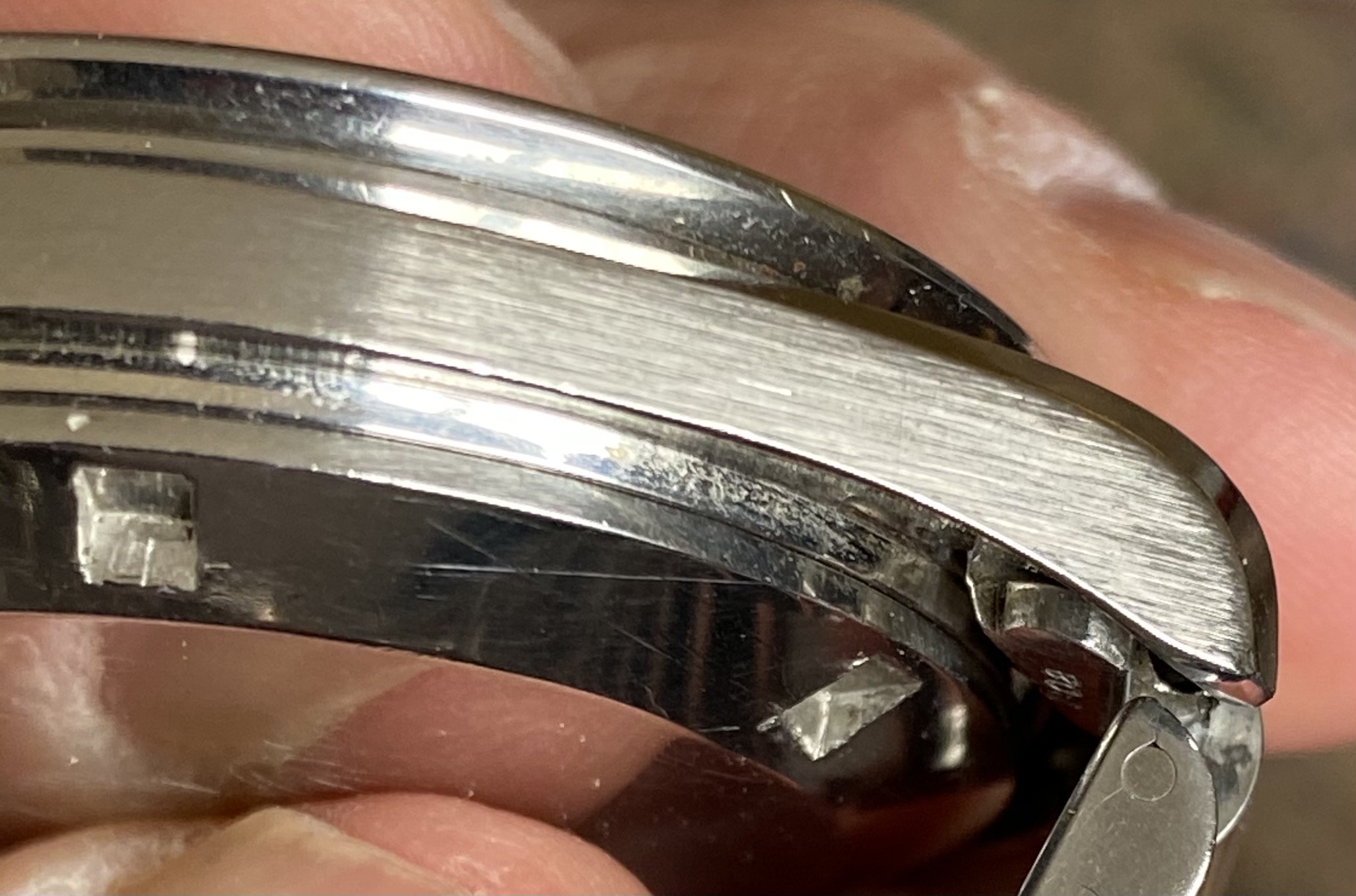

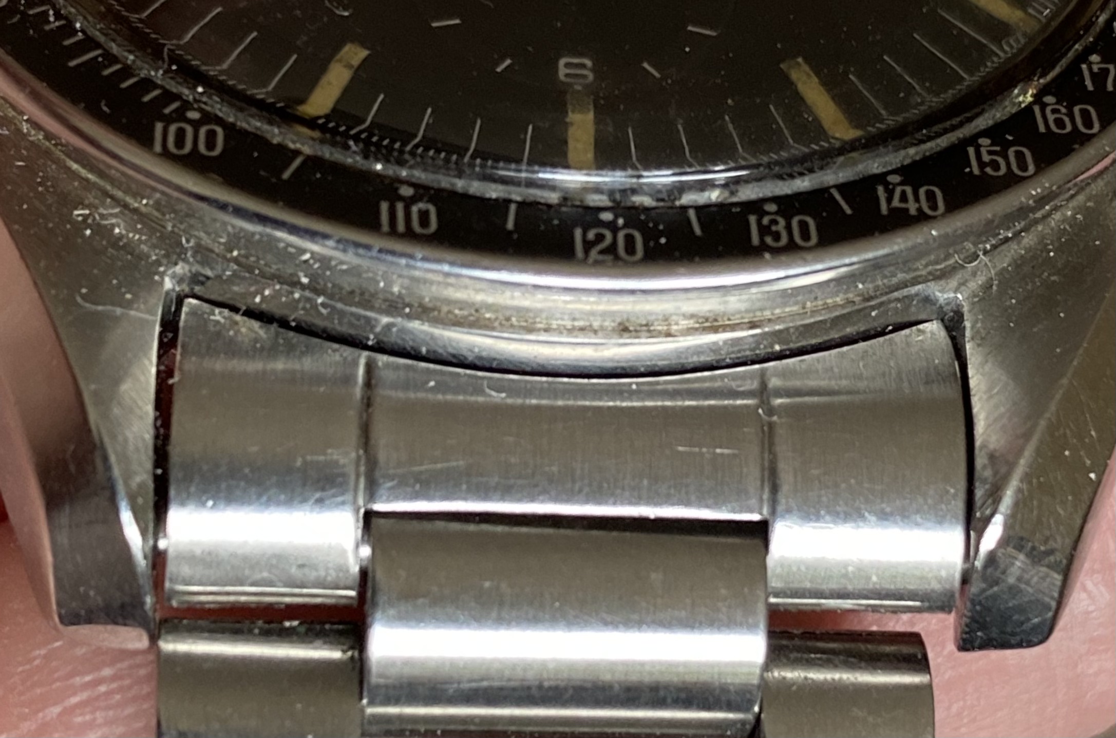

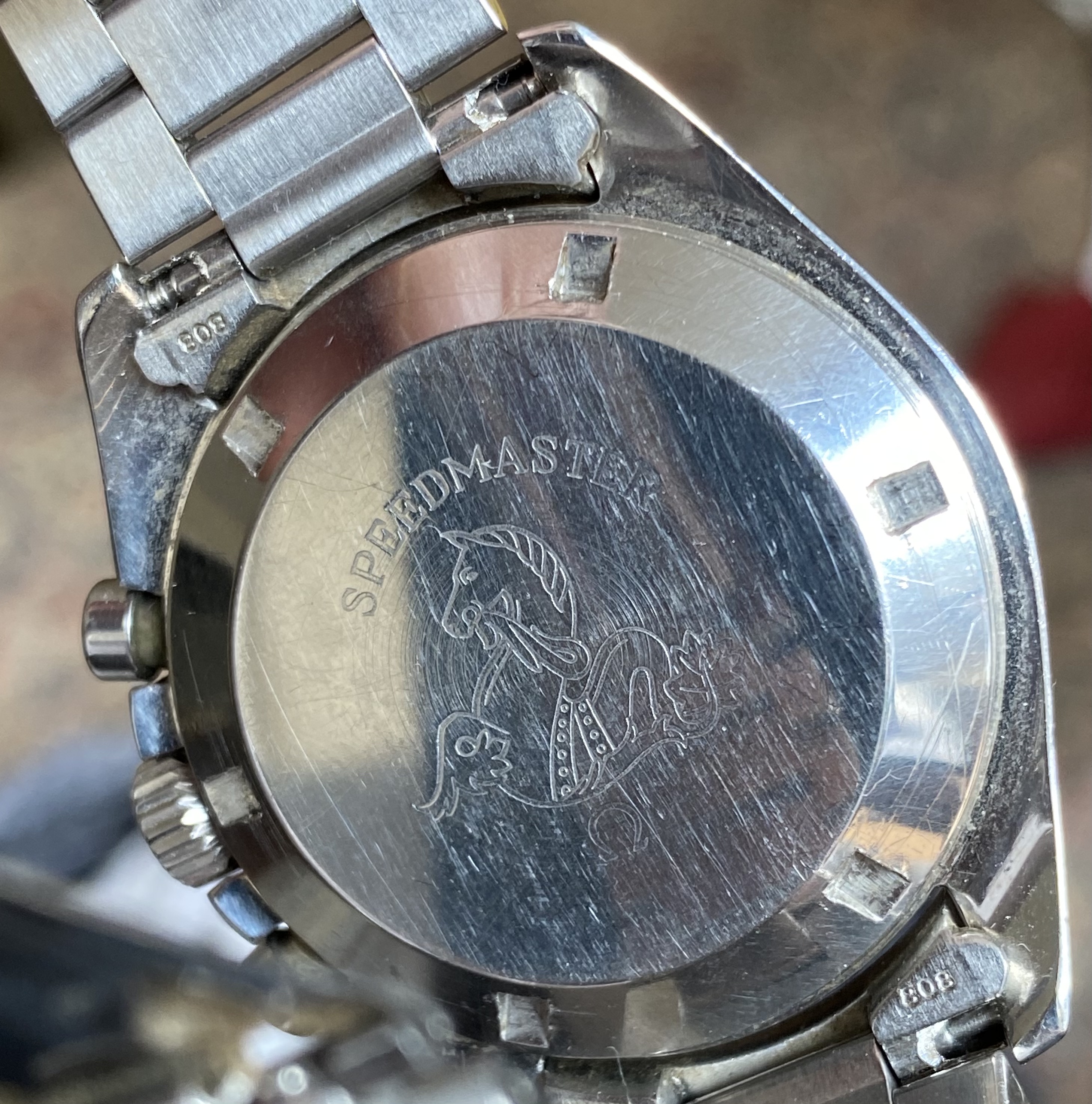

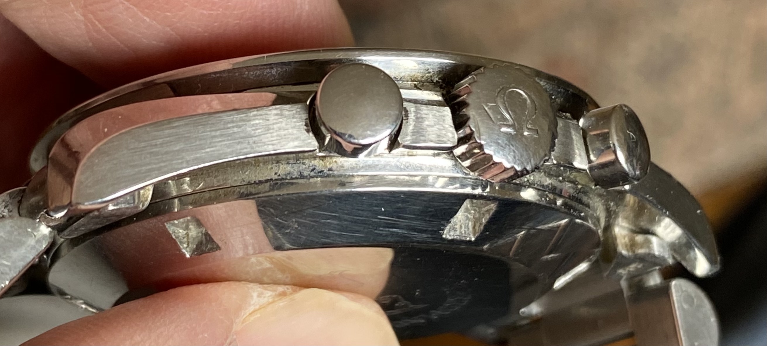

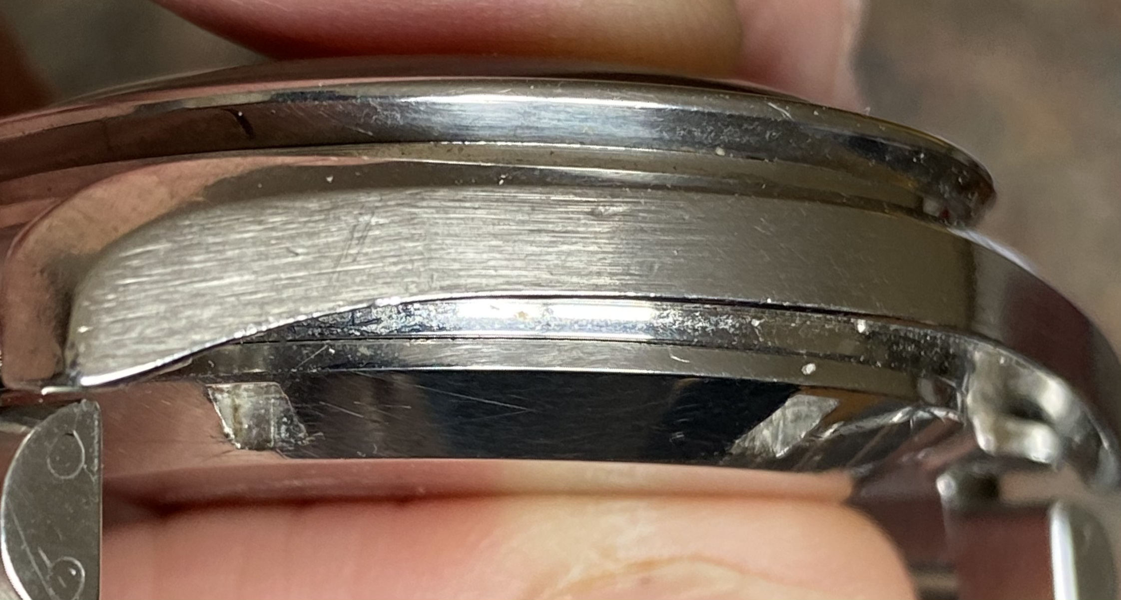

Case: Polished somewhat and worn, but still pretty decent. (To me, that doesn’t look like factory brushing on the sides.) Hippocampus clear, with traces of the factory swirl. One ding, on the edge of the two o’clock lug. Correct pushers and crown.

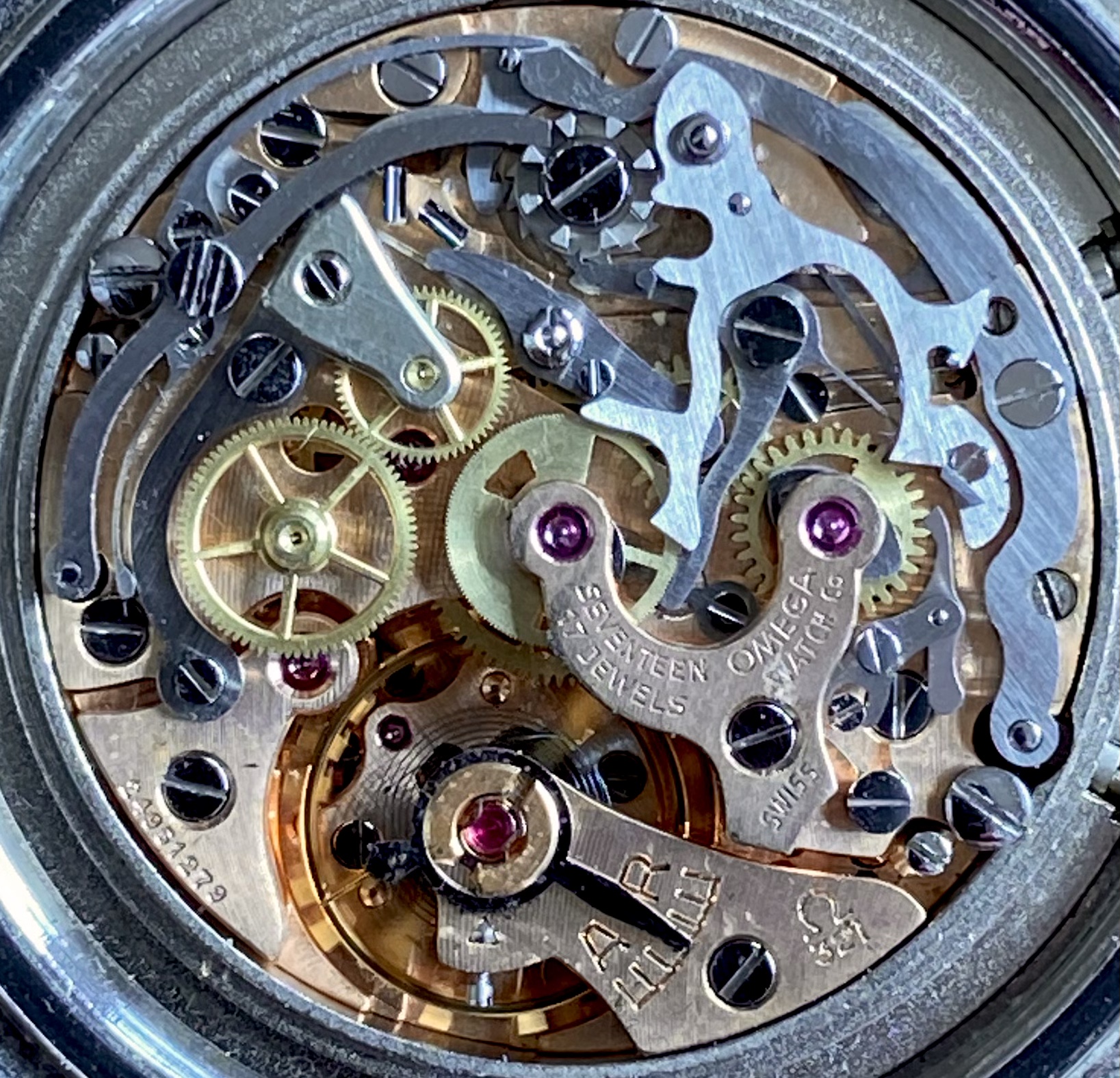

Movement: Clean and functioning. I have not applied for an extract, but the serial number is in the correct range.
I think this is closer to Very Good than to Good. The lume and paint loss in the hands, the drag mark on the dial and that ding on the lug are the things that, to my mind, hold this back.
So, what do you all think?

I’m with @Dan S, closer to Good than very good. The paint and lume loss on the hands, spots on the lume plots in my mind detract from the watch.

Fascinating! Thank you, gentlemen! I guess my ‘home team’ bias clouded my critical skills again.
So, very good is closer to excellent than it is to good?
I.e., if
factory perfect NOS is 100,
then excellent is maybe 95,
very good is maybe 85,
good is 70?

Don't take my thoughts too seriously, I'm just shooting from the hip. I think your watch is very appealing and the ratings are pretty arbitrary. But yeah, I tend to think that the only way to make sense of @Spacefruit's rating system / price list is to assign a very high standard to VG. So that's how I've calibrated it in my mind.

In my experience very few hit the excellent grade band. If you have an attractive, correct, unpolished or lightly polished Speedmaster with original parts, you will usually be between good/very good.
Spacefruit has often said you pick a level, then start removing.

In my own personal grading system, no drag marks on dial, no paint flaking on hands, no idiot gouges on caseback for "good" and up.
It does no prevent this watch from being very nice 👍, or me to enjoy my "fair" speeds...

101 grading system is pretty tough. By those this is a fair +.

Very fun exercise. For me personally, and I know this is harsh, the loss of lume on the hands would prevent me from buying such a watch. So fair is my grading too.

I think the overall appeal of the watch, vs assessment by the specific categories, makes it a Good + as I think it presents well.

Thanks everyone. (Some members, whose judgement I really respect, have weighed in here.) One of the valuable lessons is that we do differ, based on personal preferences and tastes.
I wonder at how close to excellent many place very good. Particularly if this watch isn’t even good.
I agree about the lume loss to the hands being a negative, as well as the dial scrape. I’d give the watch extra points for being ‘original’ - I.e., not prepped or tarted up, with consistent bits. I’d have a hard time saying it was less than good, but that’s my opinion only. To me, there are no major flaws. The good definition includes this:
“it is likely the lowest condition most collectors or owners are happy with”
I suspected that most collectors would be happy with this example, but now I’m not so sure. I see few 321 Speedmasters that are as nice as this one - it makes me wonder just how many very good ones are out there.

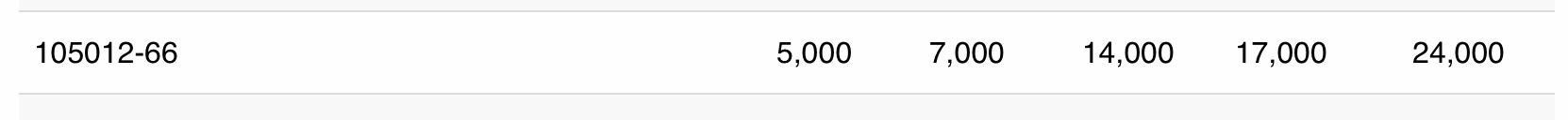

And finally, if I were to price this watch to sell, quite apart from what the chart says, I’d price it at around $12k. Based on my following the market, I think that’s about right to motivate a collector or two's interest.
I would not feel comfortable pricing it at $14k - I’m pretty sure it wouldn’t sell at that level.

I think that chart is accounting for USD inflation and all the Trillions of USD that miraculously appear out of thin air 😉 (But I can imagine that a TOP 105.012 in like-new condition would easily fetch 24k...its everything else in between where the scepticism lies). By my rating of 6/10 you would be priced higher, however, I think (and it’s just my worthless opinion) 12k would be slow in the current market...like I said: my worthless opinion, add a teaspoon of salt and a wineglass of tequila.

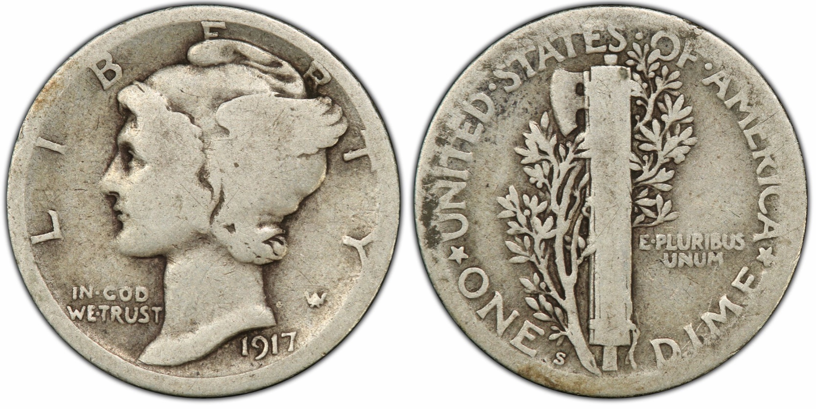

In the coin world, this qualifies as good
And this is a 67, mint state.

Case... numerous scratches, dings, polished, and all correct pieces...although not significant, still too many to rate a strong good.. good minus
Bezel...faded, some light marks, but still attractive... good
Dial...issues with hands..loss of lume and loss of paint, dial plots are discolored, blackish, thru out...fair minus (sorry)
Average... 10.5k + 14K + 6K = 9.5K - 10.1K
I believe, IMO, this price is reflective of a fair asking price in which the watch would sell

Re the OP watch. I too am at circa Good, maybe a little under. You have to take a step back and figure do you like it as a whole and I am afraid that regardless of the wonderful DON, the unattractive hand lume and slightly grotty dial lume make it a Good for me at best. With a nasty DON that would be a Fair for me, as it is maybe it would scrape Good. Just my 2p worth.

Agree with all said 👍. Though with relumed hands I think this piece would turn a corner and be a real looker. Not SP101 Very Good still but a solid wearing watch. Then you get into a different debate, I know, but this is one of those cases I think relume (hands only) is a good idea.
