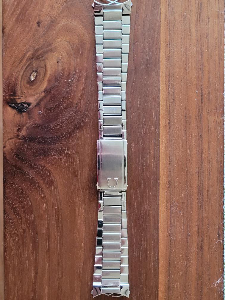

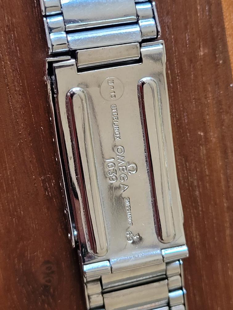

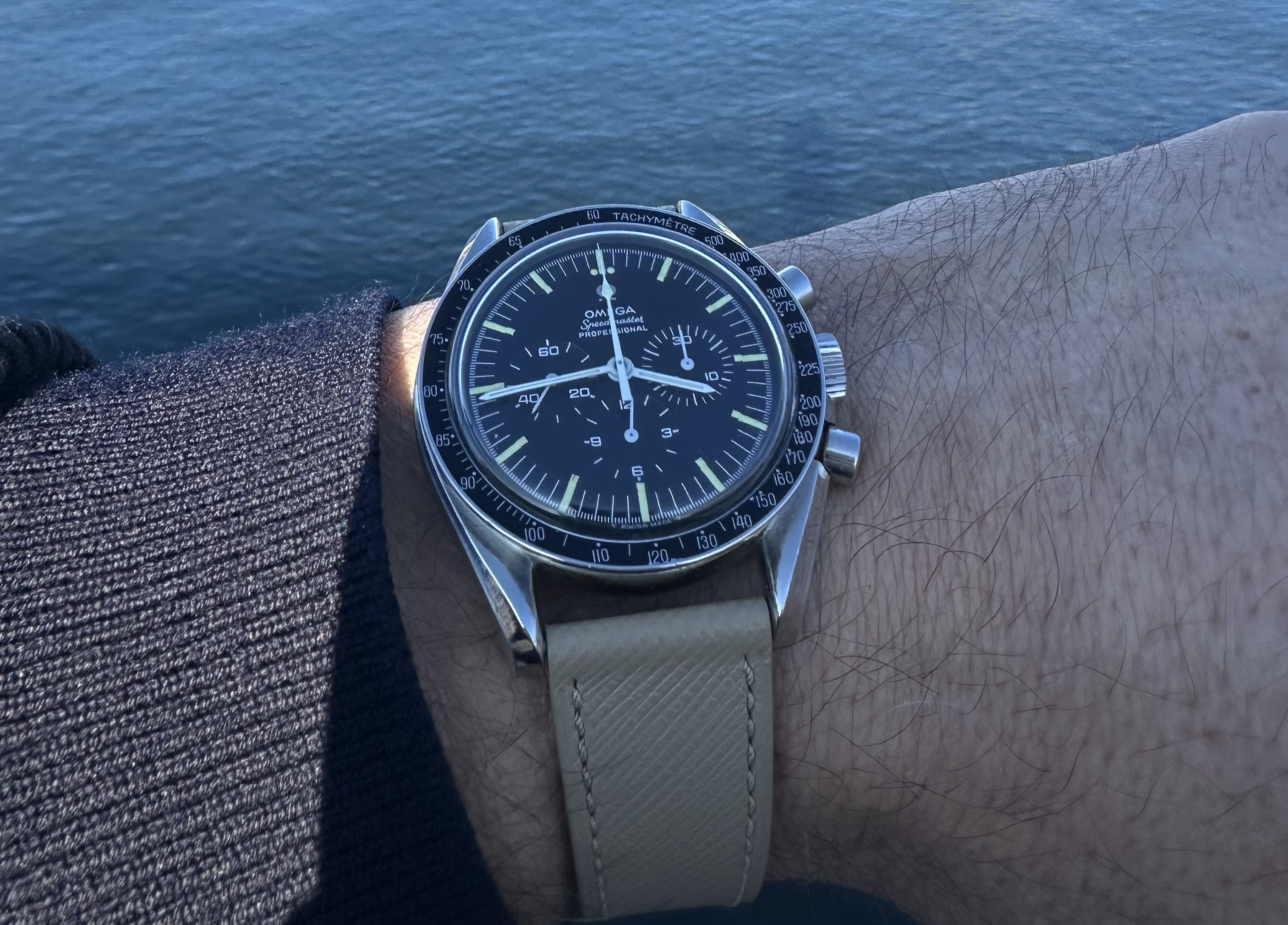

Well I am Irish but never seem to have much luck 😉 thanks for taking the time to reply as I mentioned I am very happy with my set but was just curious on when bracelets were normally added in production as almost all the 69 production Transitionals I have seen (only a few to be fair) with 1039 bracelets seem to have a 1/69 date stamp. The bracelet is actually on route to me now so I can't show it as the set but here is a photo of my new watch and the bracelet I have bought. I am proud as punch to own them both!

Congratulations
Very nice watch. And this 1039 is looks awesome.
