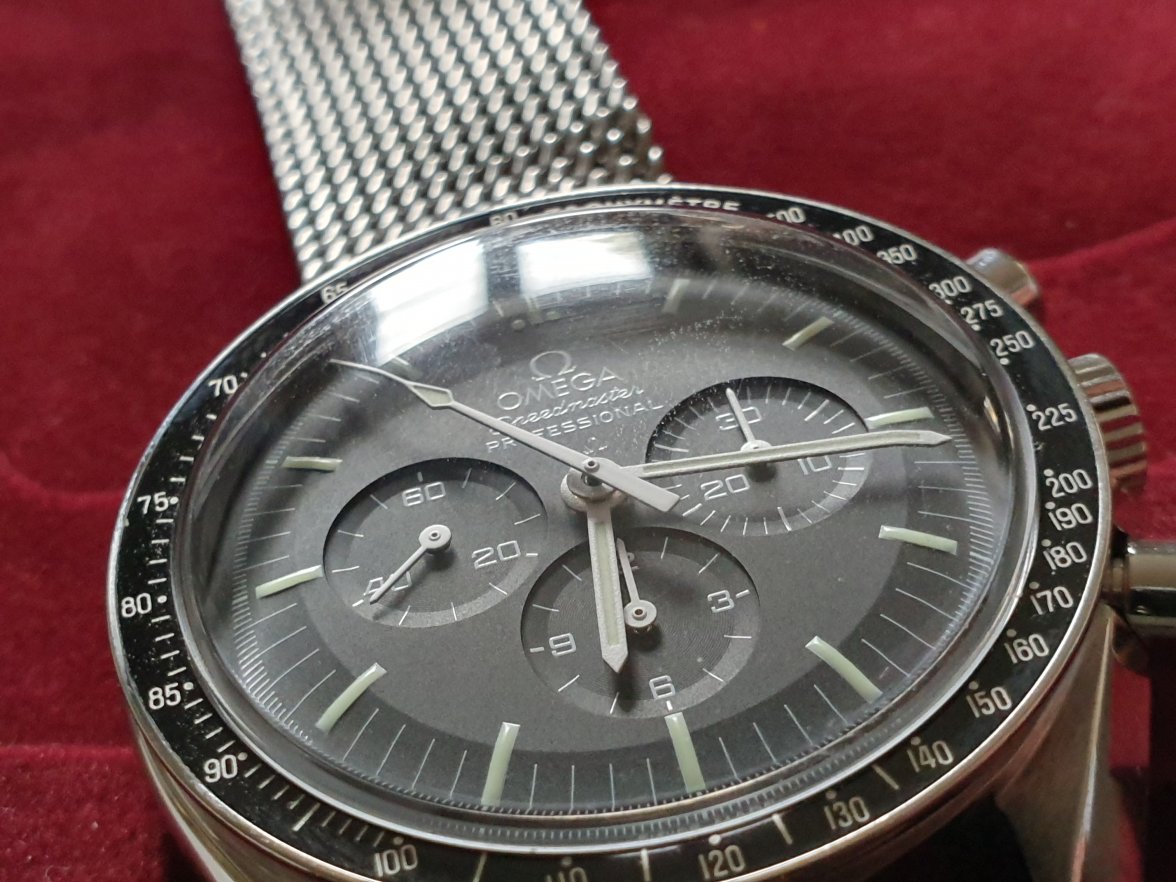

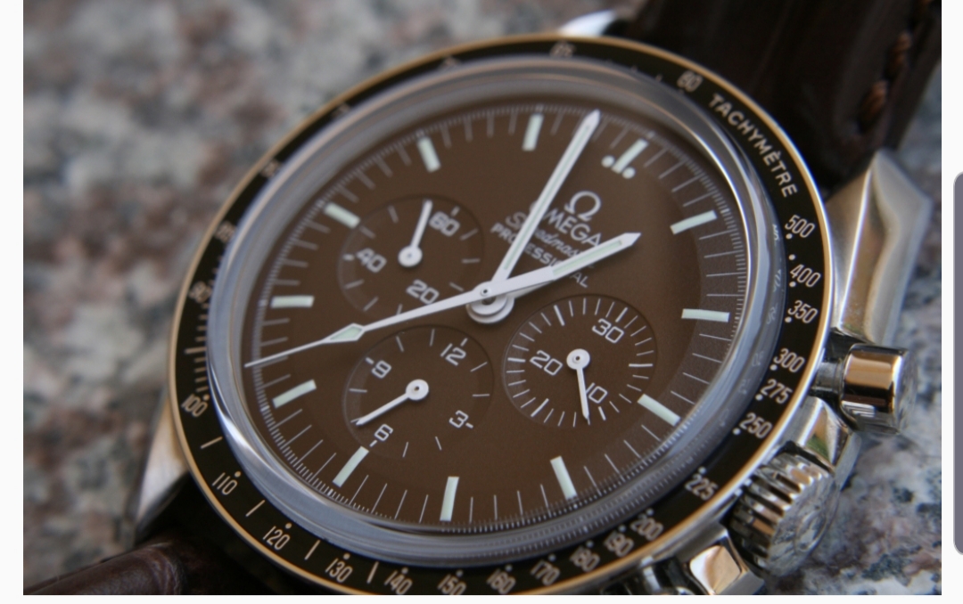

Just had my late 2012 speedmaster back from a service. The flat chronograph second and main minute hands have been replaced by bent-tip variants. Has anyone experienced this before? This is definitely the case and it is not just an illusion from the crystal.
Please see below my watch (on red bag background) versus some screen shots from watches online.
Anyone have any thoughts?
Thanks in advance.

Isn't the crystal majorly amplifying/distorting the appearance? As contrasted with OP’s pics 3 & 4.

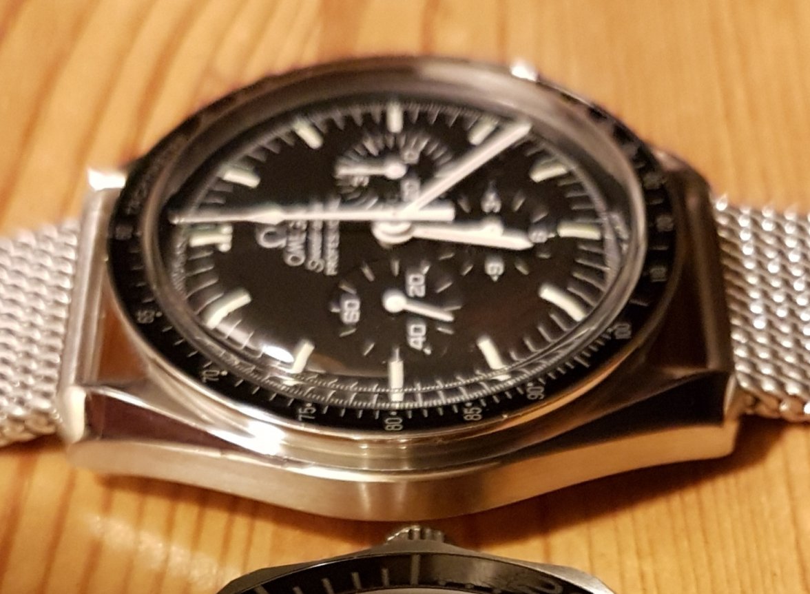

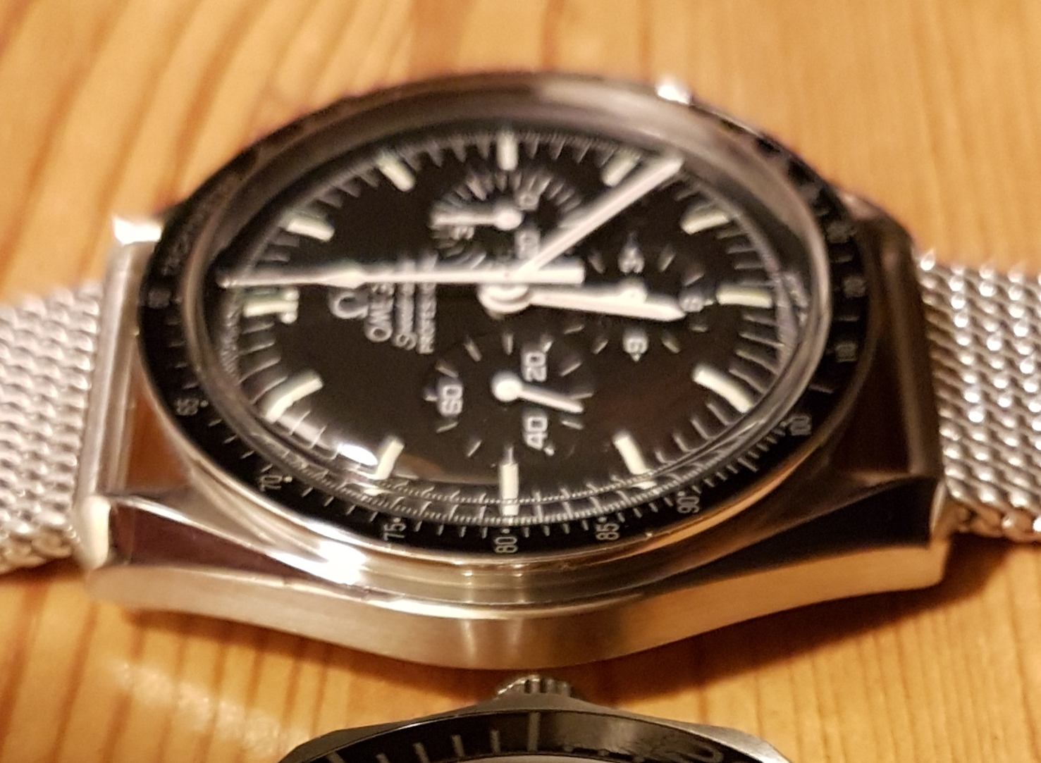

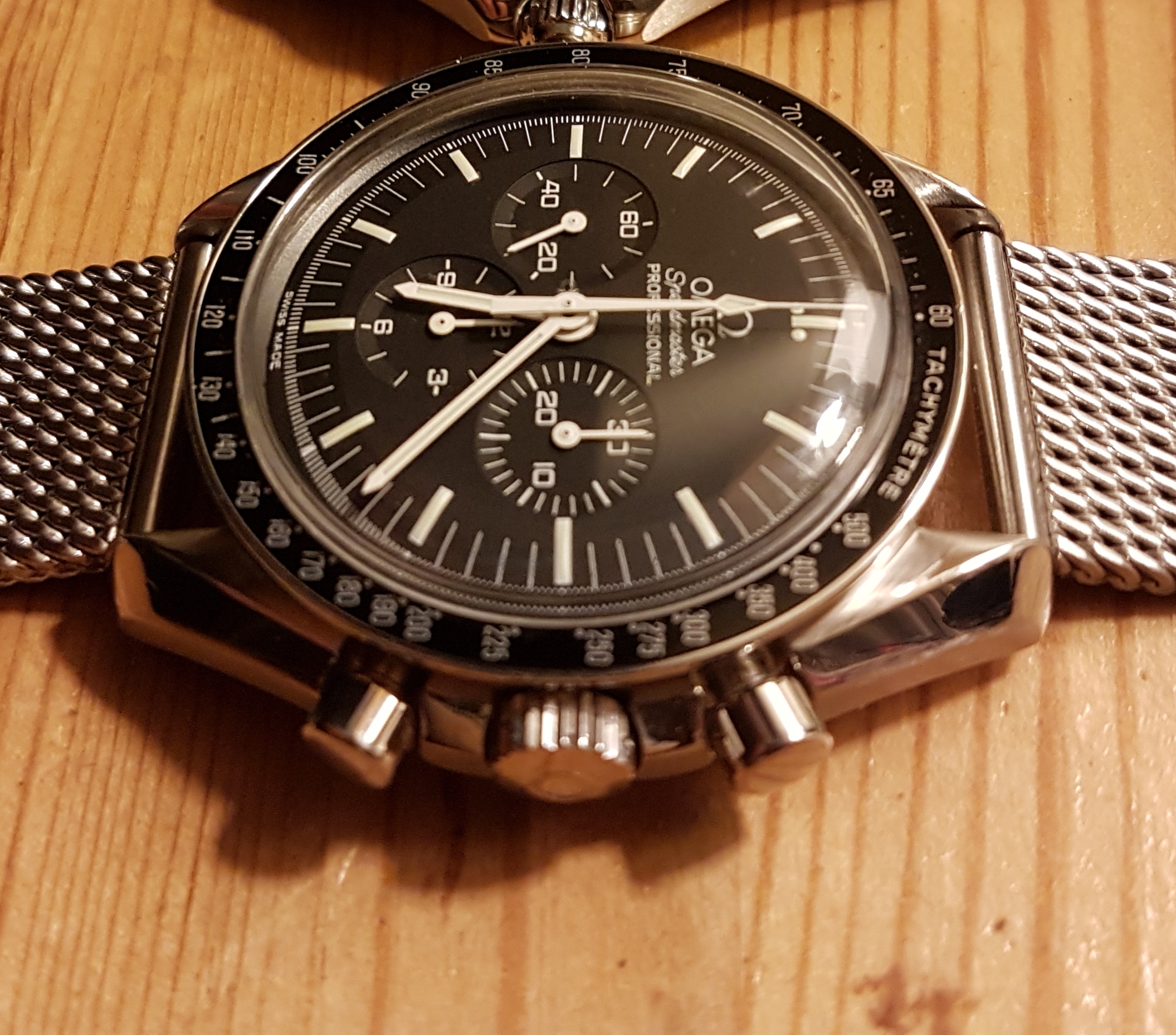

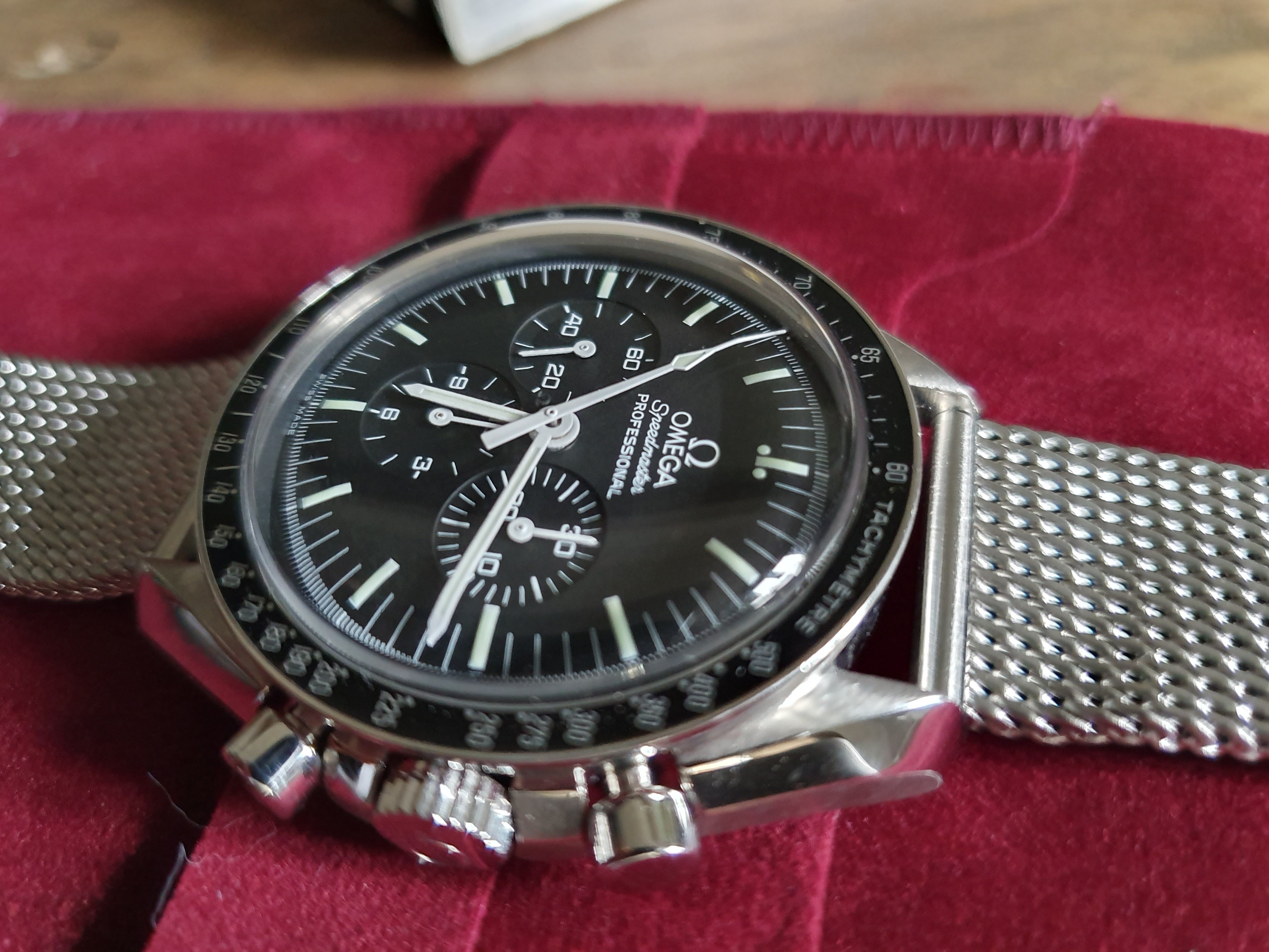

Thanks for the replies, guys. I've owned the watch for 6.5 years and worn it daily; the effect is not from the curvature of the hesalite.
Please see below two pictures of the watch pre service from the same shallow angles (wooden background) versus two pictures of it post service (red background).
I'm aware of the practice of bending the tips, but is it normal for an official Omega service centre (UK) to change the look by applying the technique? I think I prefer the flat hands...

I was taught that the hands follow the contour of the dial so, "flat dial = flat hands". On something like a dome dial Connie from the sixties, the hands are curved to follow the dial. On a Speedmaster, the minute and chrono are sometimes lightly curved at the tip because the dial is not completely flat. Your watch seems to have excessively bent hands (not really curved, just bent at one point) but part of that may be the crystal distortion.
For modern watches, many companies just replace the hands at each service as they are very visible to the user but, it's not clear they were changed on your watch from these pictures. Often this is one person who only fits hands. The hands on your watch have been adjusted as they are usually flat when manufactured.
I have four Speedmasters in front of me ranging from a mid sixties 321 to a brand new and untouched Ultraman. None have a bend like your watch and the Ultraman that has just been made, has flat hands.
If you don't like them, go back and explain that you don't like this modification and can they explain why they did it.
