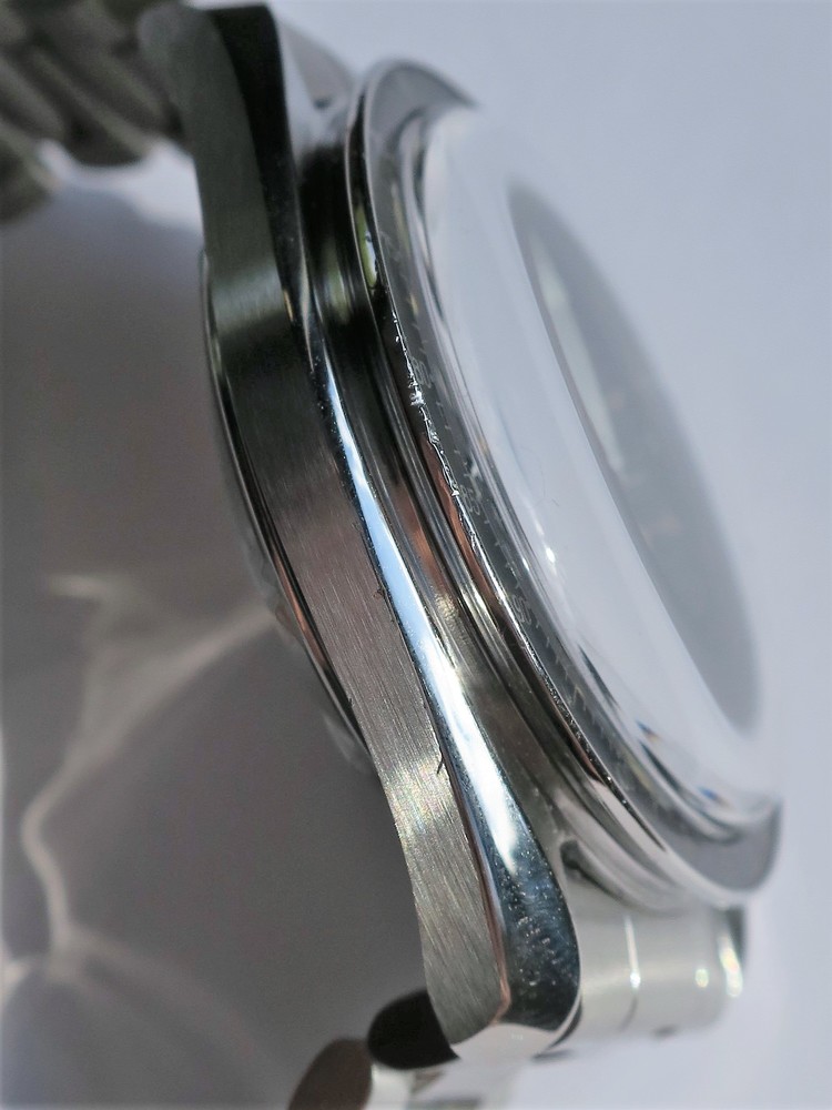

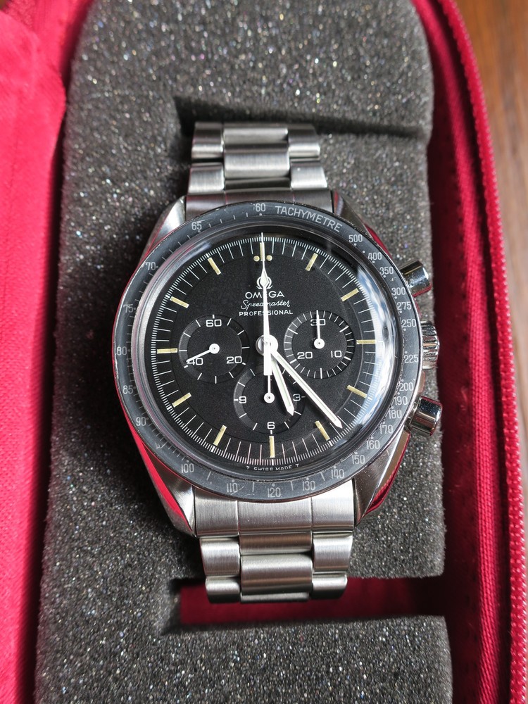

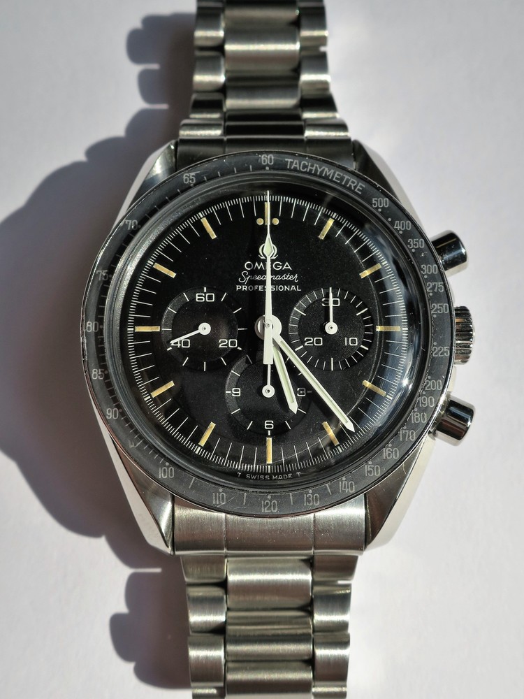

    Good day all,
    Recently I've been passed along a Speedmaster Professional and I'm seeking advice on correct identification and what to do with a possible restoration.
    The watch has not yet been opened up , but with reading around on the internet I think it's a '69 Pre-moon transitional. The dial plate points to a Cal 861 but the back has still the pre moon inscription. The bezel insert is however with the dot next to the 90, is this correct ? The bracelet is a 1039, damaged (worn daily until a couple of years ago), but the original sizable links are preserved.
    Pictures :
    [​IMG]
    [​IMG]
    [​IMG]
    [​IMG]
    My questions are:
    Is the identification correct ? Do you spot any possible "non original" parts ?
    How would you guys proceed with a restoration ? My plan was to keep everything as original as possible, the luminous material on the minute hand appears to be damaged, is this going to be a problem ? The bracelet is dented, is it possible to repair it, or keep it as it ?
    Where would you restore it, STS (lots of good reference on the net) or Bienne. I'm based in Belgium, do they accept watches from abroad ? Otherwise any recommendation for Belgium/Netherlands ?
    A lot of question, I know it ;). But the watch is personally highly valuable and I just want the best for it :). Thank you in advance.

    Very nice looking Speedy, with the original bracelet! The bezel, dial, hands, etc. also all look fine to me, but I am sure others will weigh in soon. Personally, I would get a full overhaul of the movement, but leave the rest of it as is. Changing out visible parts can reduce the market value of the watch to the collector community. Given the age of the watch it is always possible something has been changed out, but if so, the parts visible look correct and appropriately well-aged.
    Once you (or your watchmaker) open the back, there will be a serial number on the movement that can help determine the approximate date of manufacture. In addition, for a fee, Omega will provide a record from their archives indicating when the watch was produced and to which country it was originally shipped.
