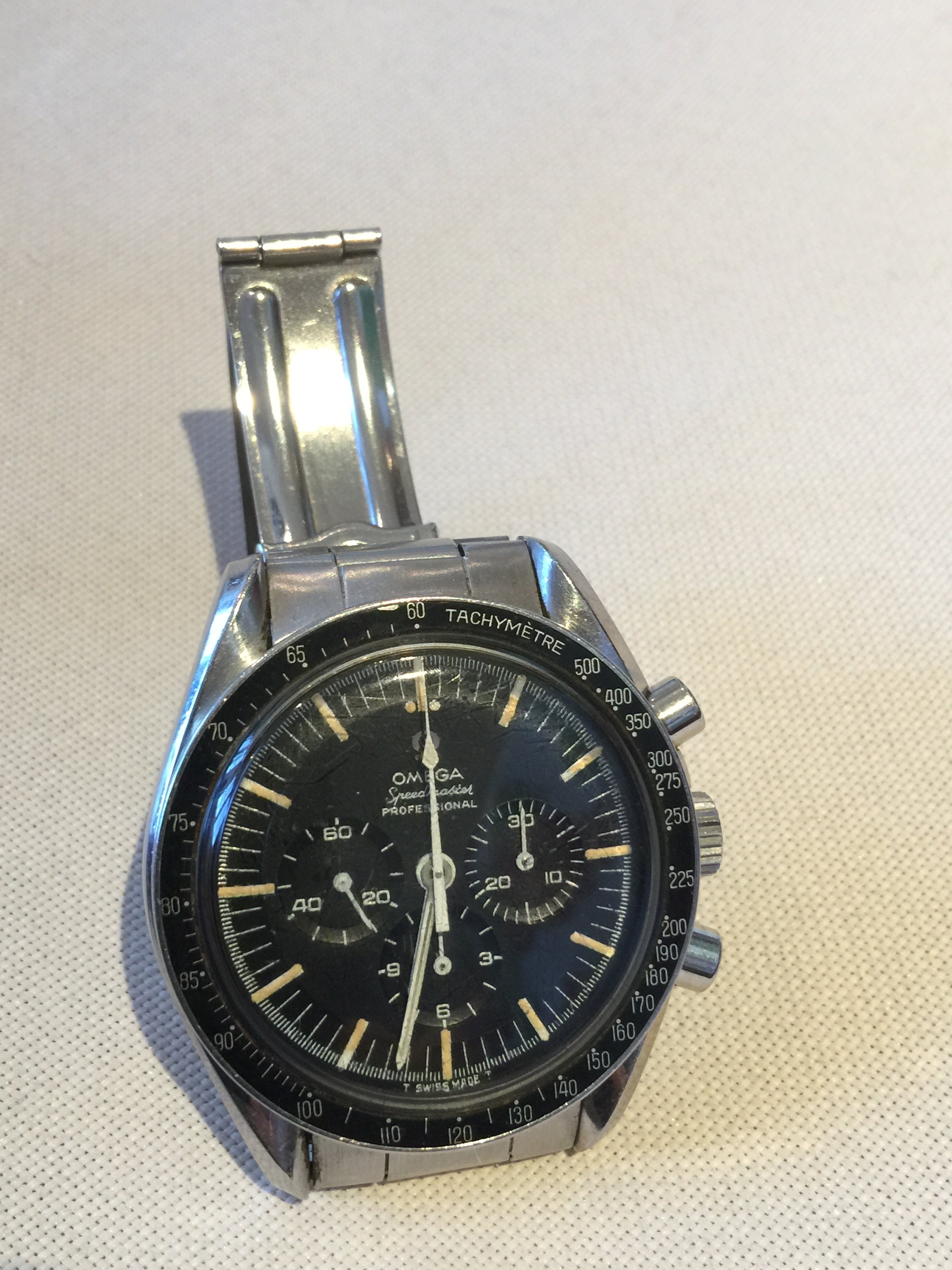

    Greetings,
    I have inherited a '69 Speedmaster from my grandfather, and after leaving it unused for over a decade I am planning to get it serviced so as to have it in good order and to wear it regularly. Any advice on things to look out for and on how much to change would be much appreciated. Pictures below. The glass is showing wearmarks and I am thinking of getting that changed, but while the dials have changed colour and lost much of their luminosity I am thinking of keeping them as they are. Any suggestions concerning things to have done and things to avoid or not to have done to the watch in servicing would be very helpful.

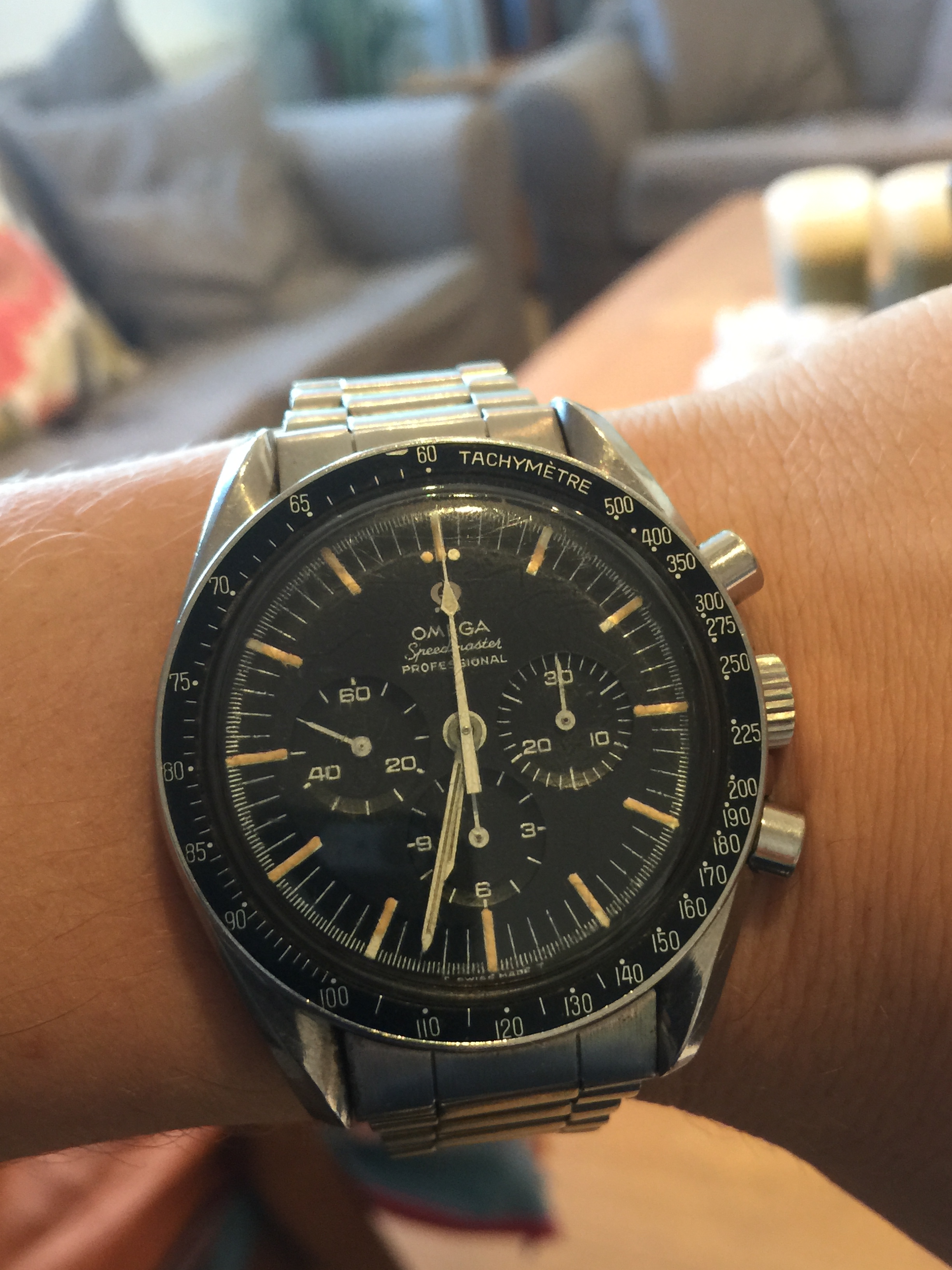

    I would say you have a very sought after Speedmaster there. The dial has a great colour and the applied metal Omega logo - this is unlikely to be a '69 but a watch from a year or so before. It is probably a '68 if the movement is an 861.
    Also it has a great looking and again very sought after 'Dot over the ninety' bezel.
    The glass can be very easily polished with Polywatch or similar polish (car polish or even toothpaste - just do a search)
    Personally I would only get the movement serviced and maybe the pushers or crown replaced if the case is leaking

    Looks like a '68 or '67, not a '69 but possibly sold in that year. The God news is that these years are much more sought after and more valuable. Looks like a nice dial and lovely bezel so definitely keep these as they are. Just go for a full movement service and a good clean, not polish of the case. It'll come up a treat!

    Very nice. Let us know what numbers are stamped inside the caseback if you can. That will tell a lot. Don't open it yourself if you're not comfortable with that, but any watch repair shops should be able to open it for you so you can get a few pics. There would also be a serial number stamped on the movement itself. That will also help.
    As the guys above have posted, it looks very nice! Definitely get the movement service, but but very specific about making no changes to the visible parts. Don't polish the case, don't change the dial, don't replace the hands. Those are all the parts that make the watch so attractive.

    It could be an 861 transitional or a 145.012.
    This is exactly the kind of watch that would fly like a kite at auction.

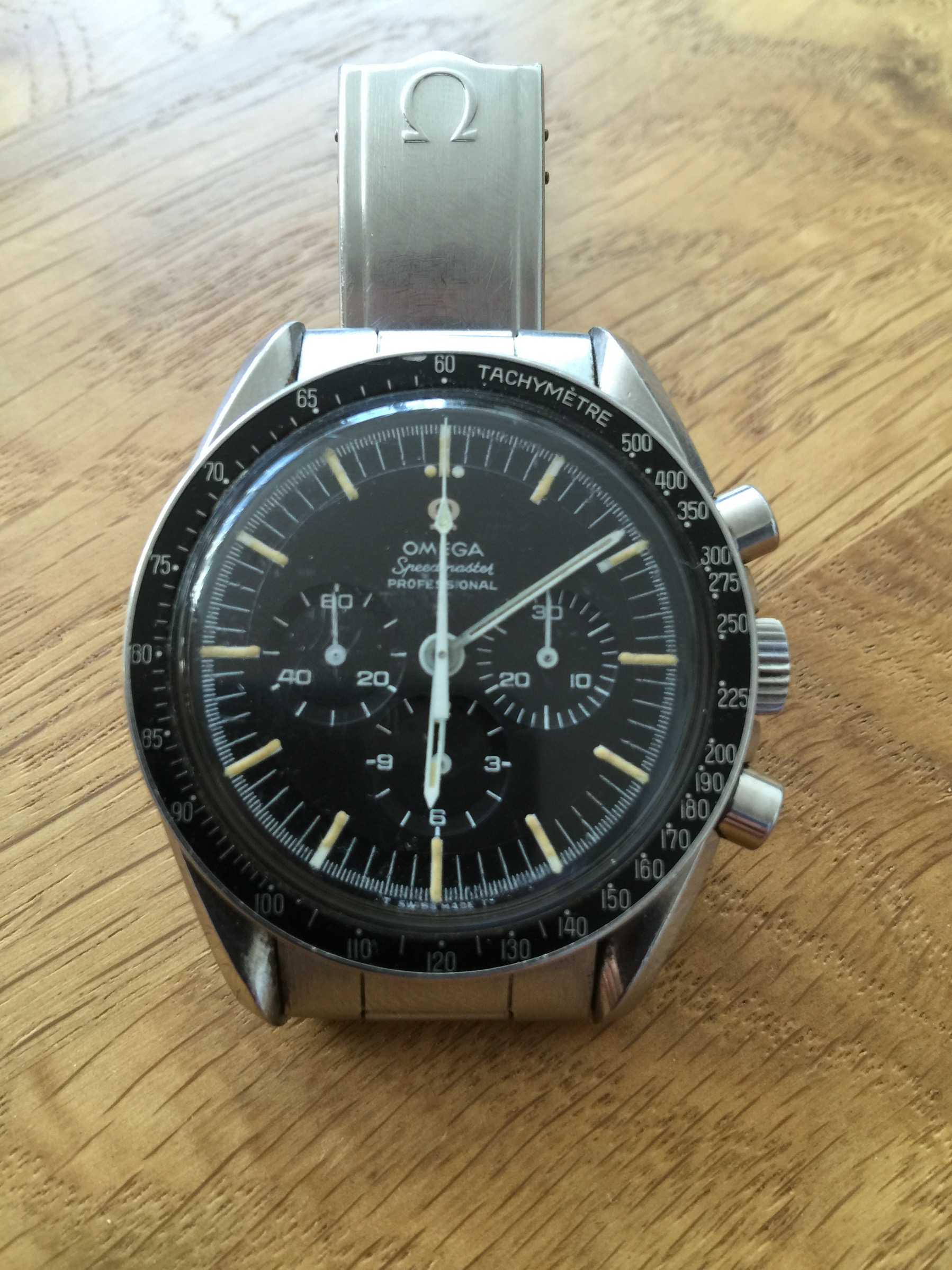

    Let me ask one more question in light of your accumulated expertise: the hour finger seems to have lost part of its luminous centre (see image), and on close inspection the minute finger may be on the way to do likewise. Would you suggest having these fixed or left as they are?

    I'd have the hands replaced with service hands, and heck, I'd have the dial replaced as well. Hang onto the originals if you're a collector, or throw them in the trash if you're not.
    Remember that just about everyone here except me is a collector. But! when the lume falls out it can get stuck in places you don't want to have it get stuck. So I think at the least, get the hands and dial replaced and keep them for the future. Don't let the collectors keep you from wearing your watch and getting full value out of that.

    If you have the lume removed from the original hand and wore the watch... everything would be safe but it would not glow in the dark, which is why the lume is there to begin with.

    I think there is some risk that the hands deform. I've seen chrono second hands that had deformed with no lume. I've heard (and I'm not an expert on this) that hands with missing lume should be repacked.. repacked with new glowy loom or with non-glowly vintage like lume is a decision left to the owner.

    I will add that a competent watchmaker can mix up some Super Luminova (be aware this stuff is expensive!!) to match the aged tritium on your dial, so you can have the hands relumed (hour hand, minute hand, sweep seconds hand) and keep tjhat original dial, which looks stable. Then the hands will glow, which is why they were lumed to begin with, and you keep the original parts and only intervene in that small area.

    Risk of deformation is slim to none, I'd be interested to talk with that individual... but you're right, whether the replacement paint glows or not is up to the owner.

    A decent watchmaker will be able to patch the gaps with colour matched substitute-keeping the old hands and what's left of the original luminous compound. Personally I'd certainly go that way rather than replacing them with new hands.
    Yes new hands will glow as will a new dial, but if brightly glowing hands/dial are important then surely a new Speedmaster is a better bet than a vintage one? If you stick new bright white hands on a vintage, patina'd watch, they'll stick out like modern uPVC windows on a lovely old stone house.

    @Jacob W it is your watch and of course you do what you want to it. You SHOULD do what you want! You may not be a collector, but this is very much a watch desired and valued by collectors.
    Should you follow the advice of @VetPsychWars i will have to withdraw my comment above. By following his advice you will be destroying the value of the watch. And of course, it is up to you.
    The figures are roughly, $4000-6000 for the op watch, and $2000-2200 after you have proceeded as @VetPsychWars
    Suggests .

    IMO it would no longer be your grandfathers watch if you install a new dial and hands, the beauty of these old watches is in the patina and wear of the dial, hands and case - something which would be lost by replacing the dial.
    Of course you can replace the dial and keep the old dial to put back later but if that is something you are contemplating then I think that you should only look at that after months of owning and wearing the watch as it is now.
