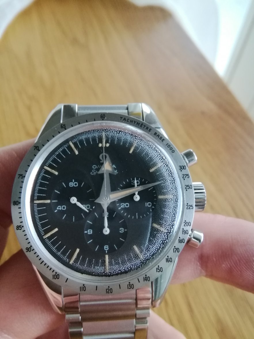

    Went to the swimming pool yesterday with my daughter. I do not know what I was thinking about but I kept my one and only modern watch at my wrist. Thought those modern speedies were waterproof but they are not...
    Any advice?

    No watch is waterproof. This watch is rated to be water resistant to 60 m.
    It needs to be looked at immediately, and I hope they would cover it under warranty. Simply drying it out is not enough - this should be fully disassembled, serviced, etc. to ensure all traces of moisture have been removed. The clock is ticking...

    The Speedmaster is rated to 60m. It makes no difference in “dynamic conditions.” The fact that this one failed is either because it is defective, or a crown or pusher was used underwater or left open.

    Nope - the watches are tested fully, so can certainly withstand the pressures involved. No marketing involved - I do this type of testing every day. But continue to believe what you wish in spite of this - that is what the world is all about these days - people's opinions getting more weight than actual facts...
