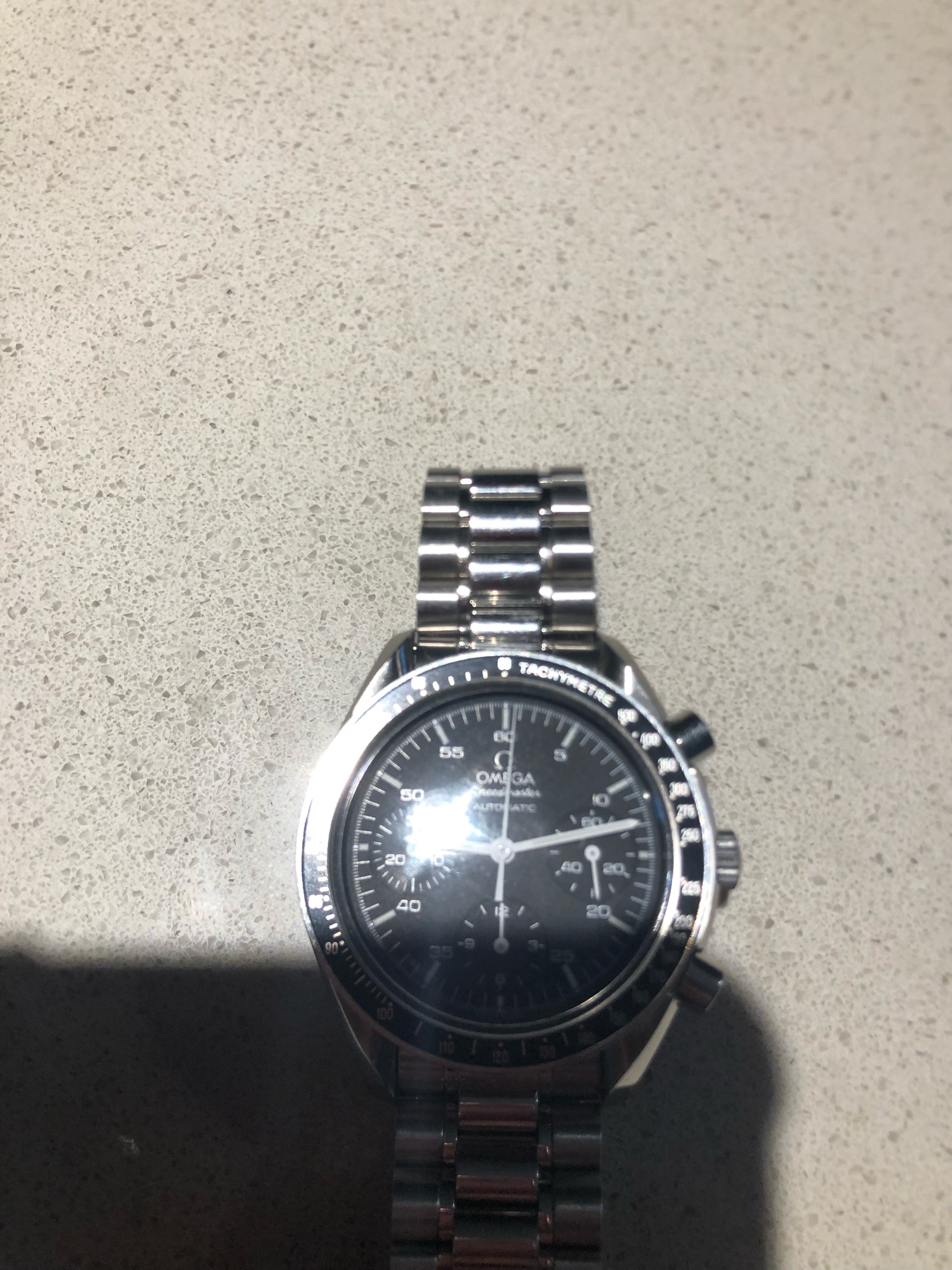

Need help, the seconds on my speedy no longer aligns with the 12oclock position, it is about a half click past. Is there a way to reset the hand alignment like you can on other watches or is the only way to fix it is by getting it repaired?
Thanks

It does look “Offside”. If you’ve had the watch for several years without having it serviced it may be causing the second hand’s “encroachment”. You may need to have it serviced “Sooner” than later. Welcome to OF coach.

Watches that have a function to re-align the seconds hand are all quartz AFAIK. Yours needs the attention of a watchmaker. As @Duracuir1 says a service may be in order, just make sure the watchmaker can and will service the Dubois-Depraz chronograph module.
