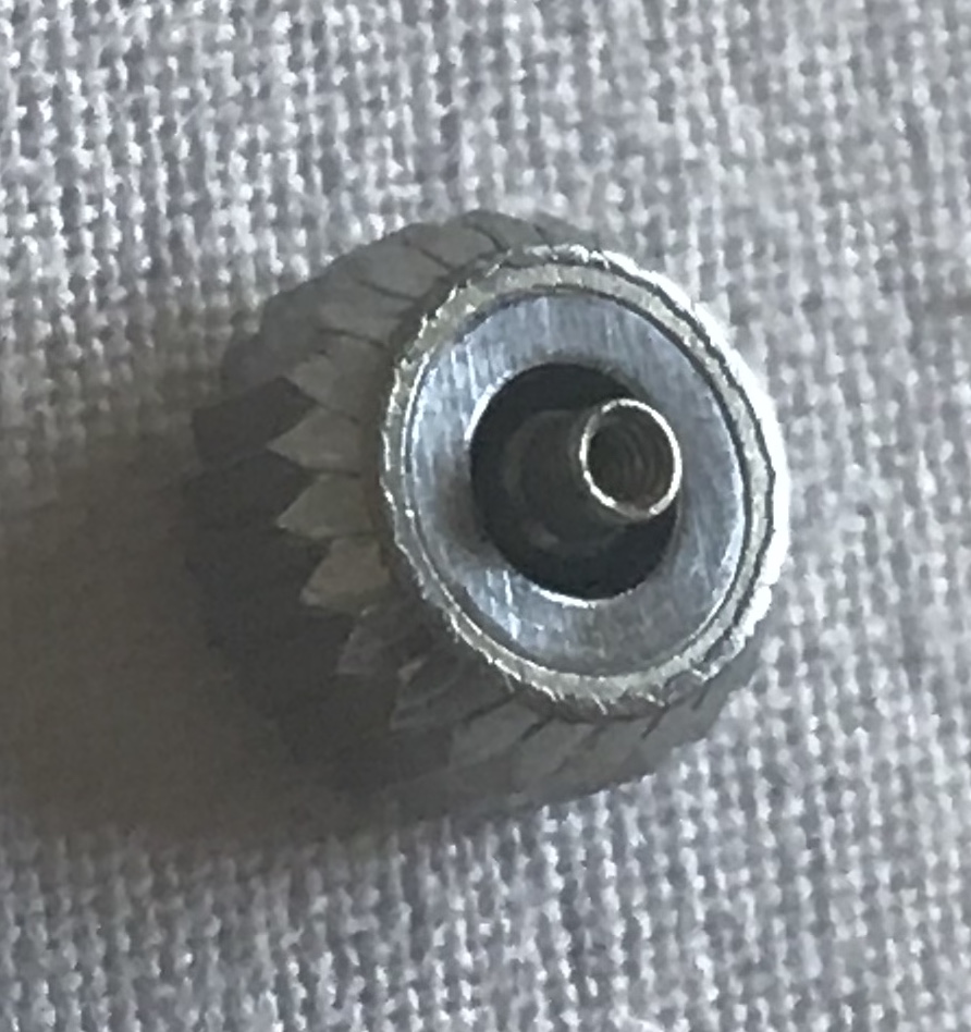

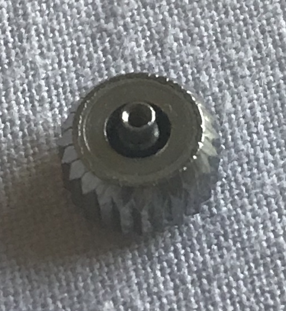

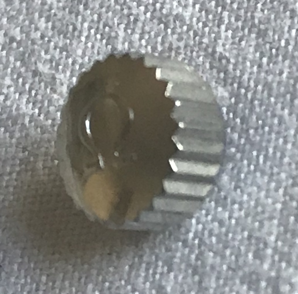

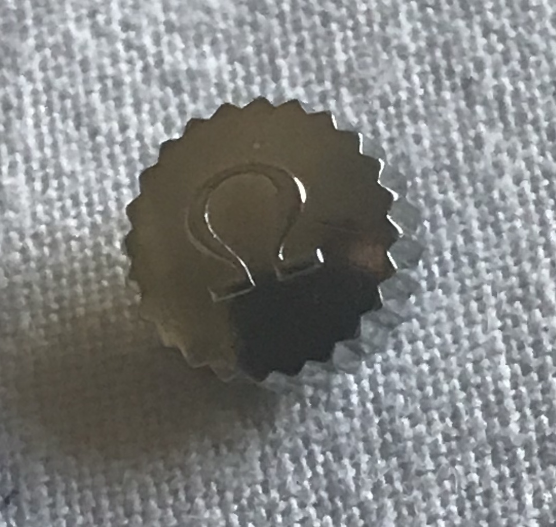

Speedmaster 321 crown type A1 Narrow flat feet. Genuine or replica?
6
I was wondering if this crown is an original Speedmaster crown type A1 Narrow flat feet or a good replica. Can you please share your opinion? Thank you

As far as I know fakes are visible from the back of the crown. Anyway I would appreciate opinions from expert about the crown I posted. Thanks
479
1,553
Seems the telltale signs for repro crowns is the lack of a crimped casing. True for some of the fake Rolex crowns out there as well that are supposed to replace the early crowns. The backside (like the ebay link posted) shows a flat single-piece edge
Meaning - Looks like yours is correct since it's crimped on the backside.

Thanks, So you think it should be genuine?
479
1,553
I'm not an expert on these so don't want to hang my hat on anything. But it certainly doesn't look like the reproduction that was linked.

There are also modern authentic Omega flat foot crowns without crimping, look exactly the same as the OP's but without crimping.
479
1,553
Makes sense, and that's a can of worms for someone buying one like the ebay link.
But are there modern crimped ones? If not, that makes it more likely the OP has an original.
If there are, well .... 😕

The OP”s crown looks fine.
I have not seen modern crimped ones.

I would say it’s the real deal and it’s for straight lug cases not later twisted lug cases. The difference lies in the raised stem pipe seen in this example.
1,869
5,443
IMHO, without the raised stem pipe it’s for a SM 300 or a Railmaster.
1,913
3,958
You can tell Seamaster and Railmaster crowns as they have a different stem size from the Speedy ones.
