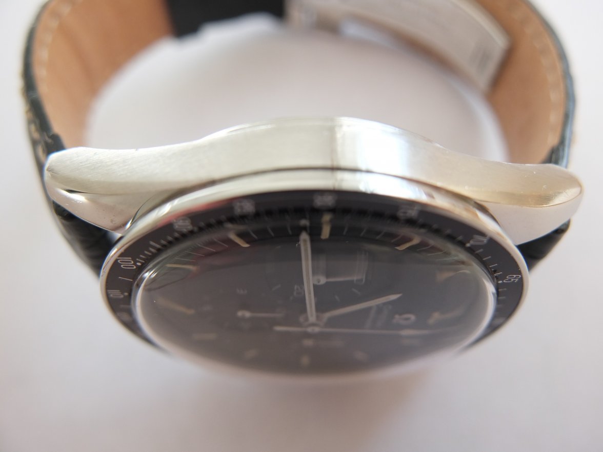

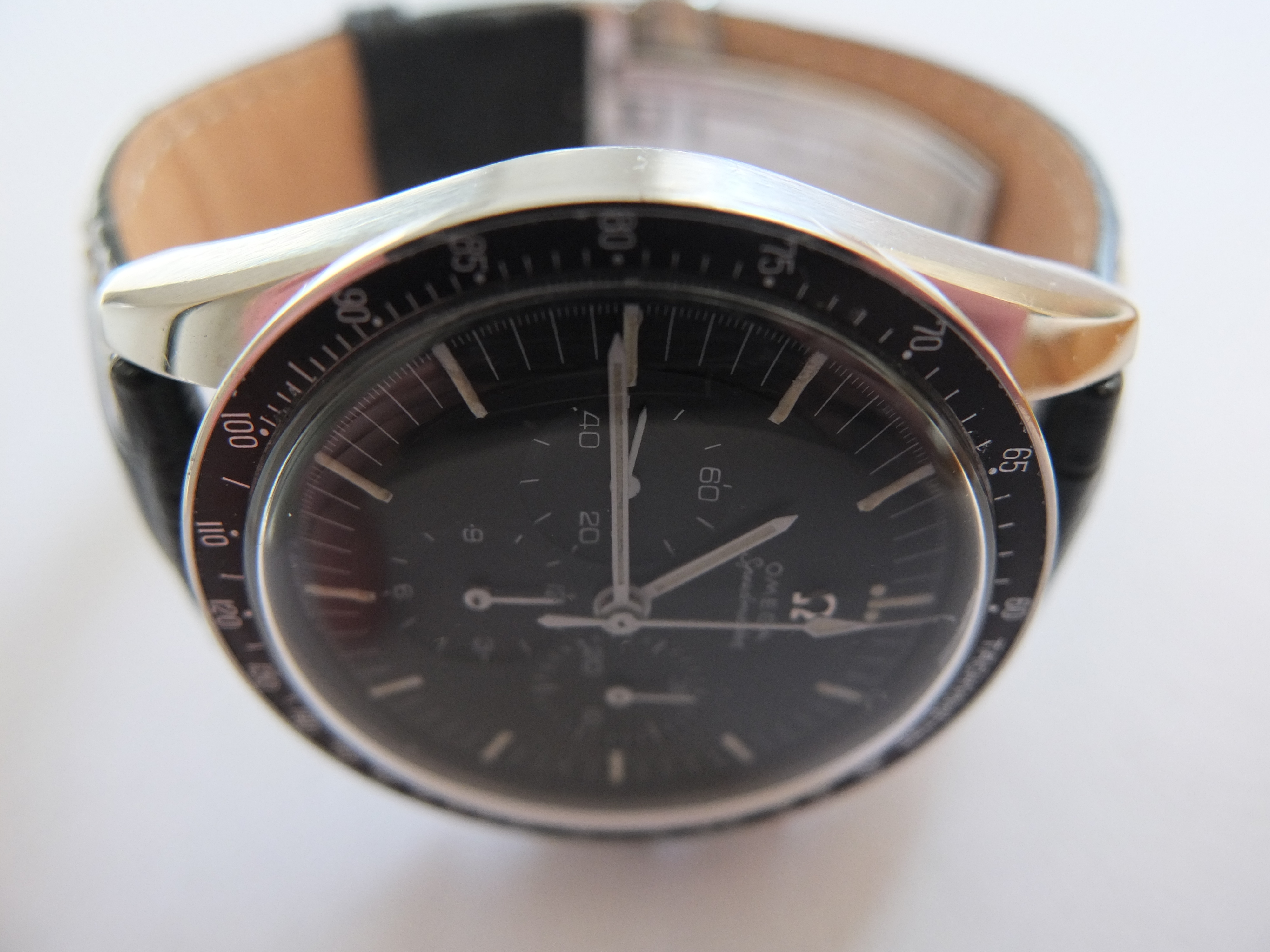

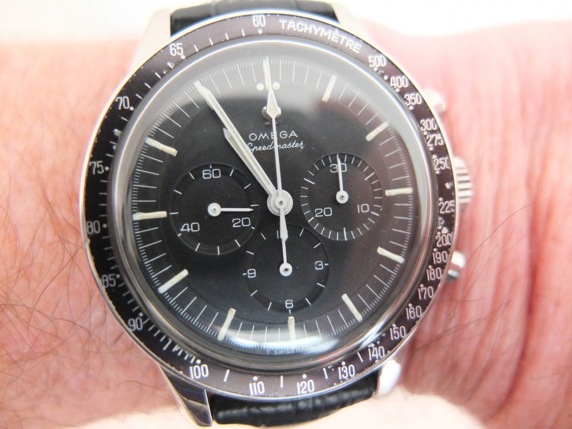

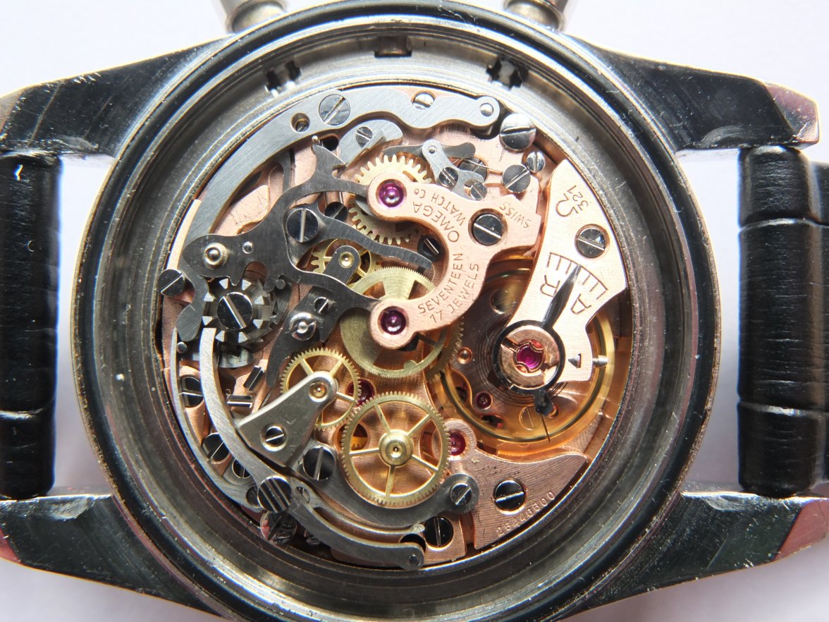

    This is my 65 speedy I know the full history of the watch from new, it was serviced by Omega in the mid 80, s
    and a new plexiglass fitted, it appears at that time the factory retouched the lumes?, I know the dial, bezel, pushers
    and crown etc are all original and dial , hands have 2015-02-25 12.15.40.jpg 2015-02-25 12.10.40.jpg 2015-02-25 12.04.22.jpg faded evenly it appears.
    It was last serviced late 2012, inc fitting new main spring, runs perfect , pushers are smooth and resets to zero.
    Comments on general condition please.

    Photos are slightly awkward to interpret because of lighting and angle. Better than most though.
    Correct non pro, close T, AML dial. With slight tropical accents. Untidy lume, but I cannot decide why. I would not have called re lume until you suggested it. I like the dial.
    Hands are probably replacements, but can't quite make out for sure. Don't like them.
    Nice bezel, DO90 in not bad condition.
    Over polished case. Many of these reference are, but it's still a shame, and again, it is possible the photos exaggerate this.
    On a watch like this, if the dial looks nice, the things I mention tend to be overlooked by buyers at the moment. Well those on the bay or Antiquorum.

    I wonder if the hands were touched up when the dial was. I hope that that relume wasn't done by Omega. The application is uneven and on several of the plots (6,7,9,& 10) extends beyond the plots.

    Well spoted guys!, it was on ebay but the transaction did not go though,
    It is great to have some opinions as to what is not correct, just to clear up
    a few points, I made suggestion on the lume to find out if this was done by Omega
    as matter of course during a service of glass change?, I know when it was done
    in the 80, s all I asked for was a service and glass.
    The dial and hands have not been changed, the bezel is original.
    I was going to relist it, but is it worth getting the lume corrected if possible first?
    It is a honest watch that I have had from new, it seems a shame to mess with,
    just my thoughts.

    I think Omega would rather replace the whole dial than relume it. My observation is tritium material does not always degrade to the same shape, form or colour, even on the same watch. Can you shine a flash light or a bright light source on the watch and let us know how long the luminosity last and any spots brighter or last longer the some others (including on the hands and dial)? If they all last just a few second with the same dullness then I think they are original. Even so, however, most people would prefer everything to be consistent and conforming to a perceived standard/norm and put more value on it though.

    Sorry TNT, you can see a small difference I would say there is a 'step' the proud area is that members are pointing out,
    is brighter than the background if that makes sense? ! But all the components glow the same.

    I still think this is a relume. I can't see how the lume could have stayed such a neutral colour and yet expanded as it has.
    Hitting it with a camera flash and then taking a picture of it with no flash, in a dark room will reveal a lot.
    Without any other knowledge I'd also be thinking the hands were replaced at the same time as the lume was done.
    It's possible both are original, I'd just be surprised.
    What is the history? Was it worn daily for ten years then put in a drawer, or has it hardly been wirn since new?
