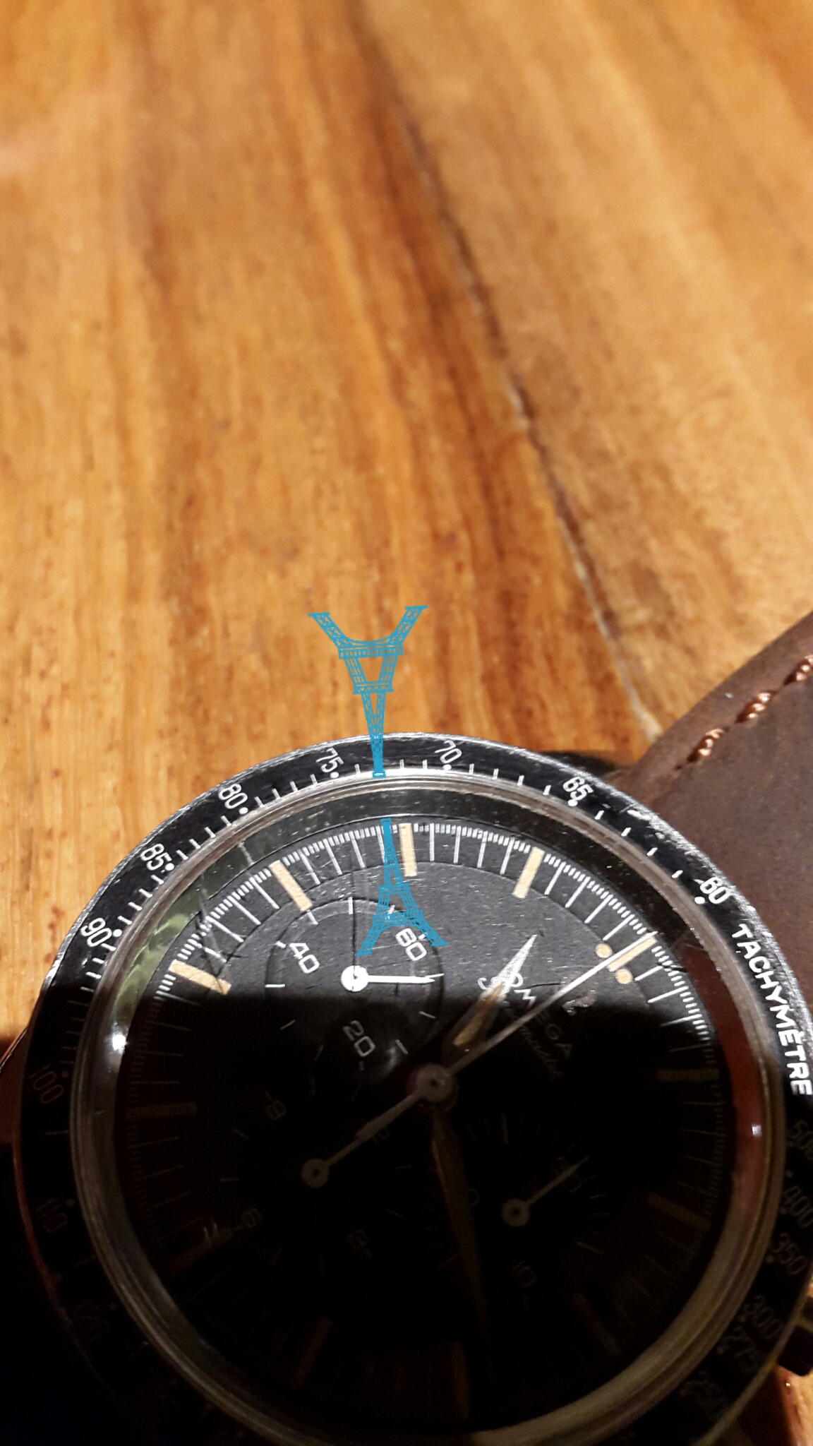

  1. earth38 Sep 4, 2015
    114
    211
    What is the name of the part between the blue arrows?? Can it be replaced and easily acquired?
    Thanx
  2. Barking mad Prolific Speedmaster Hoarder Sep 5, 2015
    4,540
    64,574
    It is the rehaut for the crystal. It comes with the crystal and they are readily available and it should be the silver one for your watch.
    Cheers
  3. flyingout Sep 5, 2015
    693
    700
    Eiffel tower.
    No, wait… The Mad One beat me to it as I was typing.
    ock2915 likes this.
  4. oddboy Zero to Grail+2998 In Six Months Sep 5, 2015
    9,217
    23,880
  5. earth38 Sep 5, 2015
    114
    211
    Ok. Rehaut is the same as "white ring"??
    Thanx
  6. watchlovr Sep 5, 2015
    1,751
    2,460
    Silver ring
  7. oddboy Zero to Grail+2998 In Six Months Sep 5, 2015
    9,217
    23,880
    Yes. The rehaut is the ring between the dial and the edge of the case. In omega parts speak, 'white' means silver. That's the one you want.
  8. Georgieboy58 Sep 5, 2015
    576
    856
    That's in general jeweller's speak, at least I know it like this from the strap buckles.
    If they are not made of silver or gold, they are not called silver or gold, but white or yellow, to avoid any potential misunderstandings.
    oddboy likes this.
  9. TNTwatch Sep 5, 2015
    2,876
    1,950
    Rehaut is actually a misnomer regarding the Speedmaster. I've never seen a watchmaker called it a rehaut. It's just a tension ring for the acrylic crystal. It can be called a rehaut if it's used for elevating the crystal above the hands/dial. Most acrylic crystals are already curved and have no need for a rehaut. Without the tension ring, the crystal would sit just fine in it's place.
    Yours looks like a white/silver one already. Any problem with it? Is that a 2998-1 or 2998-2? More pictures please.
  10. Archer Omega Qualified Watchmaker Sep 5, 2015
    26,463
    65,604
    In this case it's a tension ring, because it does add tension to make the crystal fit and stay in place properly. Not all crystals that look like this and have a metal ring, have a proper tension ring. Some metal rings are called a "reflector ring" that adds no tension to the crystal fit.
    And yes, in trade speak anything silver is "white" and anything yellow gold is "yellow". Tension rings, crowns, etc. all use this, and certainly not specific to Omega.
    Cheers, Al
    Seaborg likes this.
  11. earth38 Sep 5, 2015
    114
    211
    Thanx for all the usefull info.
