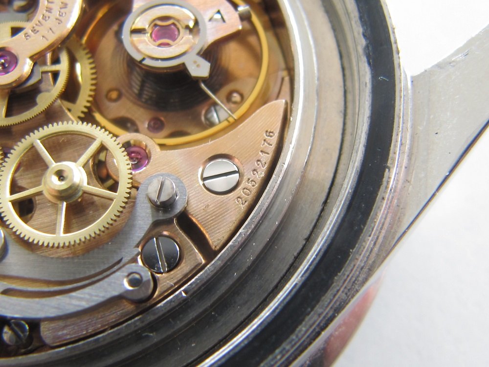

Hi, thanks for that. The warranty card isnt dated. But the serial number is 20522176 which i think is 1963. It was my grandads, hes passed recently so cant ask him anything about it unfortunately.
This serial though is correct for a -63.

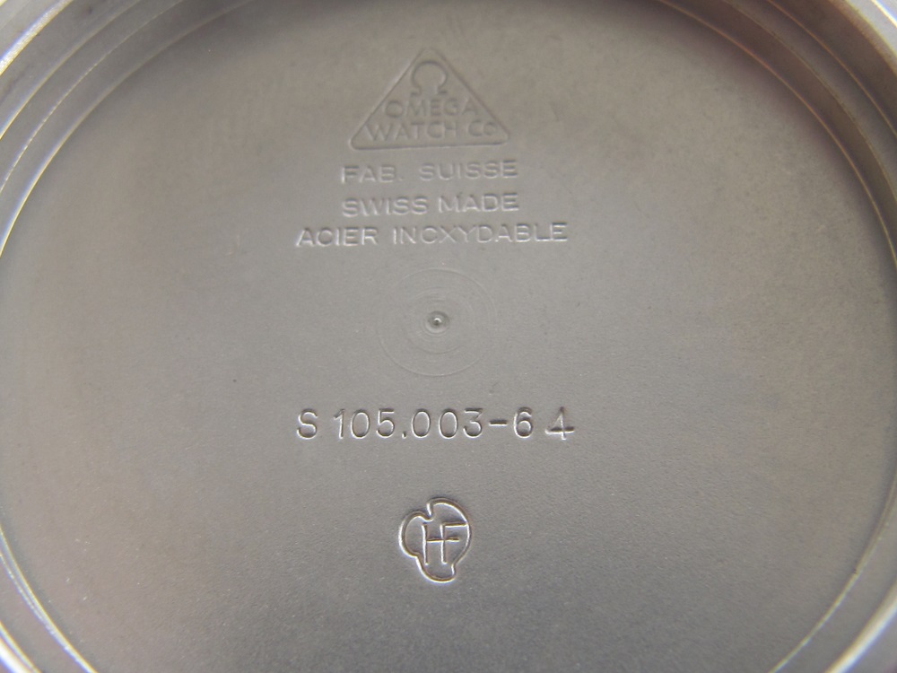

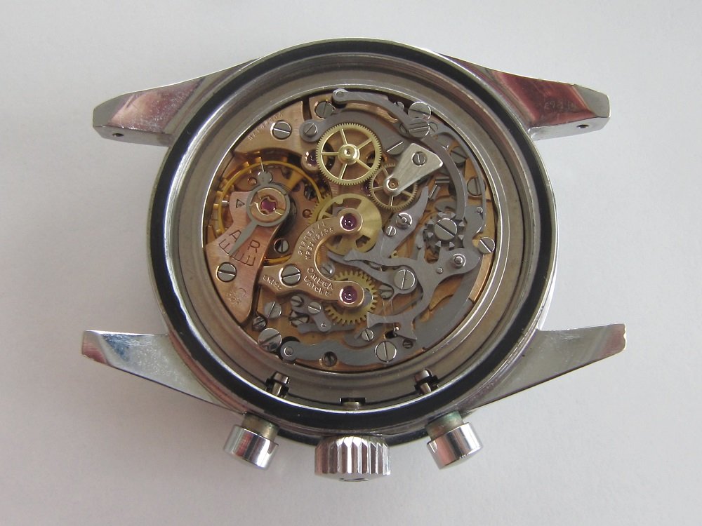

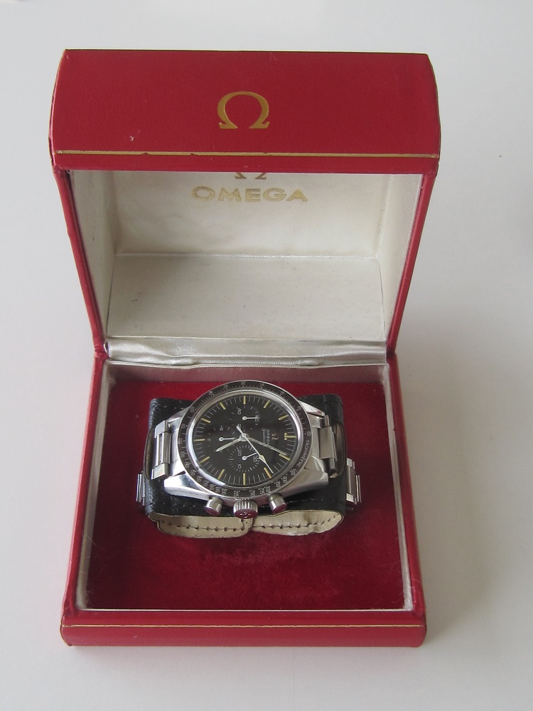

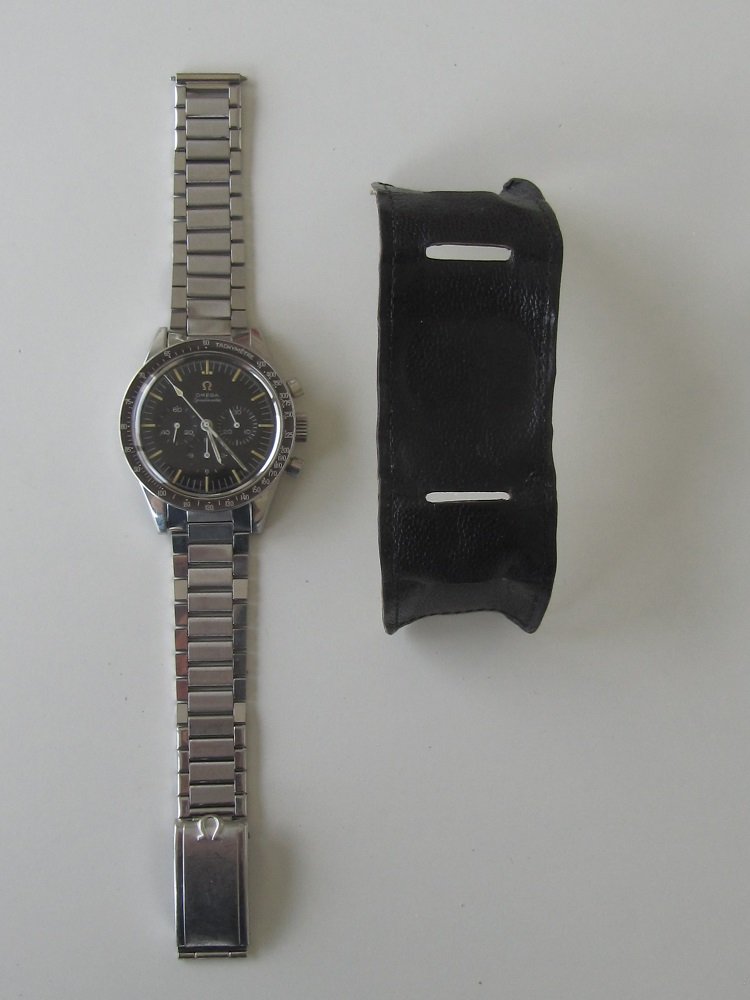

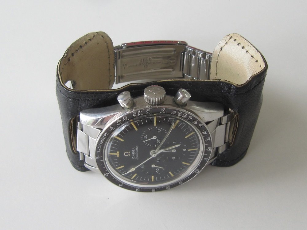

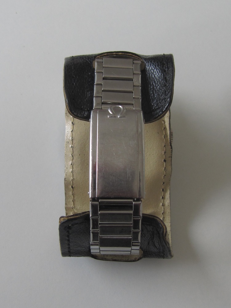

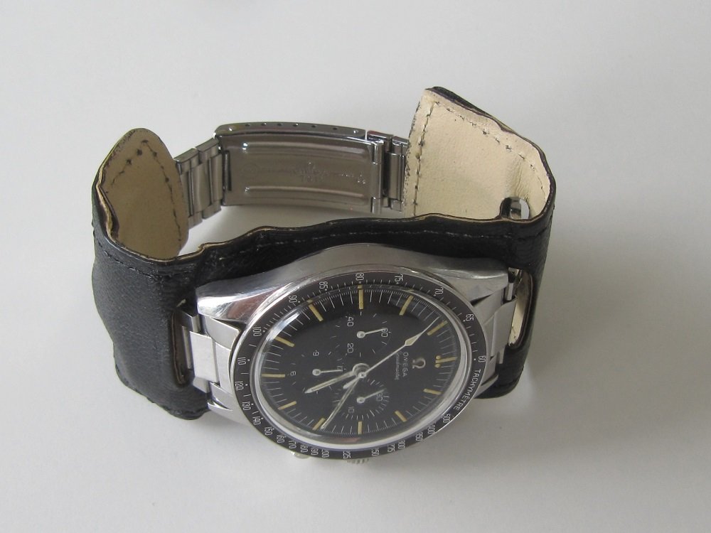

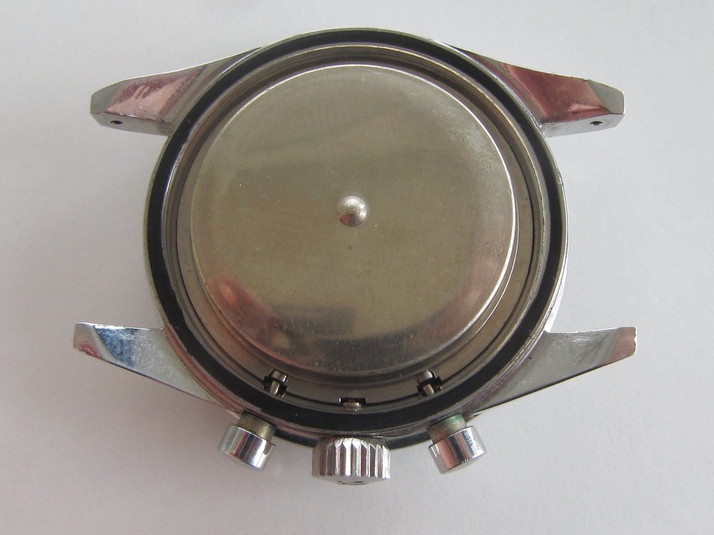

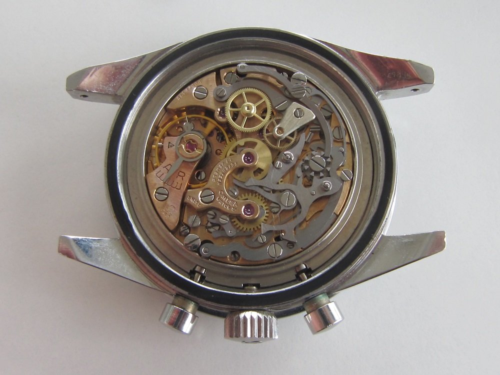

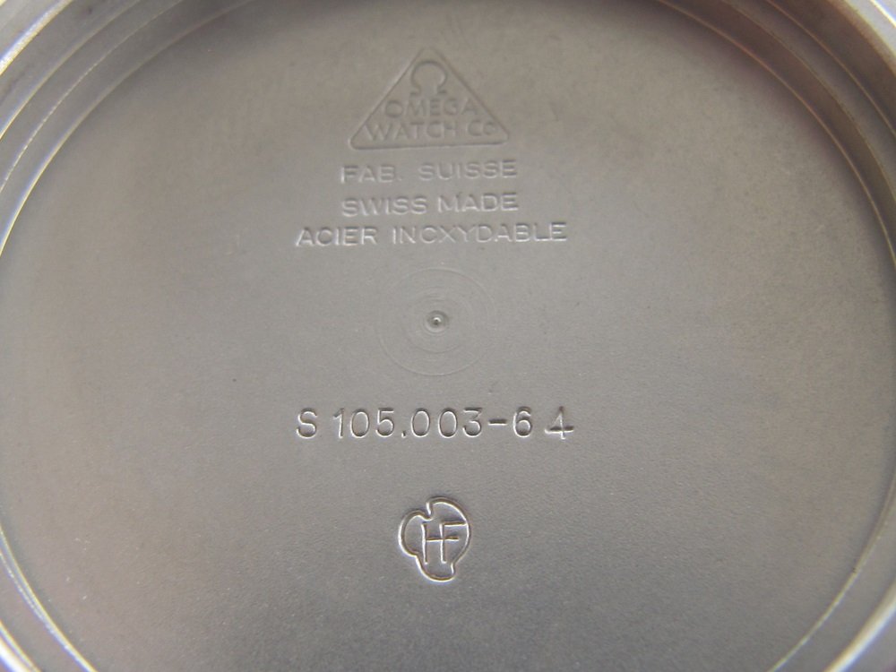

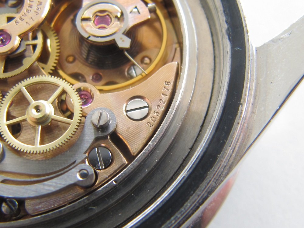

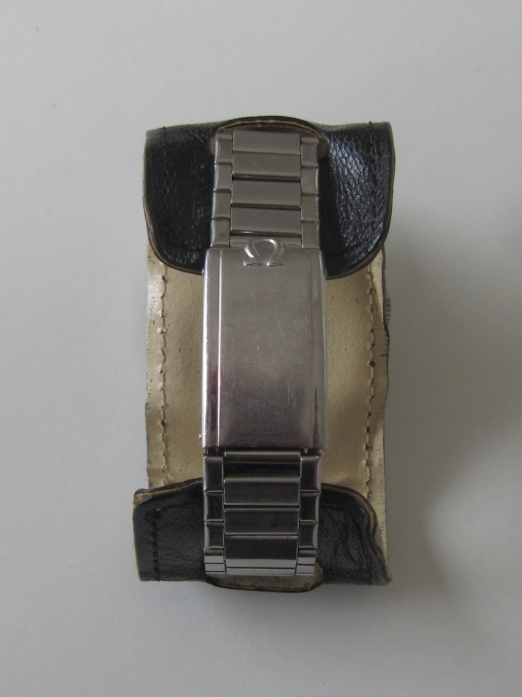

Hi OF,

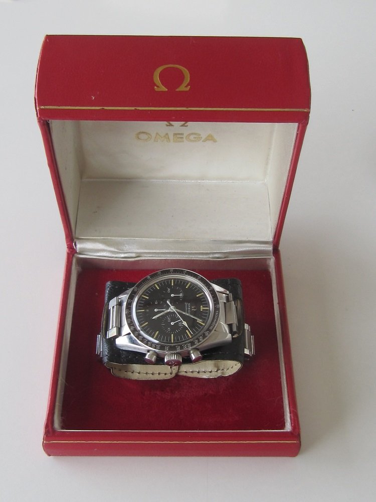

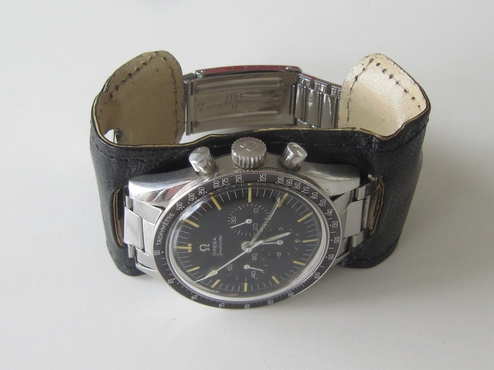

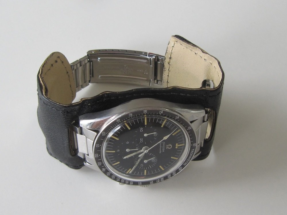

this watch ended up in my hands after a complicated journey through Europe. So I think it is fair to give a little update here. Hope we can shed some light on this mystery. It came with this very individual underlaying leather-like strap (I think it is fake-leather) that reminds me a bit of the WWI trenchwatch straps and immedately made me wonder: how come...? Was the pre-owner allergic agains the steel? But the clasp would still touch the skin. Or was he tired of his hairy wrist getting shaved by the steel bracelet? Or was it for aesthetic reasons to match the trendsetting standards of the 1970ies? Never seen this combination before....

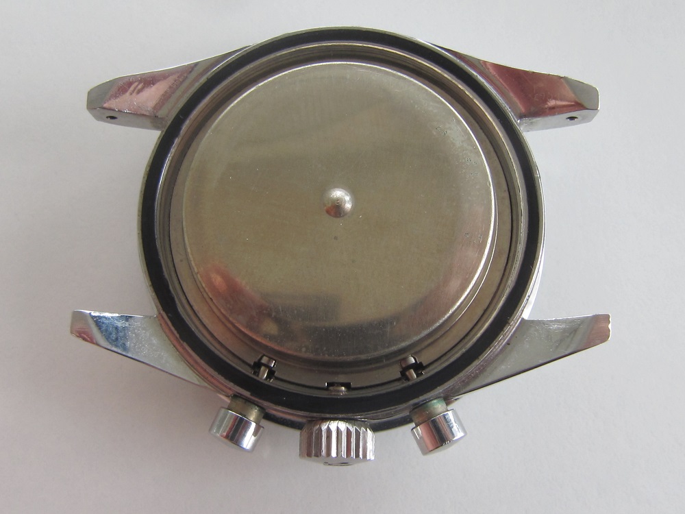

232
342

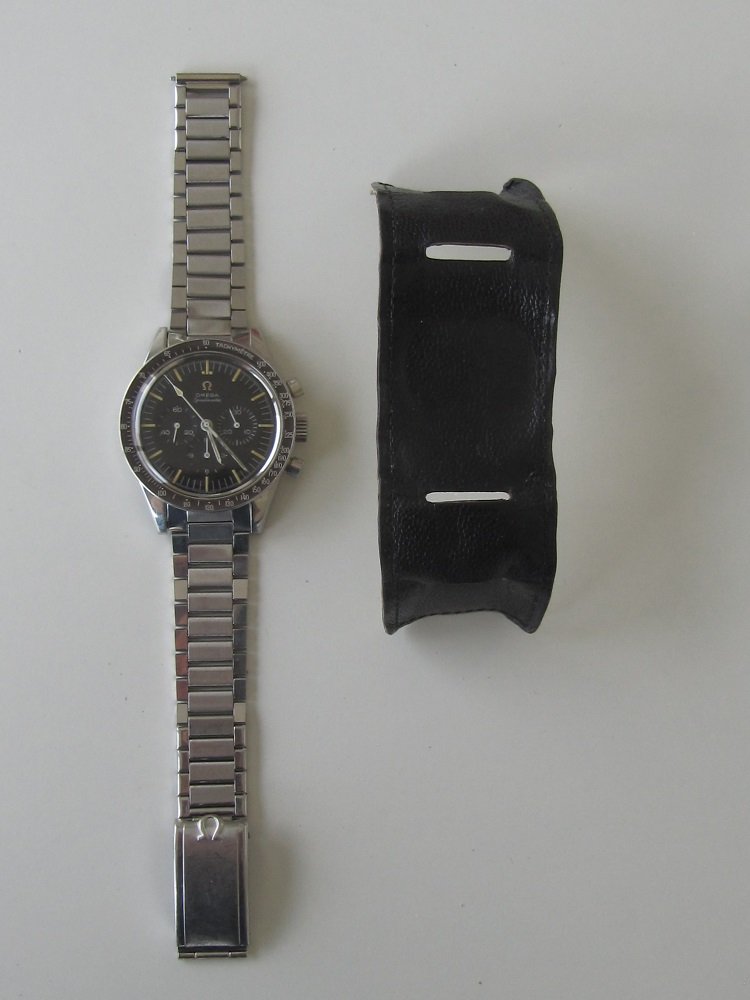

Its a 105.003-64 according to the inner of the back. Movement nr. should correspond to this. Seems not to be abused too much. Functioning except reset. Not a big issue as far as I can see:
