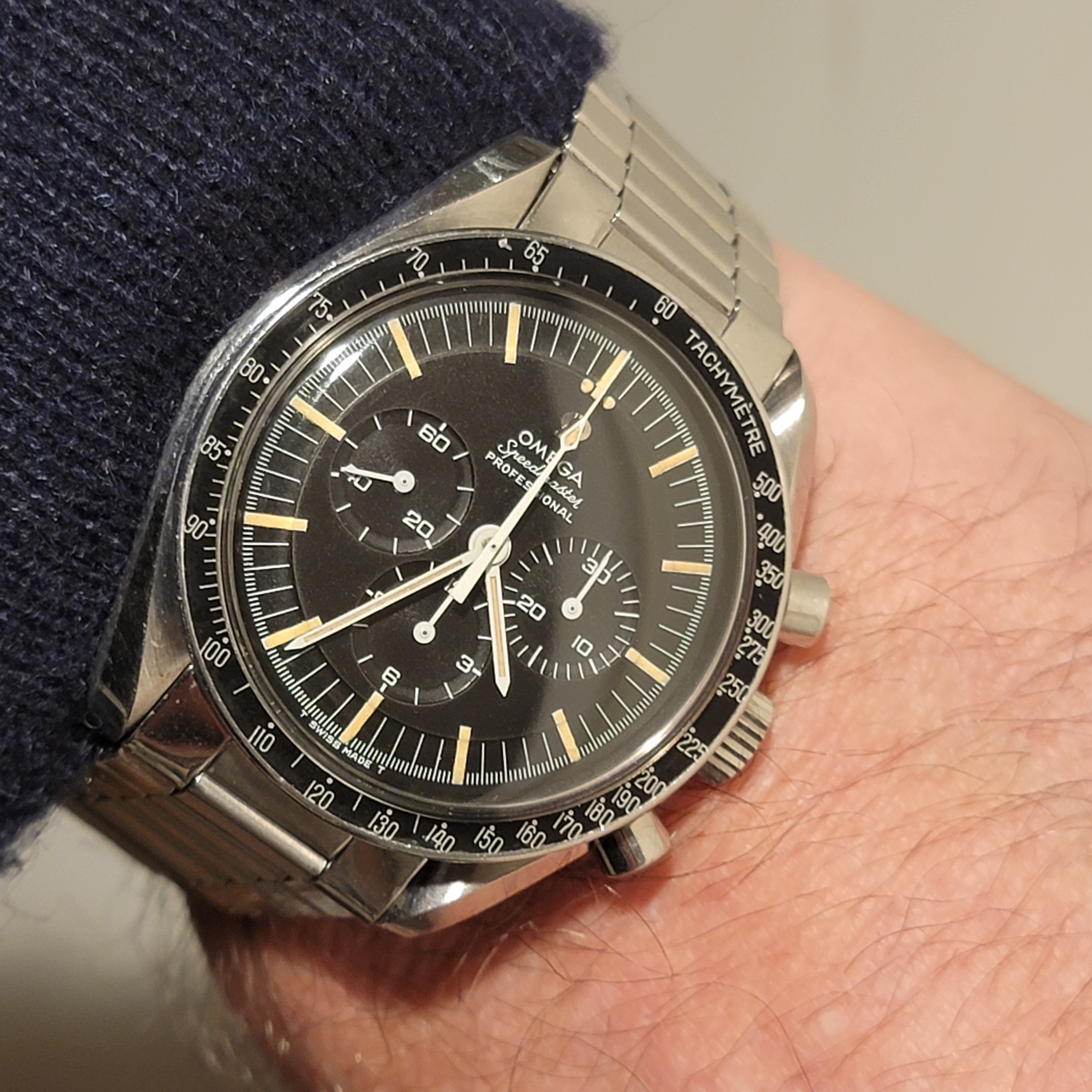

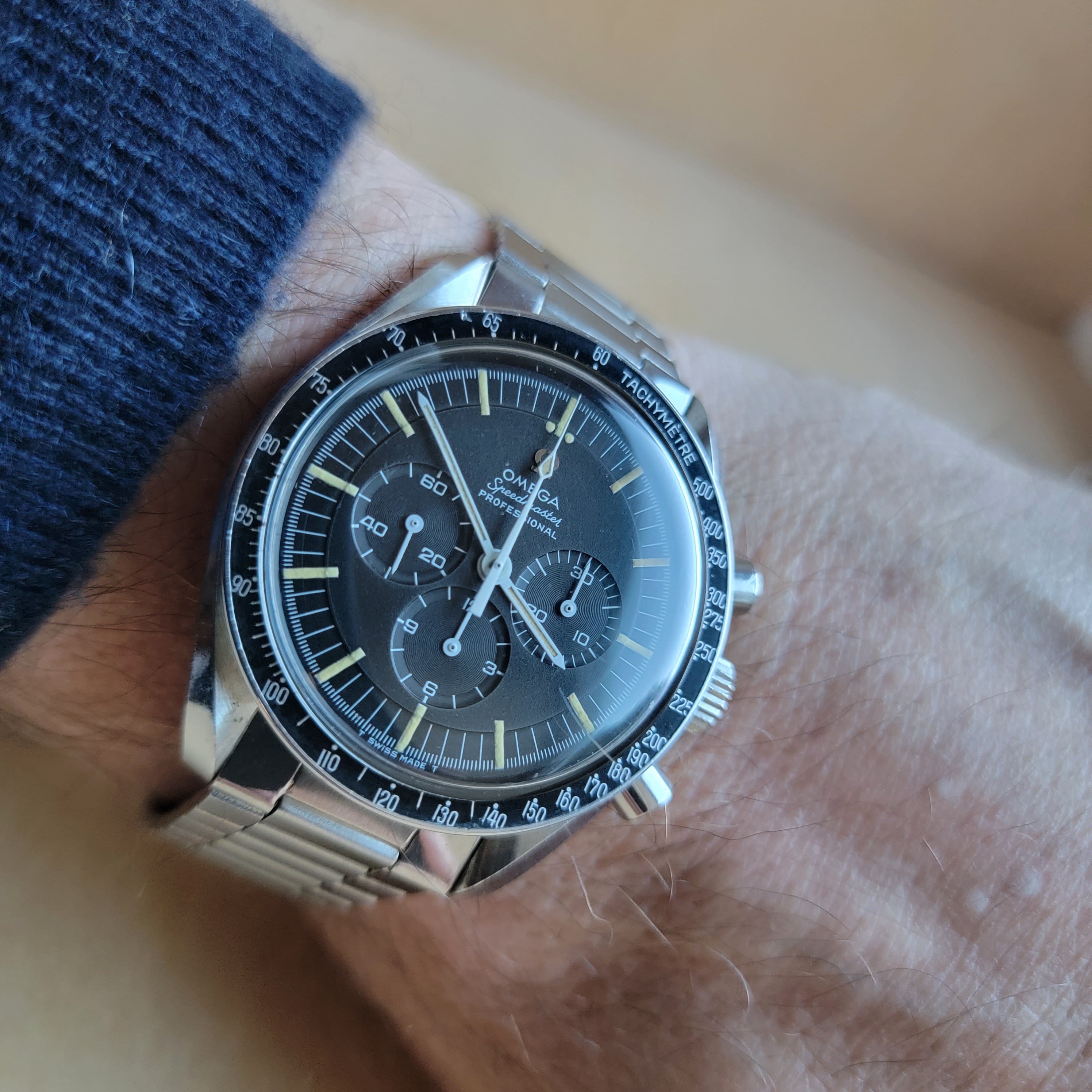

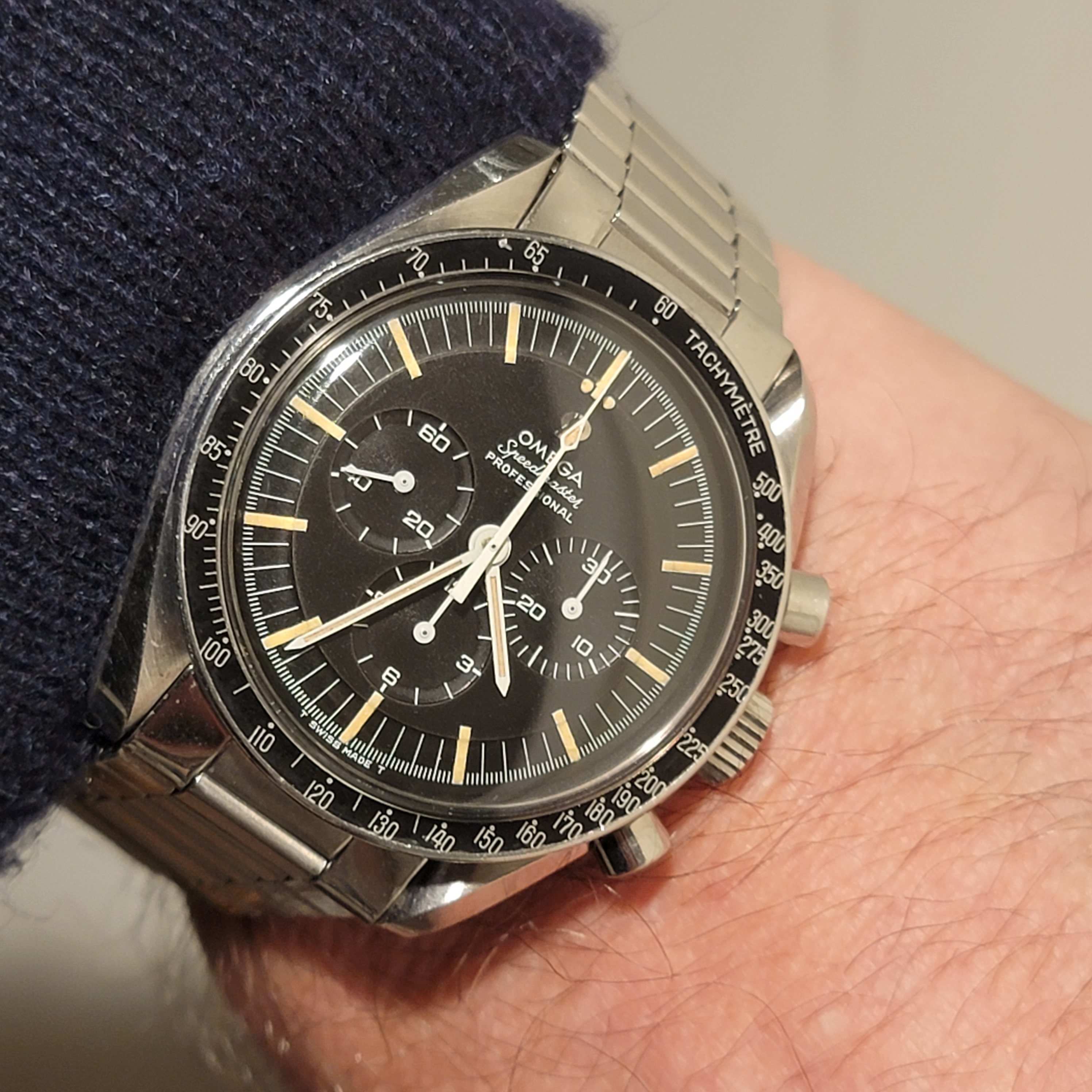

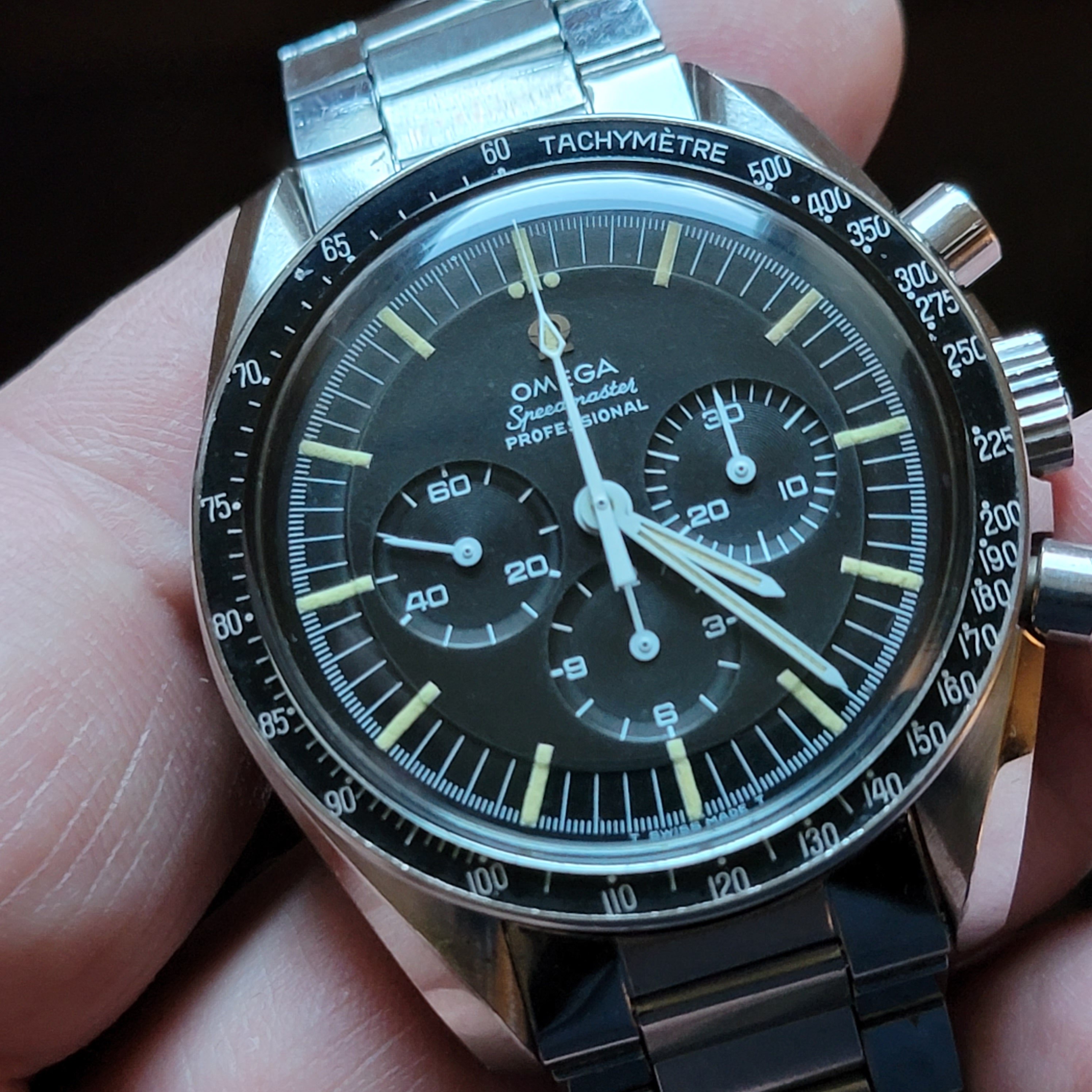

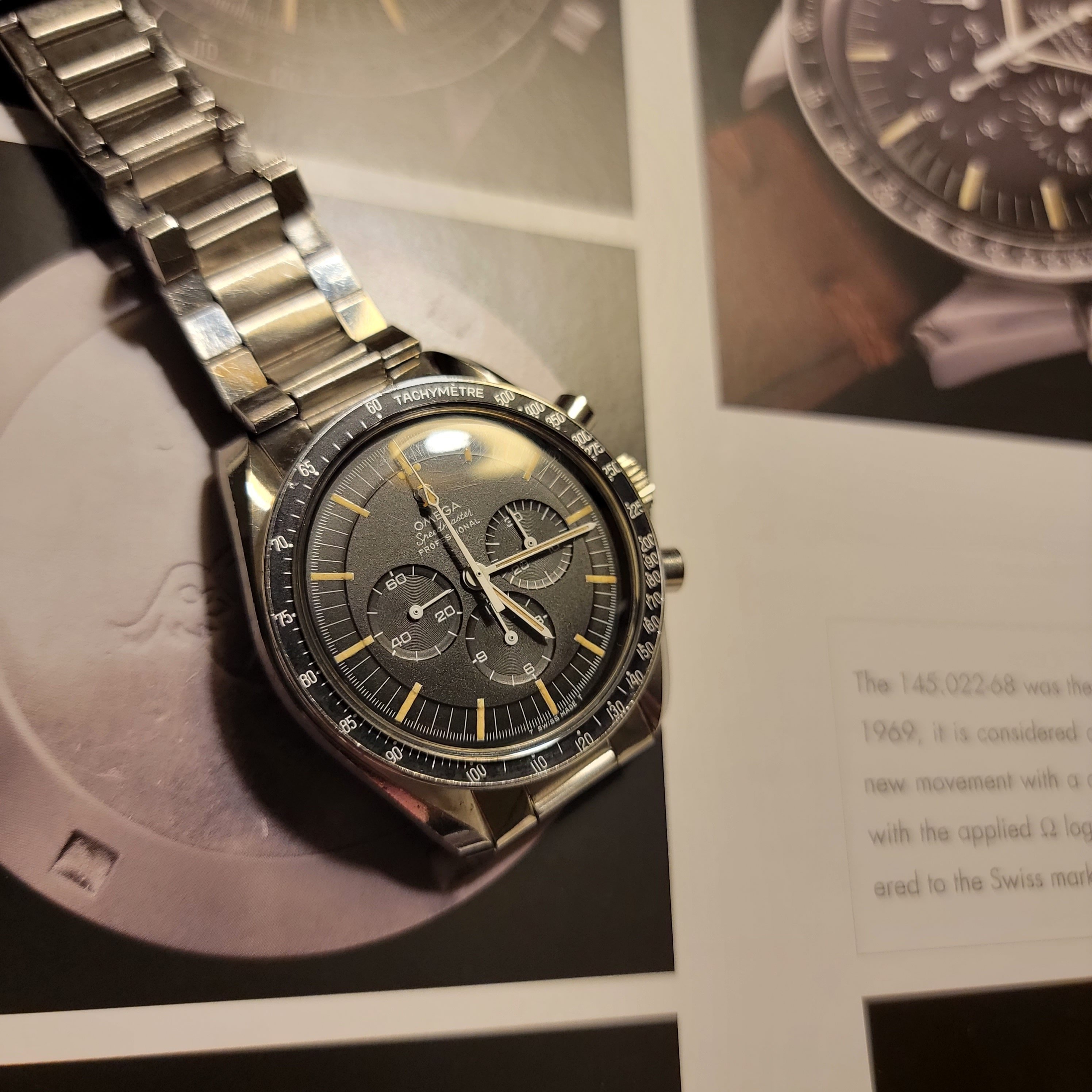

So let's go through the watch that Dave has fortunately won on an auction?
He has handled a few of them, so respect for his assessment.
I have a soft spot for these 68:s, and have a couple, although not in this condition.
I usually follow Dear @Spacefruit lovely protocol:
We have the shared pictures (not so many), and also the statement from the auction house.
And since the auction house is one of the bigger (more serious/honest/better knowledge),
I do think and hope that we can trust them.

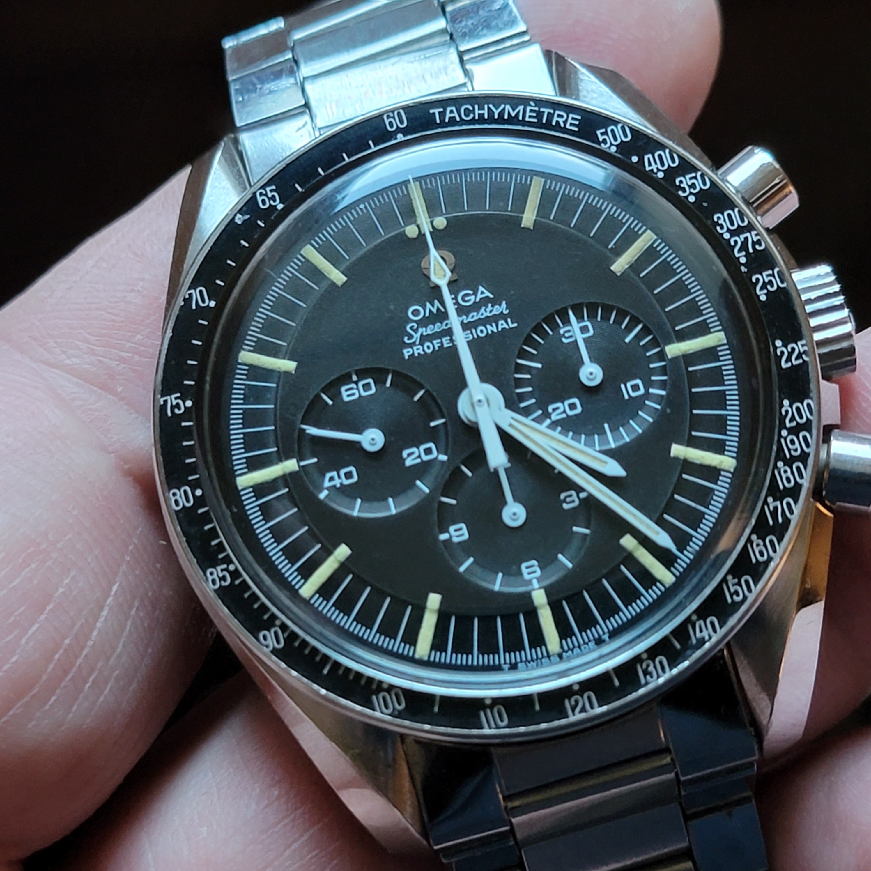

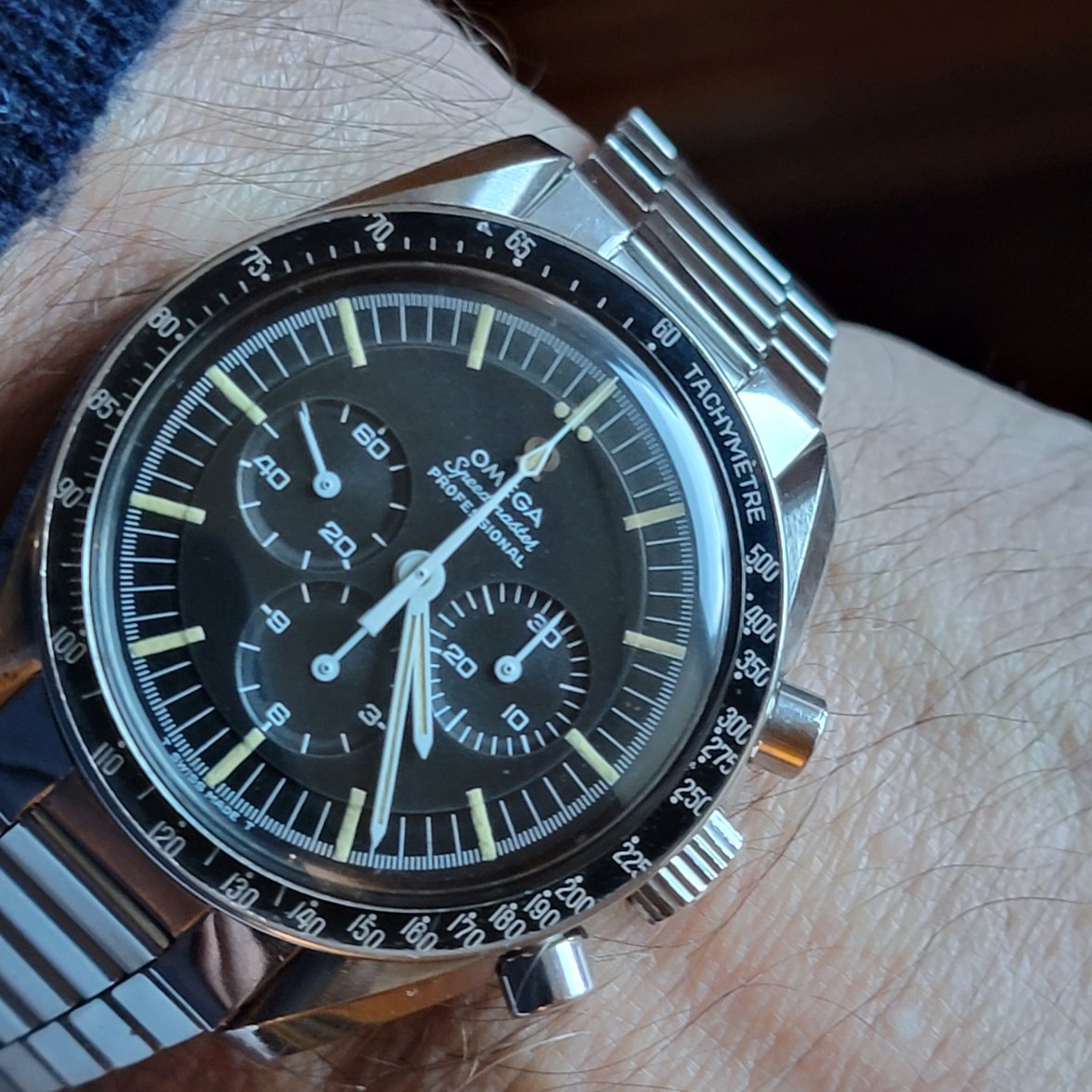

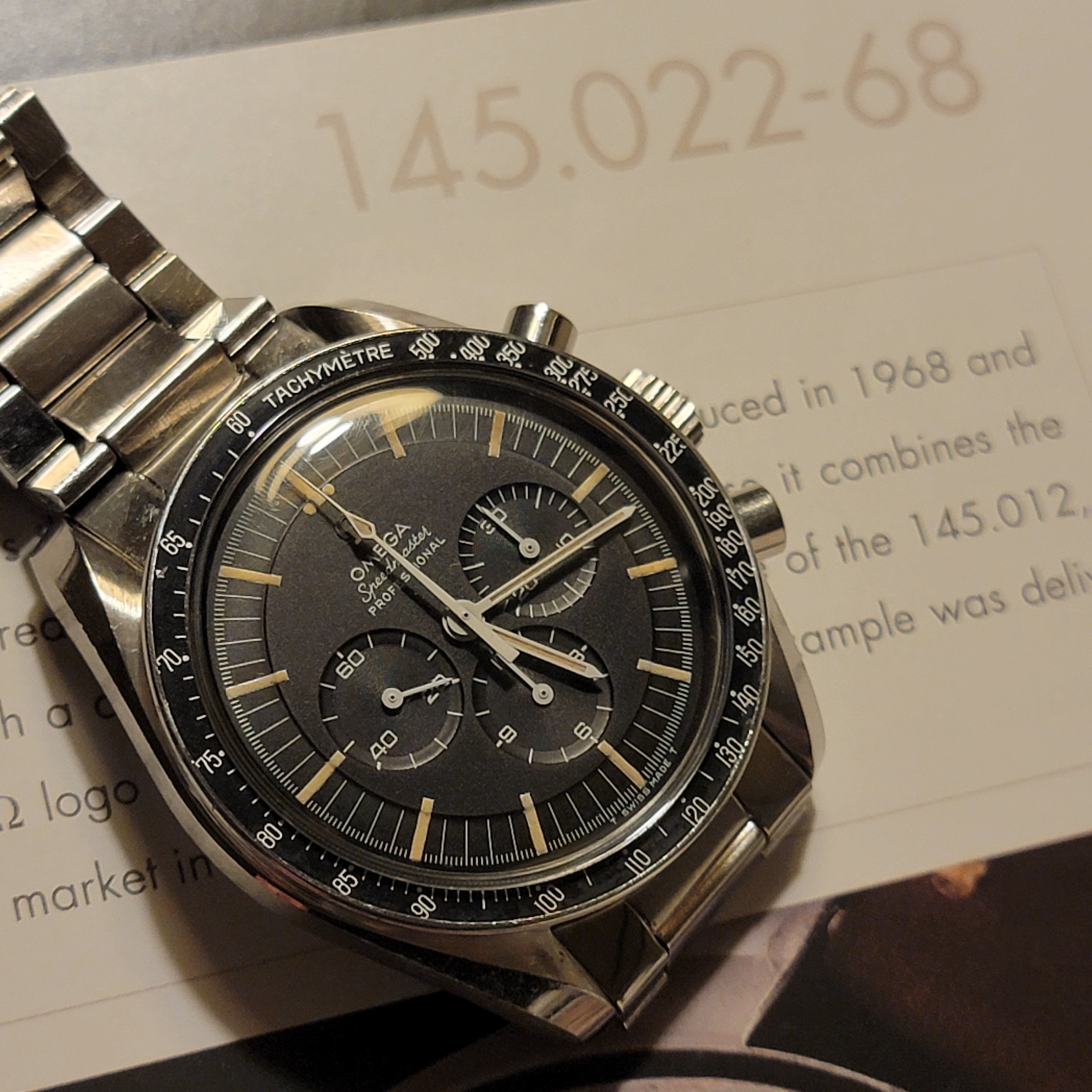

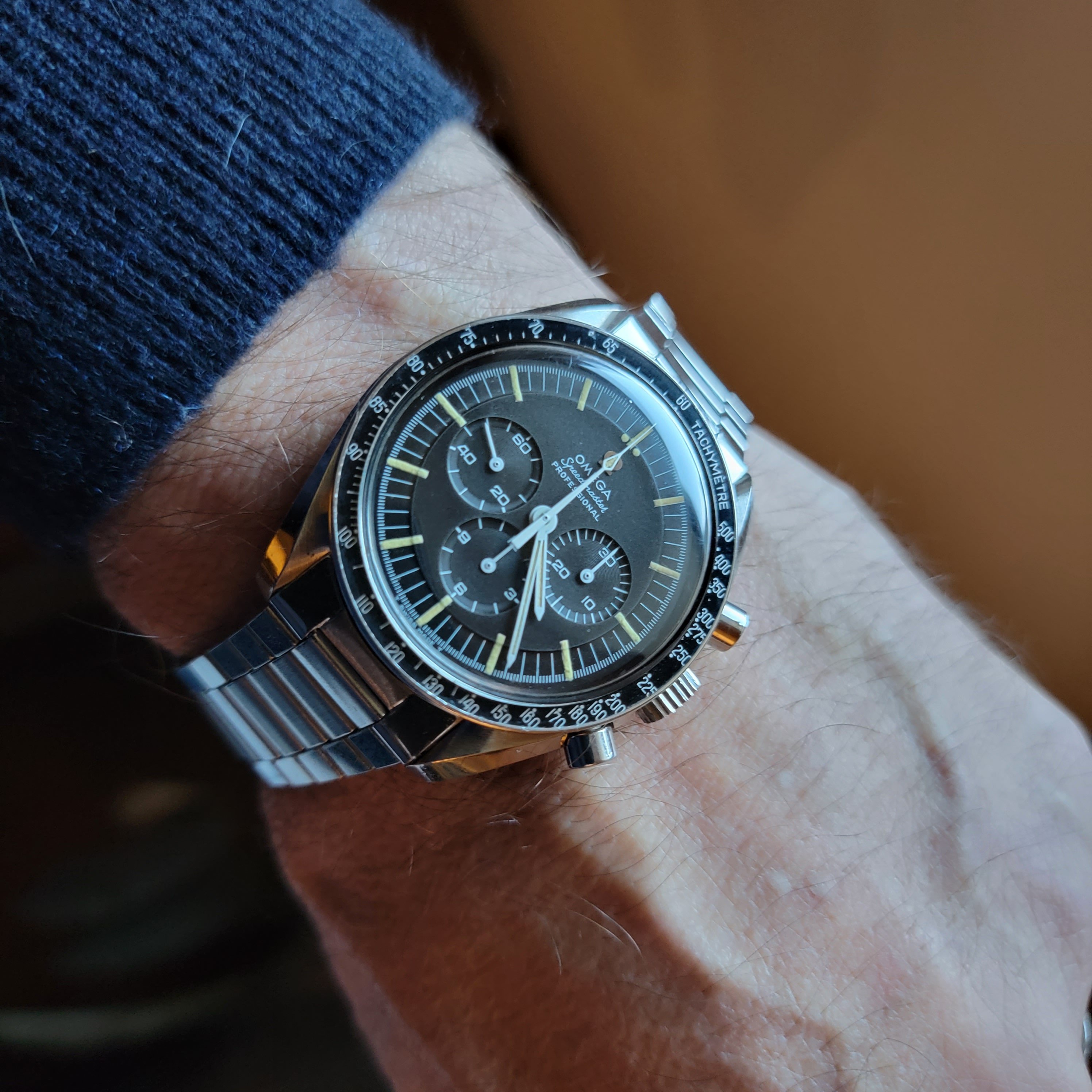

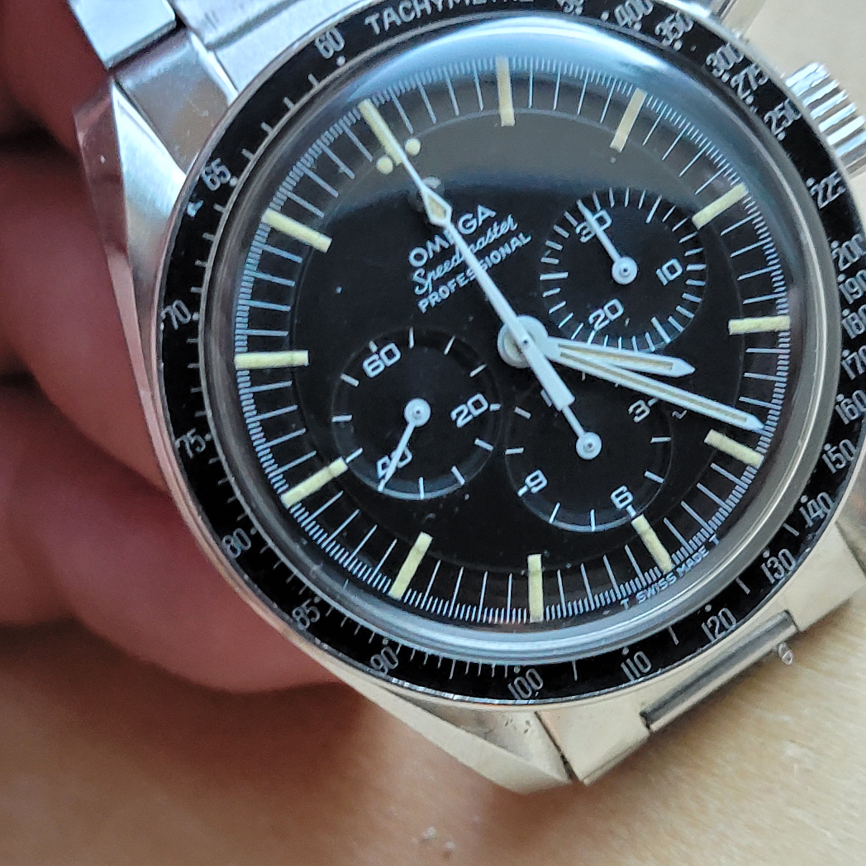

The dial:
I cannot find any spots or blemishes on it, and the color looks like the jetblack that 68s normally have.
It would have been nice to have a few more pictures from different angles,
but we have to work with what we have.
If the watch had never had a service, we could assume that the dial doesn't have any spots/blemishes?
The few that could be found would be on the crystal.
So very good here

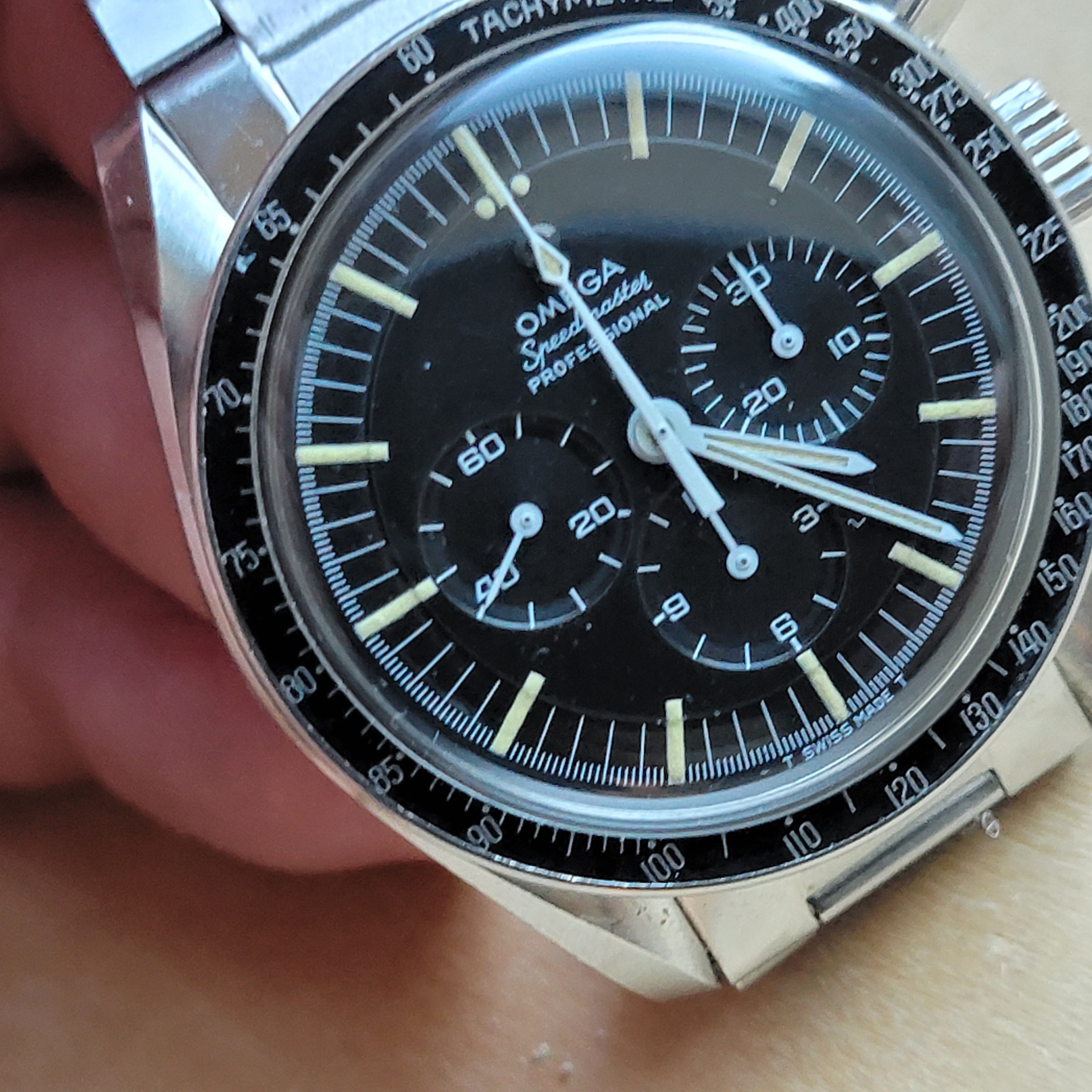

Lume plots:
I have tried my best to zoom in and out, and I would go for untouched, maybe not the most sexy, but all are complete,
they have some dirt/age and have a nice constant mustard color.
Depending on your taste-
Good/Very Good

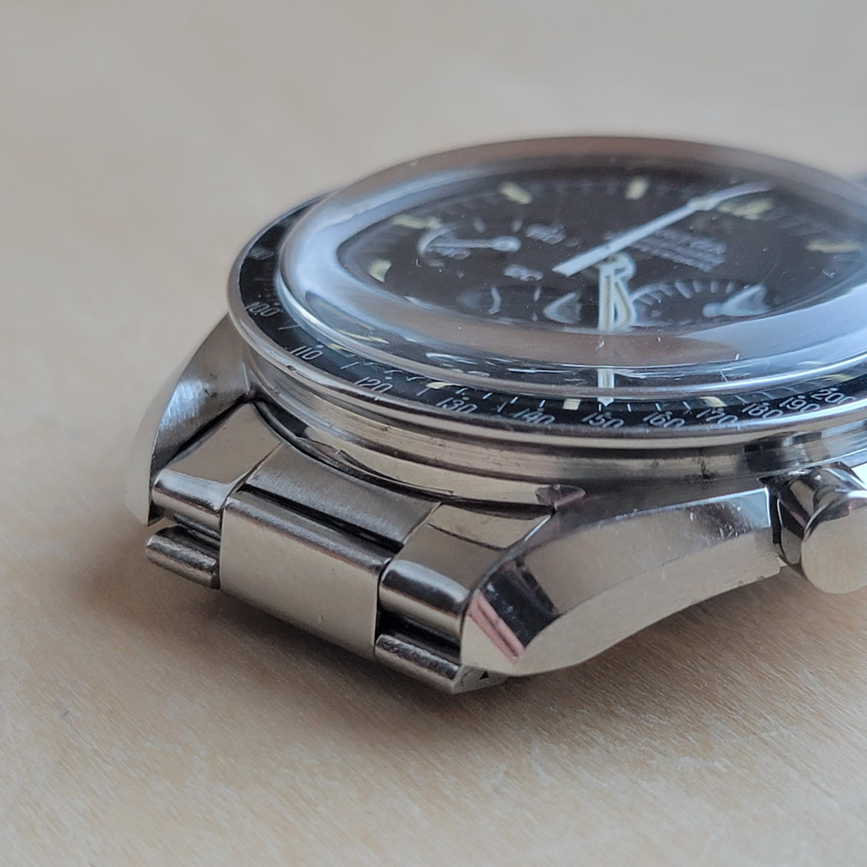

Bezel:
A few small ding at the 60, and 66, but nothing that bothers, and these makes the watch more trustworthy!
So very good here

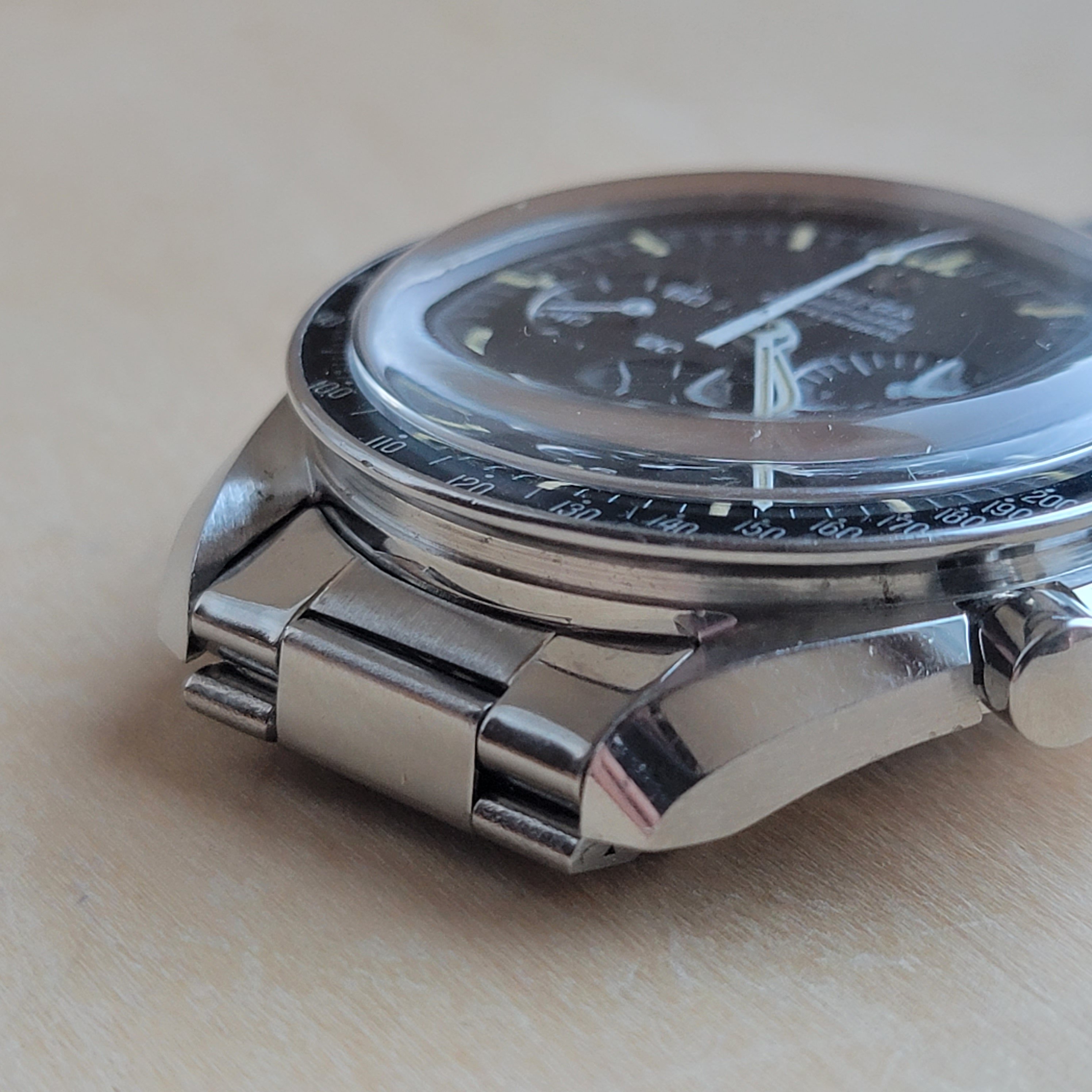

Case:

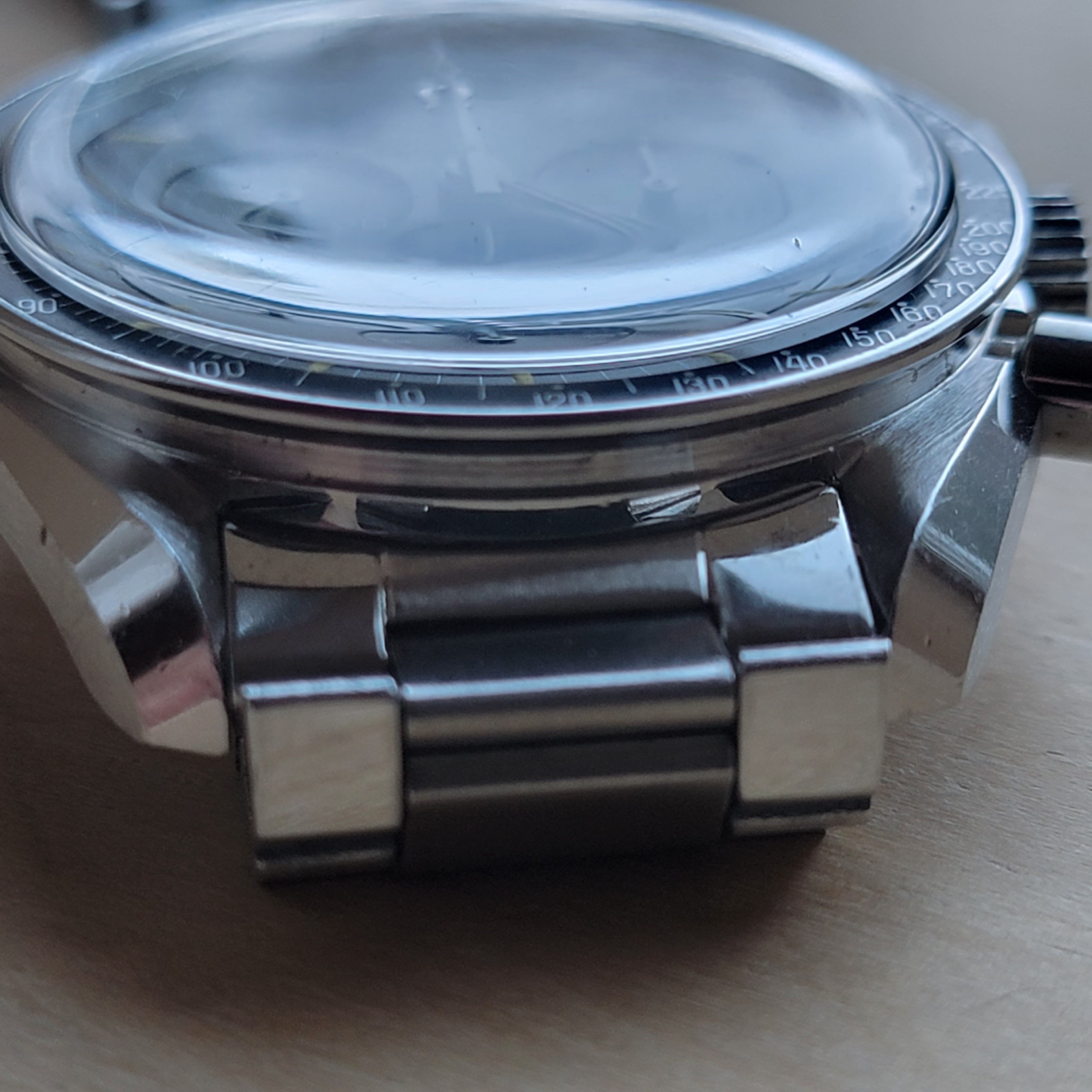

Very nice and sharp lines, lots of brushing left, and only a few dings/marks.
Very good
Case back:
Cant see it, but I would go for Very good here since the case has so nice features.
Hopefully there are no scratches from opening up the watch?
Hands:
The lume has the same color/tone as the lumeplots,
And no marks from a watchmaker, the white color is almost complete.
And looking at the hands on the sub dials, these look perfect and untouched.
Very Good here

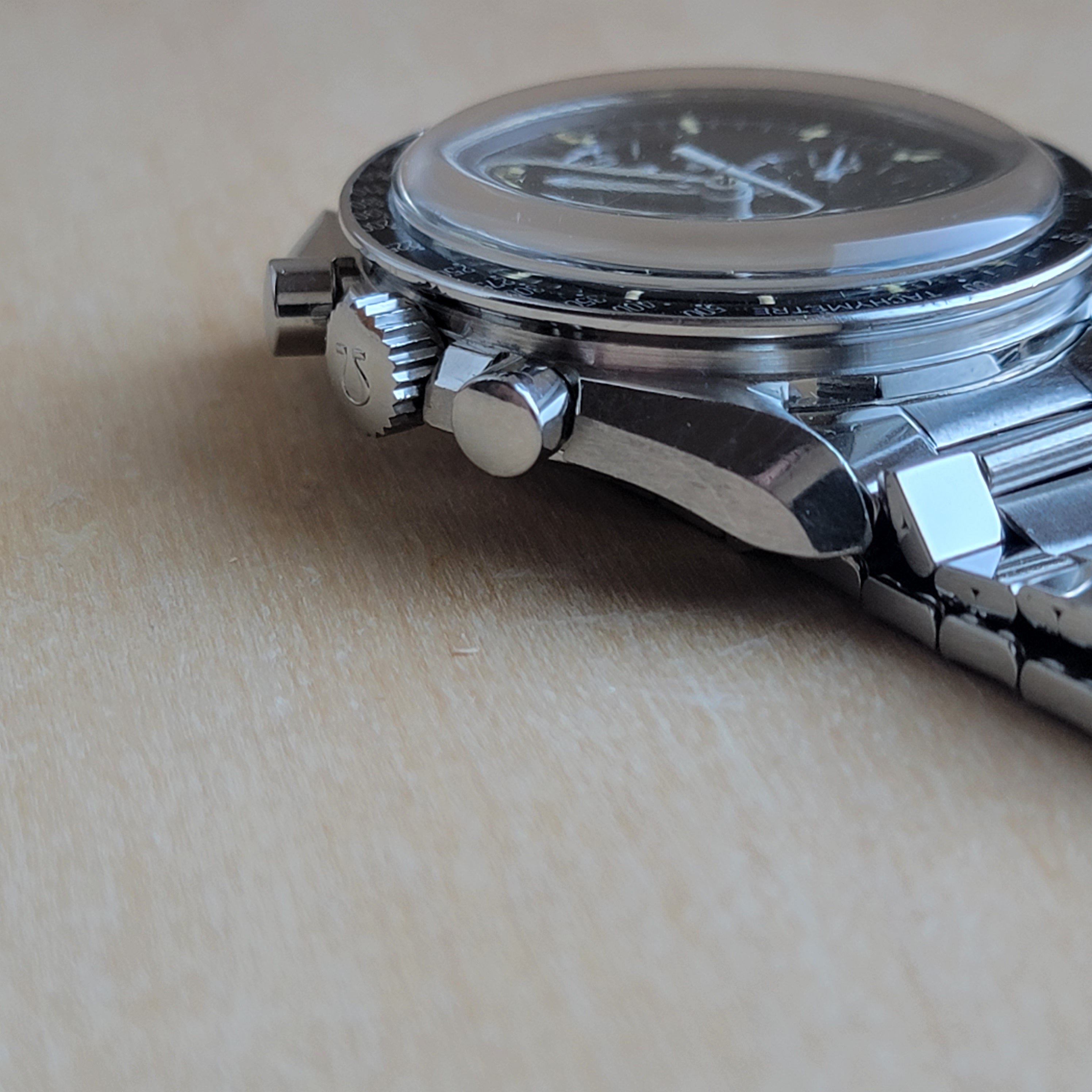

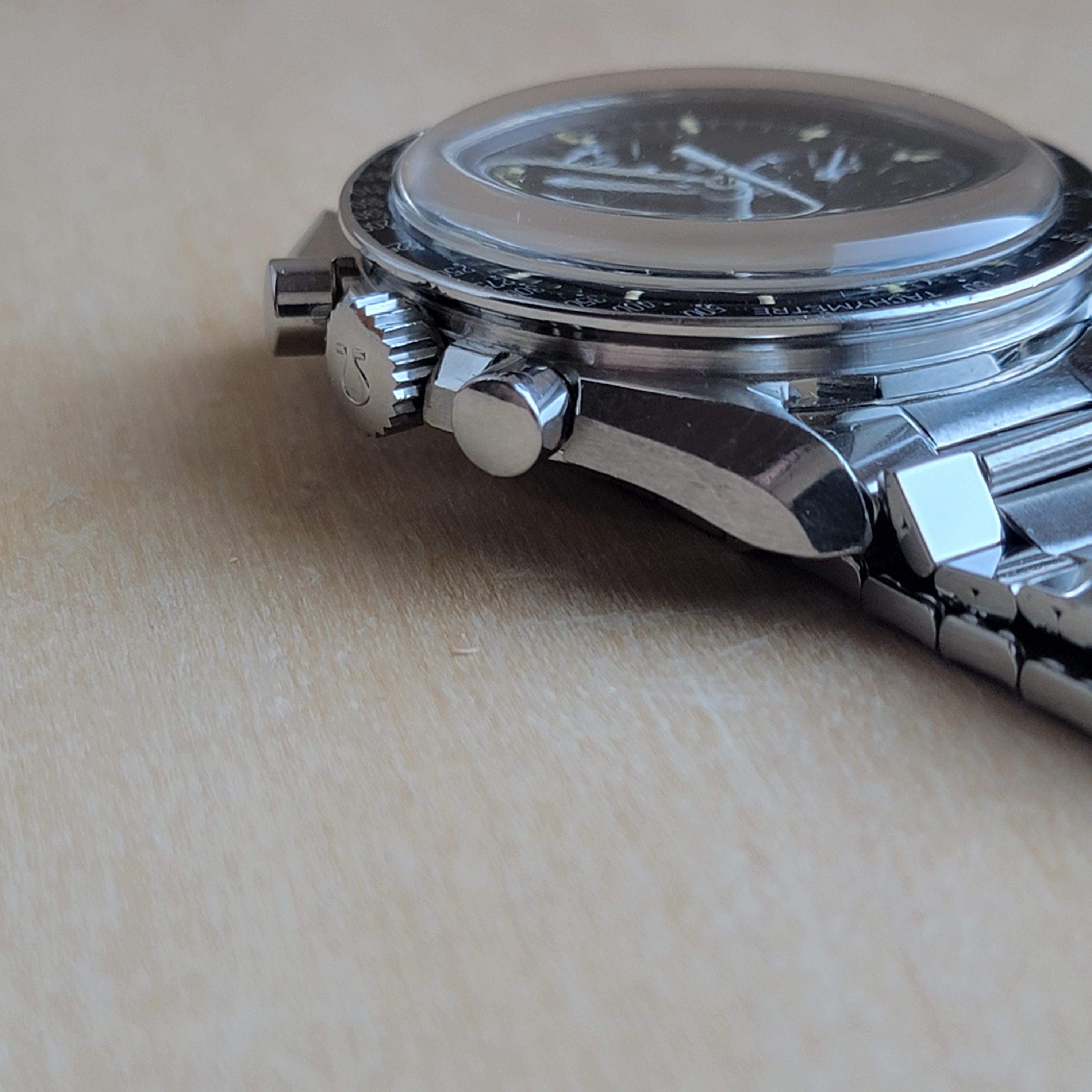

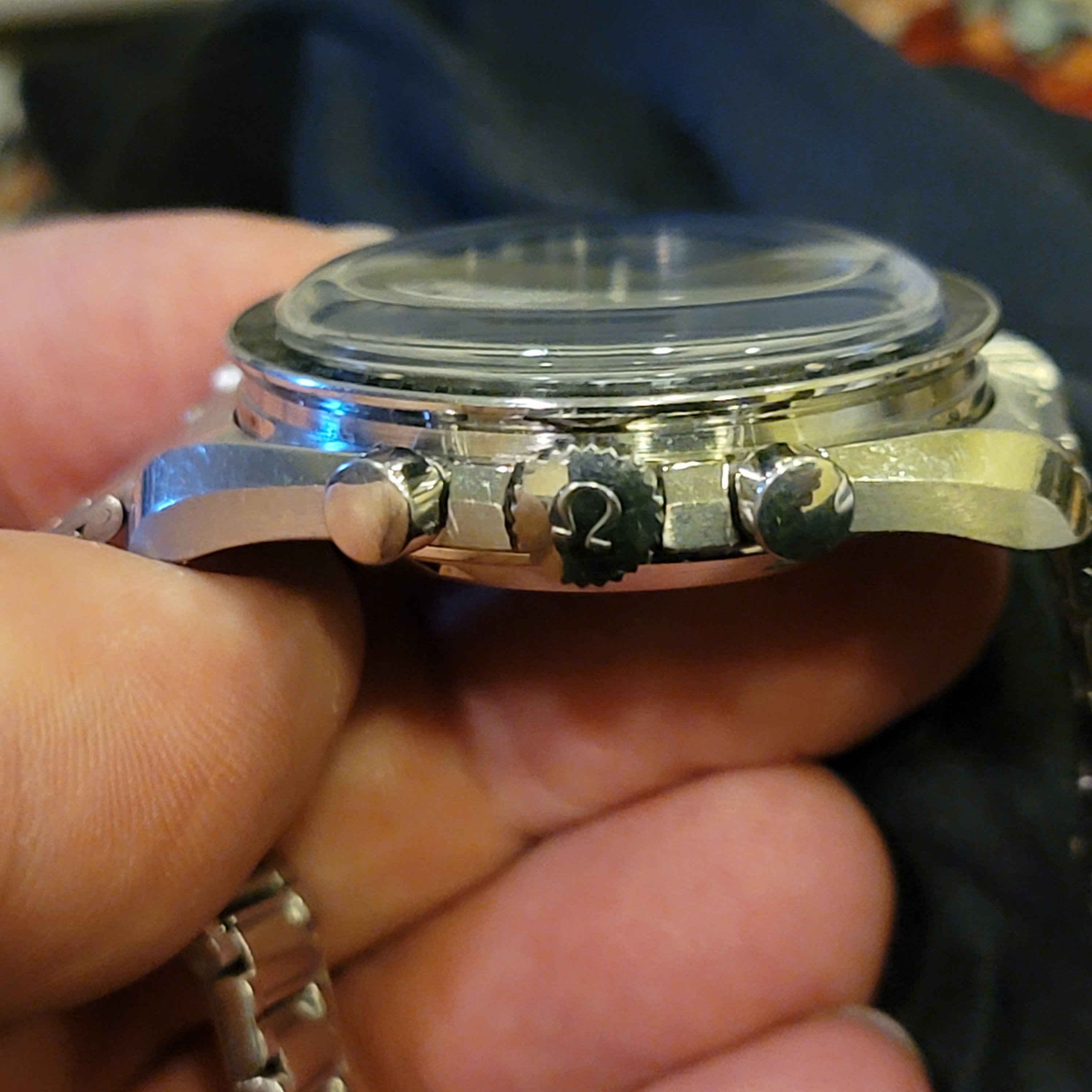

Crown and pushers:
The crown is the flatfoot, and that is just lovely (I have had my ”beatings" regarding this…)
But the pushers looks so clean, that would make me wonder a bit regarding service?
Or could the watch have been sleeping most of its life?
Very good for these

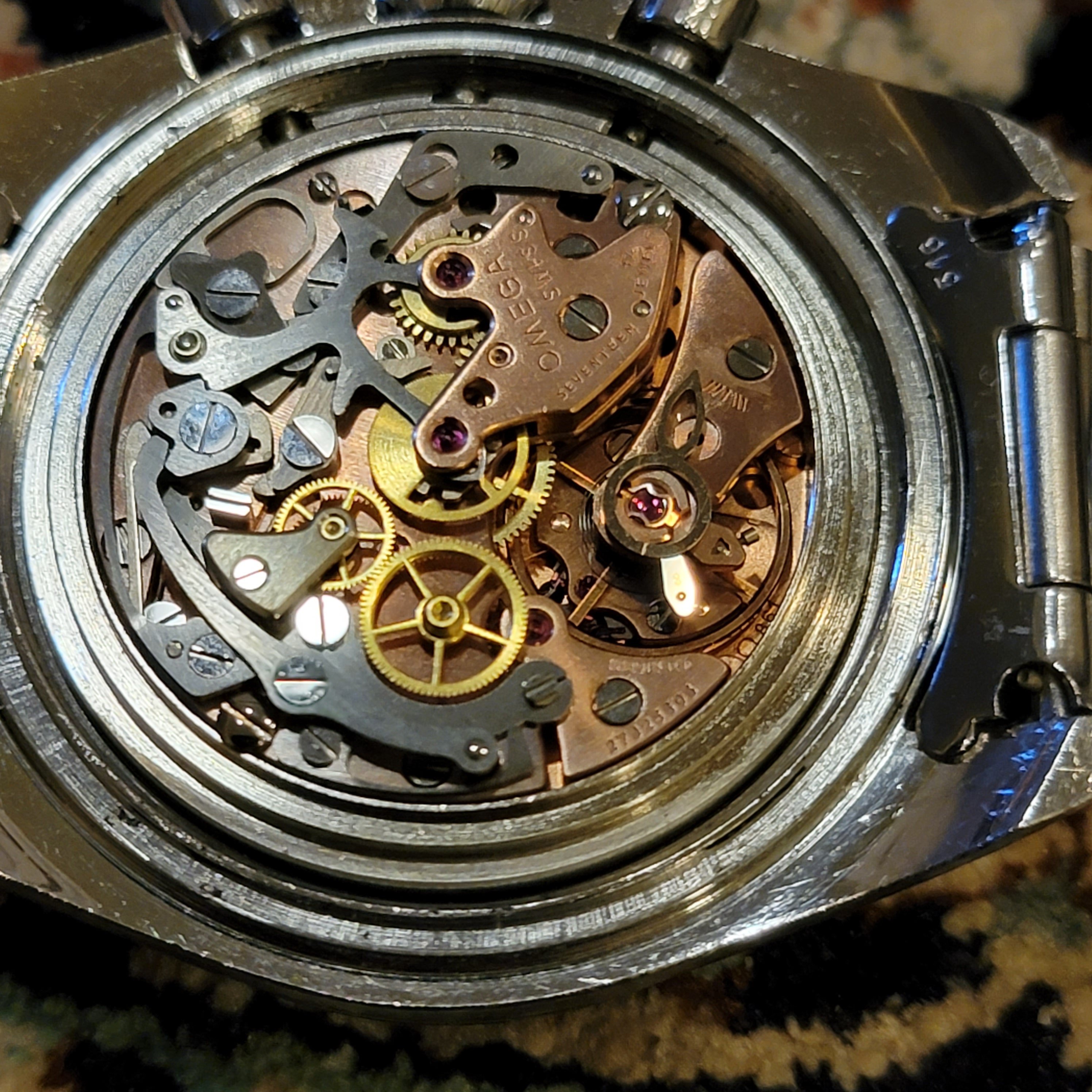

Movement:
No pictures, which is not so normal?
But we have to trust the statement, and after a service it should also be Very Good (maybe excellent)
The crystal:
No scratches or marks, I cannot see the Omega logo, but going for original since the watch has the nice overall condition.
And we have Mr Roberts - Do you like the watch, does it make you happy?
For me - I would gladly have this watch!
I have followed a couple of auctions recently with 68:s that have had similar condition to this one, and they went for much more!

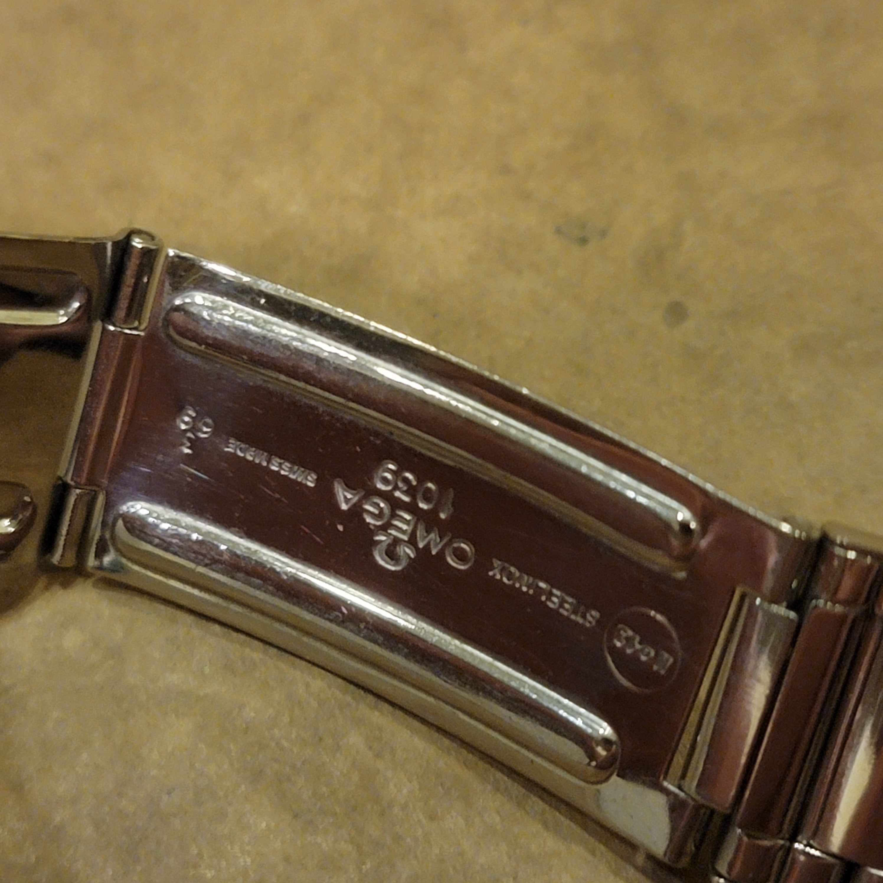

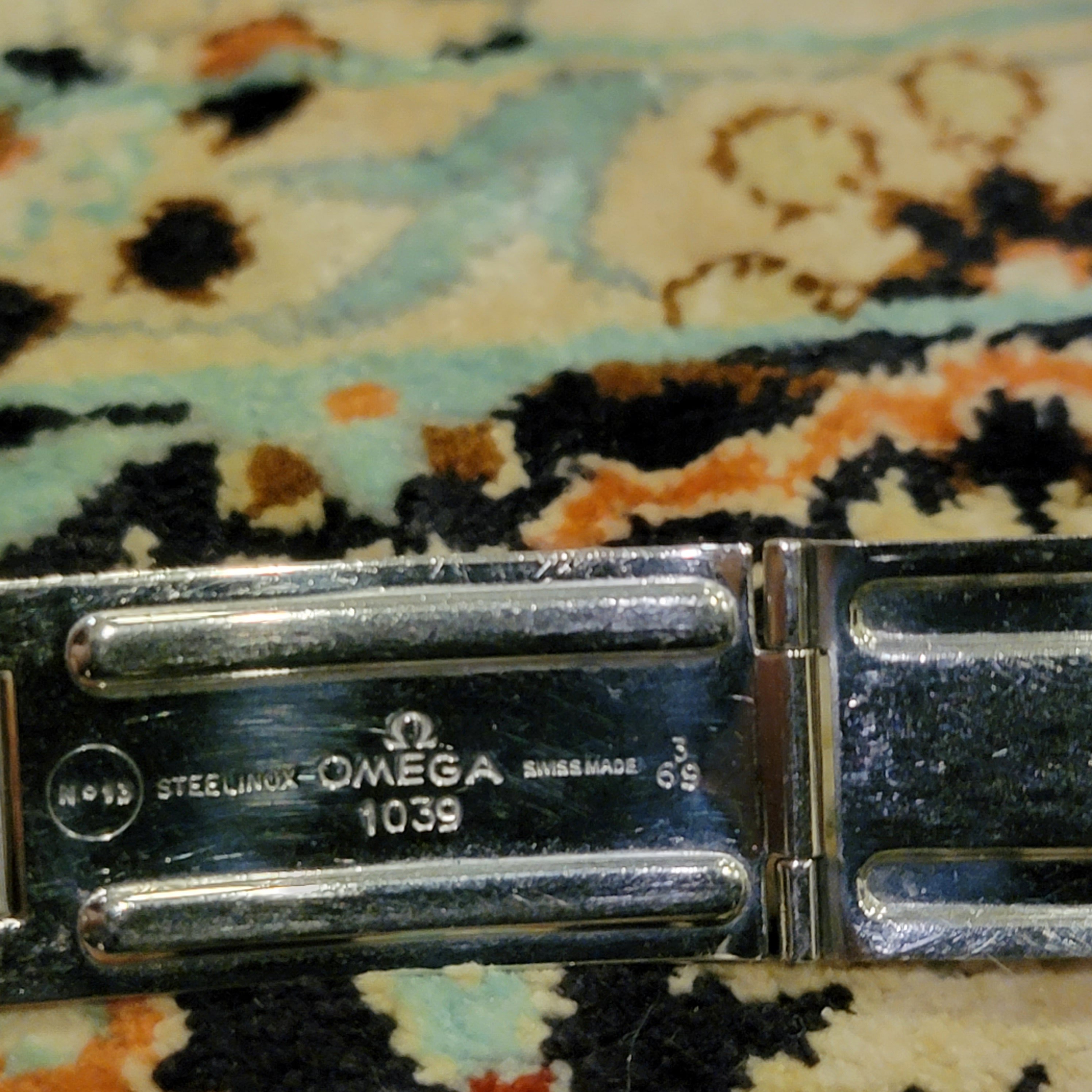

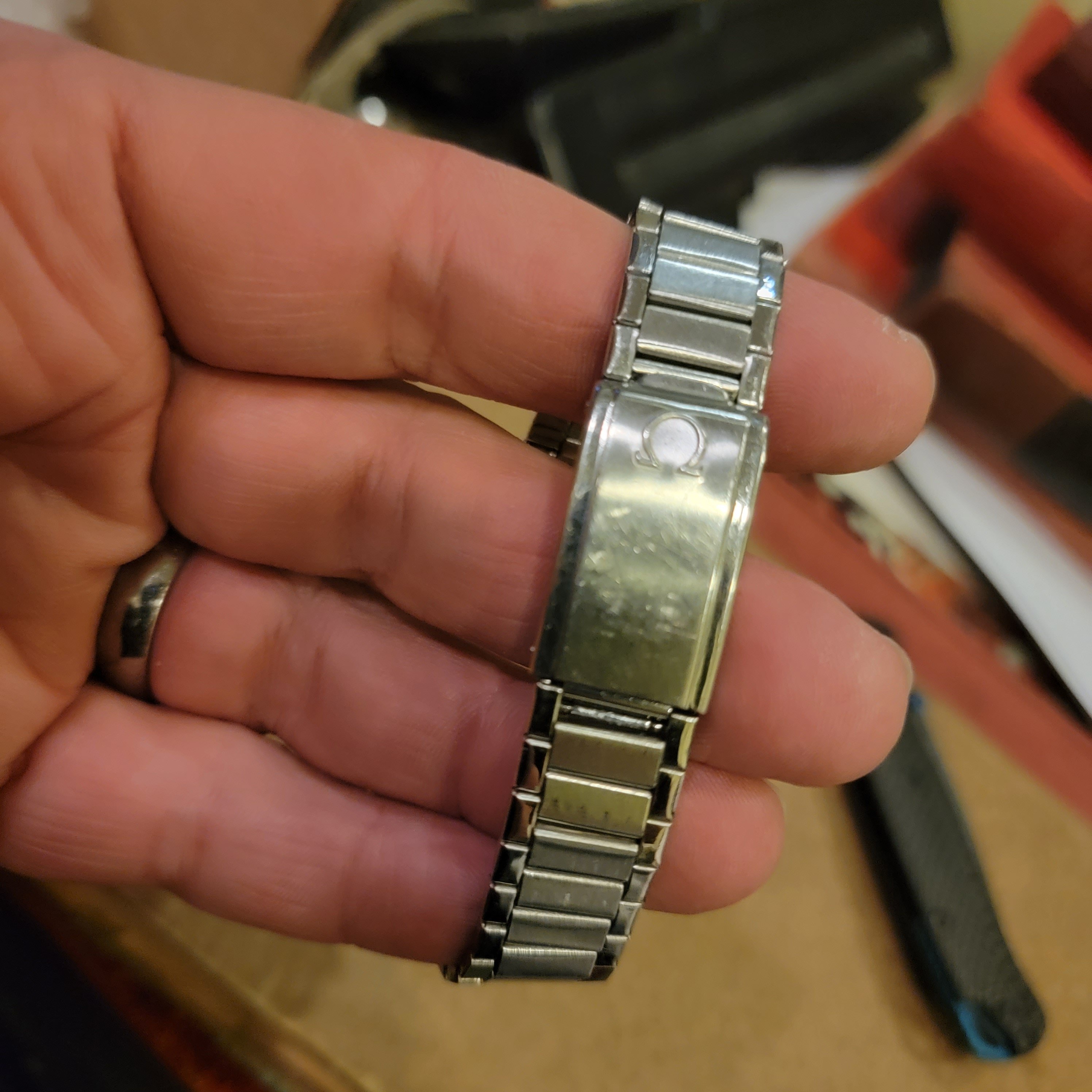

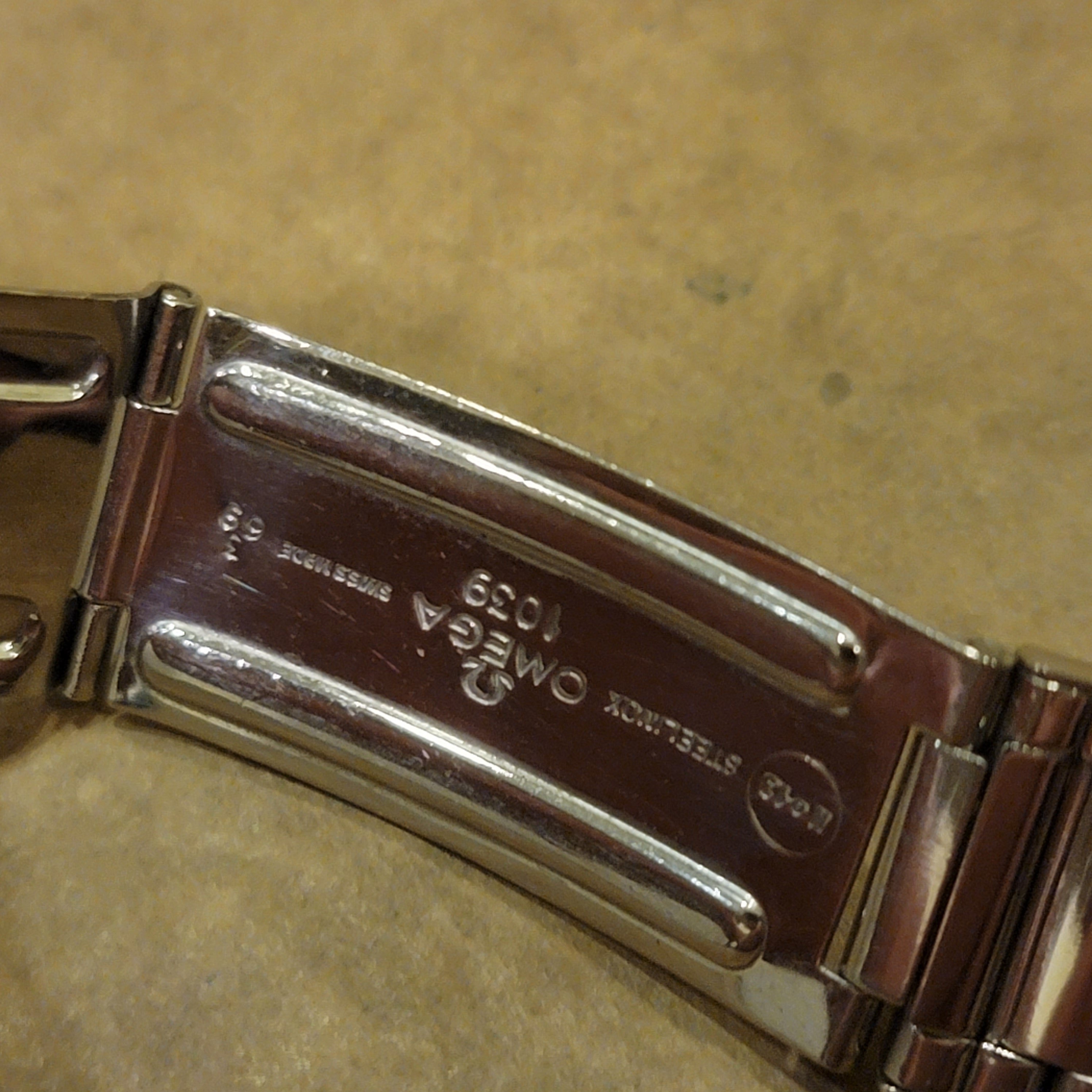

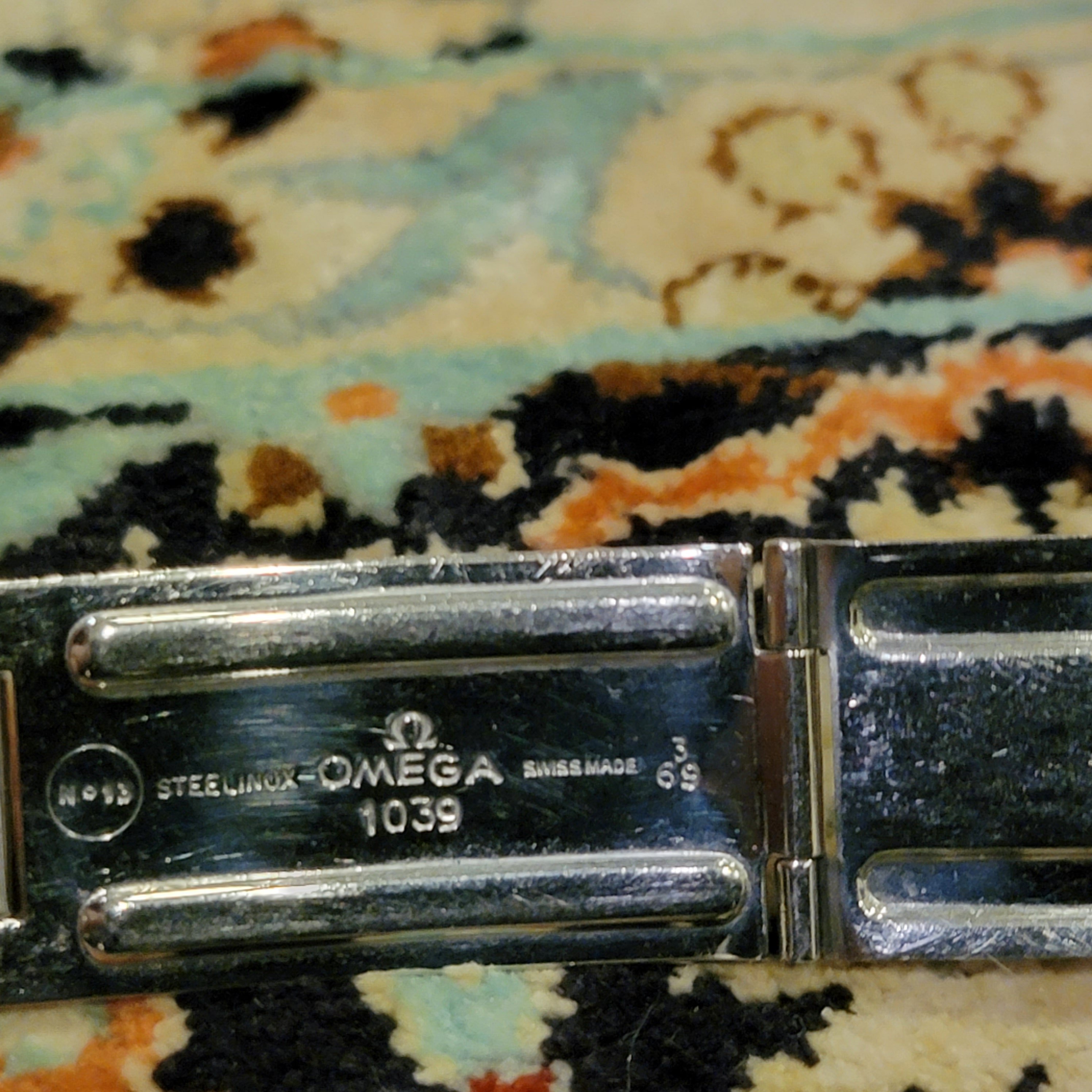

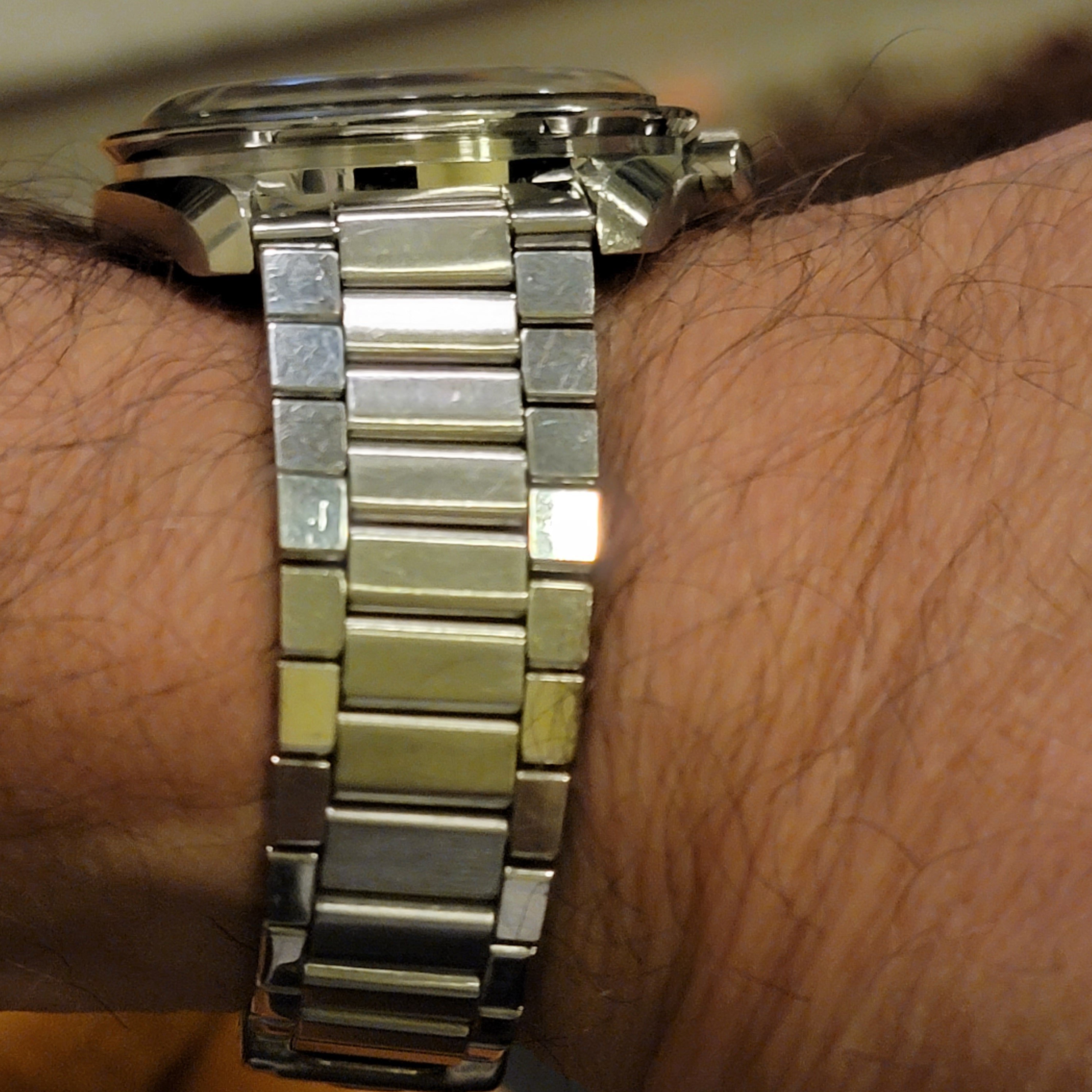

Bonus is of course the nice 1039 bracelet!
There is the question regarding the condition of the lume…
Looking at them very close/megazoom, they do have the same color/shine, and even if some of them look a bit lumpy (like som Ed Whites),
I do think that they have not been altered, and the light in the studio might make them a bit weird.
It would have been much more easy to assess them if you held the watch in your hand, but thats not always possible.

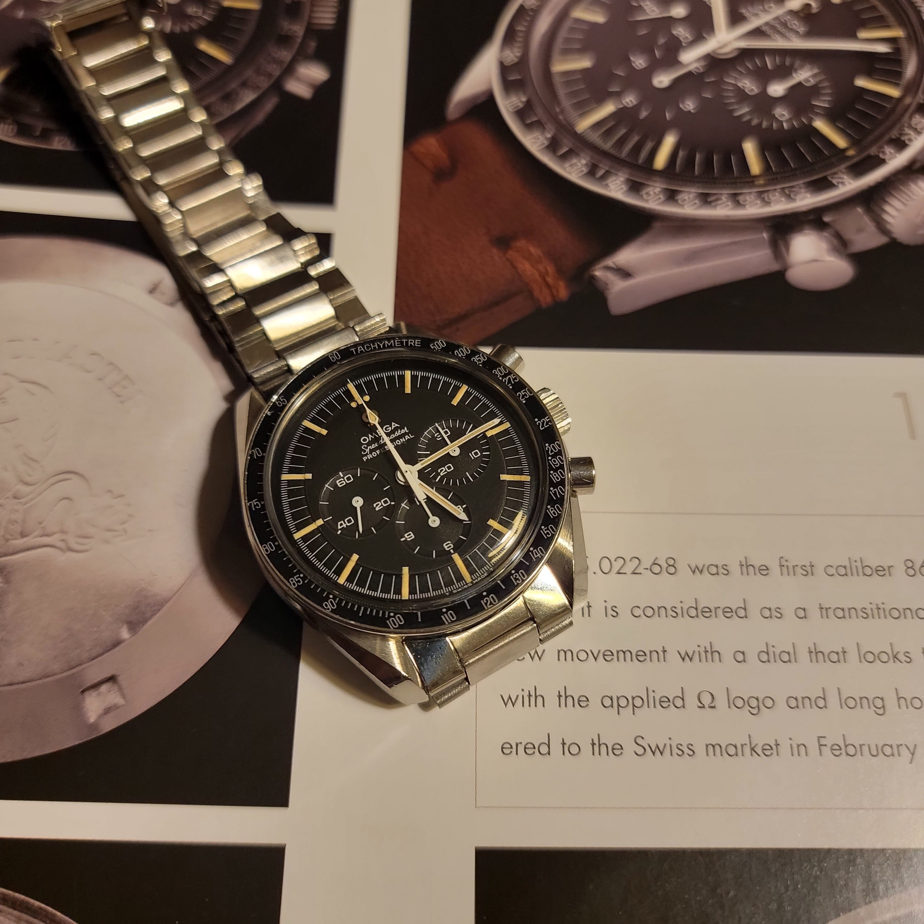

So value?
Adding up everything it would be a Very Good/Very Good plus watch.

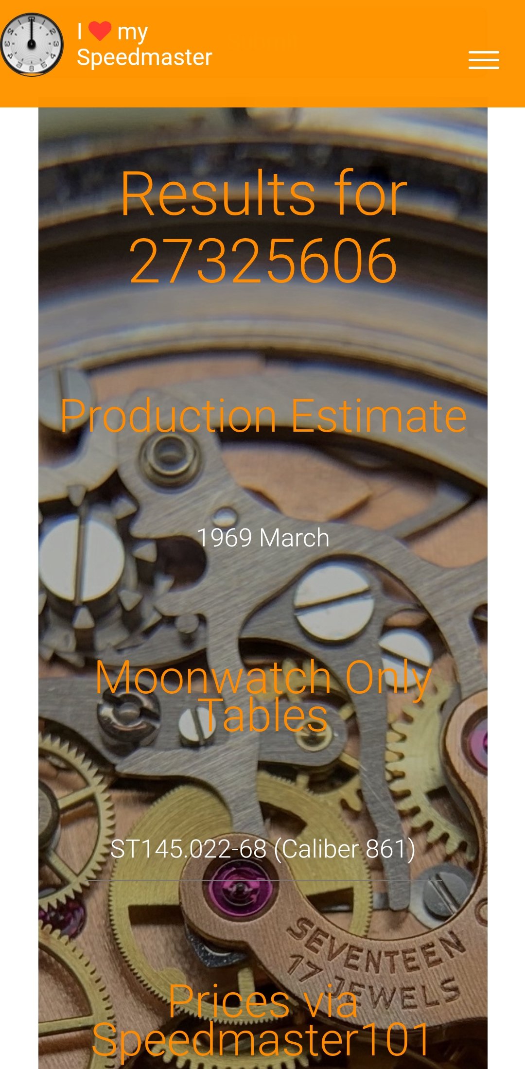

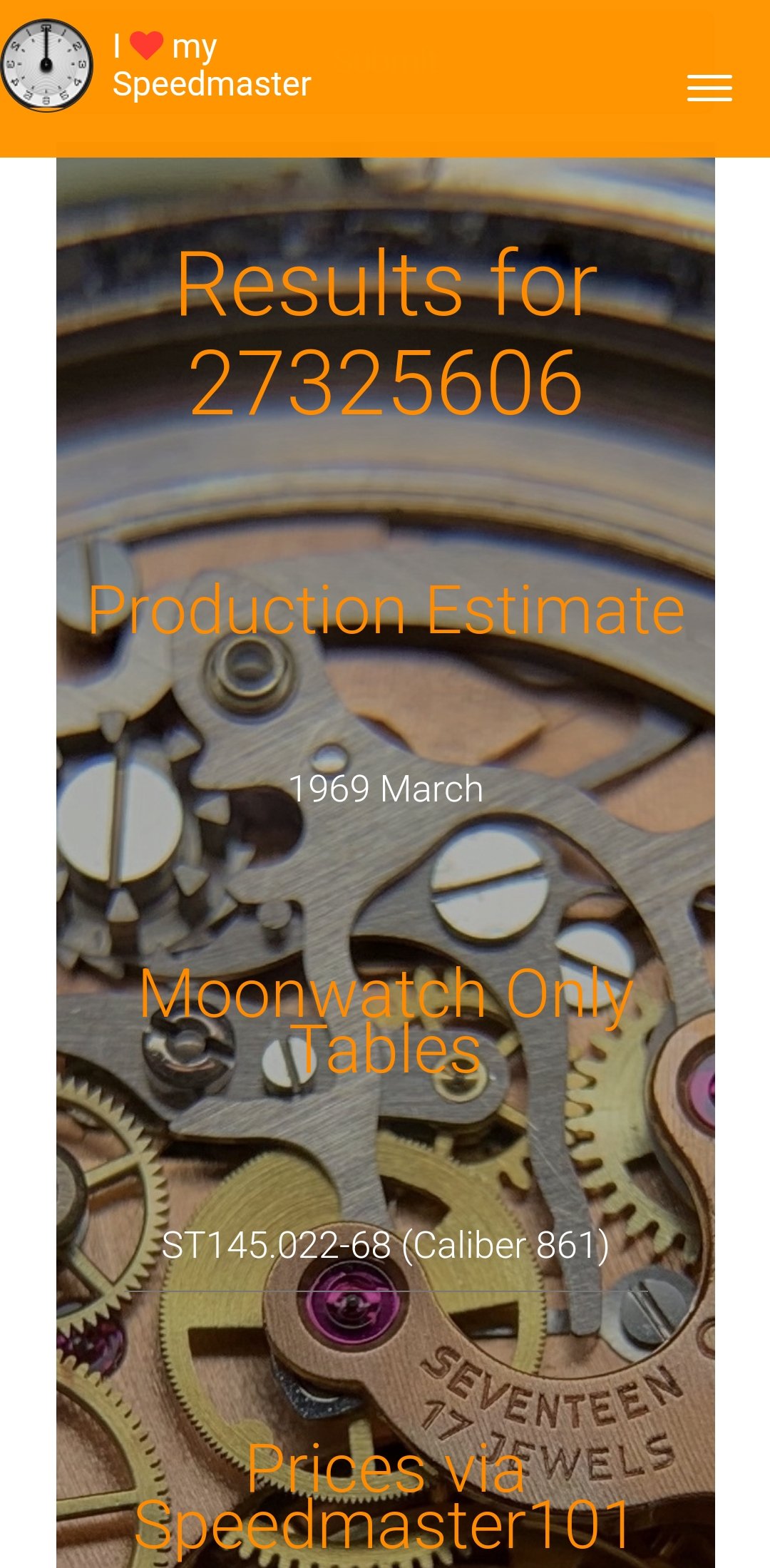

The Speedmaster chart puts it at 8000 $ / 7400 €
But then, we have to add in the bracelet, that has a nice condition - maybe 1400-1700 $ /1300€-1600€
And since Dave kindly answered the question regarding the price of 7100 $ / 6600€,
I can only say that he did REALLY WELL!
Congrats!

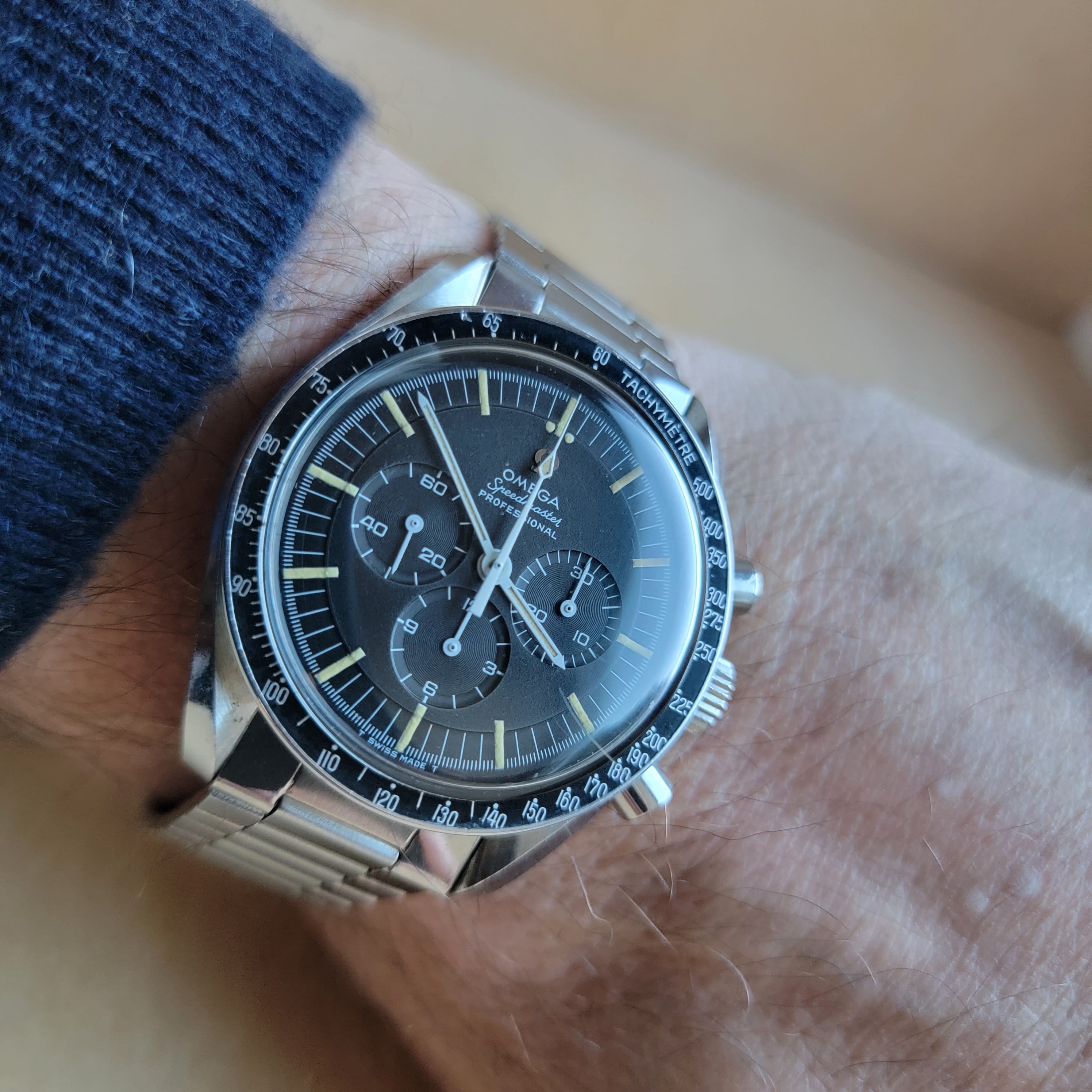

Really nice watch, i think pricewise you did very well if i compare what is on offer at C24. Brushing looks good and together with the sharp edged dents that show in the pictures i conclude no or very minimal polishing has been done. If the lume is the same with the watch in hand it has aged well. Fine wine man, fine wine, Congrats !

I think it’s as you say. The case is sharp, very possibly unpolished and the lume appears original to me.
I have a certain vision in my head of what the lume on good+ 68’s looks like and although this is slightly darker, it’s within what I’d consider acceptable tolerance.
I know watches like this need to be assessed in detail but I also trust my gut reaction after about ten seconds. I’d say this is very good all days long (assuming the movement checks out) and is a great buy. Congrats.

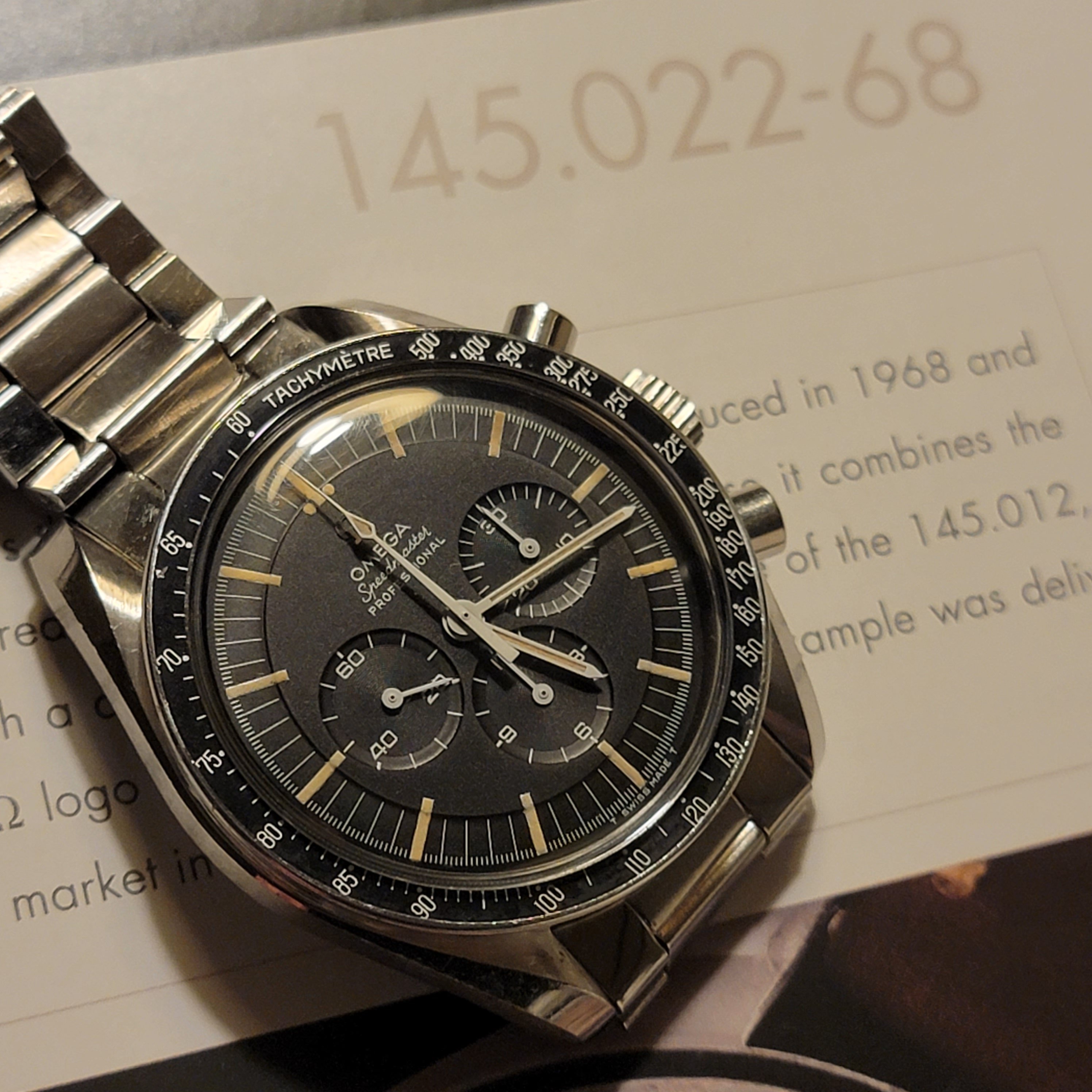

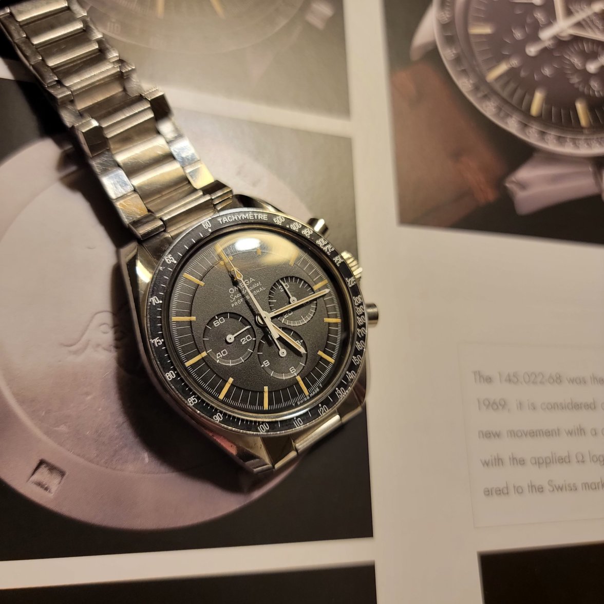

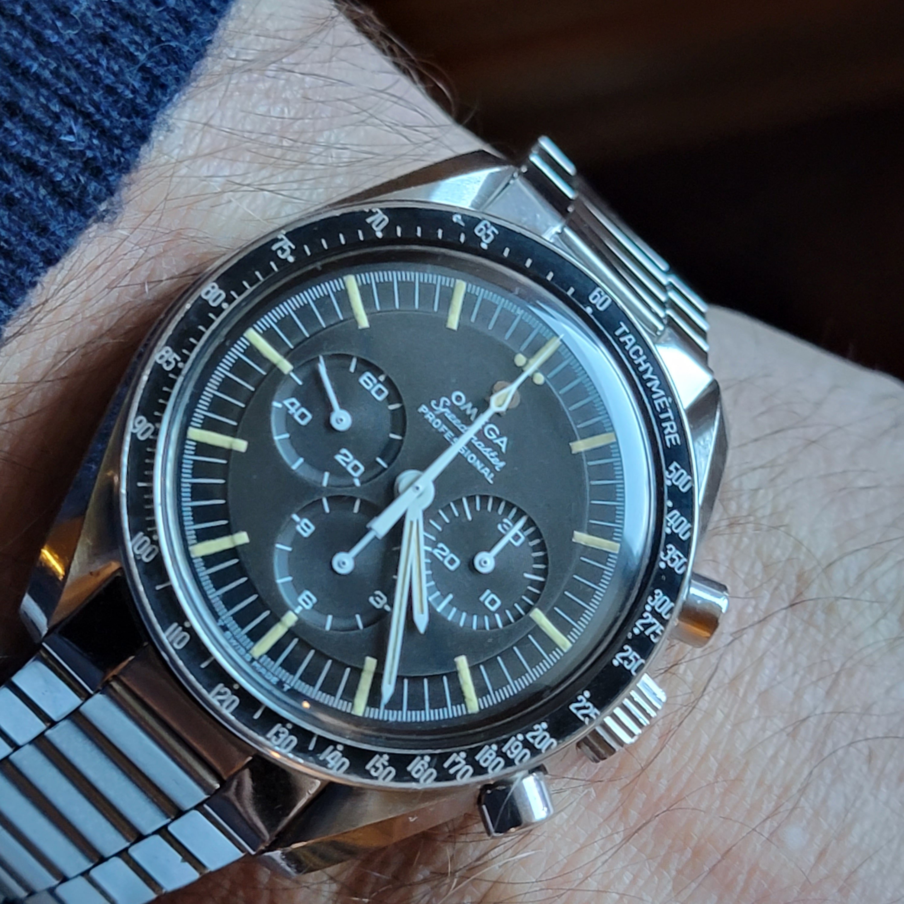

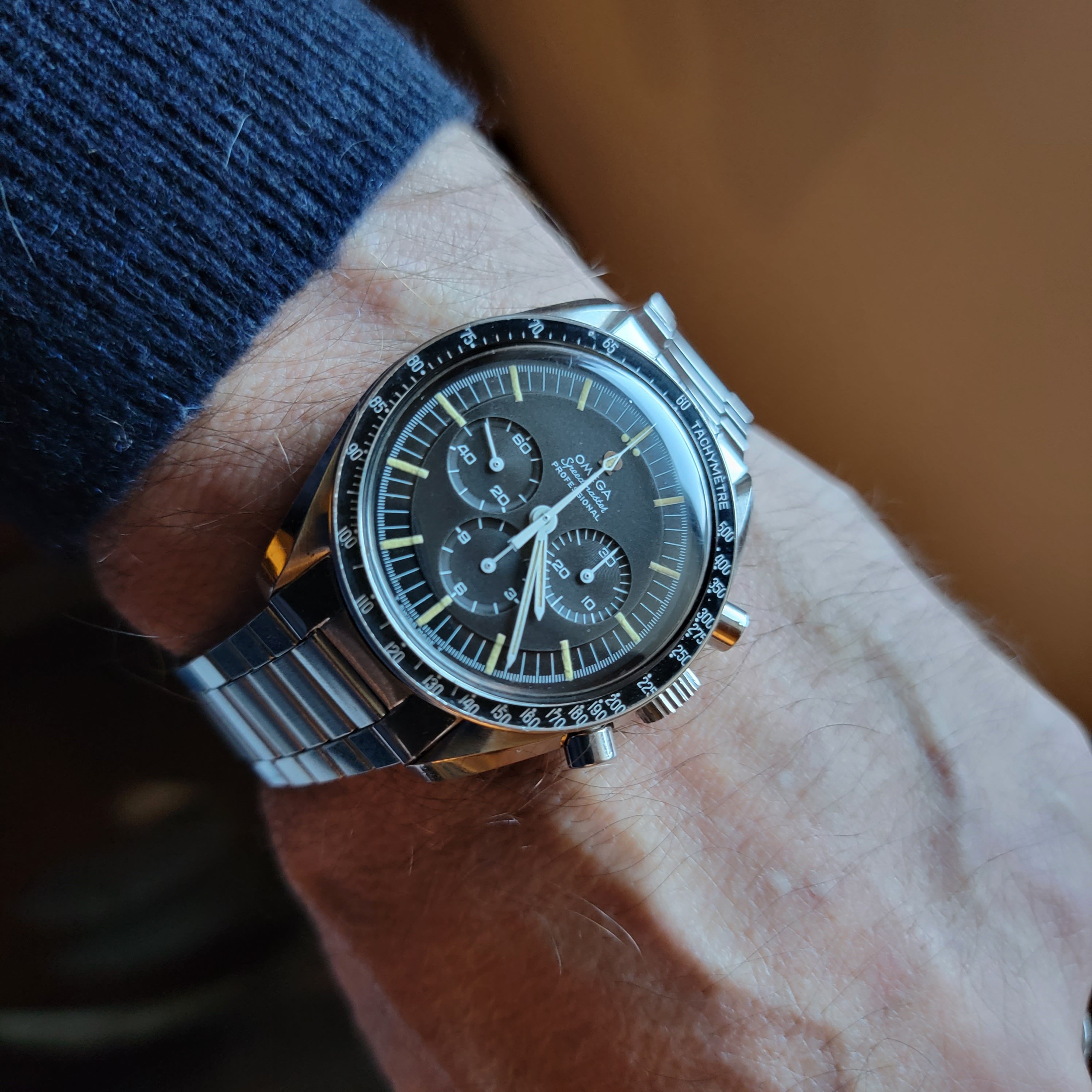

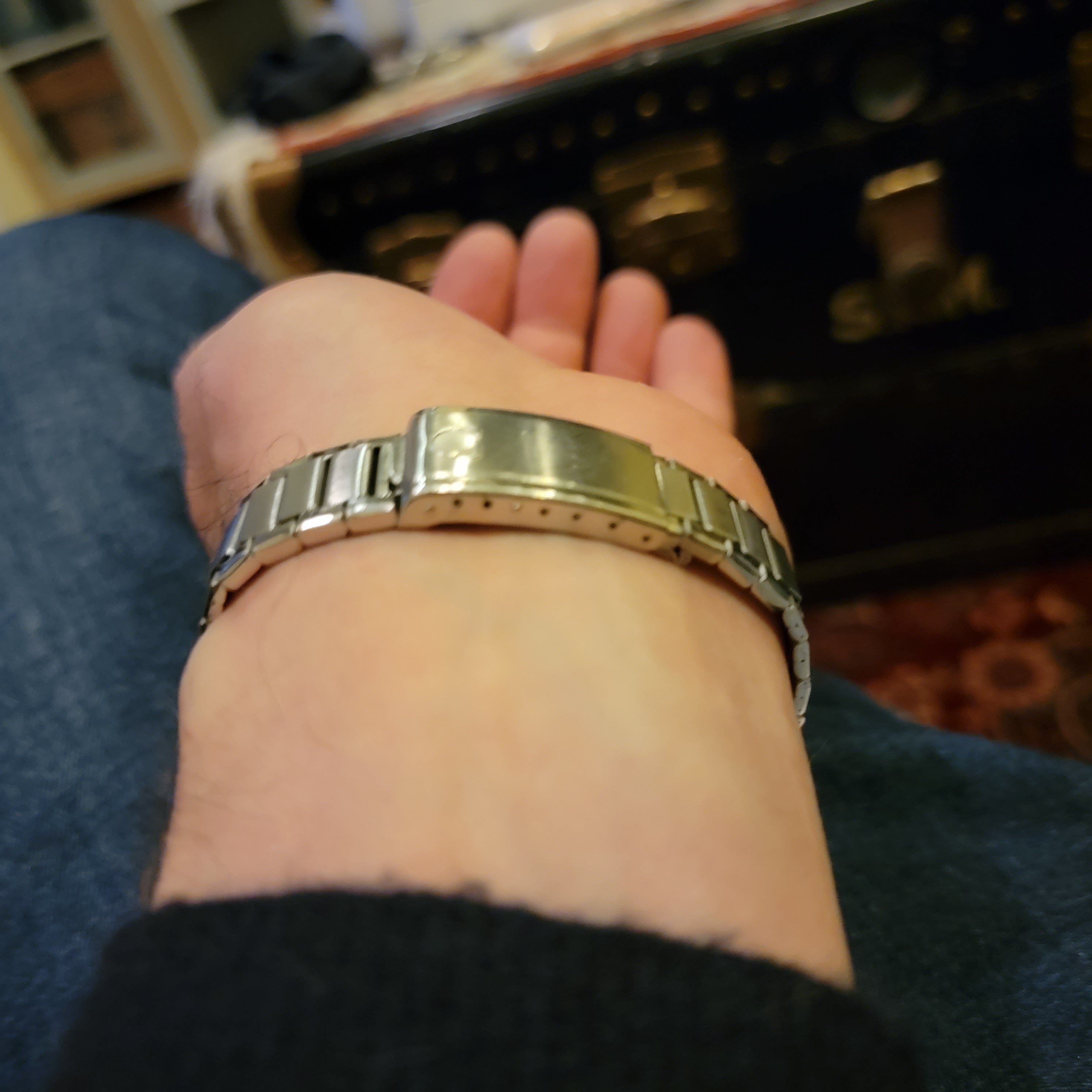

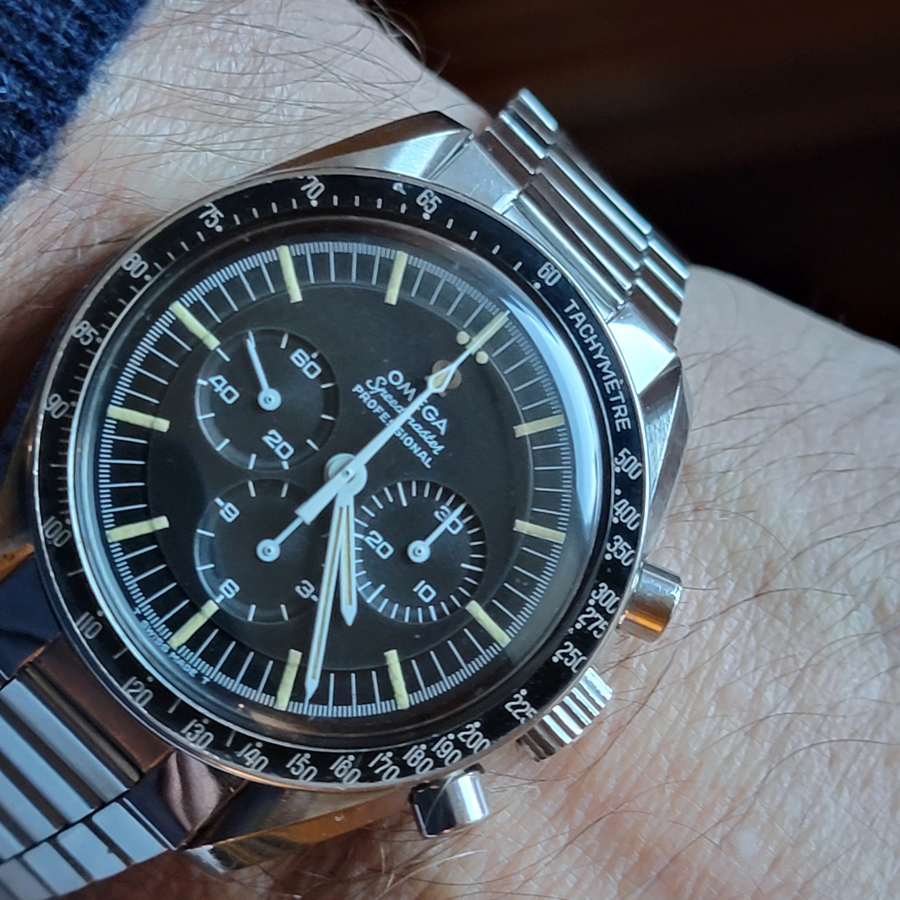

Yes, it arrived today and it's 🥰
The pictures don't do it justice. I could do a better job photographing, for certain.

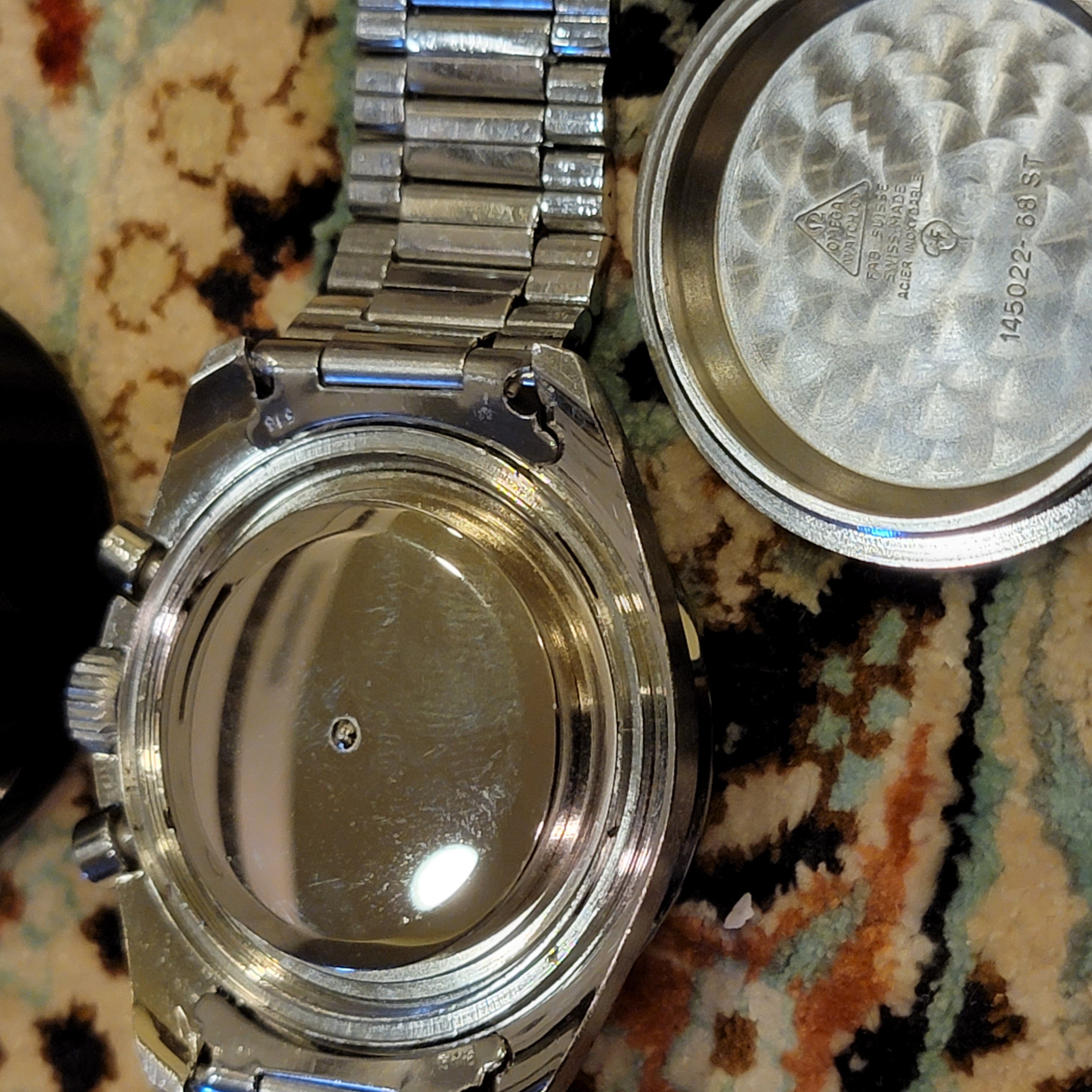

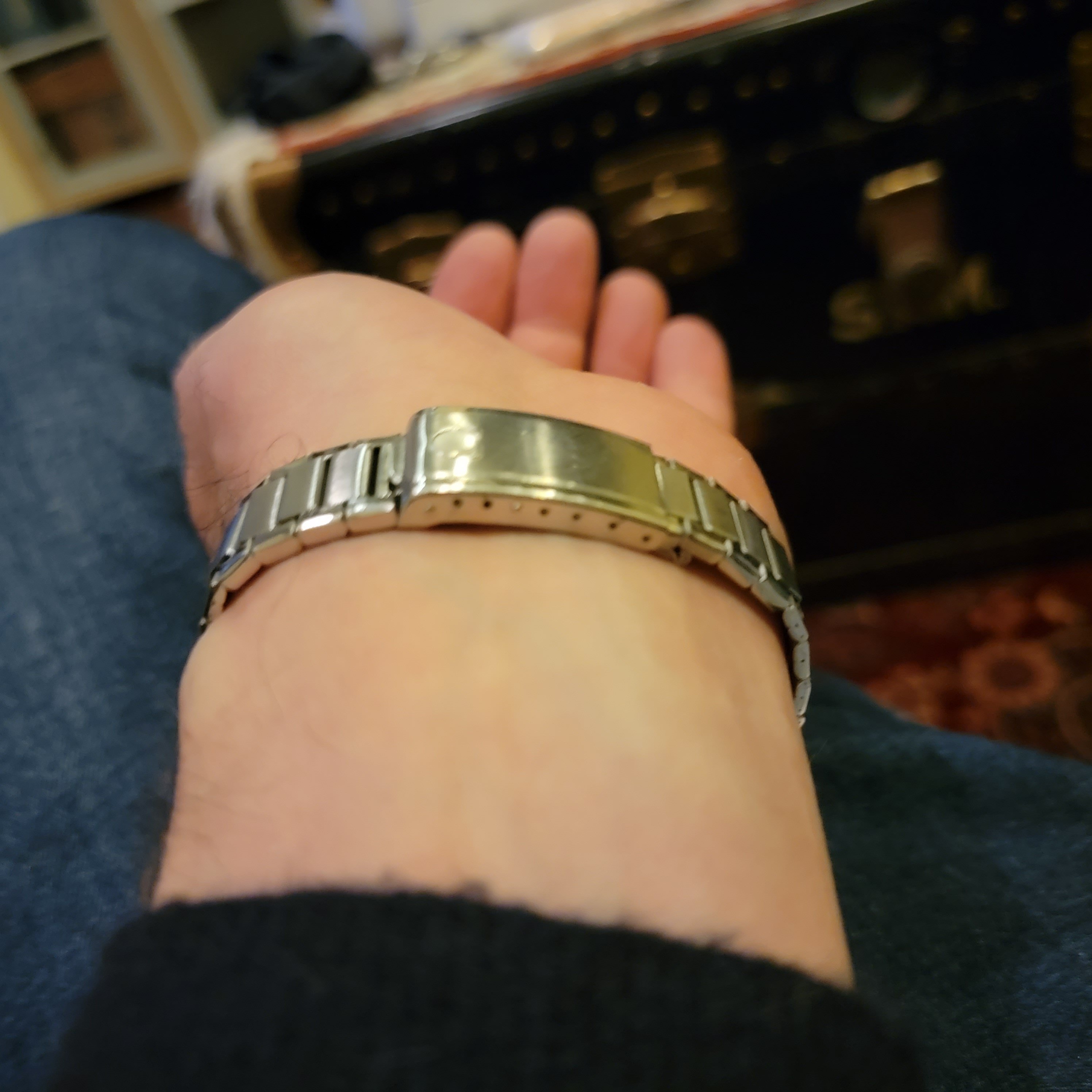

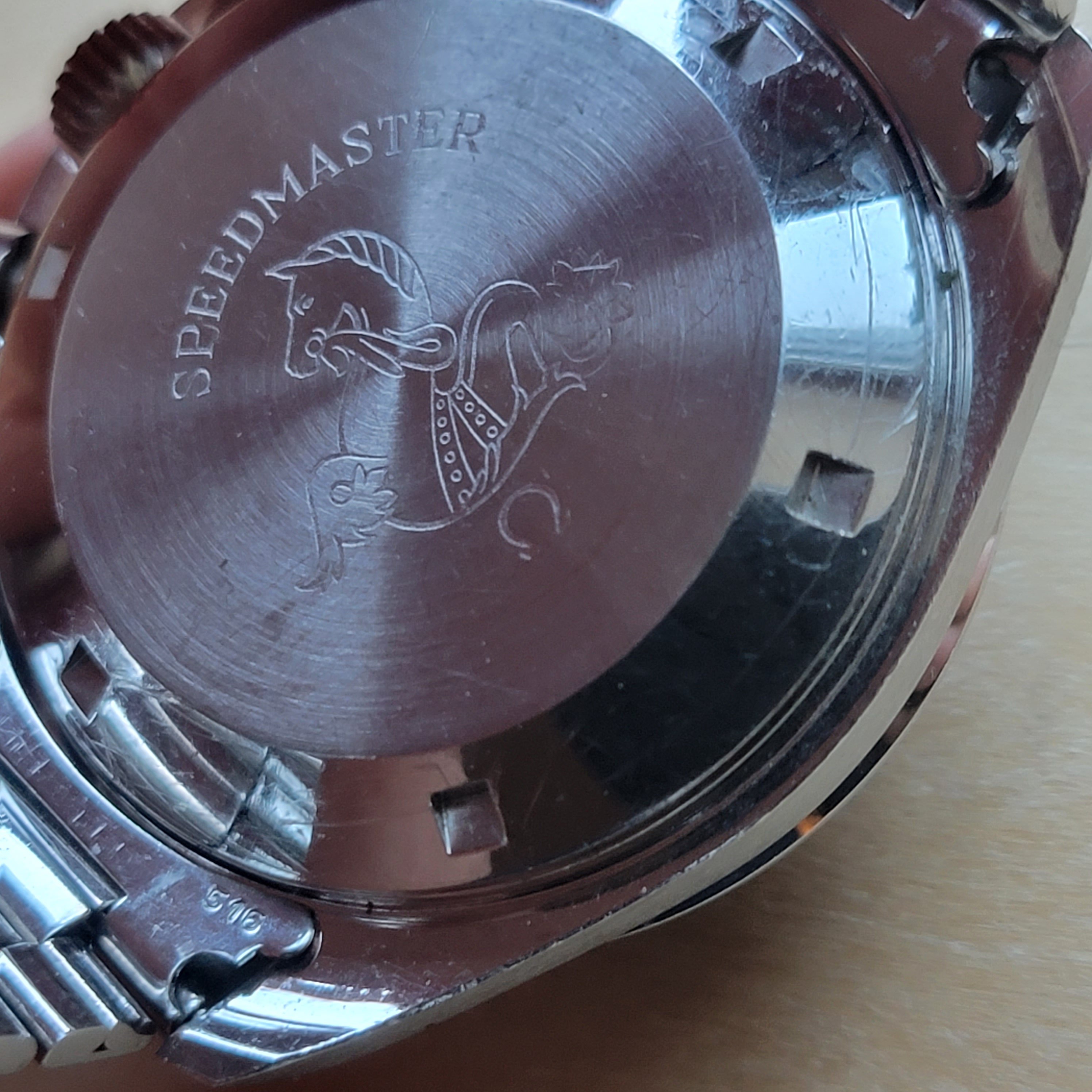

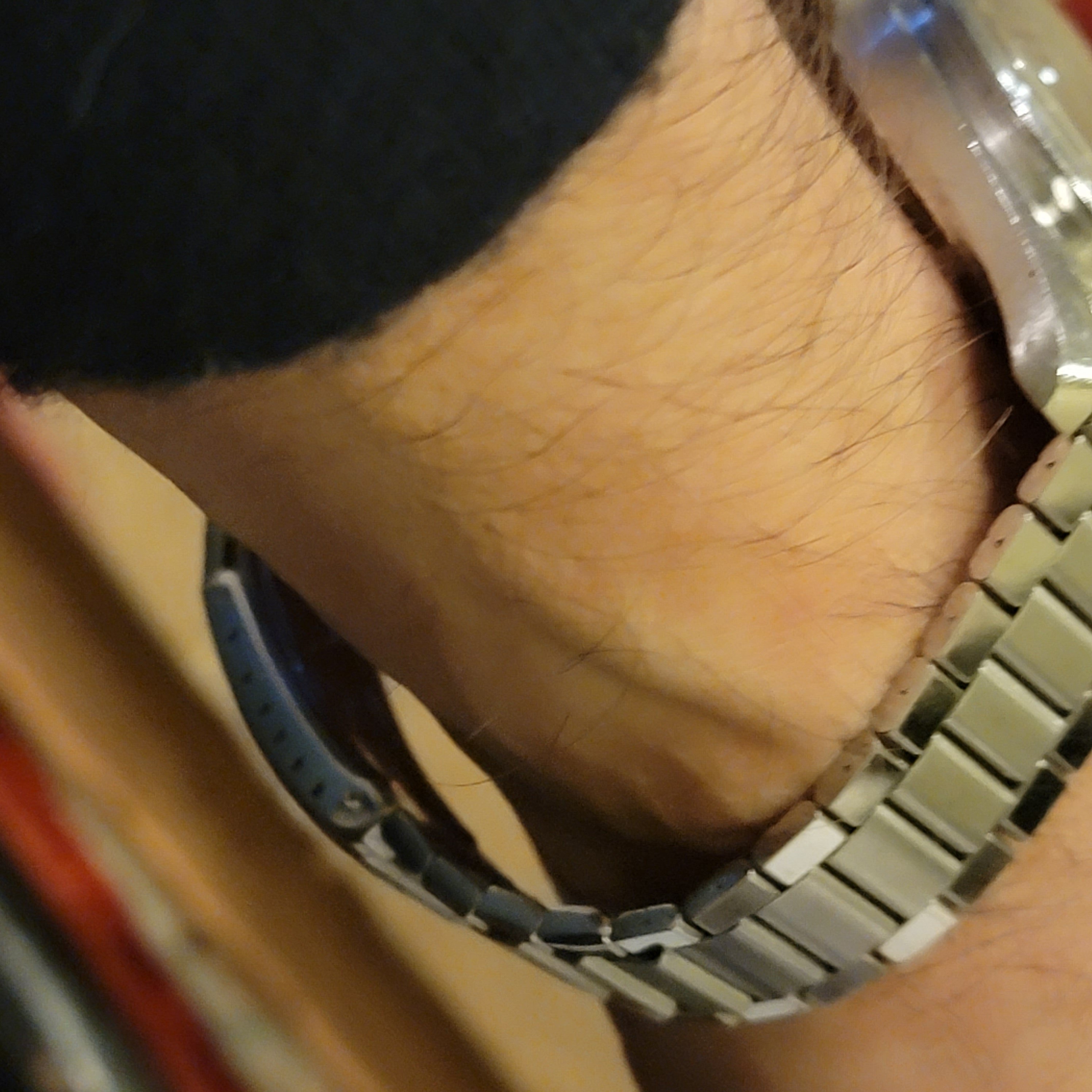

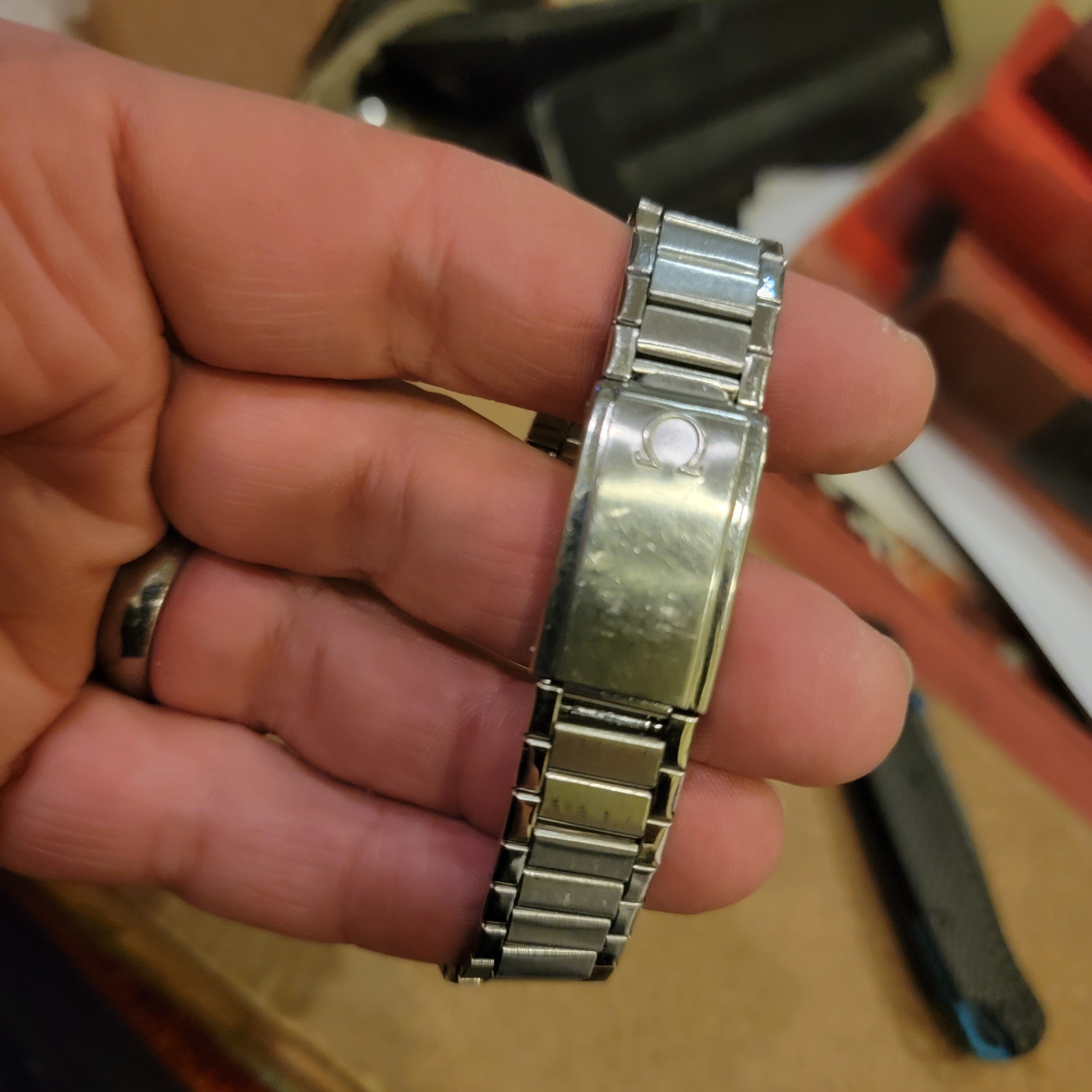

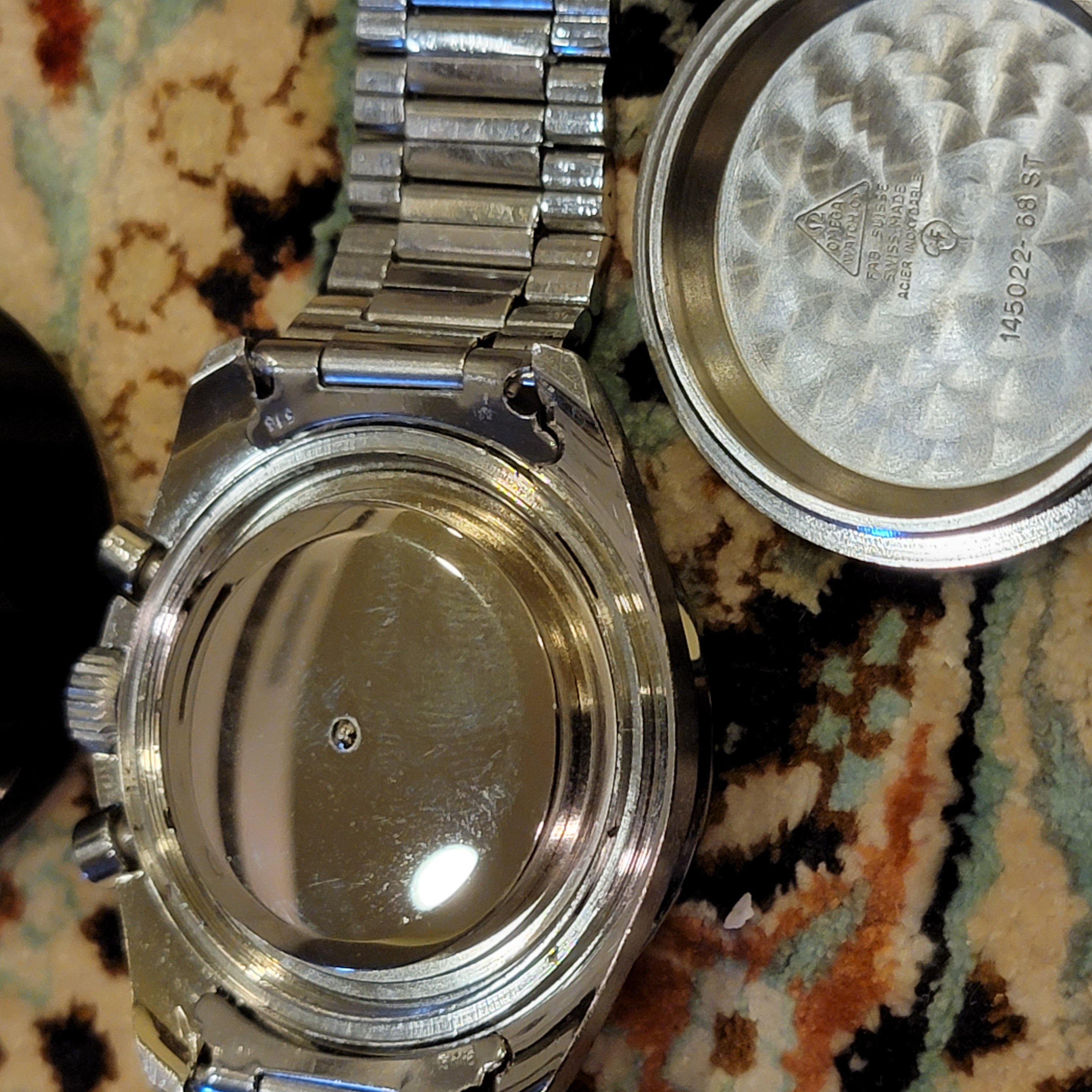

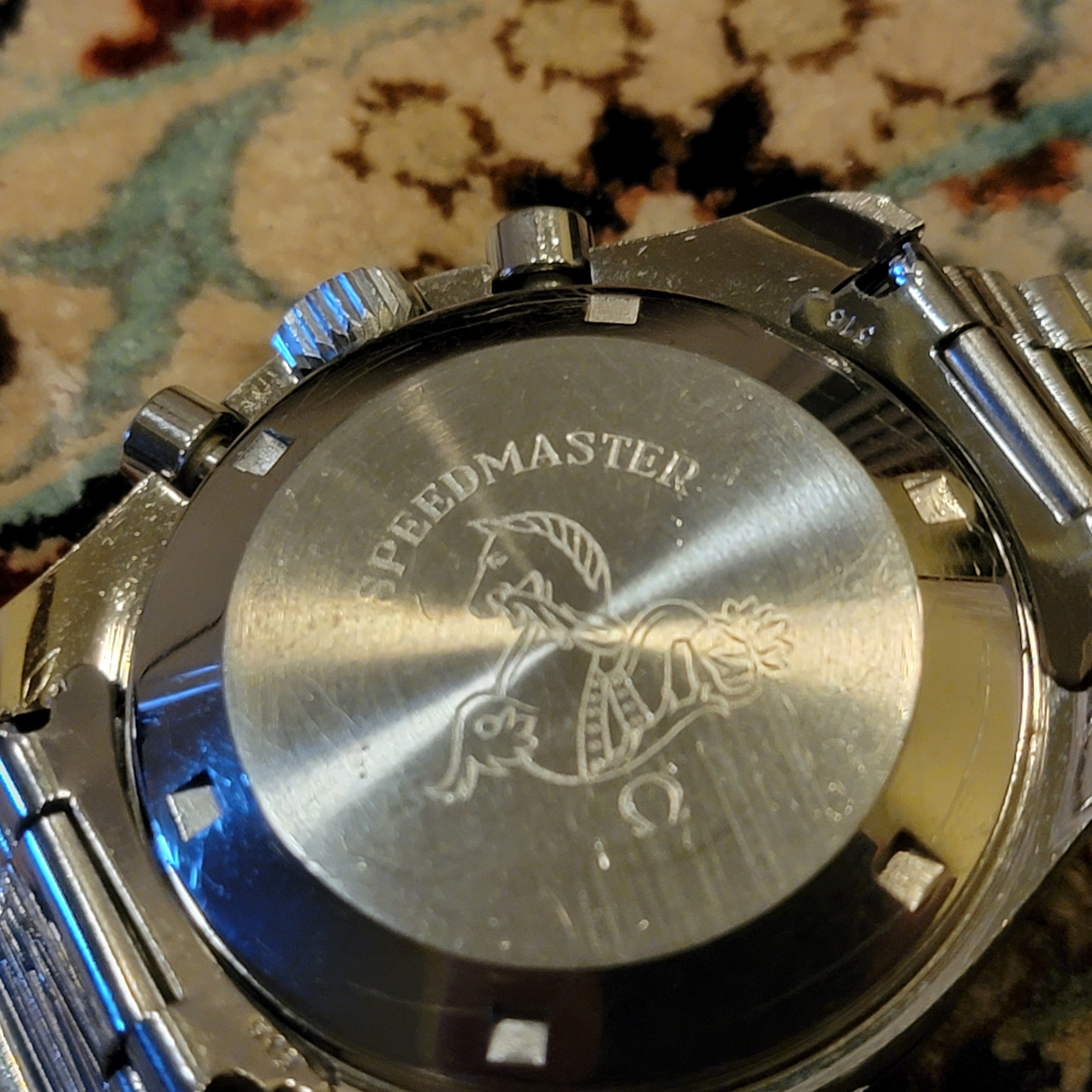

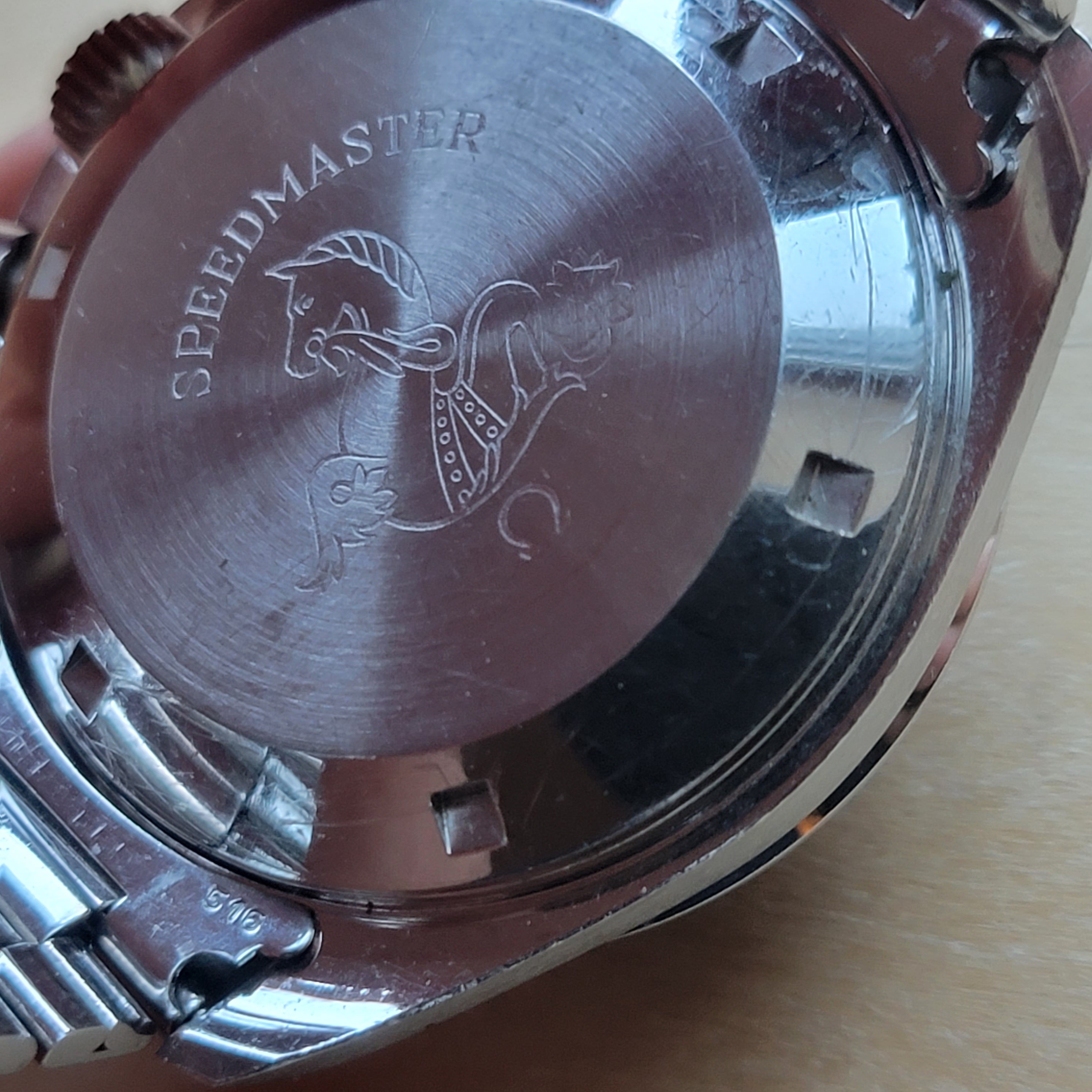

Couple comments before the pics. It looks barely used. The bracelet is long but I was able to adjust the clasp for my 7.25 inch wrist.

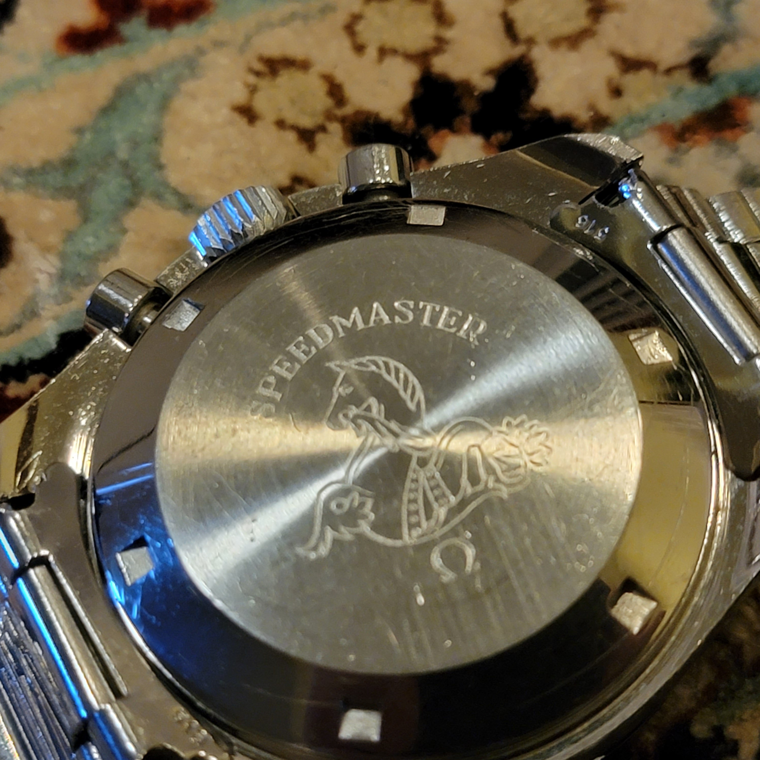

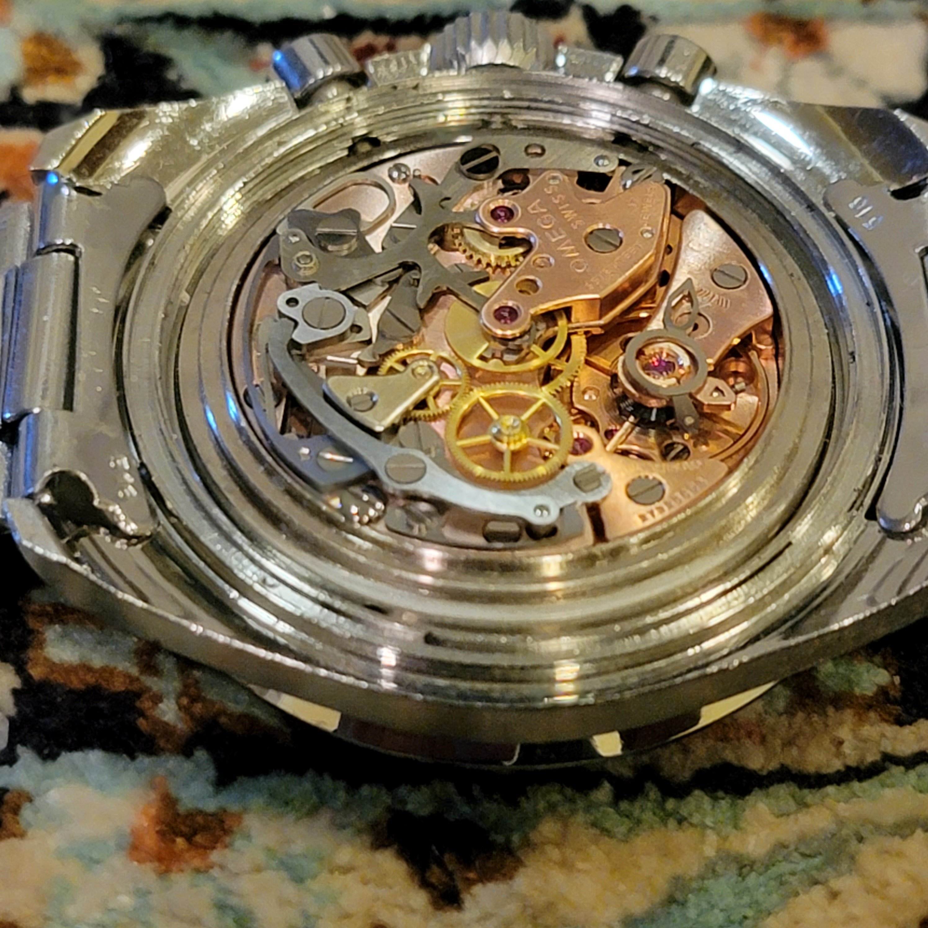

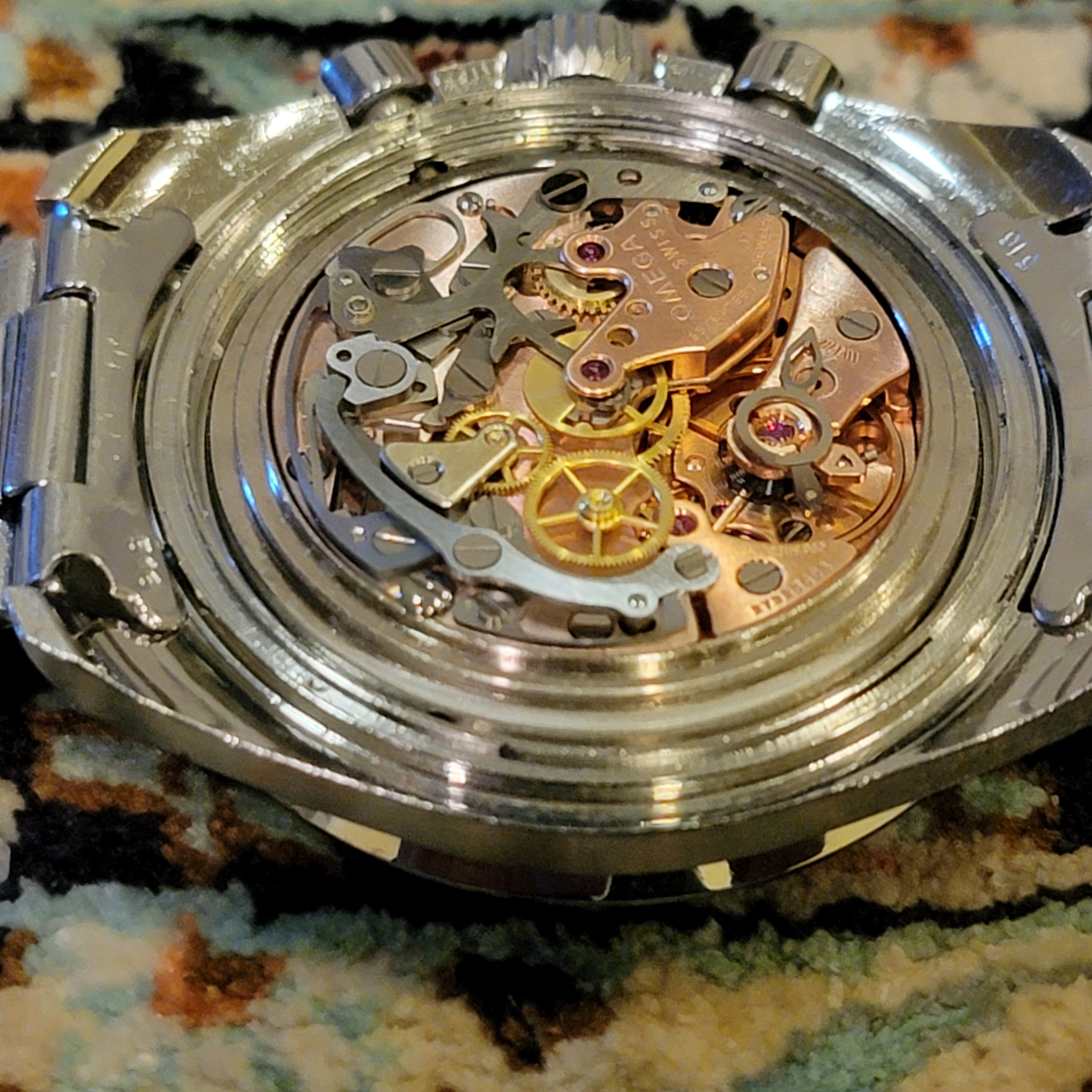

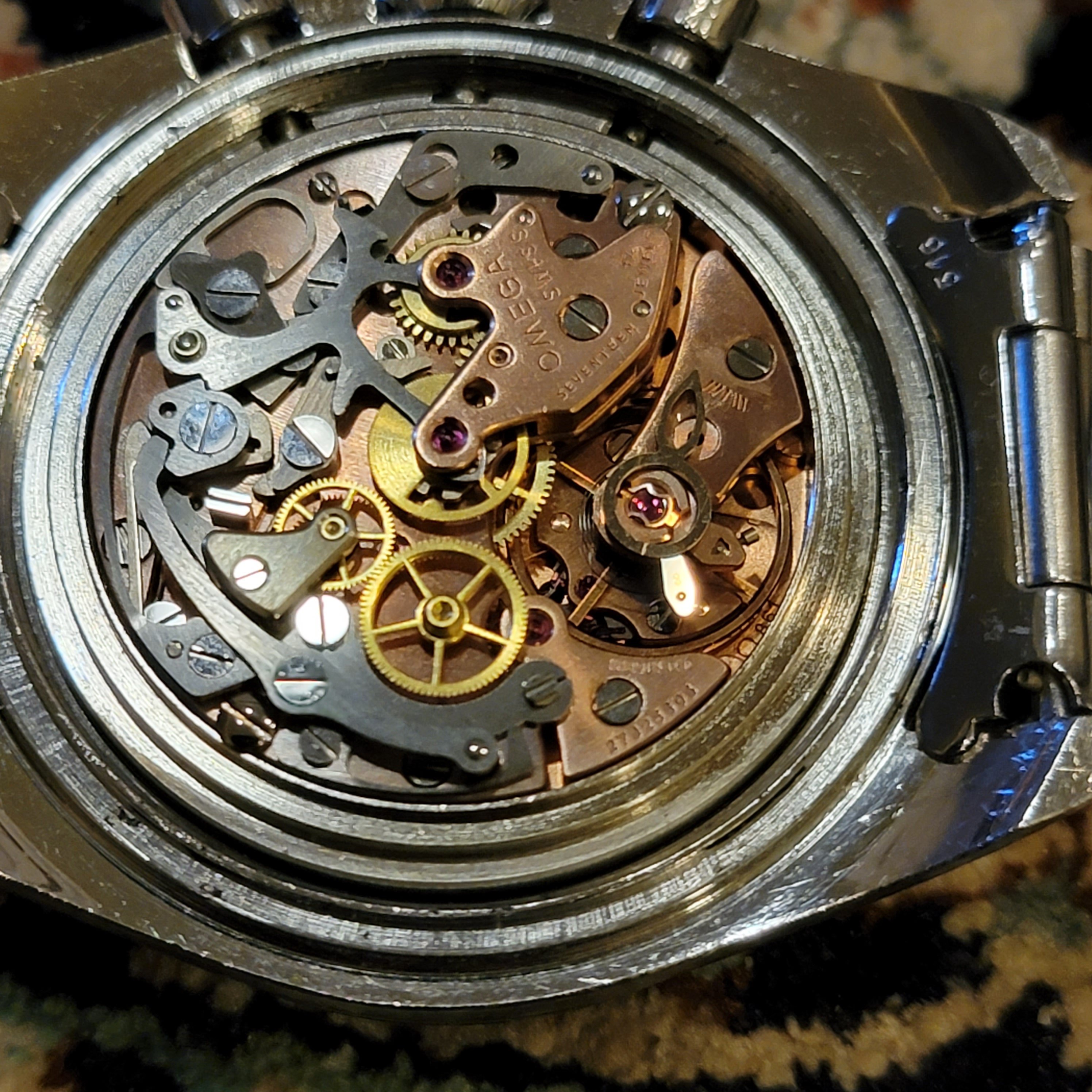

There was no rubber gasket in the caseback. Wierd. The movement looks great.

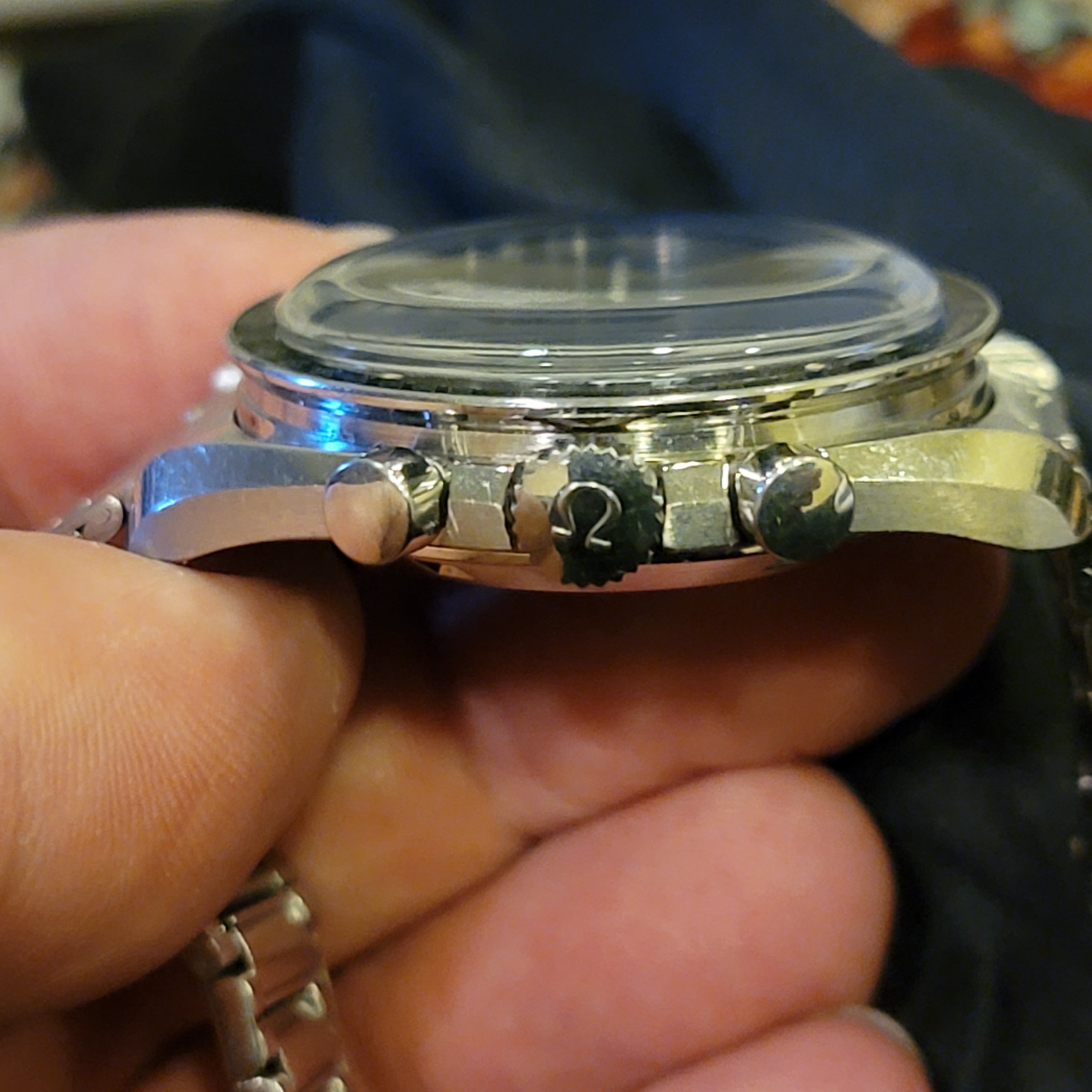

The dial is stunning. The crown looks barely touched.
To say I am lucky would be an understatement. This makes up for some other noob tax watches I have purchased.
6,559
22,391

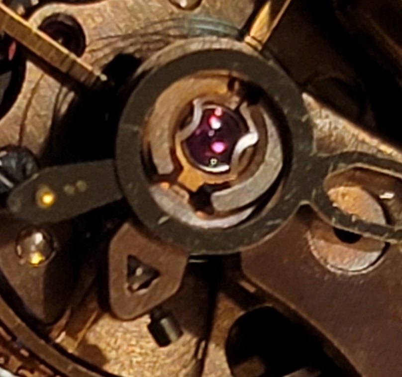

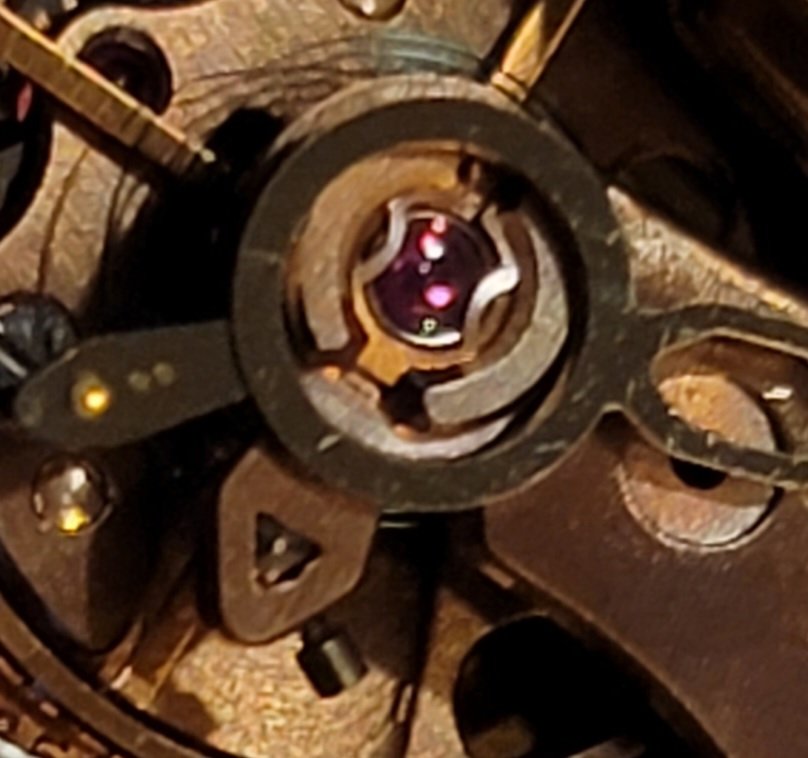

Postscript: I think I see an issue that needs my watchmaker's attention.
Edit: thinking about this some more, I suspect someone with no watchmaking skills was mucking about trying to regulate the watch. They unscrewed it too far and it came apart. This would also explain the missing caseback gasket as no watchmaker would forget to install a gasket.
Could be worse. Hope my watchmaker can take it in next week. He's always several weeks backlogged so it'll probably be over a month before I get it back.
Yes, your regulator pointer has come off the balance cock. You are also missing the regulator corrector - 72208601339.
It might be floating around inside the watch...
