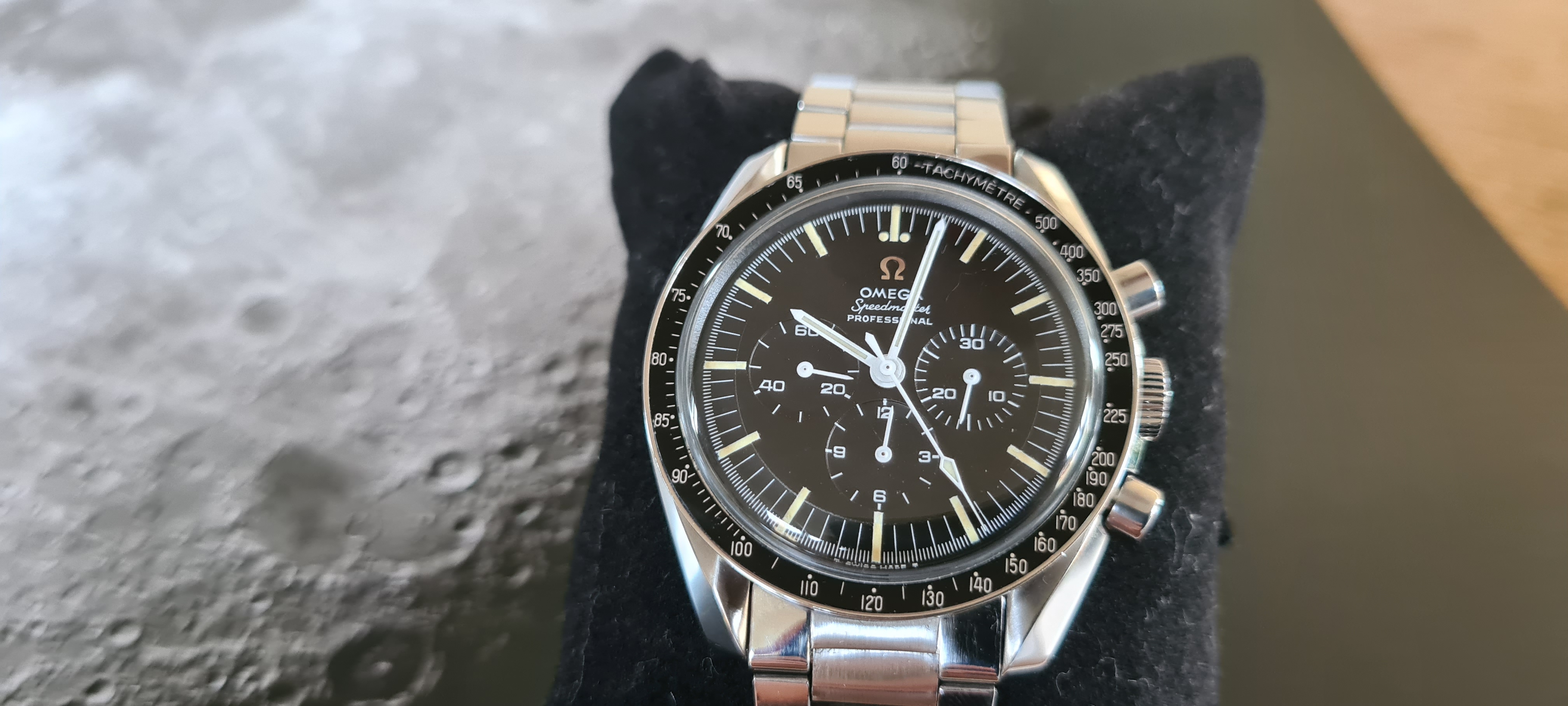

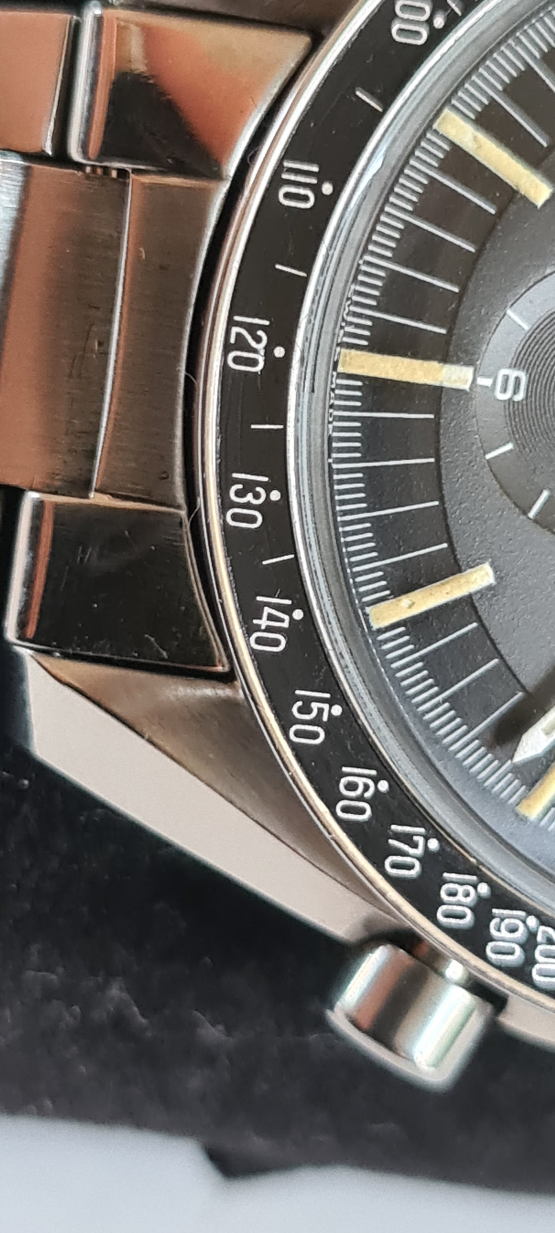

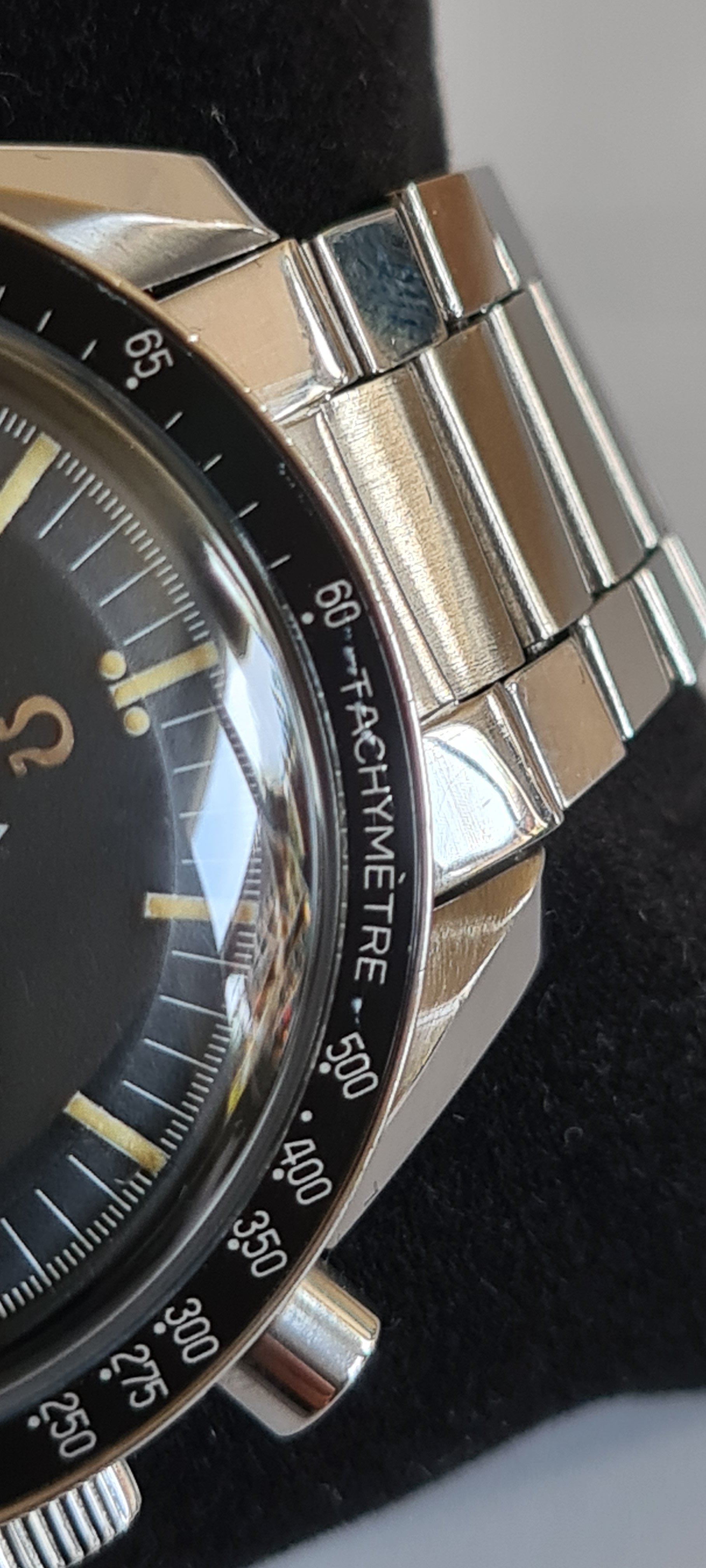

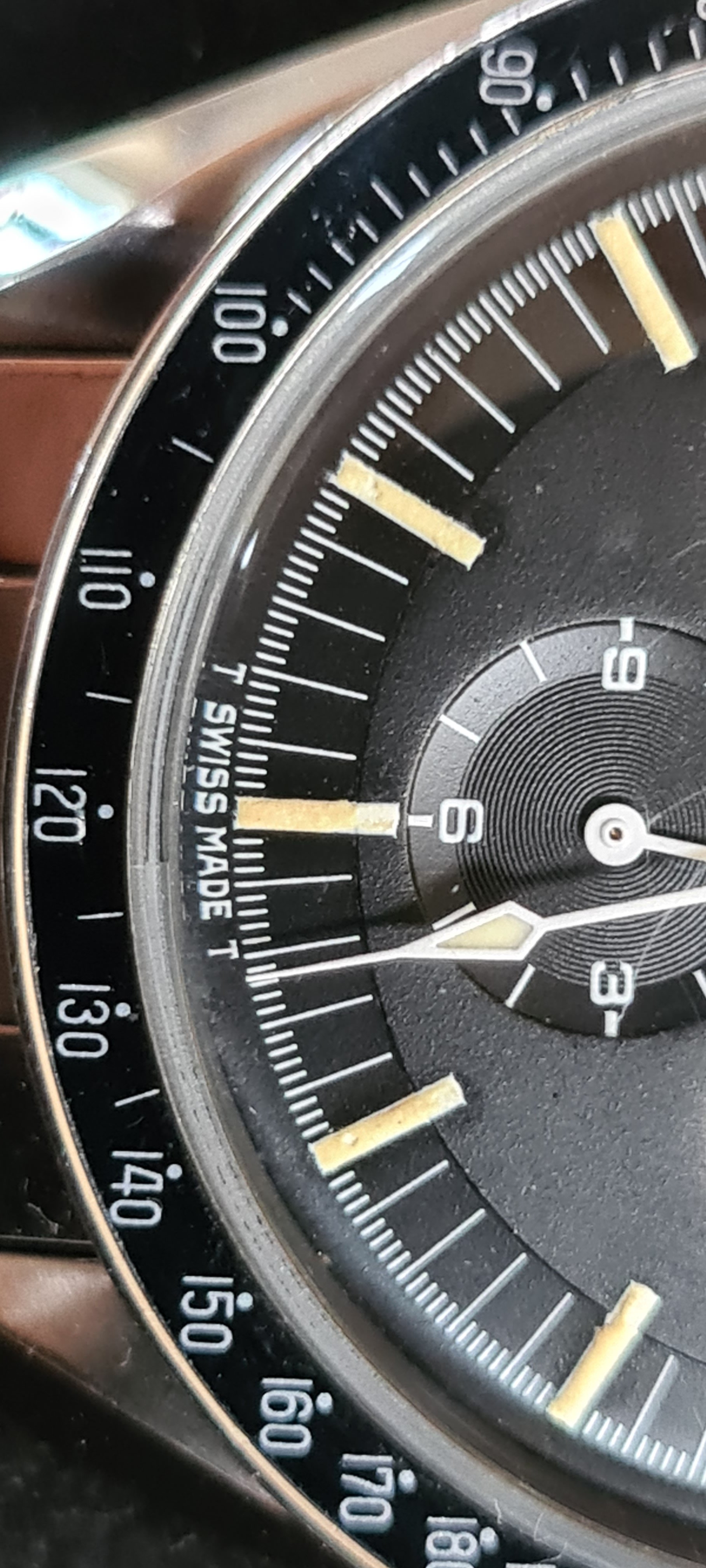

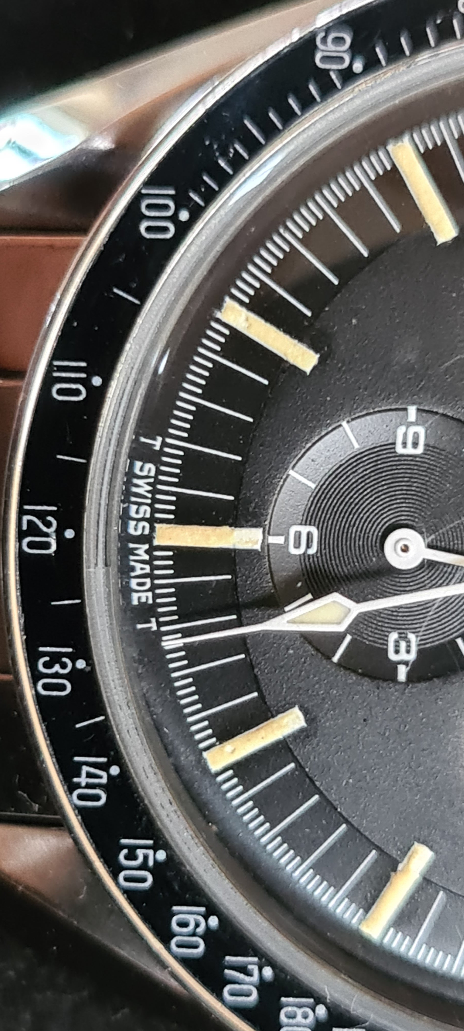

I have seen to many bezels in the last days and I feel more unsure now, than before. (Sorry for my european english☺️). I have an authentic Speedmaster 145.012.67 but the bezel was exchanged and I do not know, if its correct. I hope my photos are good enough?
Is ist a fake/ aftermarket, or a newer Omega Servicebezel, or an original part for this model?
I would be grateful for a professional answer.

Have a look at Speedmaster 101. William, @Spacefruit, a member here, is the author of this website. He has posted a fair bit of information regarding Omega Speedmaster bezels.
https://speedmaster101.com/fake-bezels/
https://speedmaster101.com/assessment-guide/
https://speedmaster101.com/145-012/
Additionally, go on to YouTube, on the channel William Speedmaster101 and look for:
Re Lumed Speedmaster? 145.012-67
The first 7 minutes of the video focuses on the dial and lume, but after that he talks about the bezel and it's originality.

If you offered me this watch to buy, I would value it as a watch without a bezel.
Does that help?

Pushers, crown and hands are correct but serviceparts, but the rest seems to be original and in a very good condition, I think. For me my watch is a dream and I love it. Special for me is the CB case as well and the beautiful bracelet!

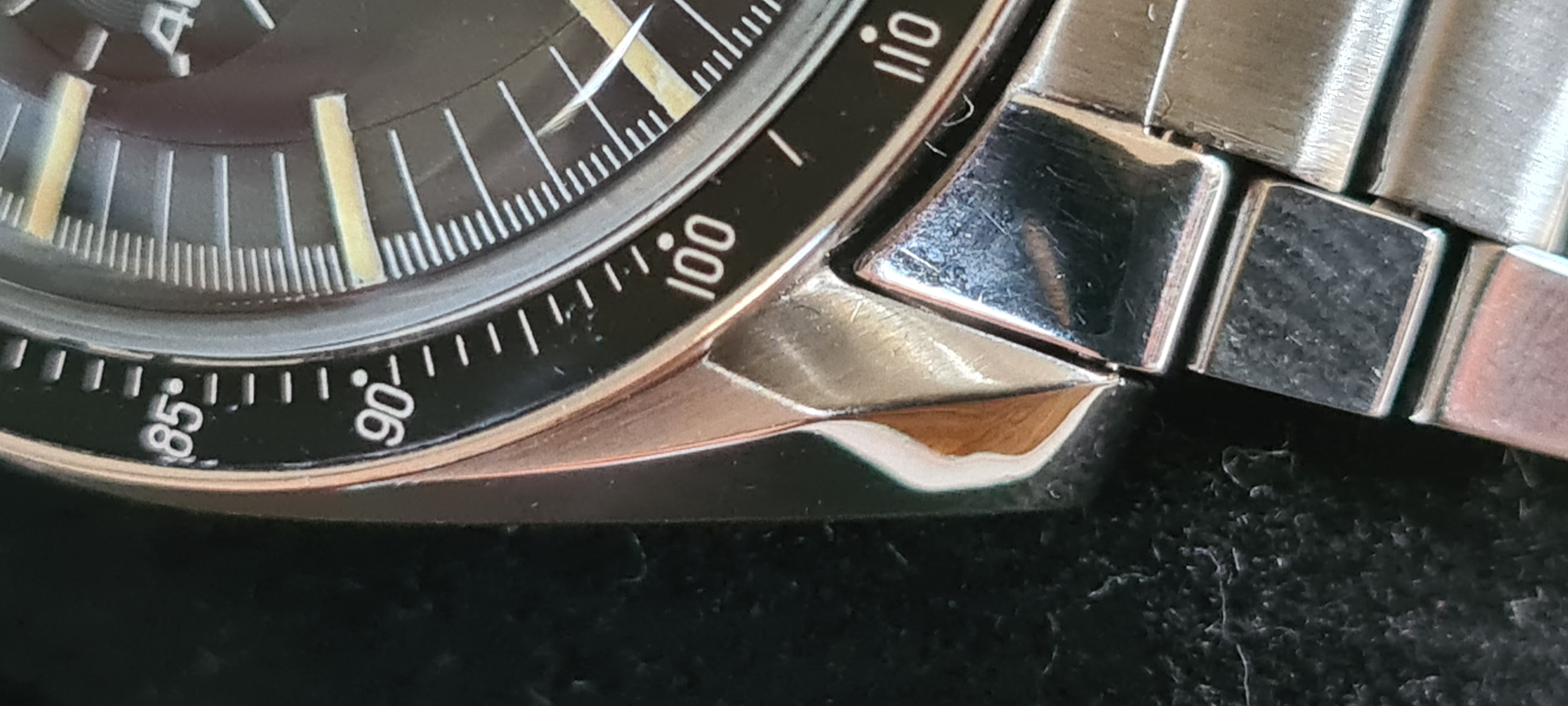

Yes I know the CB case is usually for the 105.012. Maybe the case was replaced earlier, maybe Omega just used the existing parts from the box, I don't know? Maybe for some people it's a Frankenstein watch, but I love my monster.

This is not a 105.012, so the case or case-back has been swapped apparently.
[Edit: Actually, I'm now quite confused about the watch. How does the OP know that it's a 145.012 and why does he think it's a CB case? Is there an extract? What is inside the case-back?]

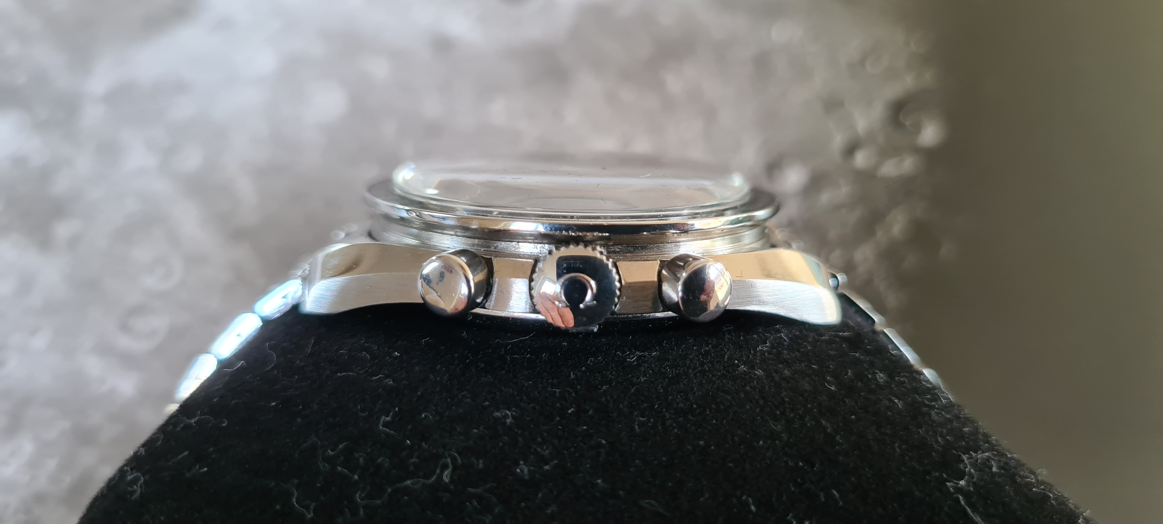

If it is a CB mid case, one has to wonder how the pushers are fitted

You may love this, and unless you have thick skin, you may want us to stop looking and commenting on it.
Just tell us to stop, because you may not still love it when we are finished.

No, there is a HF caseback, but for me it looks like a CB, because of the little step at the horn and the line at the sides.

Oh, this does not sound good. The pushers are working well, not sure if they are the "wide and short"?

If you want to know what I really think, post some photos of the whole watch, and also the inner case back and the movement number, at least some of it.

I also ended up on the "Chronoholic" page, at first I was unsure about the shape of the lugs (they're probably slightly polished on my watch), but based on the silhouette (MK 3), I assumed my watch had a CB case. The 105.012-66 and 145.012-67 SP have the same middle case shape.
However, the CB cases had to be modified for the screw-down pushers (145.012-67 SP/ SP2).
There were apparently CB case variants with a CB caseback, but also some with a HF caseback, straight from the factory. As I understand it, the HF casebacks were stamped "SP" and the CB casebacks with "SP 2". If you look at the more unusual pieces, you'll also find many double stamps or erased reference numbers to relabel them; this shows that Omega was very pragmatic and economical with the parts.
My watch, however, has a HF case back. On my version, the pushers are neatly screwed in (SP = special pushers / "speciale poussoirs"). Admittedly, I'm not knowledgeable enough about this to make a definitive judgment, and I've forgotten a lot at the moment. That's why I'm glad we can discuss it again with the current information. As I said, I really want to know for sure, even if it turns out the watch has been modified.
