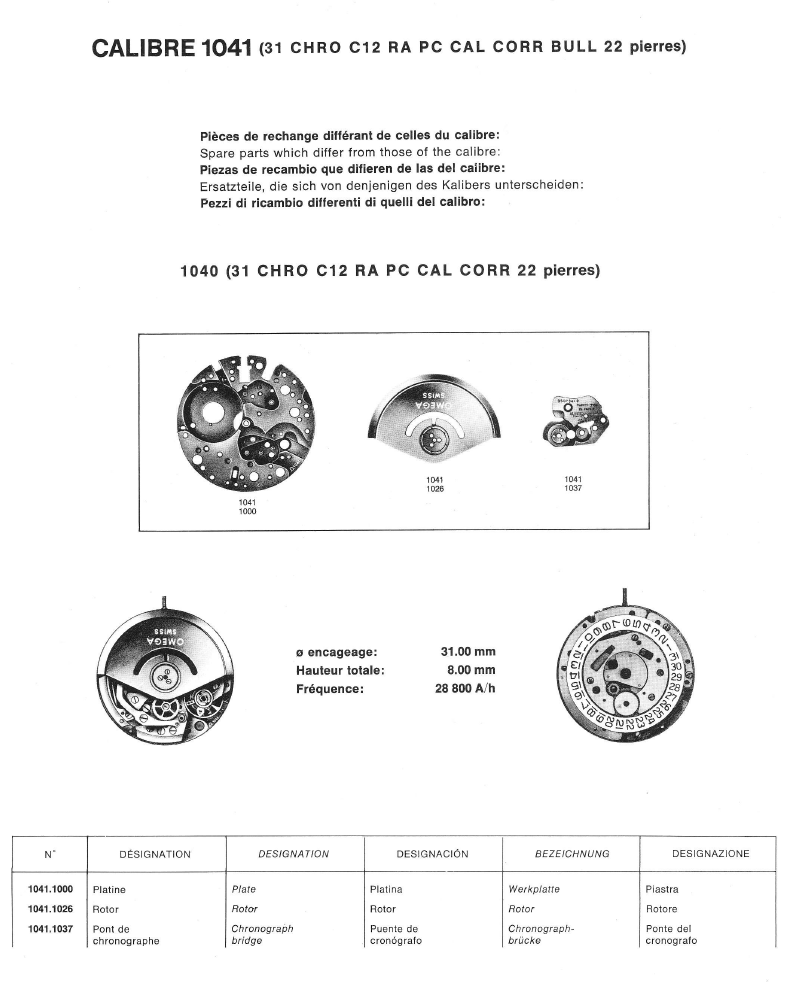

The 1040 &1041 are identical movements, just differs in stamping of SN etc, as 1041 is a chronometer examined movement. 1041 was used just in this Speedmaster 125 model and often swapped with more common 1040.
As this is basicaly Lemania movement, most of the part may still be reachable for a smart watchmaker...

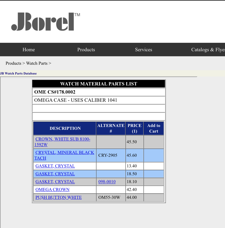

If you check Jules Borel's compatibility chart you will this not to be true.
They are not the same movement and a click on random parts shows they don't work with each other except for some shock springs and a forth wheel
Loads of parts for a 1040. Next to nothing for a 1041

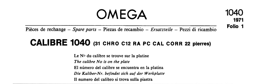

From the Omega tech manual -- it says that only 3 parts are different.
kind of odd that Jules Borels chart don’t match.
Also. Why would the main plate be different? Wouldn’t that affect the going train etc. if the only difference is that one is a chronometer?
someone’s wrong

I think they do.
It says cal. 1041 for the Omega 125 case reference.
The list of 1041 parts is very short, because there are relatively few dedicated parts for the 1041. Most are compatible with the 1040 movement and its Lemania equivalents.

Image you posted is for case parts. Not movement parts
But if you go to the caliber 1040 and check parts. The 1041 is not listed if you click on particular parts
This is why I wondered why the main plate is not compatible if the parts are the same. Something had to be changed for them to make a new main plate or why bother
I don't own one. Just odd to me. Maybe a Borel incomplete listing with the 1040 page

Because the1041 only has 3 parts and those three parts are not compatible?
302
224
All the parts are compatible of course, the difference is only in stamping of those 3 1041 parts as shown in the pat catalog above and as I said in my previous post.
The base plate differs surprisingly also with different stamping, as there is stamped 1041 instead of 1040 😀)
It is not a rocket science, just accept the facts...

Marking on main plate for 1041 identifies caliber as being 1041 compare to marking on main plate for 1040 identifies caliber as being 1040. No other differences for main plate. Same in true for other two parts that have no functional differences, only markings specifying adjustments at five positions and temperature and serial number location, and finish, as Knudsen1971 and Marte stated previously. I have seen 1041 movements in Omega and other chronographs originally fitted with 1040, 1340, and 1341 movements and vice-versa, all functioning fine. All great movements with very minor differences except for 22 versus 17 jewels for various movements and COSC tuning for 1041. Other than jewel fitment and adjustments, distinctions without differences.
