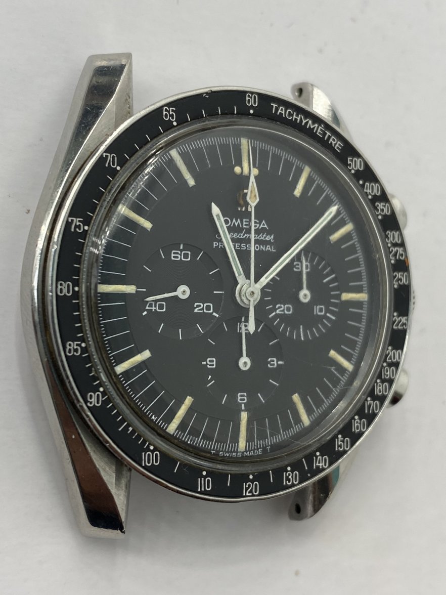

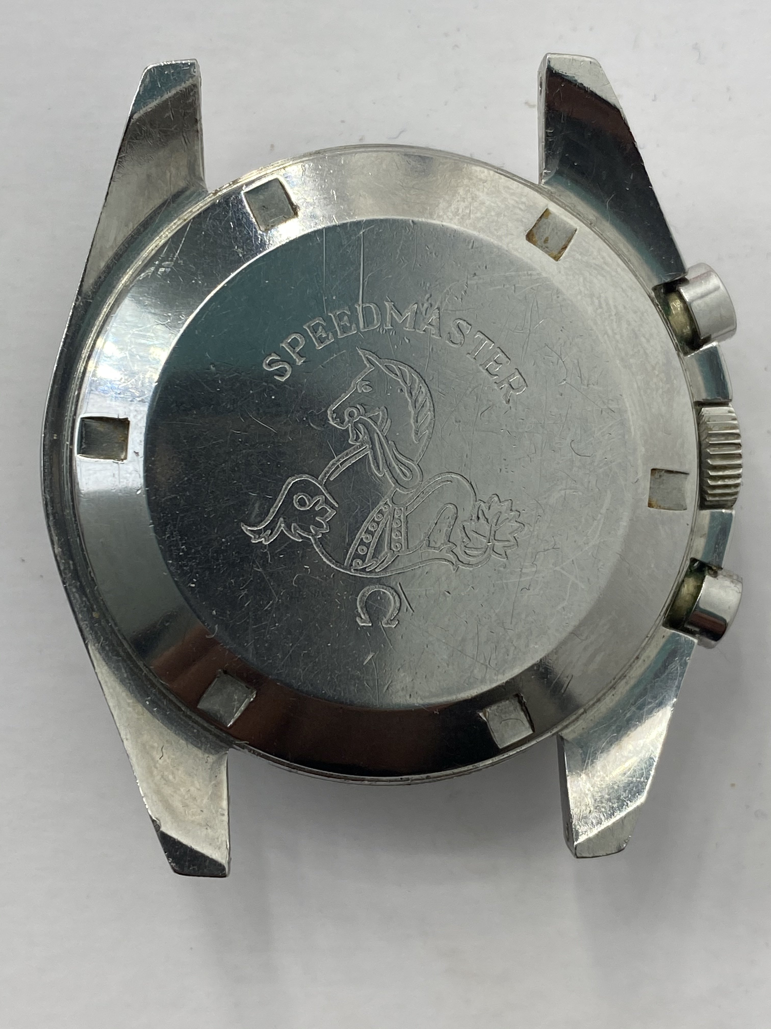

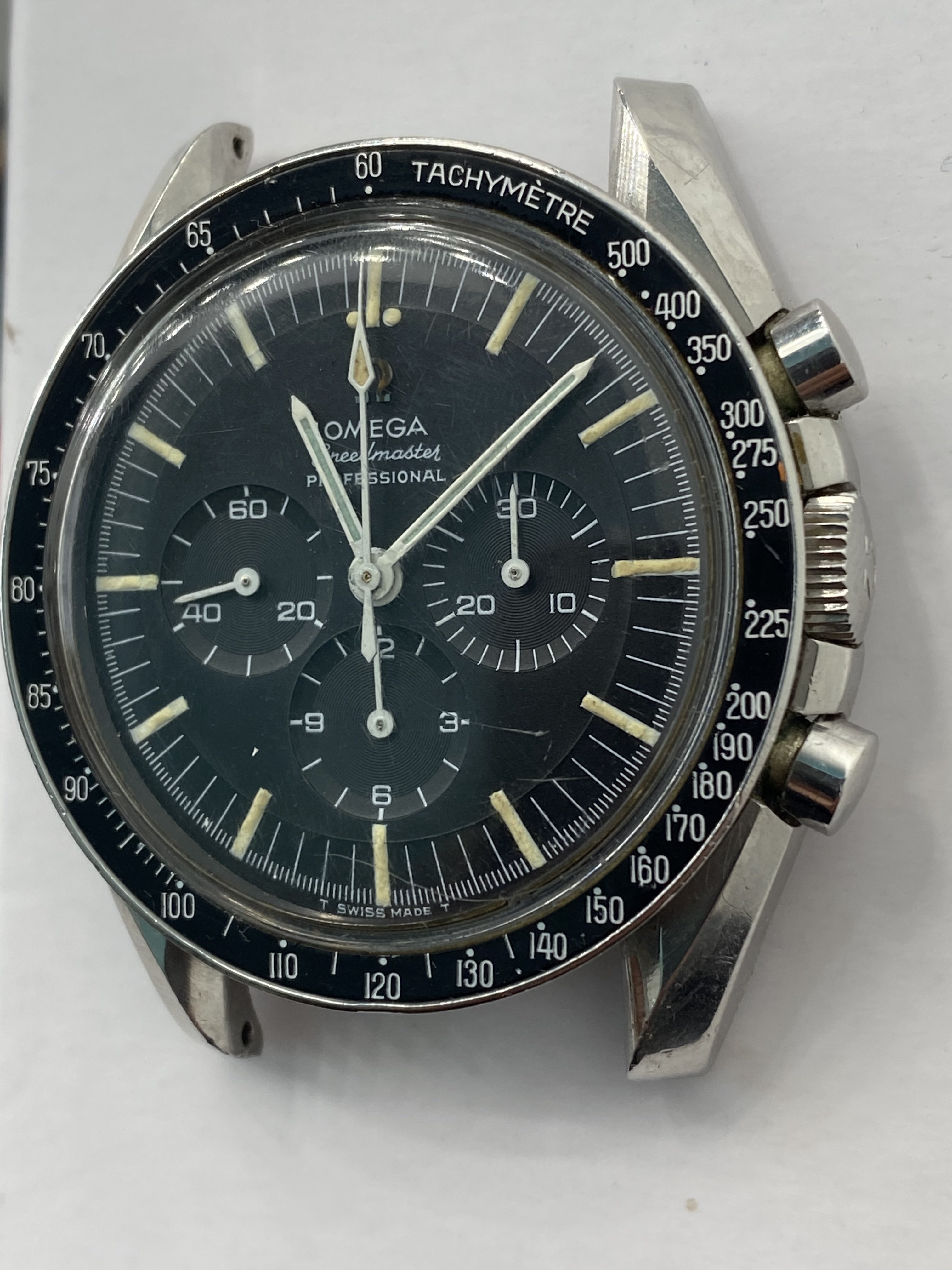

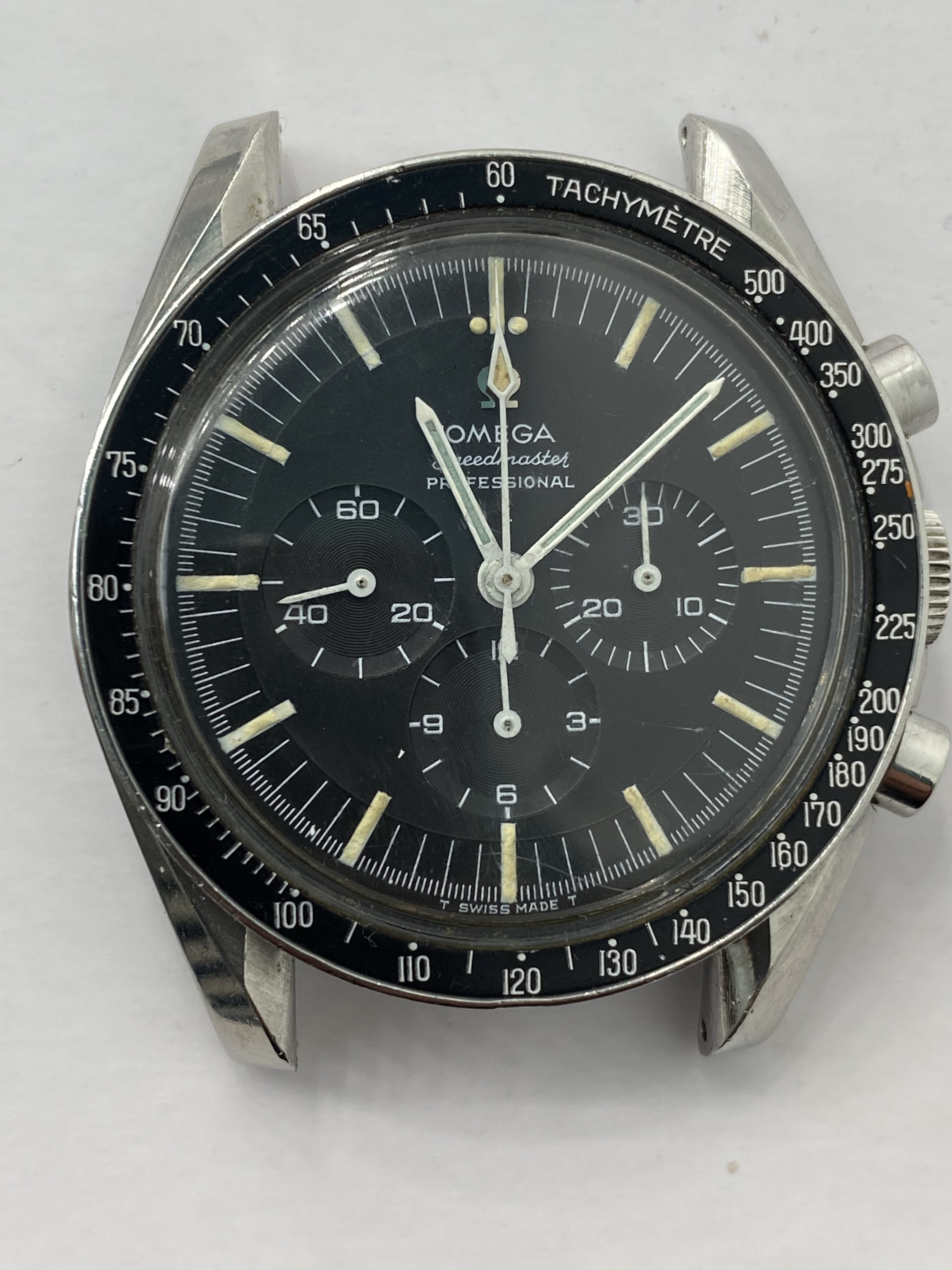

My late father left me his speedmaster. I know he acquired it in the early 1980’s, and put it away because it was “broken”. After getting it, I found out How to operate the watch from a quick google search. And it worked fine. Anyway, I am looking for input as to if all this looks correct for the case stamping, as I have no experience in these watches. Thanks.

Looks correct from what I can see with the possible exception of the hour and minute hands, which may be replaced (or maybe just re-lumed). If you can post photos of the inside of the case-back and the movement serial number, we can also check that for you.

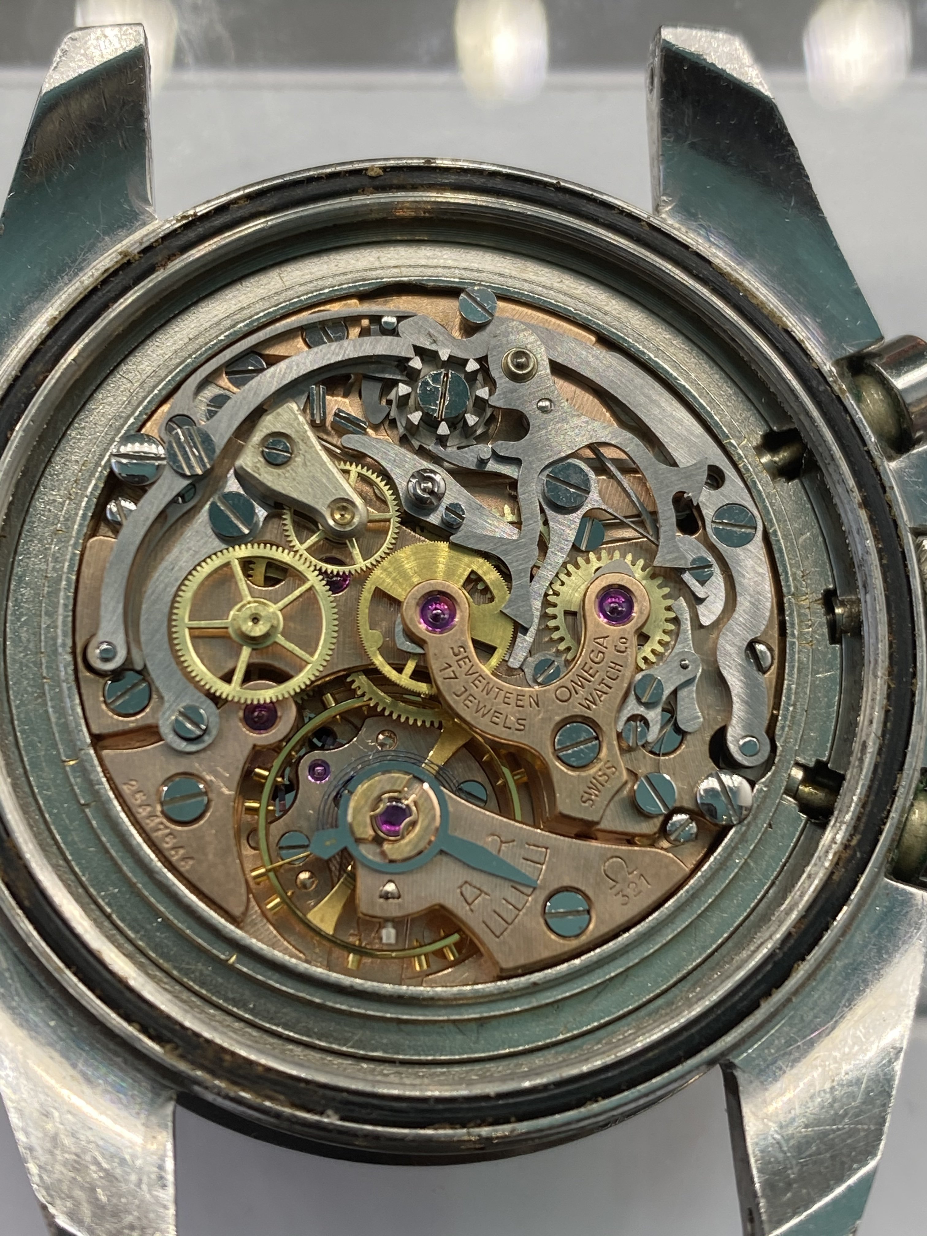

Looks good from what I can see with the possible exception of the hour and minute hands, which may be replaced or re-lumed. If you can post photos of the inside of the case-back and the movement serial number, we can also check that for you.

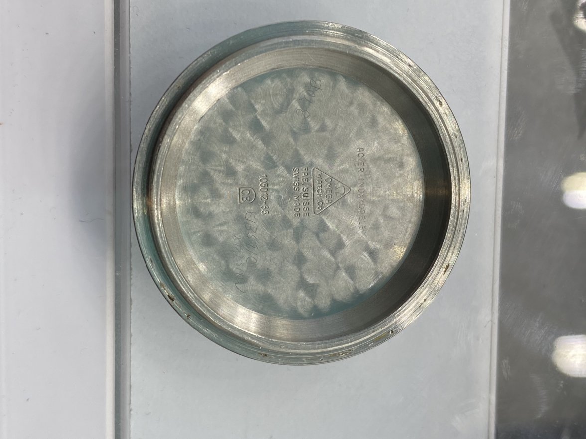

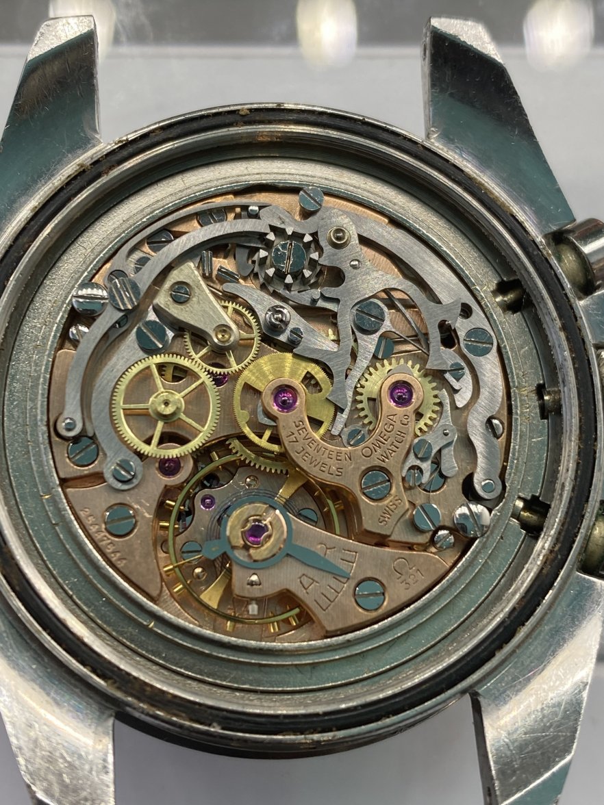

Here are some photos of it.
905
2,489

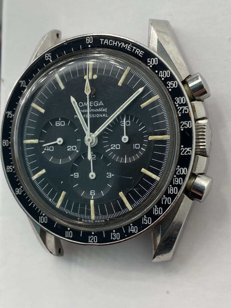

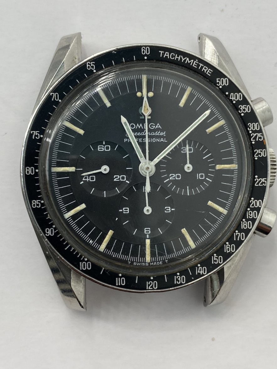

Congratulations! Looks about right, correct serial for a 105.012-66 and a nice CB case. As stated above the only “negative” to the watch is maybe the greenish lume on the minute and hour hand. To me this watch checks out to be a good example that only needs a proper service and some polywatch on the crystal. Fat pushers look good also, don’t see the crown properly to assess its condition.
1,258
2,738
You have to source a matching crown.
I am right to assume the watch still has its original crown?
905
2,489
I don't think so.
To me the crown looks original, but just like it would be without a gasket or badly aligned as it’s very far in the case.

Looks great, bar some slight loss of lume. A nice example with good bezel and case as well as original pushers.
Take the time to find a competent watchmaker, sympathetic to vintage pieces to get it serviced.

Yes, it should be a 24-tooth flatfoot crown I believe. The OP would need to show a better photo, although it does seem to be a 32-tooth crown. There's nothing wrong with having an authentic service crown on the watch. Just a matter of taste for a given collector.
2,086
2,899
I wouldn't worry about a service crown. But this crown is simply wrong. It is too thin, which makes it hard to wind the watch.
