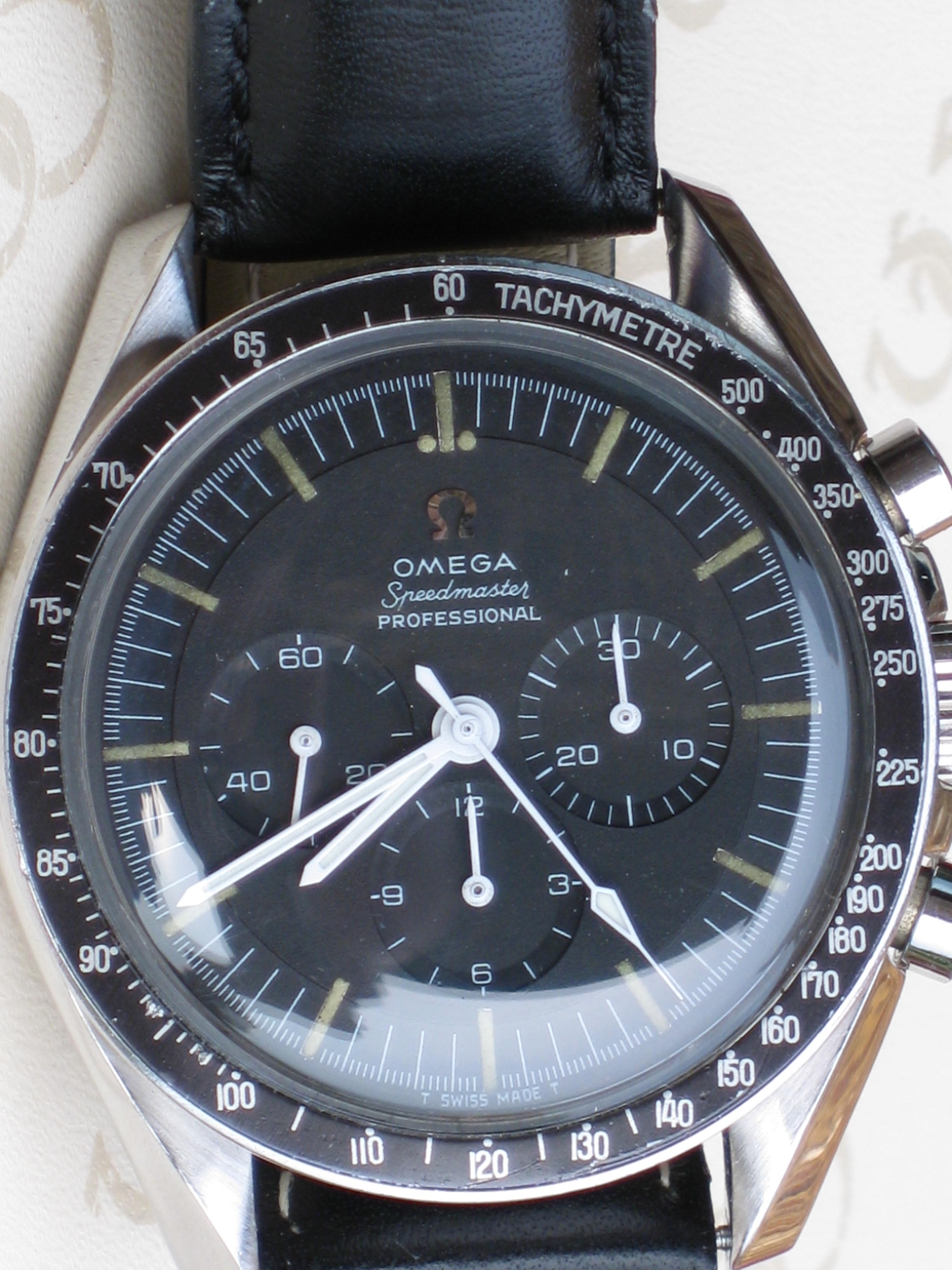

    Hello O.F.-members and viewers,
    I have a Speedmaster 105.012-65 wit a strange Dial and I would like to know if it is a correct Dial or a fake one.
    The concentric rings are missing with the seconds sub-dial (I will try to take pictures) and the text "T SWISS MADE T" is loose from the minutes markers which is strange by the "Close T"-version but normal by the "Spaced T version"..
    Could you please explain?
    Kind regards,
    Eric

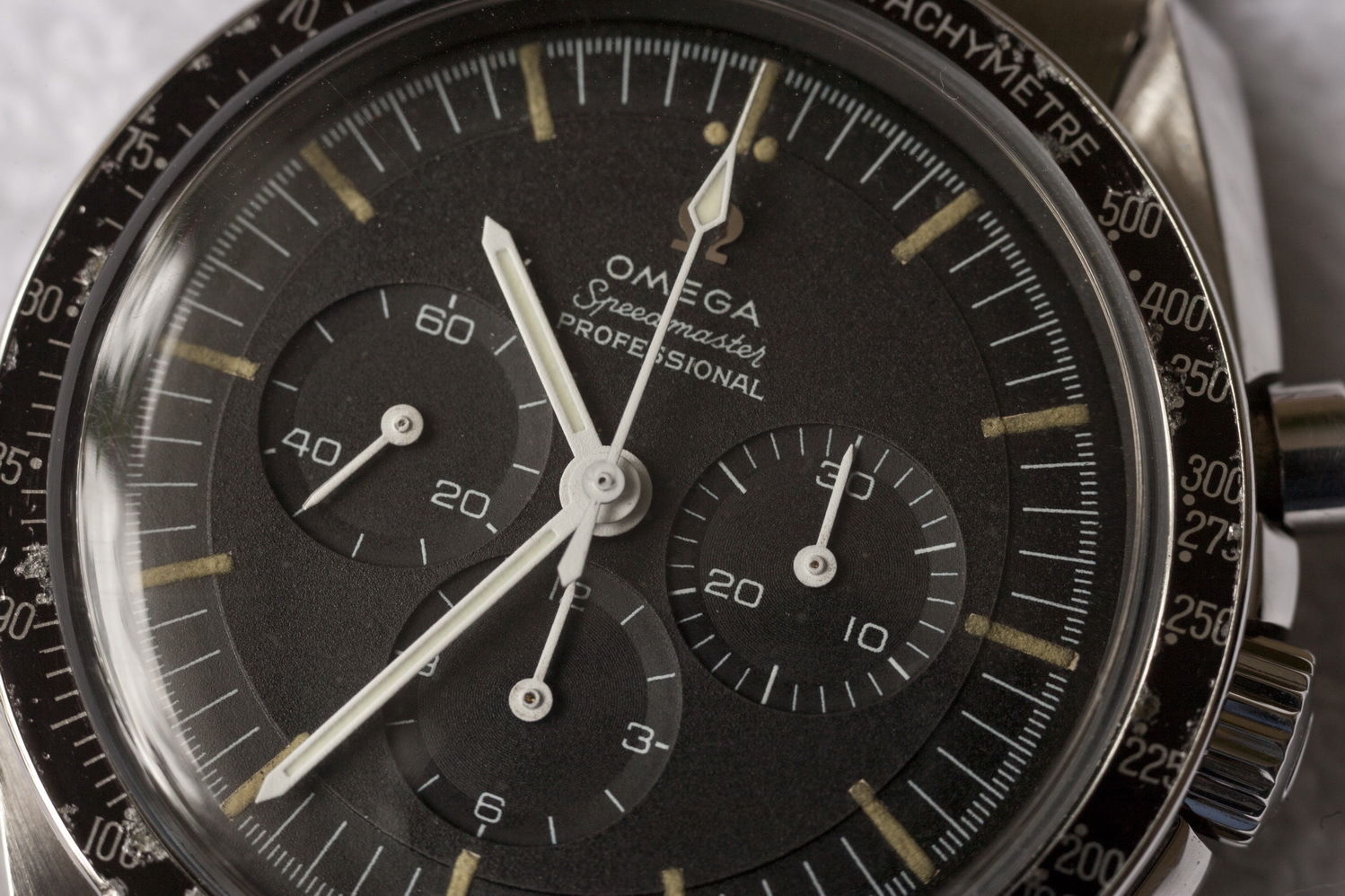

    Eric - high resolution pics will help so when you get a chance. Had to dig out my copy of MWO underneath a mountain of boxes

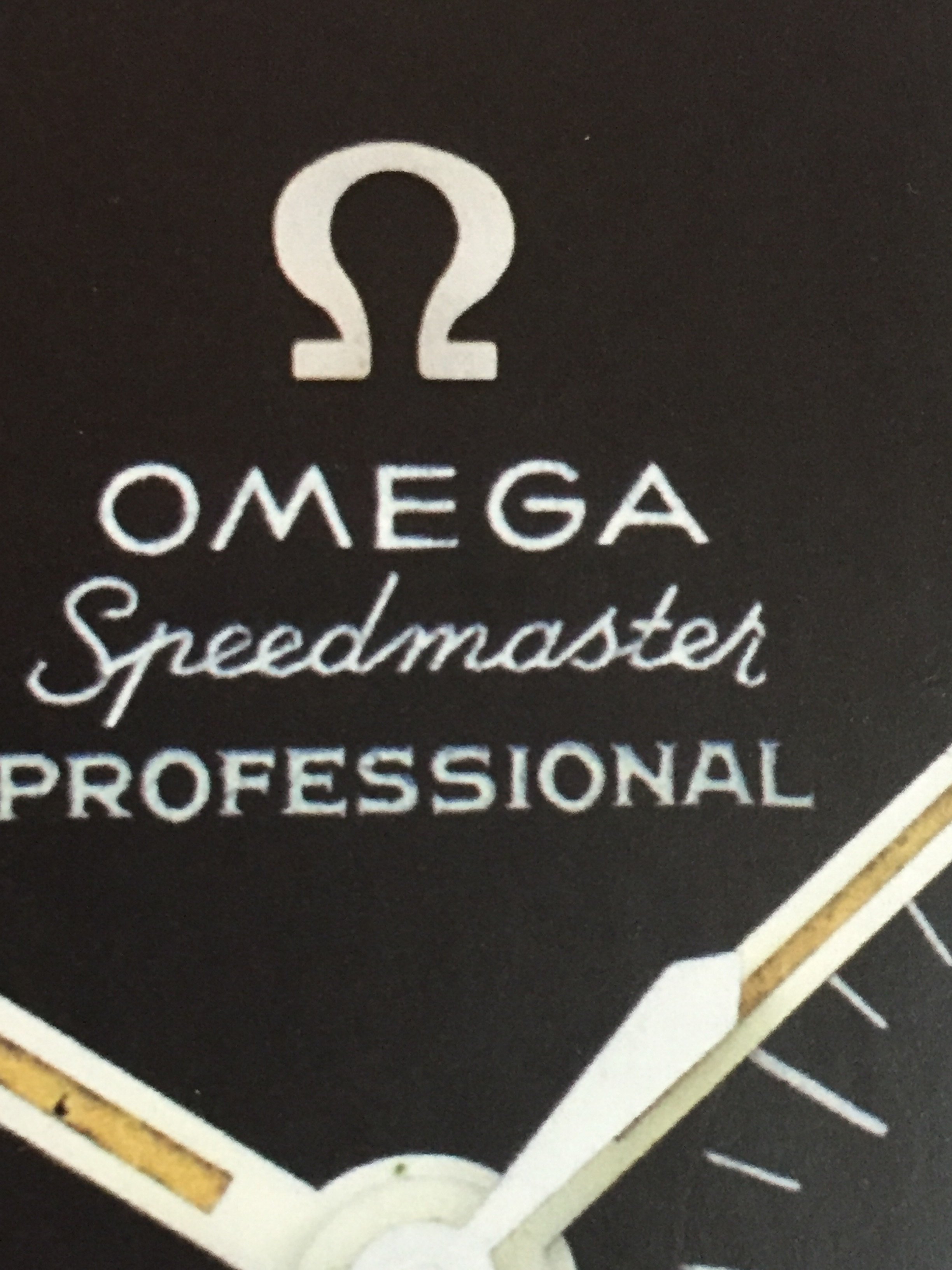

    From what I can tell, this seems a B2 close T dial per position of the T on each side of swiss made. However 'swiss made' seems positioned a bit lower than I'd expect. See here -
    Again, detailed pics will give a better view, but, seems the G in OMEGA should have a longer horizontal length than in your pic, and I think should look like this to be the B2 type dial typical for 1964-1967 Pro dial -
    I've not seen a dial for this reference without the concentric rings (seconds counter)
    Sure other will have further/ better comment as there can be other observations and examples seen/known by more experienced (and esteemed) OF members
    Run the chrono a few seconds before taking better pics so there be full views of the lettering
    Cheers

  5. Seamaster66 Jun 5, 2016
    241
    239
    Hi,
    This is about the missing concentric rings....
    Rest is coming.....

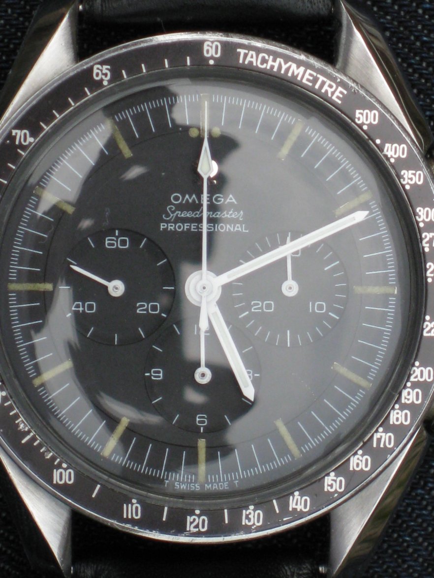

  6. Seamaster66 Jun 5, 2016
    241
    239
    Oeps,
    Wrong button:
    And the G:
    Sorry about the waiting....

  8. trackpad Jun 6, 2016
    707
    1,030
    Fascinating issue, there has been a lot of discussion about how these rings seem to vary from virtually non-existent to very visible and pronounced across different dials and references. I can understand why it's made you nervous in conjunction with the T space issues...but (without really being qualified to know) it seems to me more like a case of a Monday morning / understudy dial-job than a redial or outright fake.
  9. Seamaster66 Jun 6, 2016
    241
    239
    Thank you guys for the answers :thumbsup:.... and it seems that the Dial is original..... :rolleyes:
