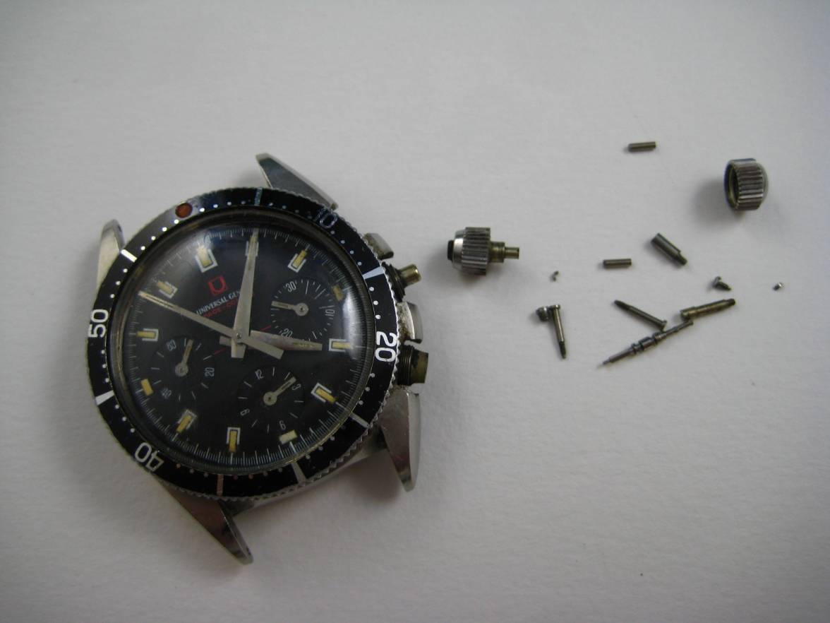

  10. wave62 Jan 26, 2016
    5
    Hello, I know I'm late to this blog but I"m looking to fix mine as well. I need a winding stem. Any help?
  11. Syrte MWR Tech Support Dept Jan 26, 2016
    7,422
    20,882
    If it's just the winding stem missing, couldn't a skilled watchmaker just craft one? Considering the value of those watches, i would think it's worth it no?
  12. wave62 Jan 26, 2016
    5
    I have it at a skilled watch maker now and the stem is very complex, it has a spring on the outside of stem and one internally.
  13. wave62 Jan 26, 2016
    5
    Does anyone no where I can find a schematic / drawing of the actual stem that UG used for this case?
  14. Diabolik Jan 27, 2016
    1,372
    2,660
    It is a straight forward two part valjoux 72 stem. needs careful and sizing and setting up. Crown only turns 1/4 turn. There are no springs :mad:
