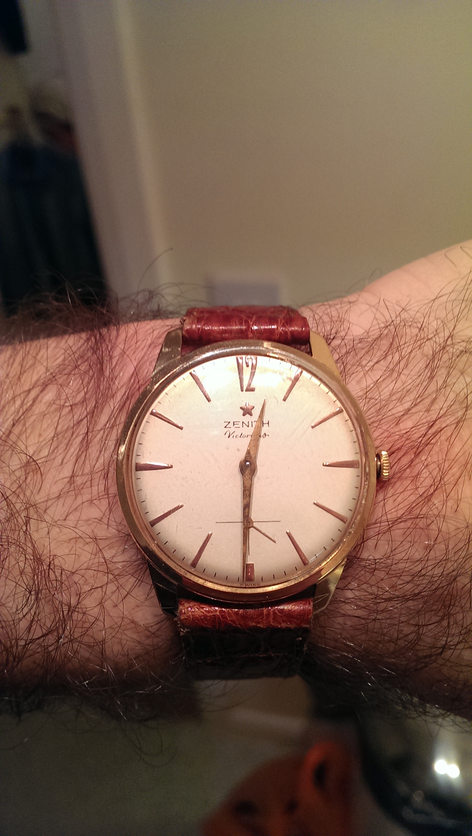

  14. MattUK Jan 2, 2014
    11
    Whoops, i had another thread in the sales section - they are linked (Thought I was on that thread).
    As for pictures - the watch is a present to myself from my other half and she has put it away.
    I managed to take a quick sneaky shot with it first arrived though.
    Its a rose gold case (40-T movement), 35mm without crown, and a Zenith strap.
    Dated to roughly 1961. Bought it from Italy.
    I do have a question though - I noticed the plastic crystal isn't in properly - its a bit loose on the top side (it slightly bulges out near the 12). Can I just push it back into the watch, or should I rather get it professionally done? Afraid I don't have any pics of that. I get the watch at the end of Jan, so will post more then.
    Thanks :)
  15. cicindela Steve @ ΩF Staff Member Jan 6, 2014
    15,047
    23,790
    Nice watch, you can't beat the basic gold watch. :thumbsup:
