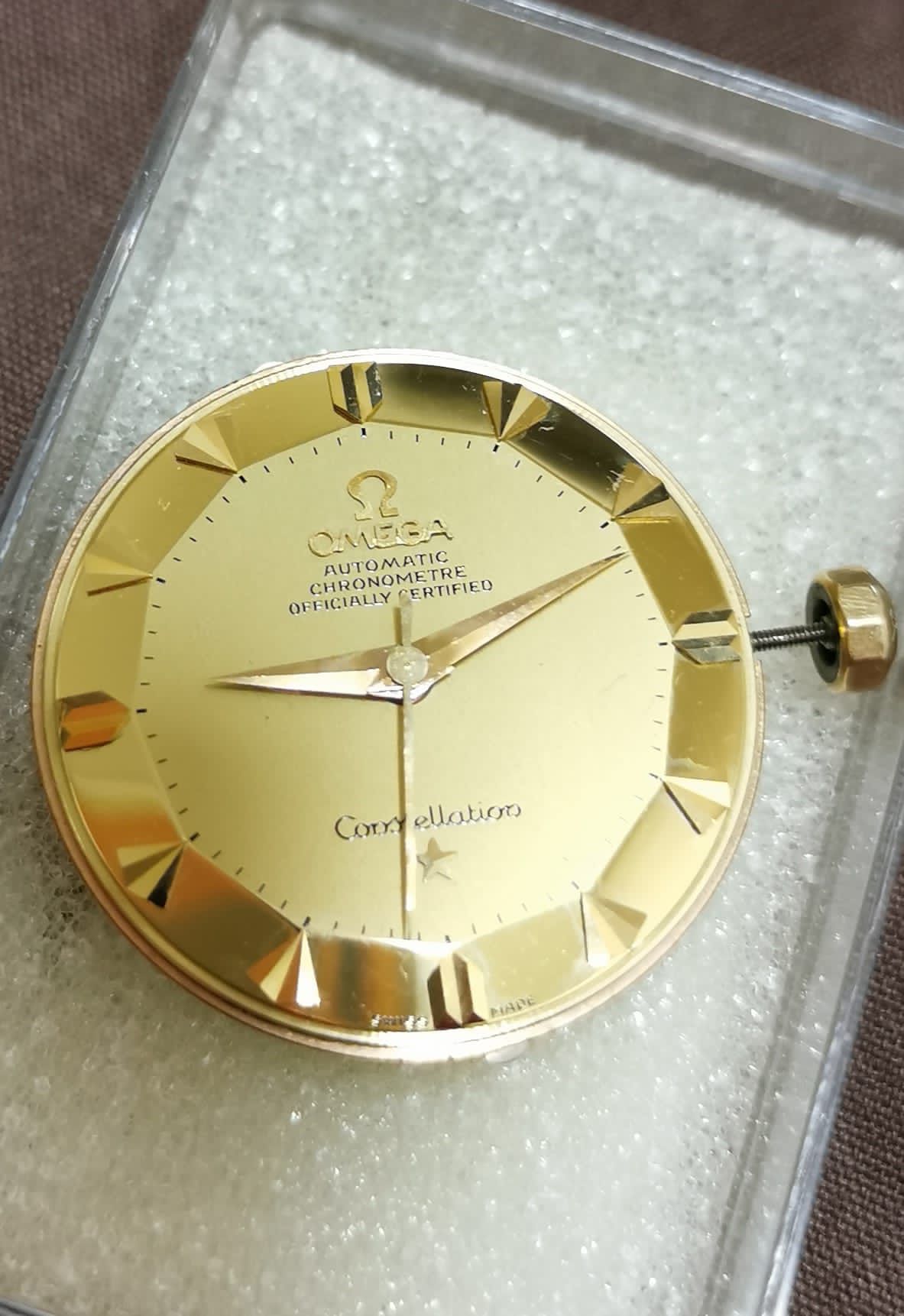

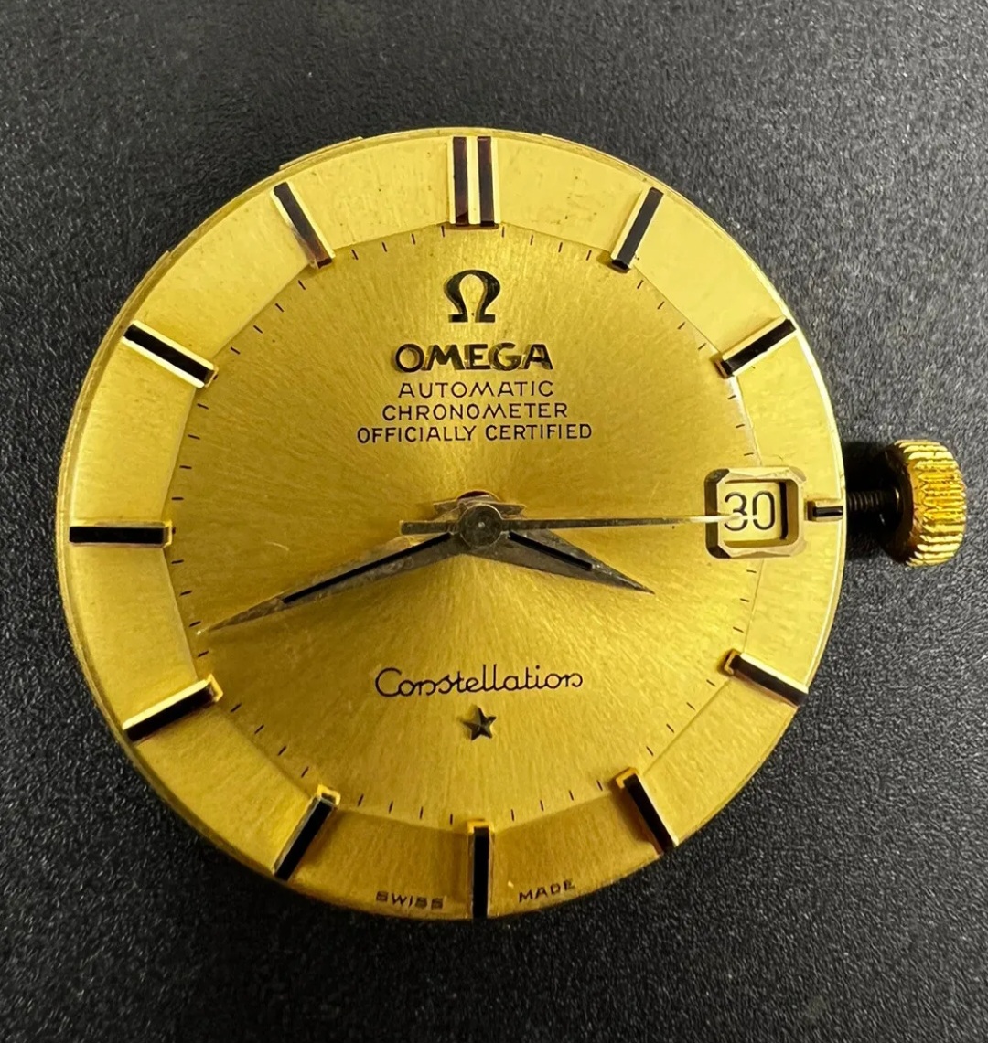

Hello
I am curious when I see on local ads a gold capped 14393 equiped with solid gold dial.
Could it be a franken watch?
To my understanding gold dial should only be used on "high end" ref, i.e solid gold (14K/18K) cases.
Am I wrong, please enlighten me.
Thank you

A solid gold 18k dial would usually be found in a deluxe constellation which would have an 18k case and be denoted a ref 14394, not 14393.
An option would be that a gold dial was an option for special order - but Bearing in mind the deluxe version was a further step up from an 18k cased watch, and has its own reference, I can’t see why Omega would offer that option for a gold cap constellation.
An extract might show its provenance but I suspect it would show it to be a frankenwatch.
More likely the gold dial is a survivor from a scrapped gold case ( but why they didn’t also scrap the dial, who knows)

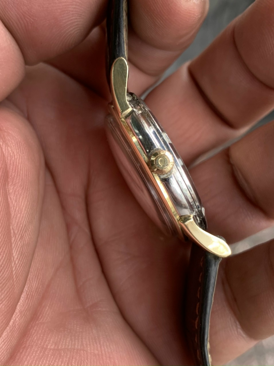

Service crown and service strap, wonder if this one has been to Omega for a service?..and a dial?

There’s no such thing as a known market value for a 14394 dial, as they hardly ever come up for sale on their own. My rough guess would be 500-800$ for the dome variant.

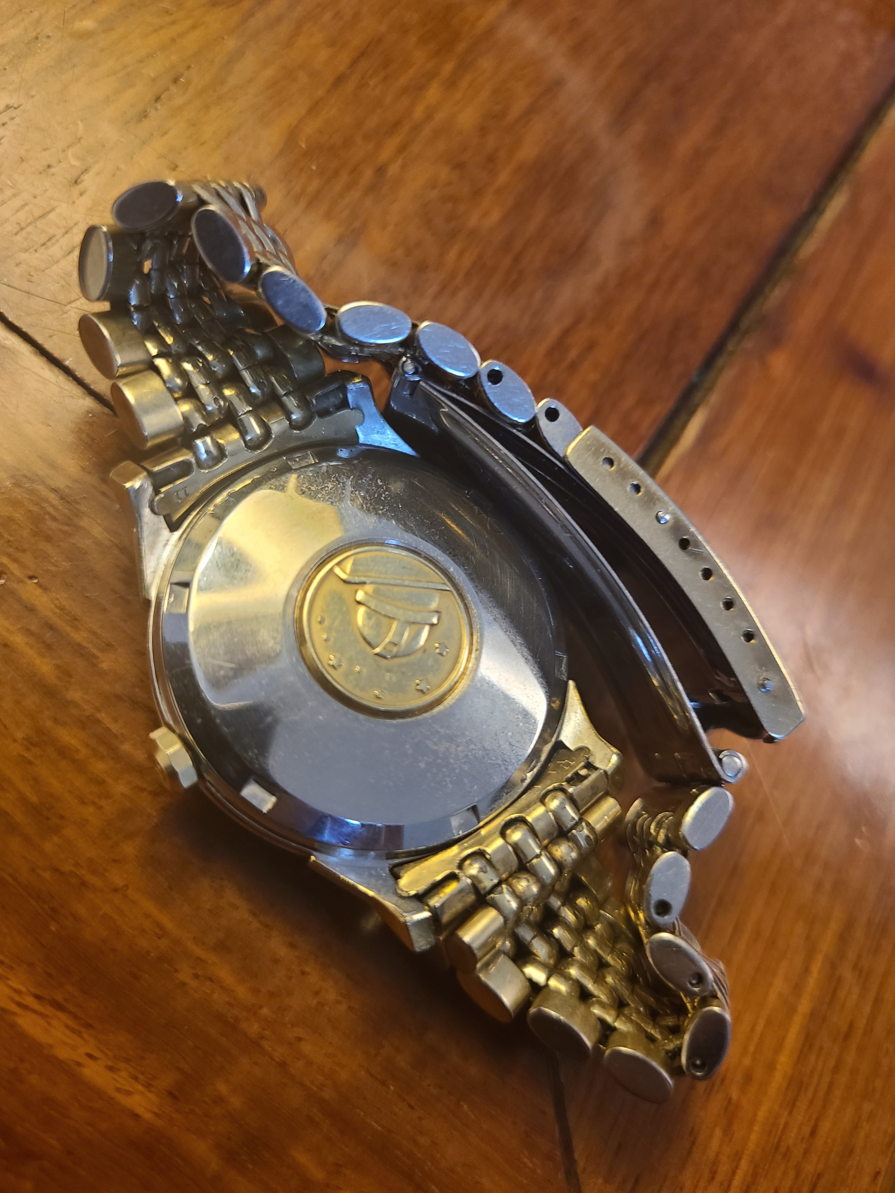

Finding a spare 14393 dial requires some patience and more often than not they won’t be cheap. Your best bet might be to find an 18k 14393 (which shares a case and case back with the “deluxe” 14394) and switch dials to create a gold-capped 14393 example with a regular and a 14394 with a solid gold dial.
I’ve done the same with the kind help of @X350 XJR and a 2852/2853 when I found this:

The 14393 case (so it is at least with the caseback) I posted comes already with gold dial. I don't intend for now. Just curious and self learning with your help. Tks

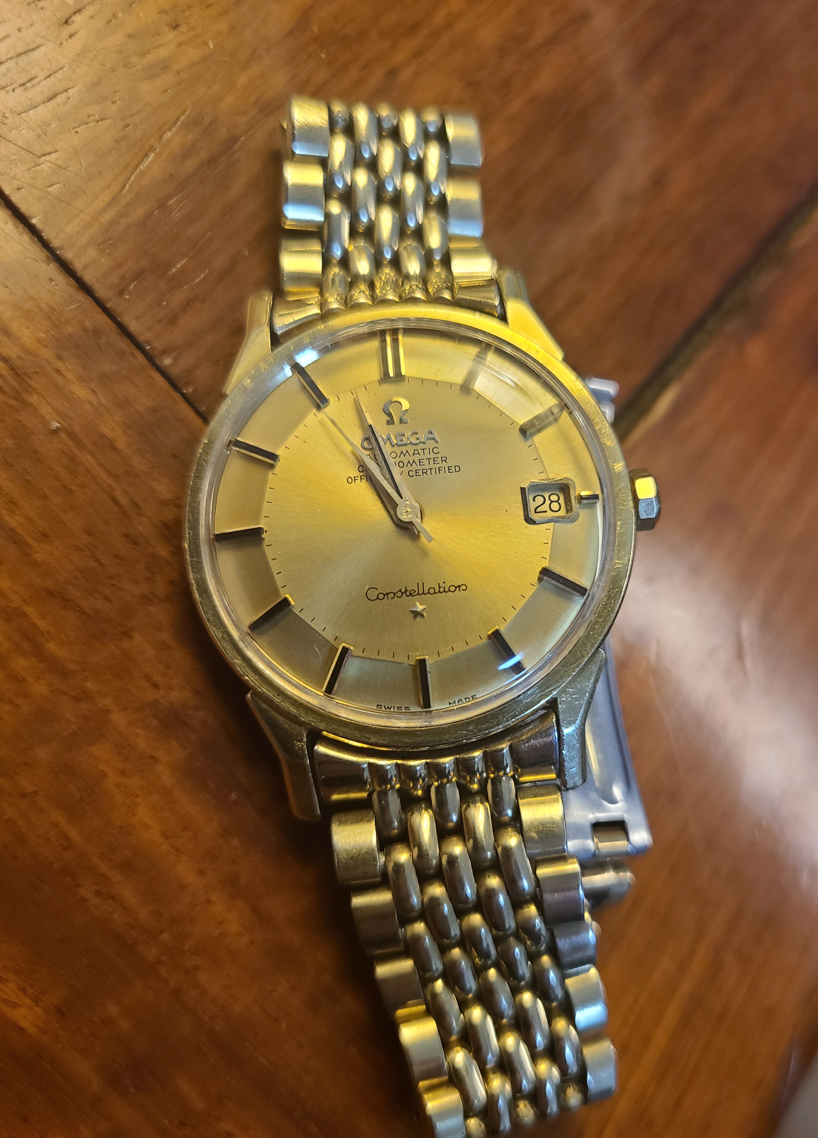

Recently, I bought a 168.006 18k pie pan dial coming with 561 movement. Have it serviced and putting it into a 168.005 gold capped case, bought a 14k gold plated bracelet and an original 10 sided crown for it.
Total cost is @ $3200 for a frankened one but I like it.

What a journey! If ever I buy the 14393 I would let it alone because I am looking for a 'daily beater' and parts are scarce for me (am not really versed into online buys)

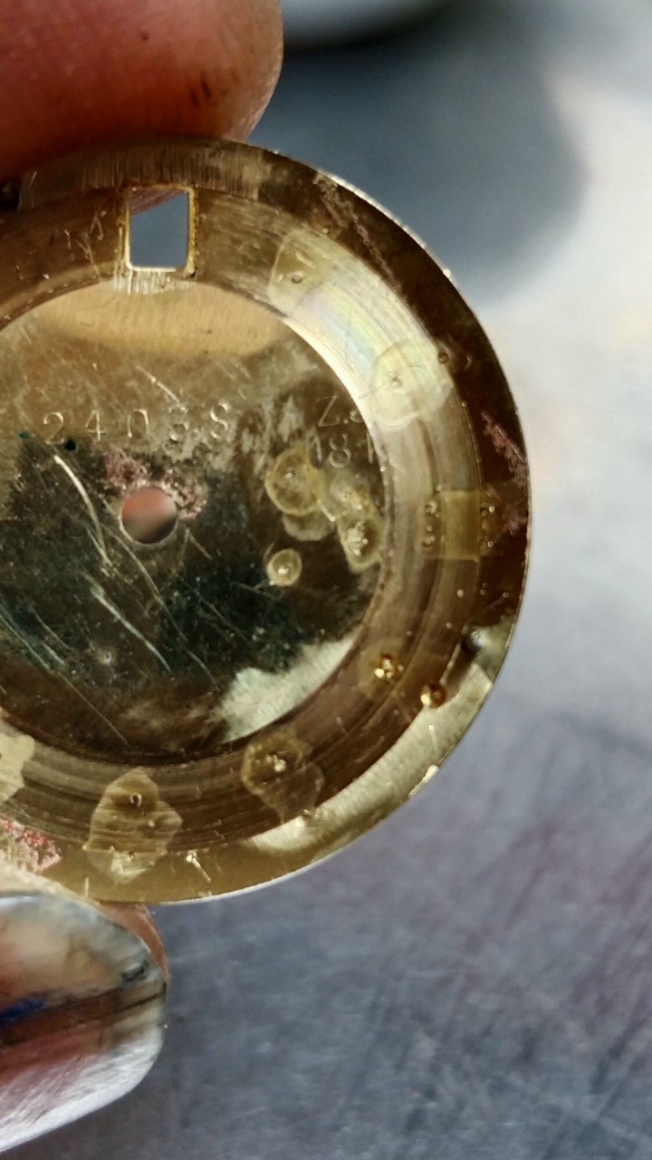

I recently serviced an 18-karat gold Constellation for a friend. The back side of the dial was stamped 18 K. The baton markers were also 18 K, and the markers were set with onyx stones. V often, the front side of the dial will be marked as well. The dial on the subject watch is 90% certain to be plated.

The OPs dial has the correct makers mark and 18k stamp on the rear.
More importantly, it has the correct, wide, flat onyx inserts for a deluxe dial.
This is an early 60s dial and Constellation dials weren’t marked ‘OM’ until the late 60s
Ah yes! Now I see the 18 stamped on the back of the dial. Faint though it is.
