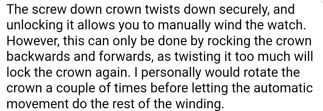

    I am currently wondering how to best respond to the buyer of one of my watches on eBay recently, a Titus Calypsomatic 8940.
    I noted in the description that while manual winding could be done, the crown needed to be rocked back and forth as it locked in after twisting too much whilst in the winding position:

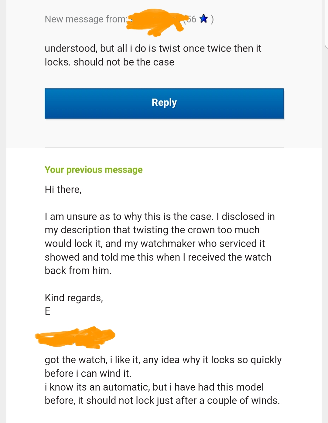

    The buyer received the watch, and has now told me that it is odd that the crown is like that. I responded by telling them I stated it in the description and that my watchmaker had noted it to me when I collected it, so as far as I knew it was like that. They then said they understood and reiterated that the watch shouldn't be doing it.
    I am currently trying to figure out how to word a response or what I can offer, seeing as they bought it and my description says no refunds are allowed unless the watch is not as described. One of my options would be to send it back to me to pass onto my watchmaker to be checked, with all costs incurred by them. I just want to know how I can word it in a way that will be sincere (and not insulting.)
    Responses are much appreciated!

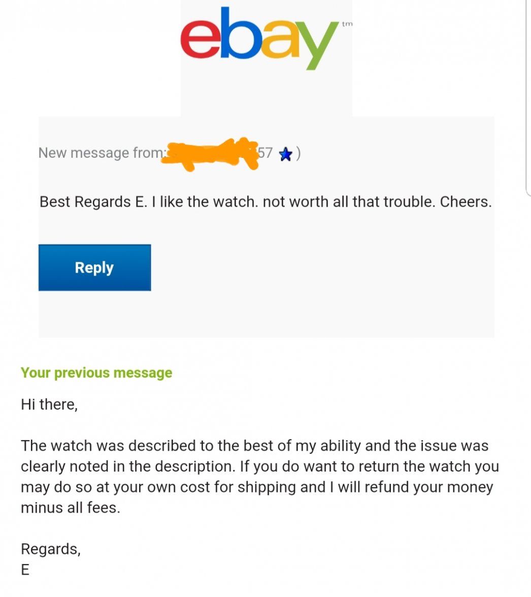

    Tell him you clearly noted it in the description. eBay can see this and your issue with something clearly noted. If you want to unwind the transaction you can ship it back at your cost and I will refund minus all fees.
    There is no way to argue against that. And no harm no foul. Nothing for him to complain about.

    The real question is why your watchmaker didn't resolve the problem instead of giving ti back to you like this. Stem is cut too short and there are a couple of ways of fixing this...

    The buyer contacted me earlier today:
    Well, I did ask him at the time whether the stem could be swapped, to which he said it was a feature of the watch.

    Buyer is keepering it as a reply get got from ebay .,...
