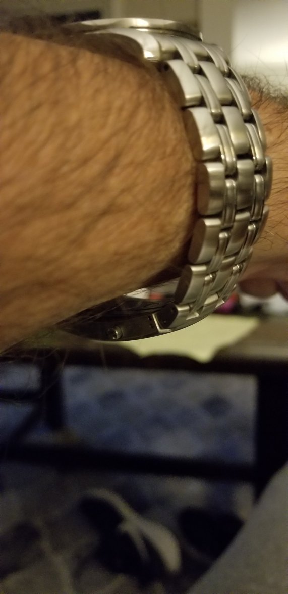

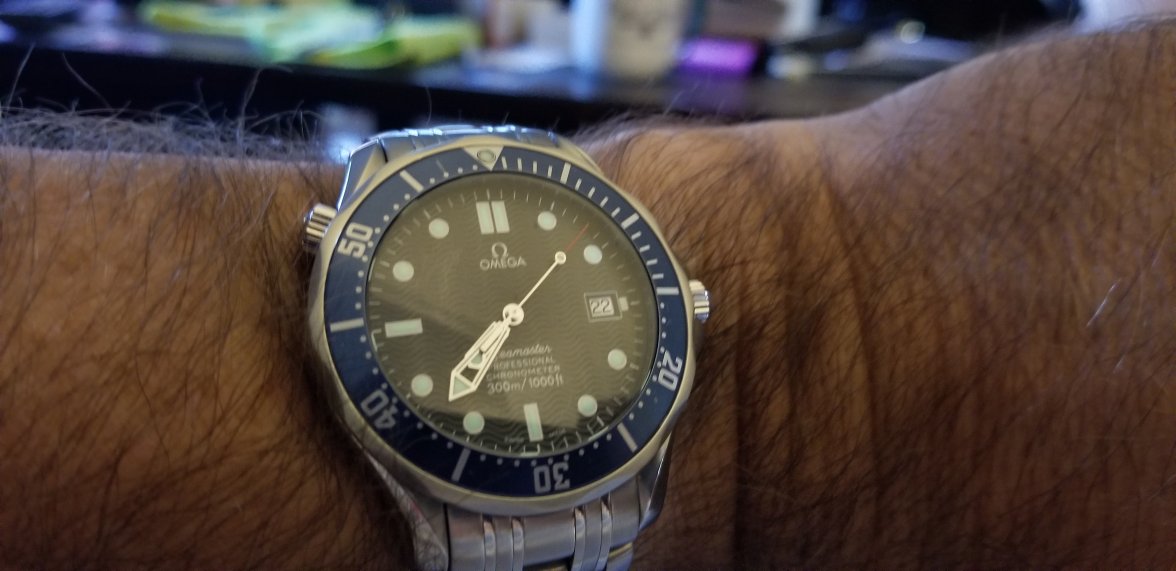

Hi all.
Was wondering if anyone had success changing out the clasp for a newer one that has micro adjustments? I've heard that you can but called omega and they had no idea what I was talking about.. if anyone here has had success please post pics and what parts you got from omega.
As always, thanks in advance for any replies/suggestions

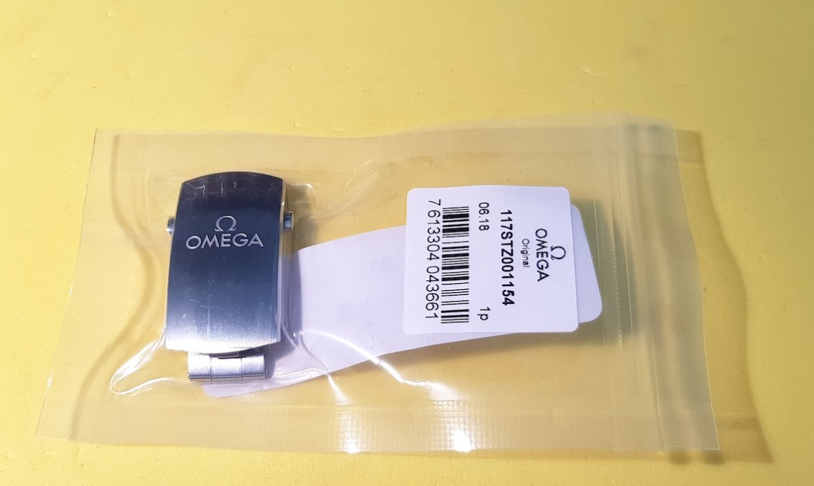

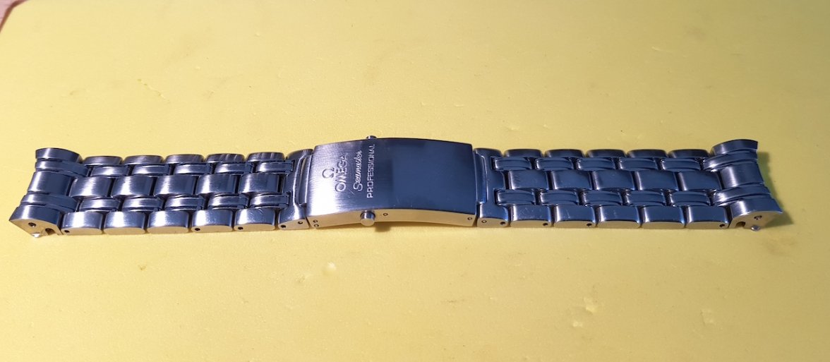

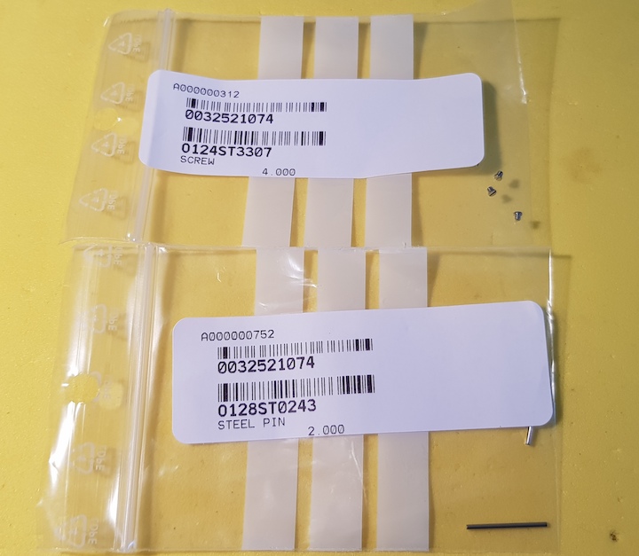

Yes, it's been done. I've done it with a 1504/826 bracelet, that's the one for the Seamaster Chrono Diver of the same era. The parts you'll need are the same.
You need the clasp itself, some pins (2) and screws(4), as the clasp comes with none. and a couple of connecting links for the Bond style bracelet.
You will also need a pin pushing tool for adjusting pin/collar bracelets.
Keep in mind that there are 3 versions of these clasps:
117STZ001154 (the one shown) has 6 extension positions but NO diver's deployable extension.
117STZ001159 has 6 extension positions and diver's deployable extension (a bit longer than the 1154).
117STZ004666 has 3 extension positions and NO diver's extension (a bit shorter than the 1154).

Excellent post Blackdog! Always cool to see successful DIY projects.
An alternative option is to just add a half-link to the 2531's bracelet. Judging by how tight that under-wrist shot looks, it looks like you have room for even a full link to be added?
I think the adjustable clasp is a great counter-balance to the SMP Chrono, but might be too thick for the 2531 (which is already thinner than the 2220). Personally, I'd keep the thinner original clasp and see if you'd be happy with a half-link added.
Thanks so much for the info!! I'm going to give it a shot

Half link added already! Great for summertime, fits good in warmer weather but in colder need finer adjustments, cant get it just right and really think different clasp will help. I'll bet they aren't as thin as what I have now but we will see.
Thanks so much!!

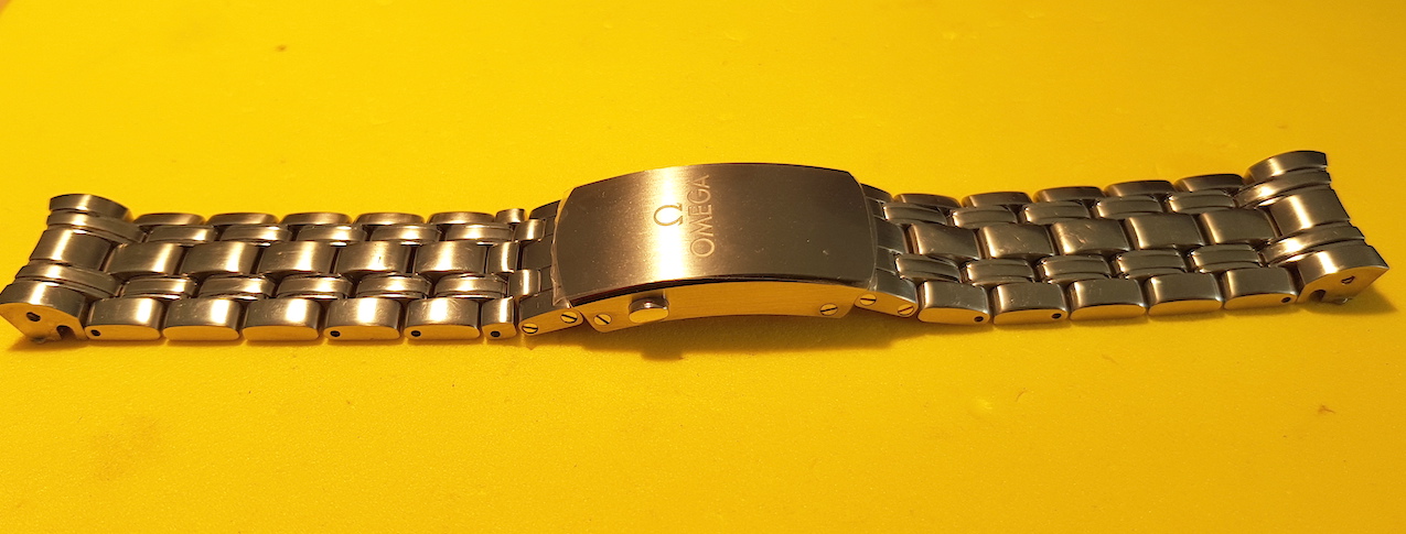

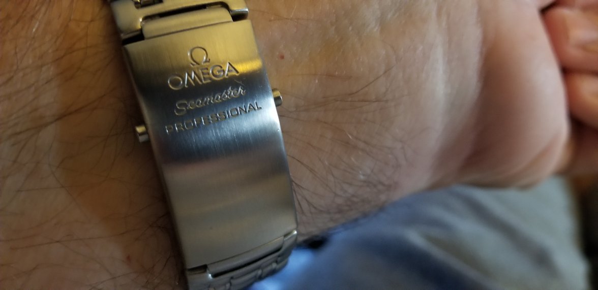

Definitely thicker. See for yourself:

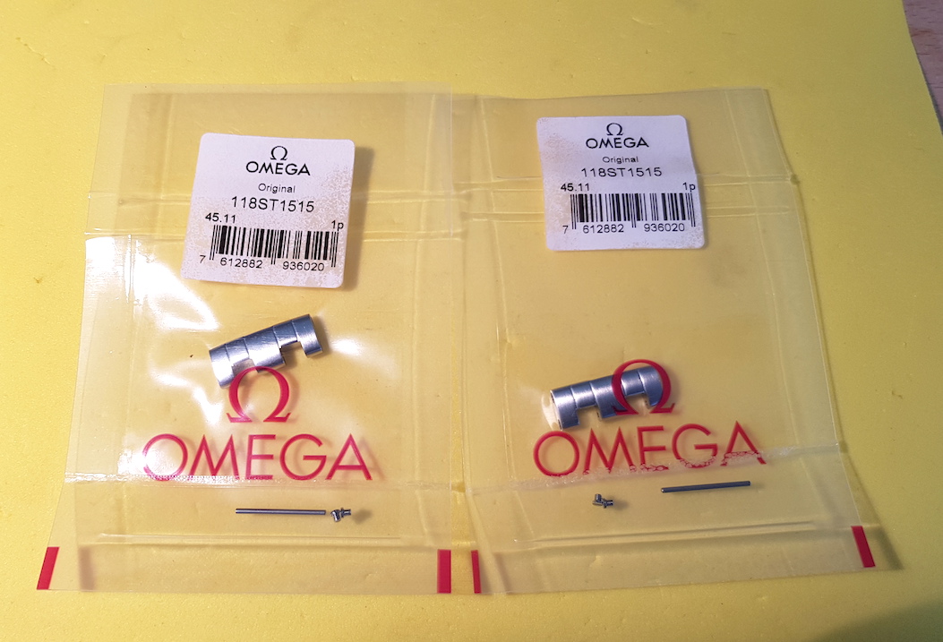

I did it on a 2531.80 a 600m and a GP GMT. here are some links and notes
https://www.watchuseek.com/threads/...ble-clasp-for-bond-1503-825-bracelet.3420314/
https://www.watchuseek.com/threads/planet-ocean-fitment-issues-problem-solved-pics-inside.2938834/
Omega Bracelet Buckle MOD
2531.80 bracelet is model # 1503.825
GMT 18mm at clasp
600m 20mm at clasp
For the GP GMT: 117STZ001154 for 20mm
With divers extension. 117STZ001159 for 20mm
For the PO 45: 117STZ001154 for 20mm
Clasp X1
0118ST1515 End links x2 for Bond
End links come with Pins and screws
117STZ003191 for 20mm
007 adjustable clasp
