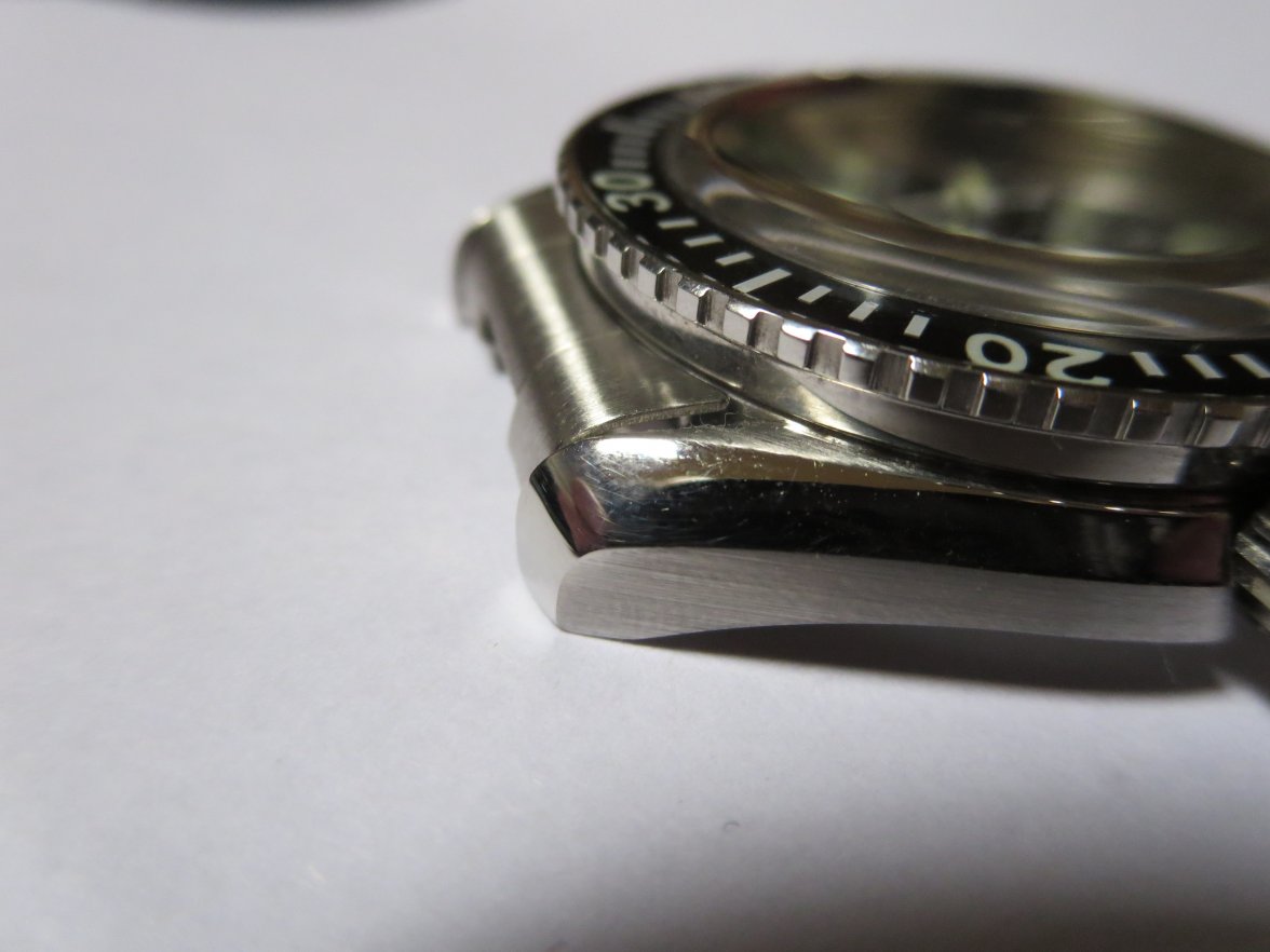

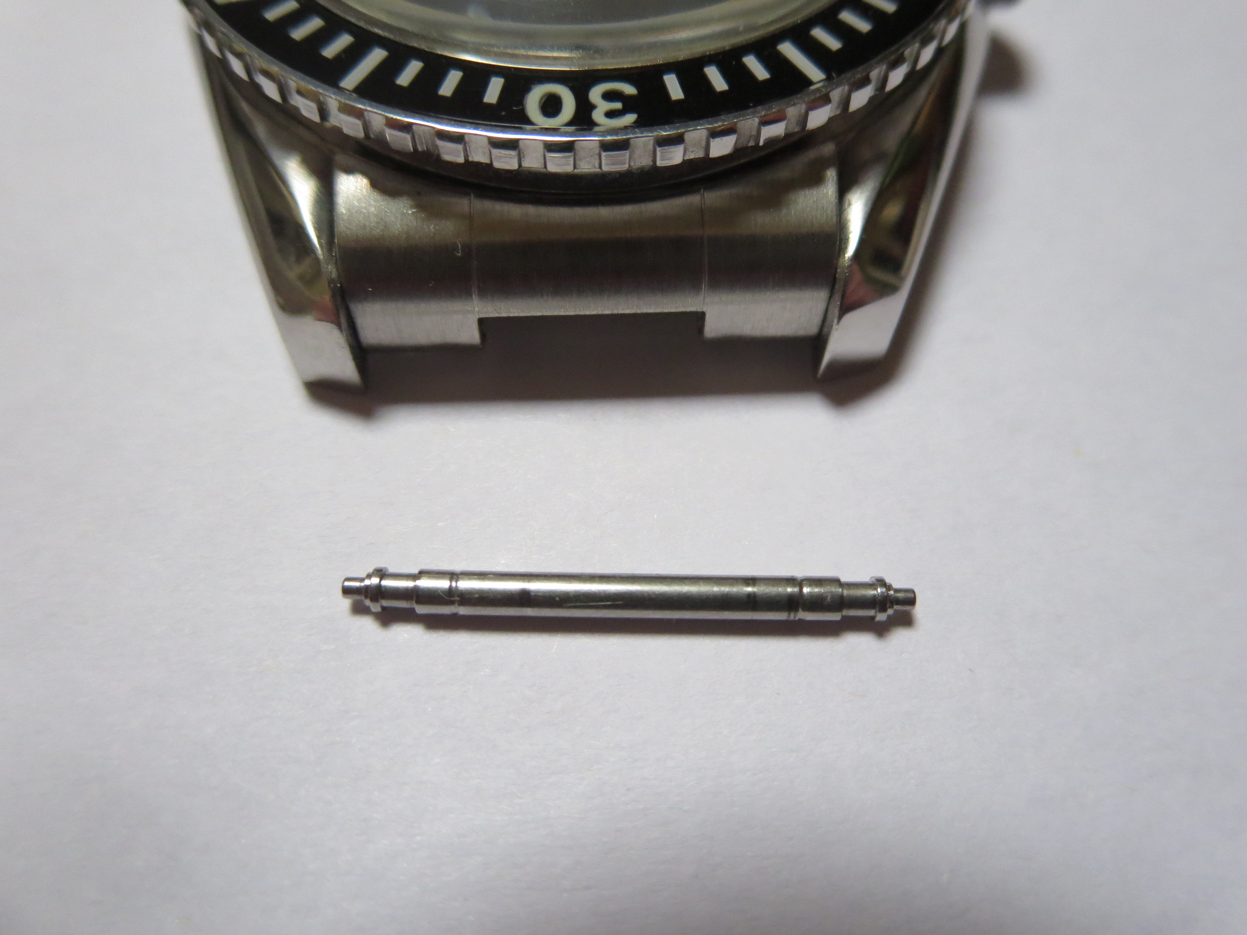

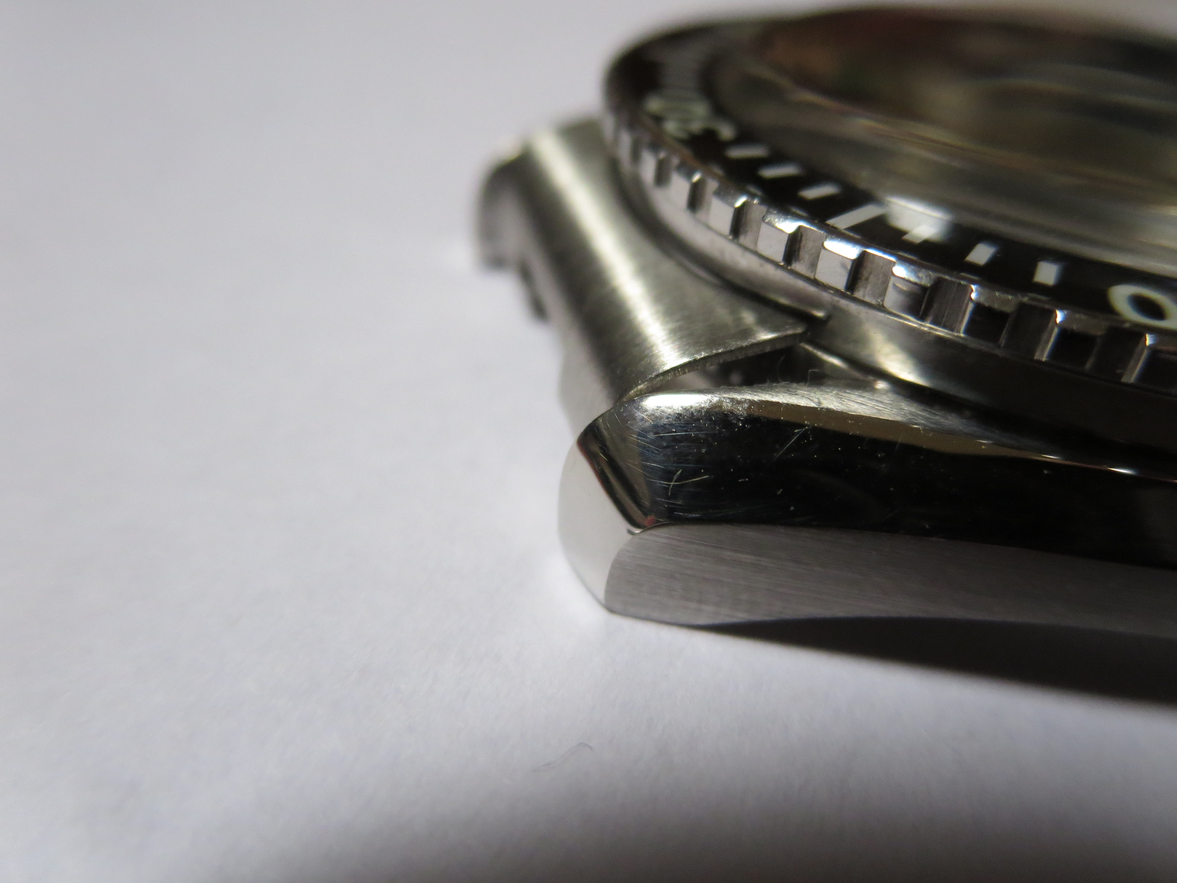

    In the first pic the end piece fits, I think, as it should. Note the small gap at the pointed end of the semi-circle where it it meets the case. In the second pic, a larger gap in the same place. This is how the end piece fits when installed with the bracelet and spring bars. Third pic is the spring bar I am using.

    These "hollow" end links can be bent together (crimped if you want to think of it that way) so the curved part doesn't stick up above the lugs. If that curved end won't fit between the lugs, then they need to be filed.
  5. kingsrider Thank you Sir! May I have another? Oct 30, 2017
    2,689
    5,431
    Got it. That should give the spring bar a little breathing room. I think a little filing will be needed too. Thanks for your input.
