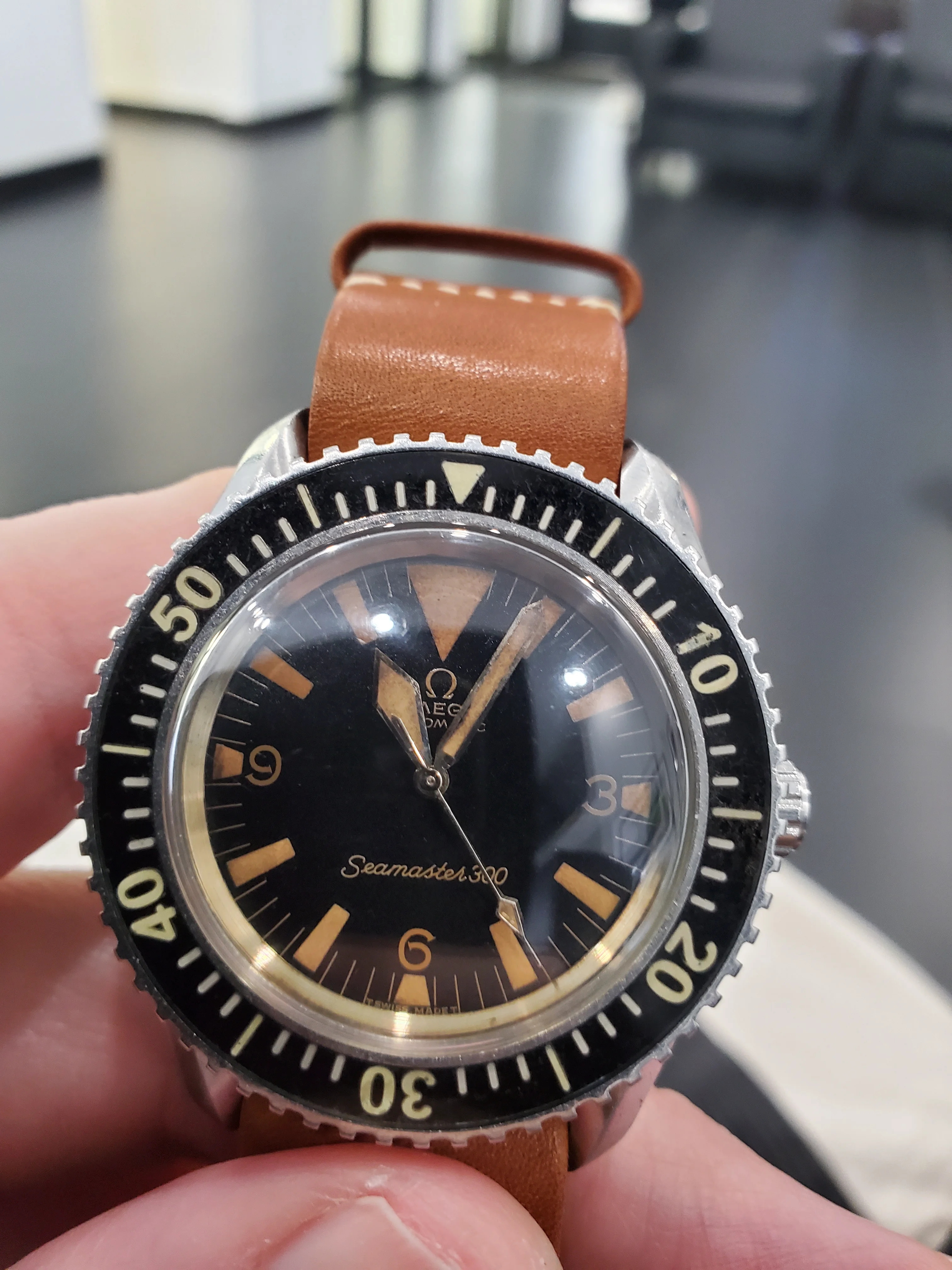

Are the SM300 sweep second hand supposed to be painted white or polished? Or both?

Well, that is a fake SM300, so the second hand is a relatively minor issue.
Usually the unpainted second hand is an indicator that the watch may not be genuine. The unpainted hands are common with the fakes

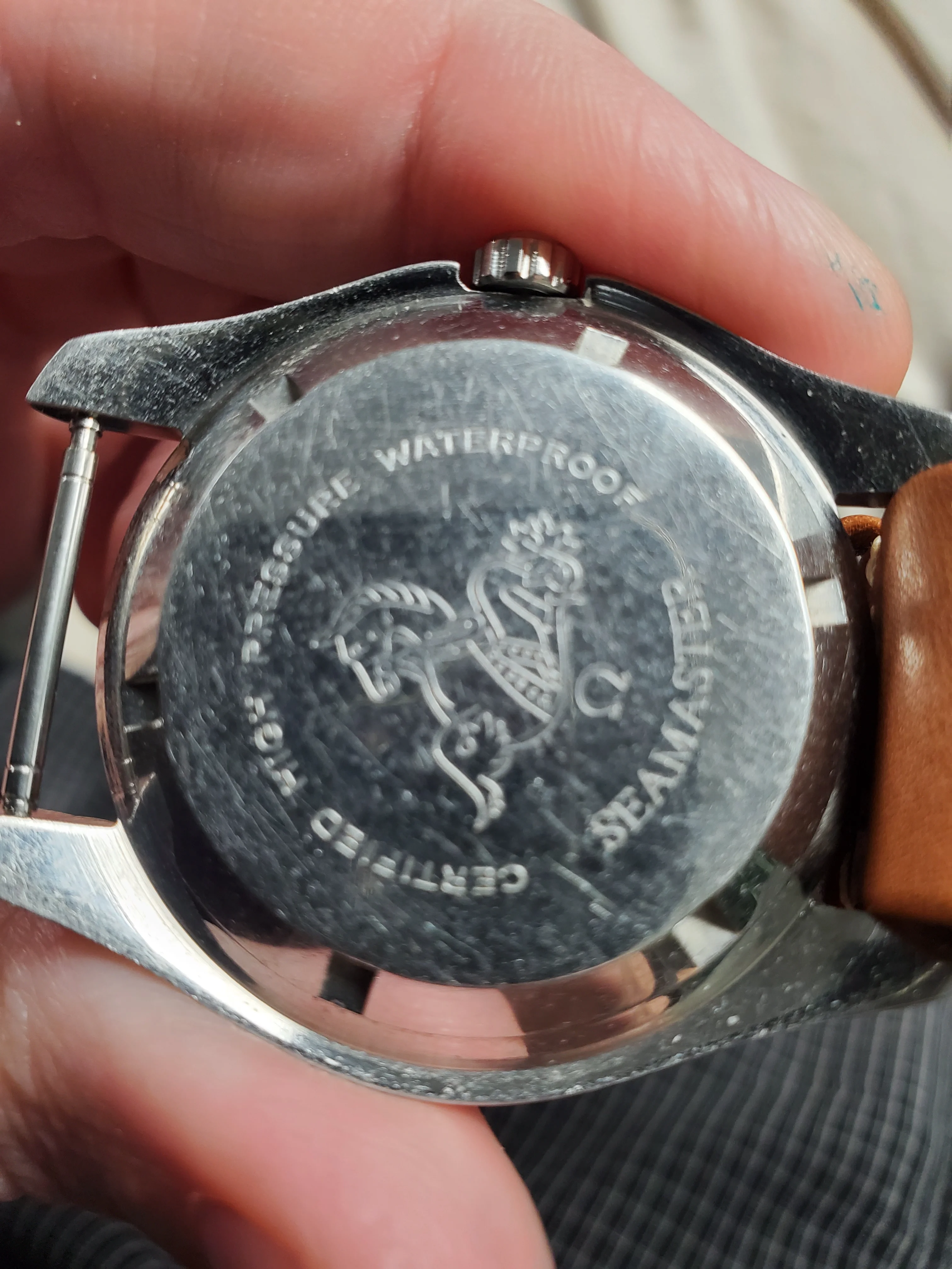

Here is caseback.
I'll need to know some more about why it's fake so I can return.
3,012
4,780
Sadly these fakes are common. There was a thread about them just last week. One can purchase 'kits' which have aftermarket counterfeit cases and dials. The movements are usually pulls from plated cased watches, so the movements can be real, but this is basically a pig in lipstick.
The aged color of the lume on this is also a giveaway. The coloring is too even and a bit dark. It takes looking at 100s of examples to see what is wrong. Many here have done just that.

It’s a genuine vintage omega movement, with a fake dial, fake case, fake bezel, fake everything except the movement
