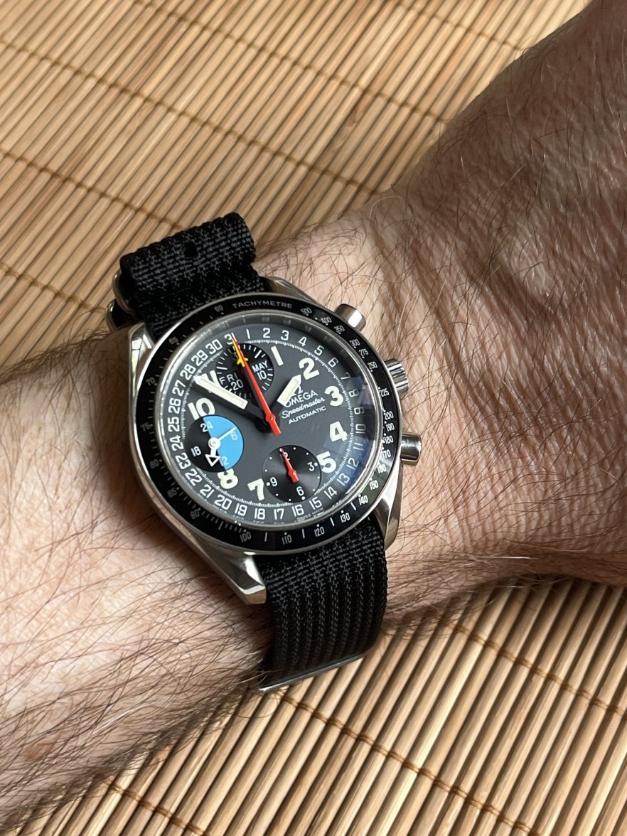

    After months of research I finally found my MK40 last week. I was lucky to find one in almost NOS condition:
    Reference numbers
    There are two reference numbers: 3520.53.00 and 3820.53.26. The first reference is for the model with steel bracelet, the second one is used for the version with leather strap.
    Please refer to the schema of Omega PIC Numbers (https://www.bobswatches.com/rolex-blog/resources/guide-omega-pic-numbers-explained.html)
    Dial configuration
    I have checked dozens of offers that brings me to this conclusion:
    As stated above it seems that there are two dials that differ in some details
    - MK I: Use of Tritium (and therefore we see a nice yellowish patina nowadays), fat minute markers every 5 minutes
    - MK II: Use of Luminova, fat and long minute markers every minute
    I have seen the MK I dials until serial number 558xxxxx. The earliest MK II dials I have seen start with serial number 560xxxxx. Using various sites for Omega serial numbers the 560xxxxx dates back to 1998. So, I guess that there was an update of the dial around 1997/1998. This again matches the facts from above.
    PS: Personally, I love the vinate look of the tritium indices. However, the newer minute markers have a better readability (by far!)
