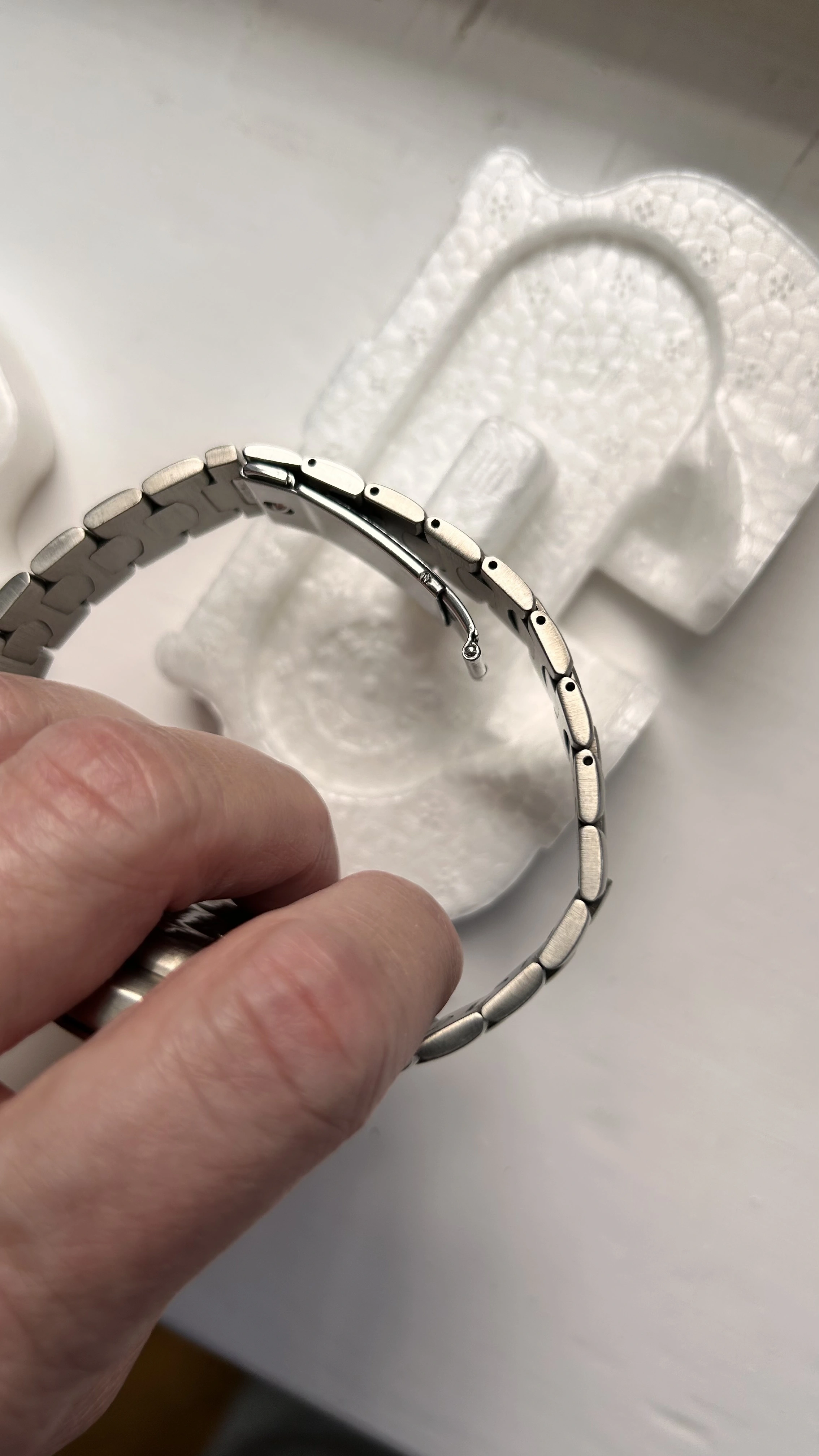

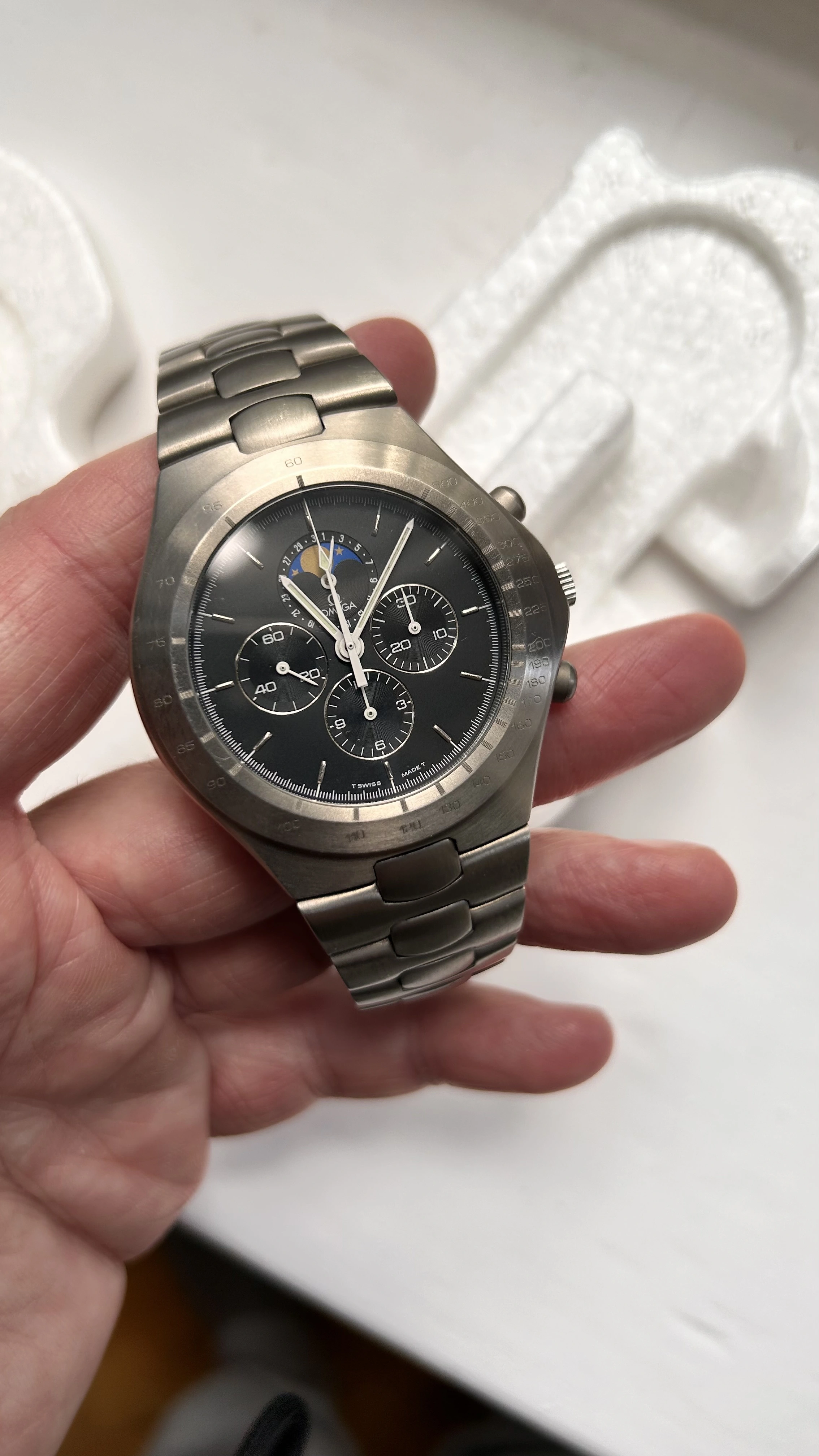

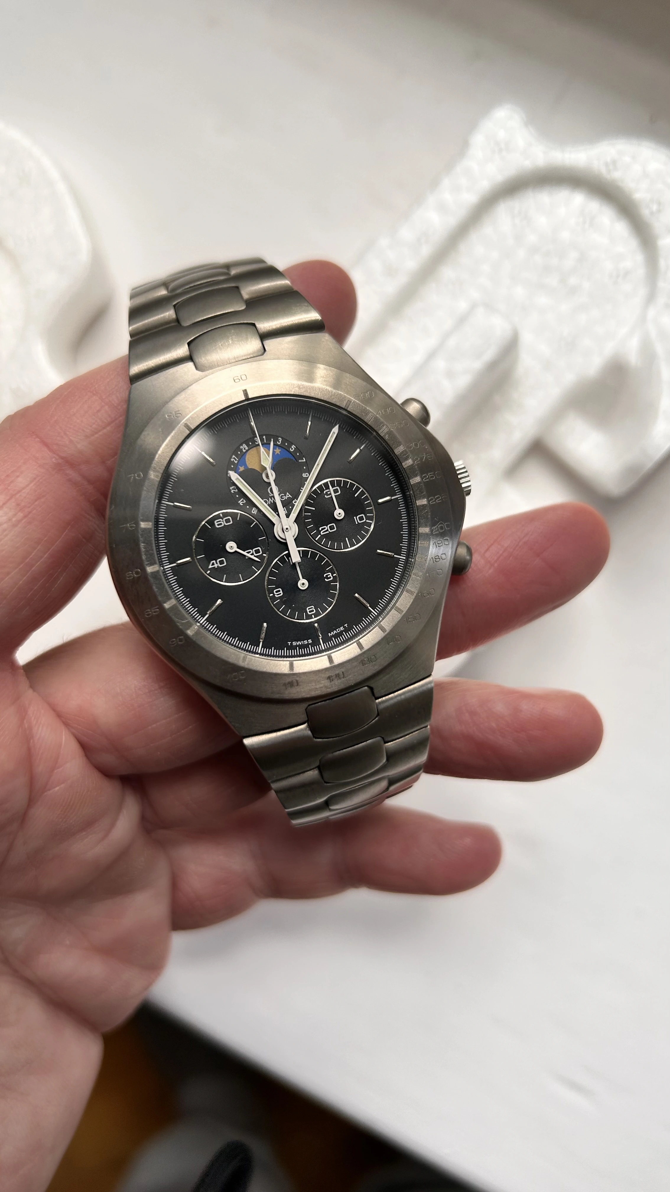

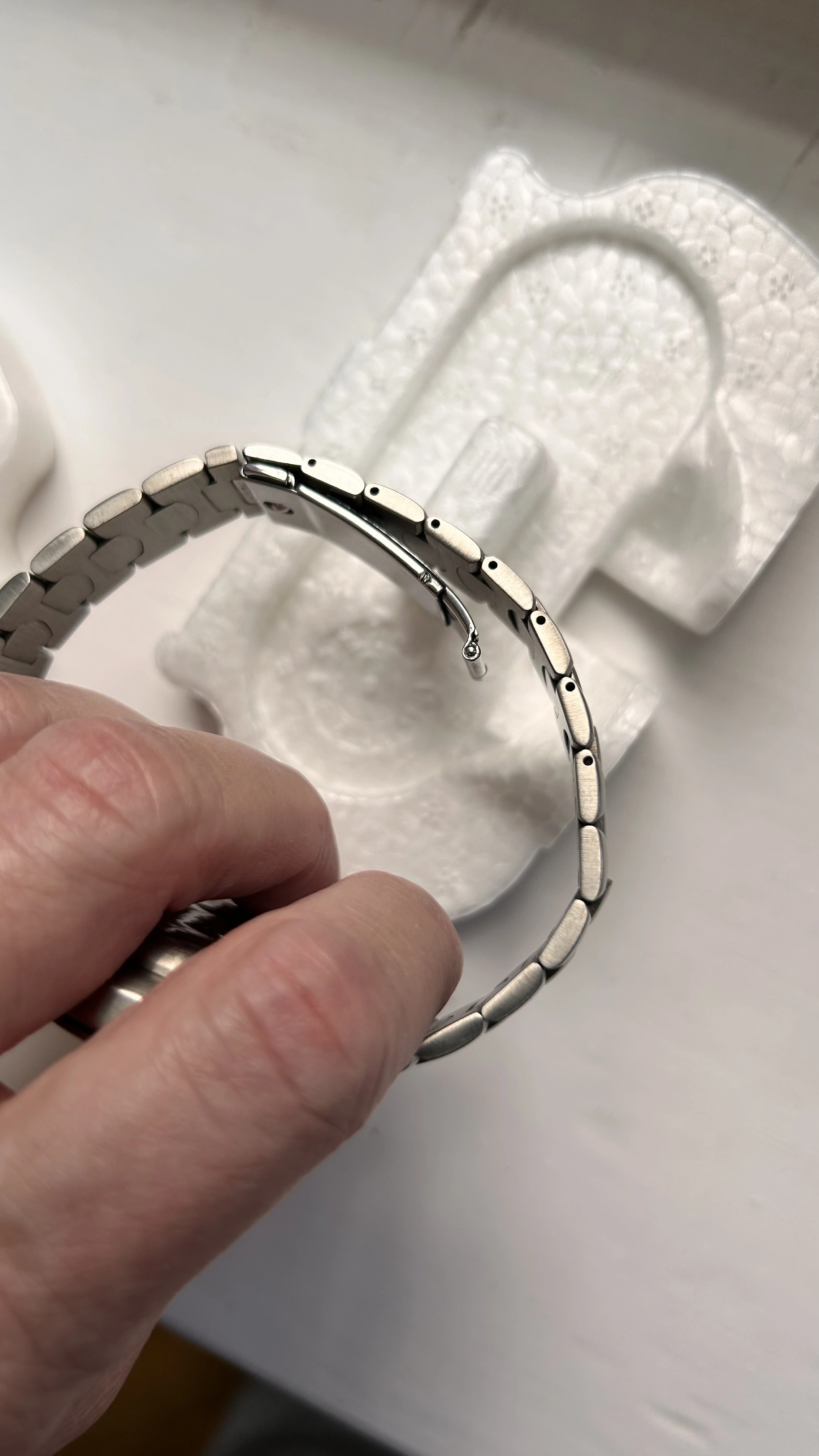

Hello Forum,
I recently purchased an Omega Teutonic chronograph with a moonphase, and I think it’s an absolutely stunning watch. I’m hoping someone here might be able to help me with sizing the bracelet. Ideally, I’d appreciate a step-by-step guide.
It looks like there are spring bars in the links near the clasp that need to be pressed down to release the links—but I’m hesitant to proceed without proper guidance, as I don’t want to risk bending or damaging anything.
Thanks in advance!

Some Omega bracelets do have center links that are secured with small spring-bars; however, I have no experience with this particular bracelet.

Are there 'arrows' on the links that are adjustable? If so, then it is a 'split pin', you drive out the pin in the direction of the arrow. If there are no arrows it is possibly a 'pin and collar' arrangement where you drive out the pin (either way), there is a collar in the center part of the link that holds the pin in by friction. Reassembly is just the opposite, drive the pin into the collar, just make sure you don't lose the collar as it is easy to overlook once the pin is driven out. They are a bit fiddly to adjust but very secure once installed. If you aren't comfortable trying it yourself, or in case Omega has used some other method on the bracelet, take it to someone who is familiar with this type of bracelet.
The Teutonics are an interesting iteration of the Speedmaster, your's looks like it is in very good condition.

Most likely a pin and collar setup, but it could have internal springbars.
What's the bracelet number?
No worries 😀 on this particular bracelet, the holes are only drilled from one side. There are definitely spring bars inside the links (you can actually press them down). In theory I understand how this mechanism works - but I don‘t want to risk bending the spring bars since they will only detach from one side…
Thank you! Yes, I‘m very happy with the condition of the watch. Also, the romantic moonphase and date complication paired with the modernist case is really special, imo. There are no arrows on the bracelet - also, the holes are only drilled in from one side. Bu yeah, I might just bring it to an Omega-store and let them have a go…
It‘s a 1410/401

Typically, the center link(s) is held in place with a springbar that goes into holes on both sides. Usually, one pushes the ends in from both sides, and rotates the center link(s) out. I don't know why there would be holes on only one side if there are springbars inside. Holes on one side would be typical for screws, IME.
If the OP is certain that they are springbars, I would probably push in the end of the springbar and see if it releases the center link.
Agreed - but if i push down on whatever is in these holes, it feels like i am compressing a springbar… it does loosen up the center link but i just don‘t understand how i can then get the center link out. it‘s halfway attached to what i think is a springbar from one side and there‘s the pin i use to push it down from the other… 🤷🏻‍♂️

The center link would need to pivot out enough so you can access the springbar and remove it.
Yeah, I think so too. I guess i‘ll have to cover everything in scotchtape and pray for not bending the springbar 😅

So, here's a little update: It's easier than it seems and pivoting is the key. Thanks for all your replies!!!

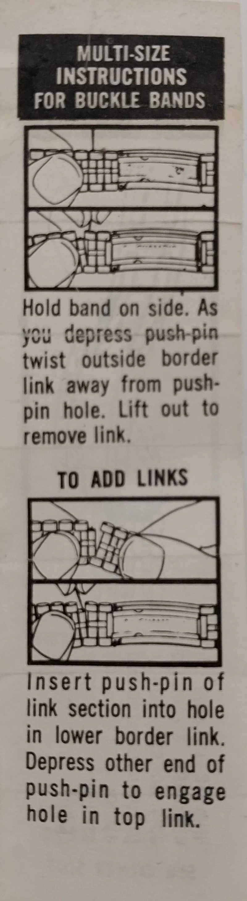

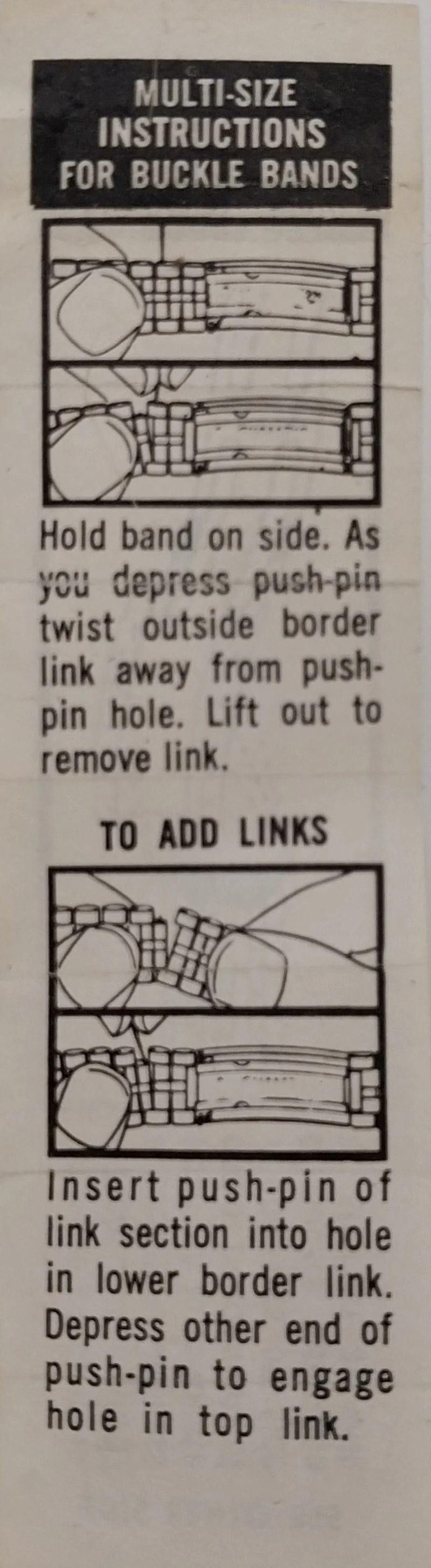

Might not be of much help, but maybe a little?
Wow! That is exactly how 😀 Nice find, thank you! So if anyone wants to know how to size the Teutonic moonphase bracelet - this is it 😀
