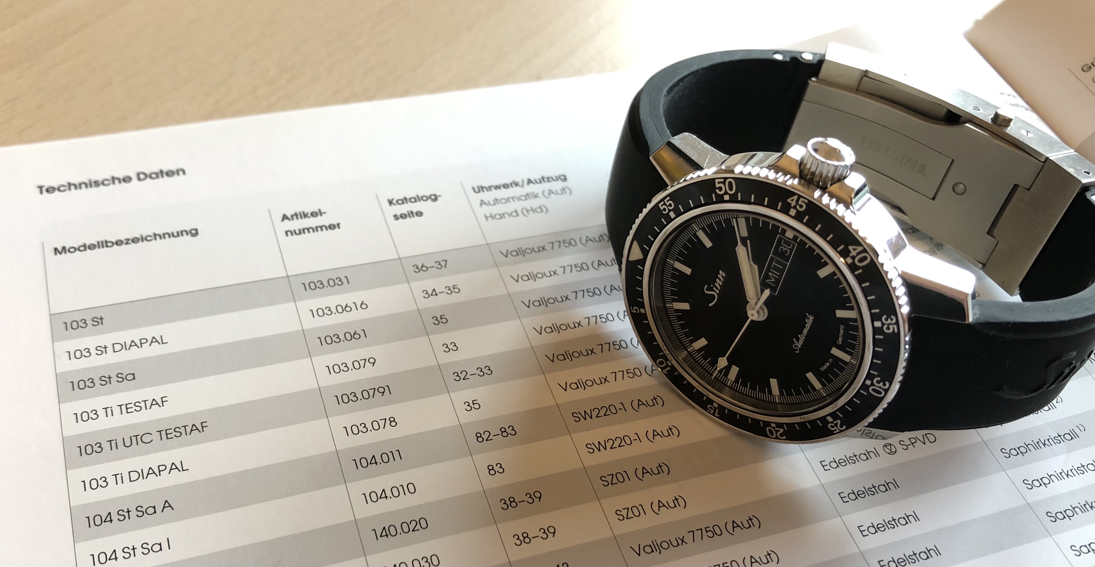

Indeed - this is my PAM 104...
::facepalm1::
18,317
27,673
::facepalm1::
How is that a 7750? where is the chono? Totally in house!

Just had a look at my Sinn 104 St Sa purchased circa 2015. Rotor swings freely in both directions when fully unwound and a little less smooth when fully wound (hasn’t been worn for about a year I guess).
The movement is a Sellita SW/220-1
Yours definitely needs servicing.
