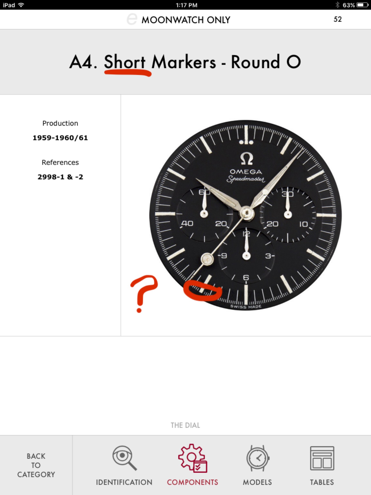

Ok I have read speedmaster101's guide and consulted moonwatch only..
Just for clarification
1/ A "short marker" dial, is a dial where the markers don't go precisely to the edge of the step? Y or N
2/ A "tall marker" dial has minute markers that stop exactly on the stepped edge. Y/N
3/ "Short marker" dials are all service dials on any watch prior to "Professional" appearing on the dial...(except for a CK 2998) Y/N?
4/ It's impossible for a pre professional speedmaster to have a short maker dial unless it has had a replacement dial (unless it's a CK 2998). Y or N
Sorry but the speedmaster101 and moonwatch only guides aren't clear on this
Cheers
328
127
(I'm referring to the 105.002 and the 105.003)..as clearly a CK 2998 can have an "original" A4 short marker dial....

Sure makes sense... so what is exactly the difference between an original "tall marker" and "short marker" dial? Are we talking markers on the main minute track here or the 30min subdial? Sorry for the newbie question but nobody (either reference) has said which "dial" (main or subdial) they are referring too... or actually specified the difference

The lumed hour markers on the main dial.
Ah ok sorry for confusion...now I know why I didn't seem to get this.. der... (the moonwatch only book picture of an "A4 Short Marker - Round O") actually has tall hr (lumed) markers... 🙄
