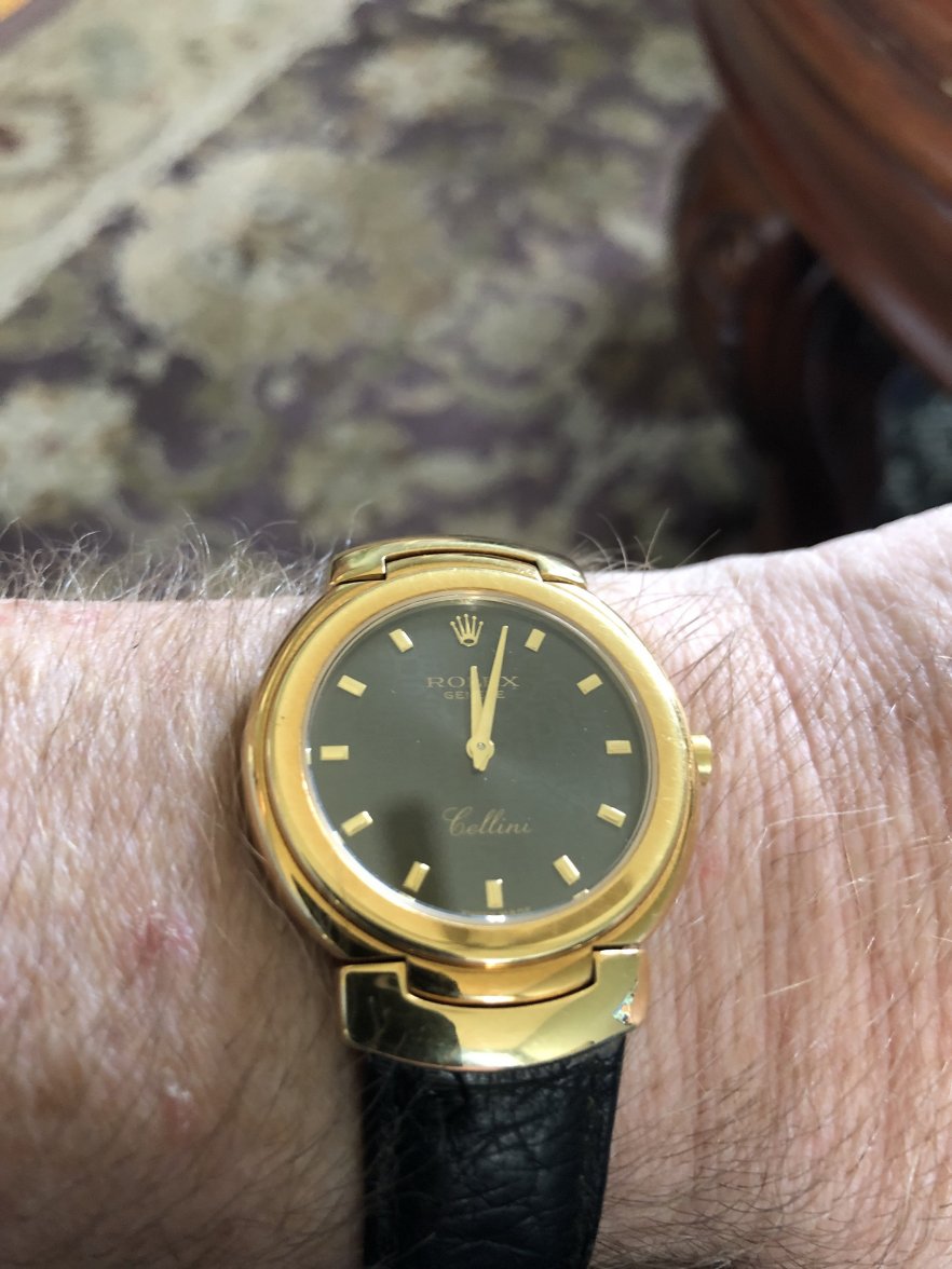

    hey, a number of times I’ve gone on about my Cellini. I get all my automatics serviced, even Rados I’ve picked up for 50 bucks. I’ve spent more servicing them then I did on the watch. My question is what can I do with this Cellini as far as servicing goes. I’d hate to have it stop and be worth only it’s weight in gold which I wouldn’t imagine being that much anyway. I actually did have it serviced once but I never thought to ask exactly what the hec they do to a quartz watch. I know many watch makers are here or at least people who have more expensive quartz and I’d like to know what you do. I actually wore my Cellini today as I was on a job interview as my life is in a tailspin and I’m trying to figure out what to do next. I shall now include my obligatory blurry picture of my famed Cellini. Thanks for any info.

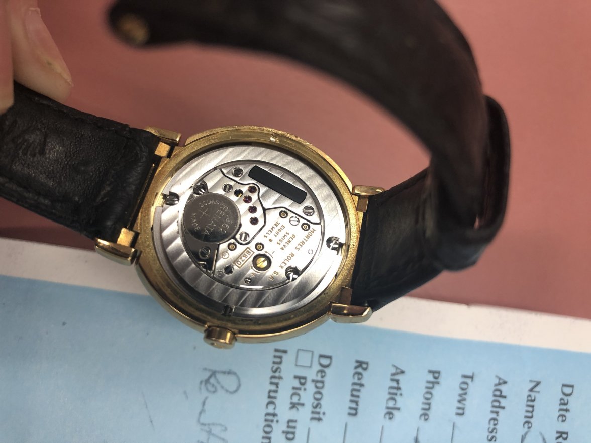

  9. Walrus Jul 12, 2019
    8,916
    41,908
    Thanks, yes as soon as it stops I get the battery replaced. Never left it not running for more than a day or two. What I do wonder is if it would be a good idea to leave the battery out if I go for long periods without wearing it. Here are some pics of the movement maybe they can tell you something as I have no clue. I have no idea if it is a sturdy movement but I’m just a watch fan not a technician. Thanks for any info at all. 30C83580-306F-4933-B67C-A98FBEDCA663.jpeg CB2520AF-7108-48F3-B570-C1DEEBD72646.jpeg 6142BFF1-D65D-45AB-BF42-7F411A0BDC84.jpeg 9F1645B0-E894-423E-84E4-FB2EA3388B2E.jpeg

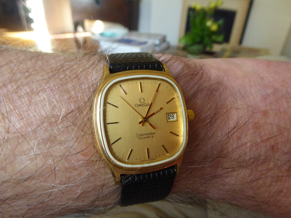

  17. MRC Jul 12, 2019
    3,257
    8,171
    Agreed. I bought this new in 1982, and paid more than its market value to have it serviced by Omega.
    Edited Jul 12, 2019
    Deville94, Caesar95 and Walrus like this.
