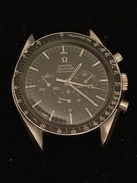

    I’ve just got bought my first vintage Omega, a Speedmaster pre-moon/transitional 1968, 145.022 with DON bezel. He is going in for a service soon and need some expert advice:

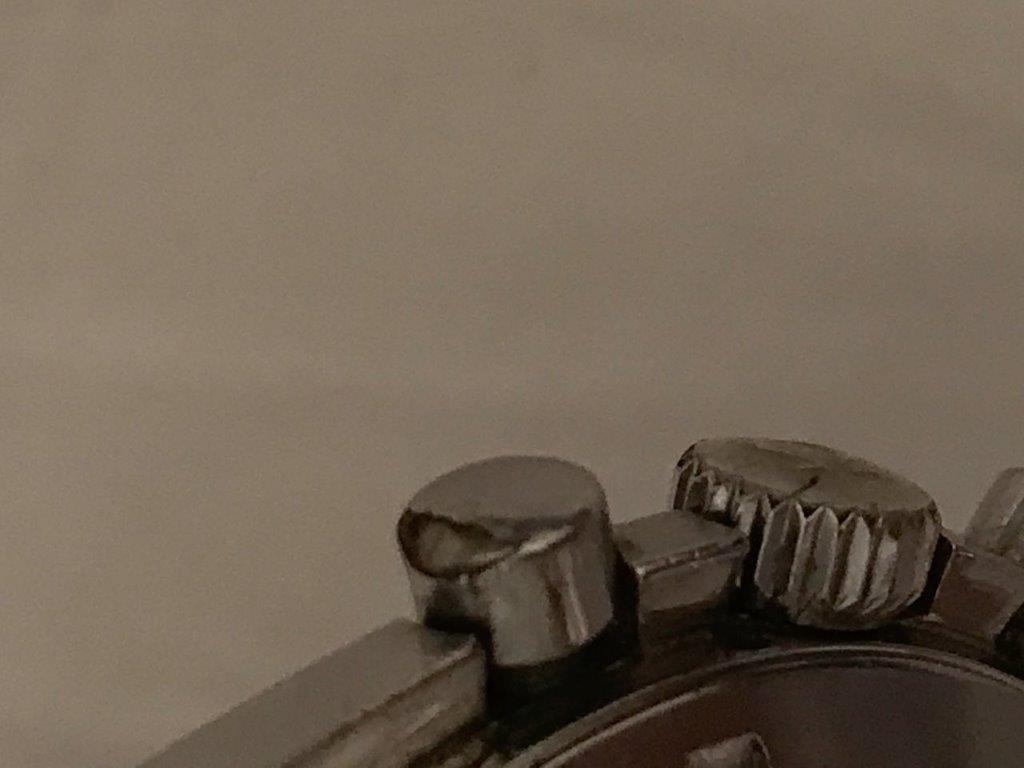

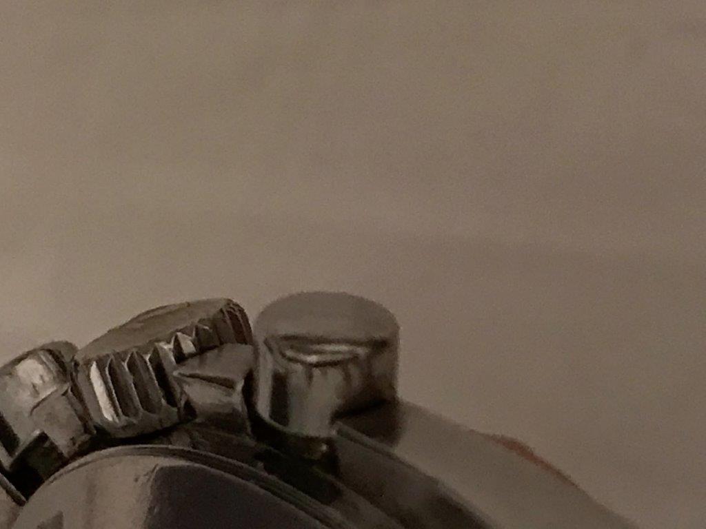

    1. Both my chrono pushers have lost a chip and reset pusher is stuck and currently not working. I have got my hands on 2 x 086ST-0059 (NOS) pushers and should I change them or let my watchmaker try to fix the original pushers? Will it devalue the watch with NOS pushers? See attached pictures. What do you guys think?

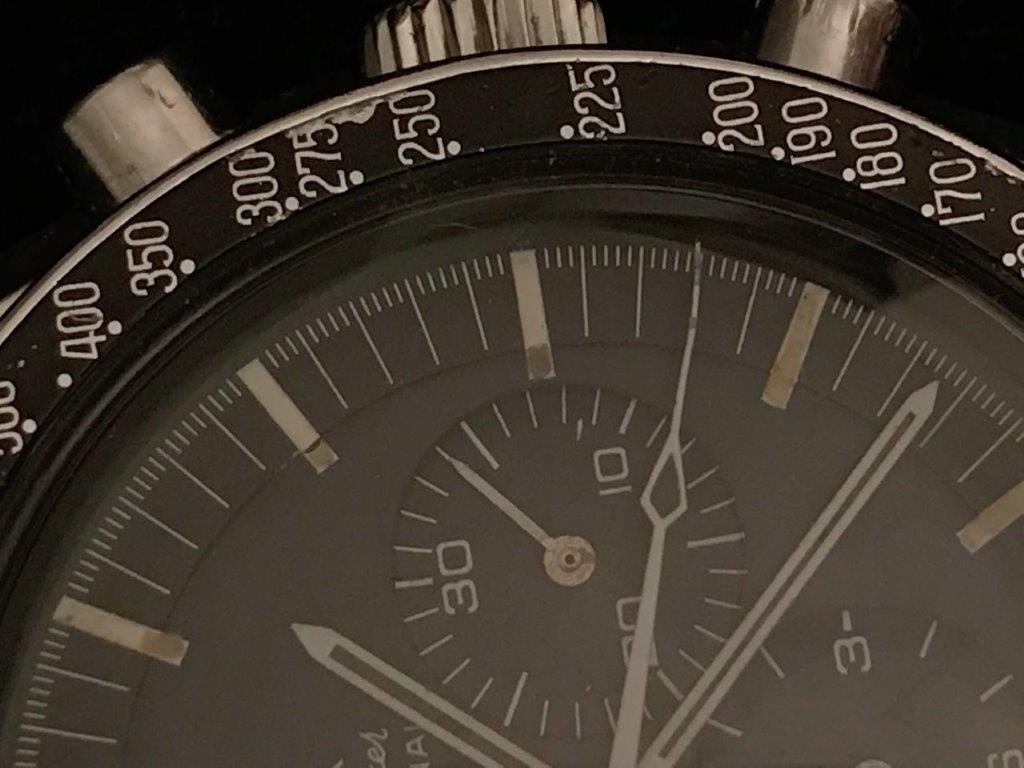

    2. The second hand is not entirely straight. The last/upper part is bending a bit to the left. Is this an easy fix for a proper watchmaker? Warm it up and gently try to align it straight? Anyone familiar with this? I do not want to replace the hands or re-lume as I intend to keep the watch as original as possible.

    Attached pictures of the watch, box, pushers and a close-up of the second hand.

  2. boogedyboo Sep 25, 2018
    429
    908
    Congrats on the transitional Speedmaster, these are pretty rare.
    1) The pushers look pretty far gone to be repaired, looks like there is missing metal material.
    2) Chrono hand looks like it can be aligned straight

  4. Archer Omega Qualified Watchmaker Sep 25, 2018
    26,463
    65,604
    The hand is an easy fix - no heating required, just someone who knows how to bend hands properly. Common thing for any watchmaker...

  5. kingsrider Thank you Sir! May I have another? Sep 25, 2018
    2,689
    5,431
    How do hands get bent typically?. We often see minute hands with a bend too. Poor service?.
    Oh and, get those pushers serviced.

  6. Archer Omega Qualified Watchmaker Sep 25, 2018
    26,463
    65,604
    Hard to say - sometimes they get out of level due to a drop of the watch, then they catch on another hand and get bent.
    On this example the date window frame came loose, and it ended up wrapping the seconds hand around...
    [​IMG]
    I would imagine that sometimes careless handling during a service could be the cause, but if the watchmaker is paying attention at all they would straighten something like a chronograph hand to enable it to be lined up properly on installation, so the OP's example is one where the only thing I could think of is that there was some hand interference and the tip of the chronograph seconds recording hand was bent when the time was move backwards...maybe...

  7. WatchAndy Sep 25, 2018
    4
    Thanks for all replies guys, much appreciated :) Pushers will be changed and hopefully my watchmaker will straighten the second hand. Will post some new pics after service.
