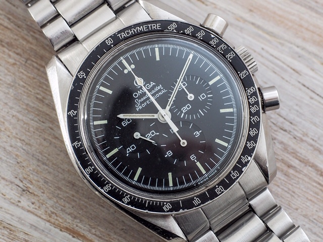

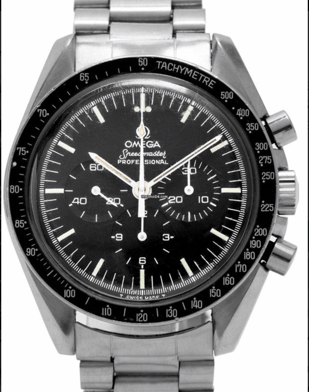

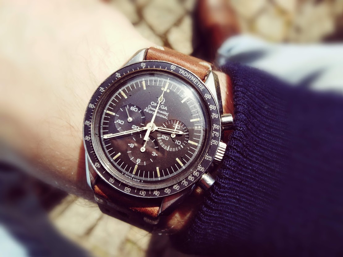

your opinion on this 3 differents watches?

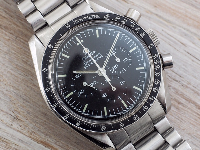

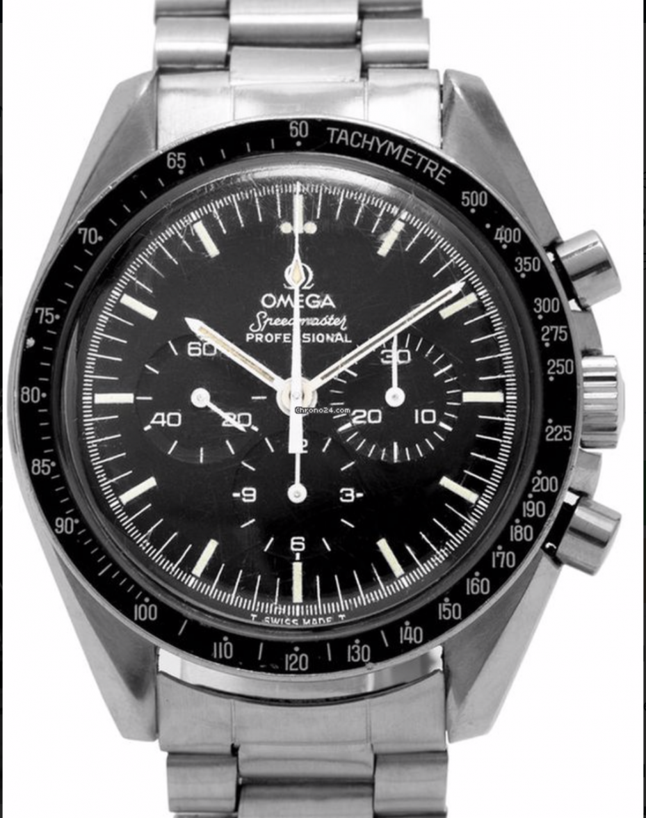

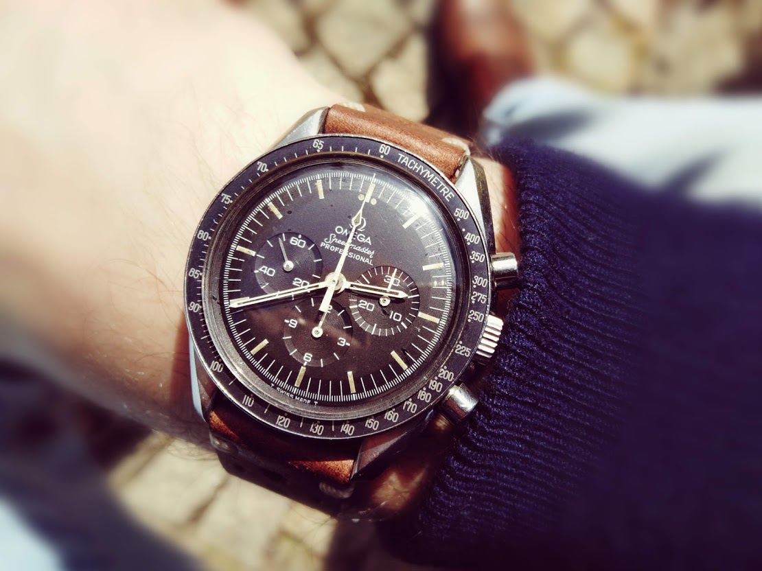

all three of those are post mid 1977 production
look at this picture and the relation of the "S" to the "P" in "Speedmaster"
http://speedmaster101.com/wp-content/uploads/2016/04/P4290005.jpg
The 2 on the left are 74-mid 77 production and the "S" does not drop to the bottom of the "p" The 2 on the right from mid 77 to mid 80's dials and the S drops to the bottom of the p. Note this test would only excluded early -76 models that have not been serviced, any watch that was serviced from 77 to mid 80's would have the second dial, so a serial number is still preferred..
What are your thoughts? From those pictures its hard to make an evaluation or exactly date the watches. Different lighting, and in at least 1 case heavily filtered in instagram

what do you think this ad: https://www.chrono24.fr/omega/speed...gut-gehaeuse-stahl-band-stahl--id12362632.htm
The dial seems to match, the bezel in an exceptional state for its age. But the bracelet was never delivered at that time, right? Is the dial too impeccable to be original? is it a copy in your opinion?
No price difference.
The -74 and -76 earlier version look better to me as well. It’s the same font as on most of the 321 speedmasters.
Looks like an original dial to me. But the picture has been color adjusted. They are asking top dollar( mint) for a piece without showing the caseback or movement. I’d also want natural light pictures to really see the lume.

What about the bracelet? Models from this era were delivered with? or has the 1171 been replaced?
Watches where not delivered on bracelet but added at the dealer.
