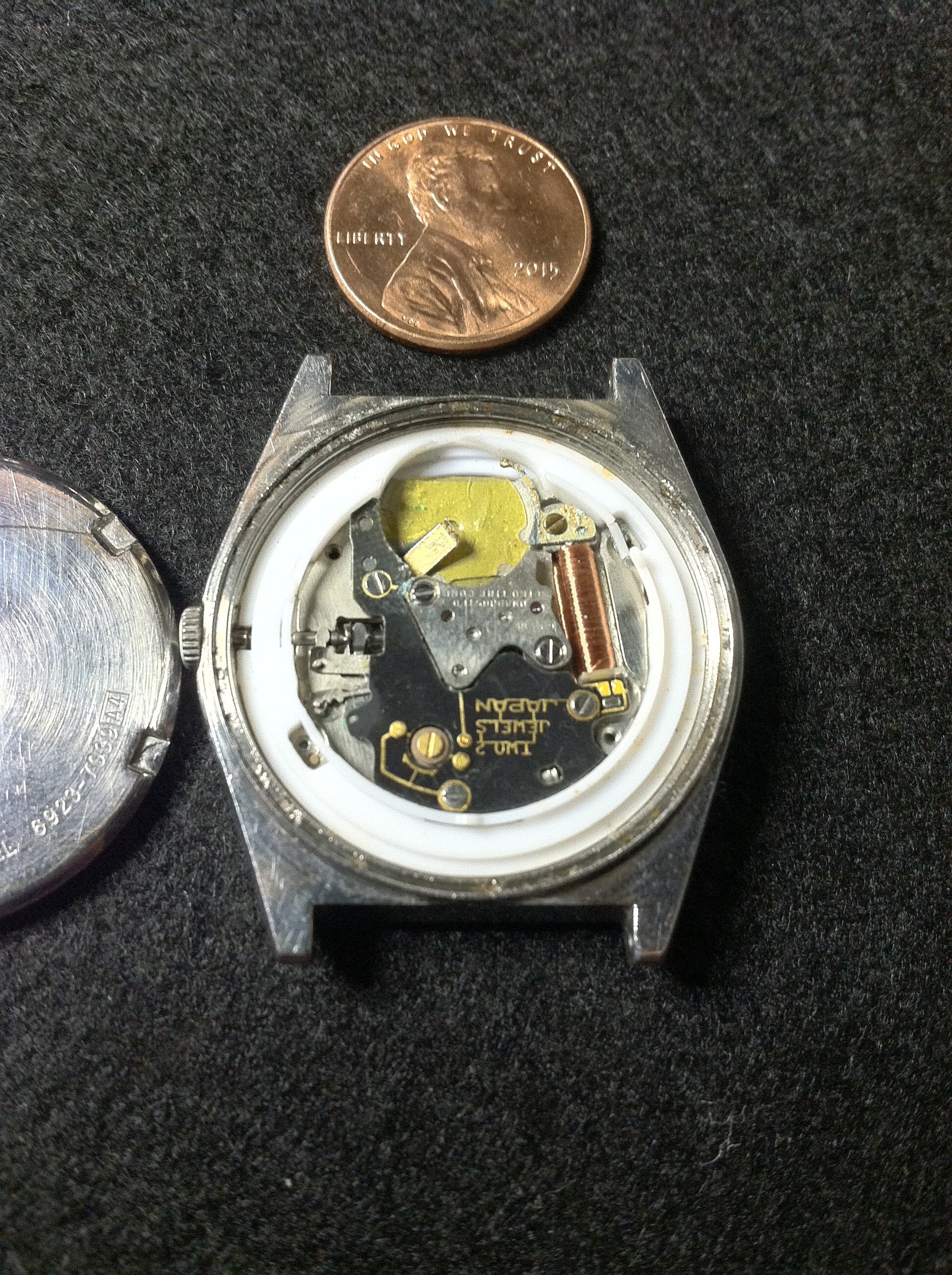

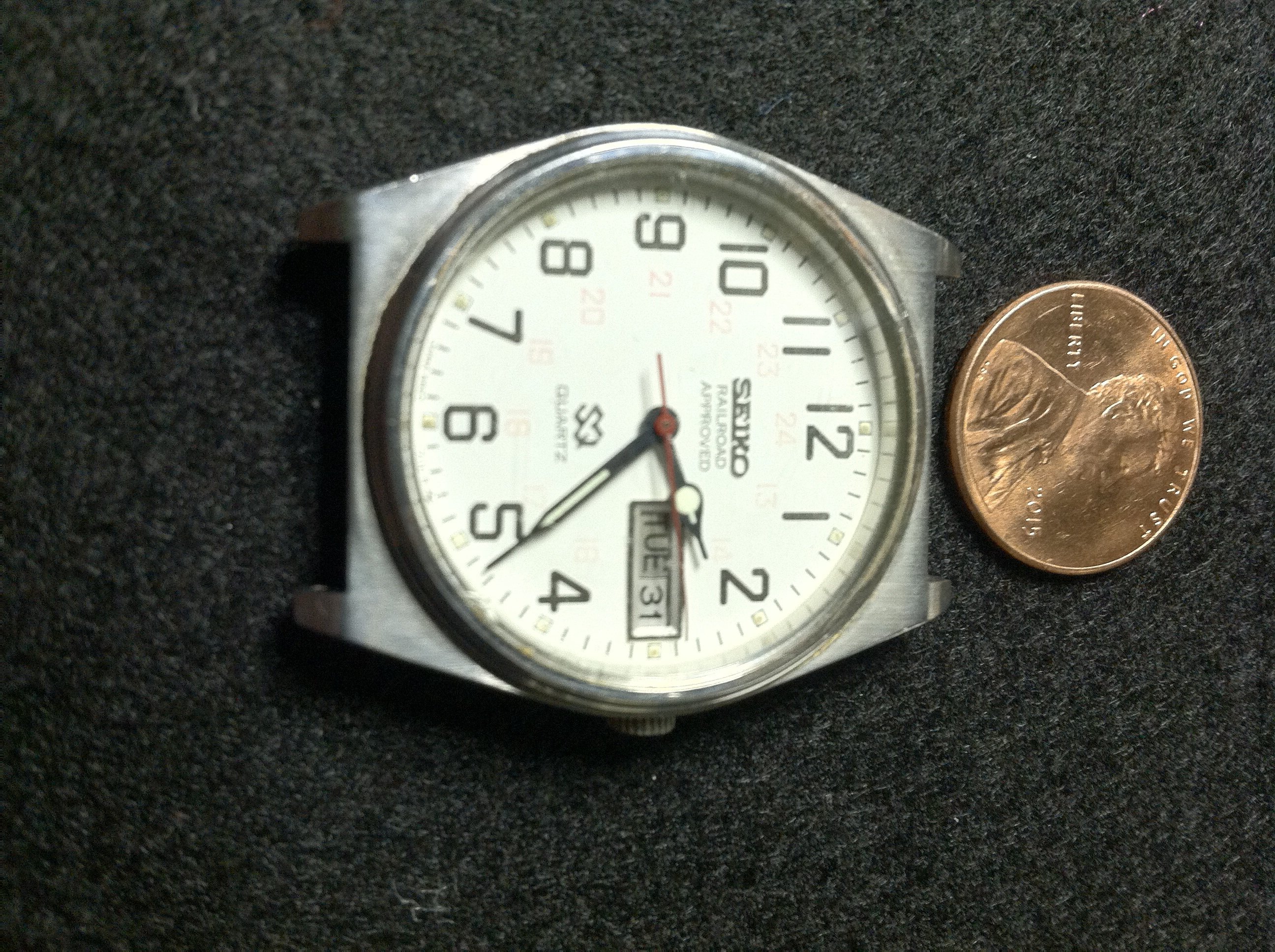

    Anyone know what size battery this seiko takes? I can't find anything online and I don't want to send it out for a repairman to charge me if I can do it myself ..the numbers on the case back read 6923-7039-A4

    Measure the diameter of the battery enclosure in mm and then see if you can get the depth. Then use the charts that @STANDY pointed you to to find suitable batteries.
    At a guess, an SR926SW.
    BUT!

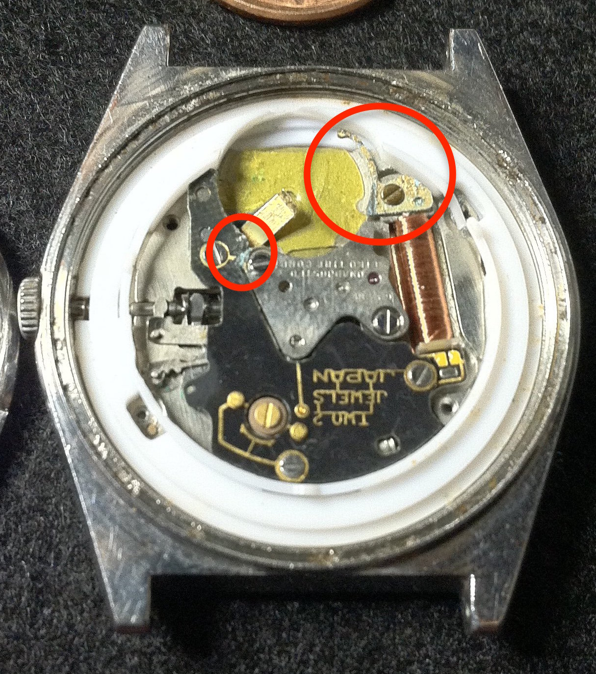

    Before you put a new battery in that watch, you need to address the corrosion issue, obvious result of a battery that has leaked in the past.

    SR926SW didn't fit right was little too thick; where do you see corrosion though?

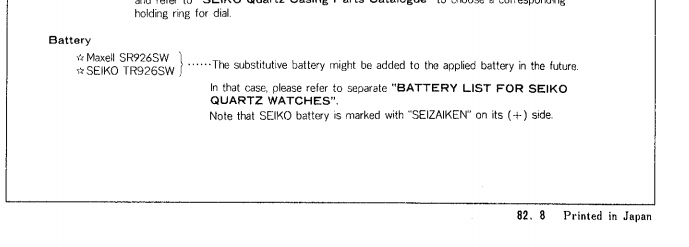

    SR926SW is correct, from the caliber parts list:
    If you can't get an SR926SW in then try an SR927SW (9.5mm x 2.73mm), if that's too thick, go down to an SR920SW (9.5mm x 2.05mm).
    Corrosion is here
