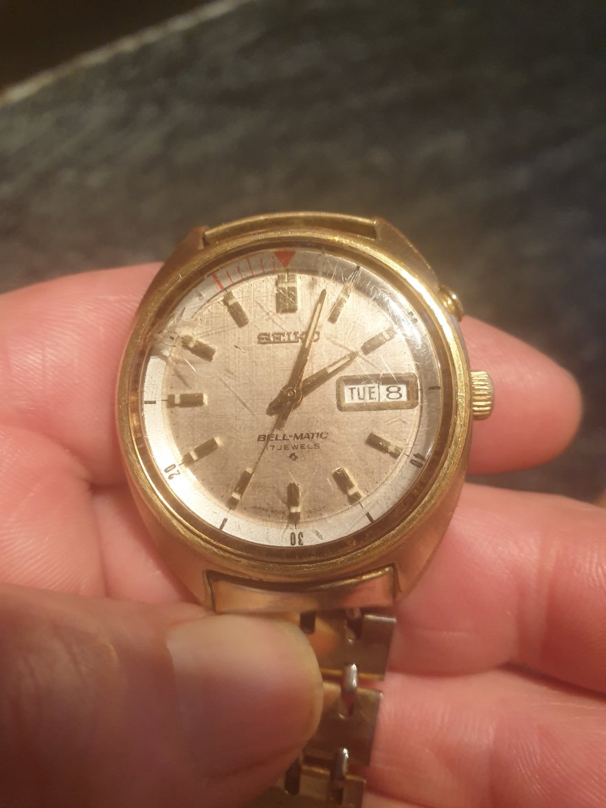

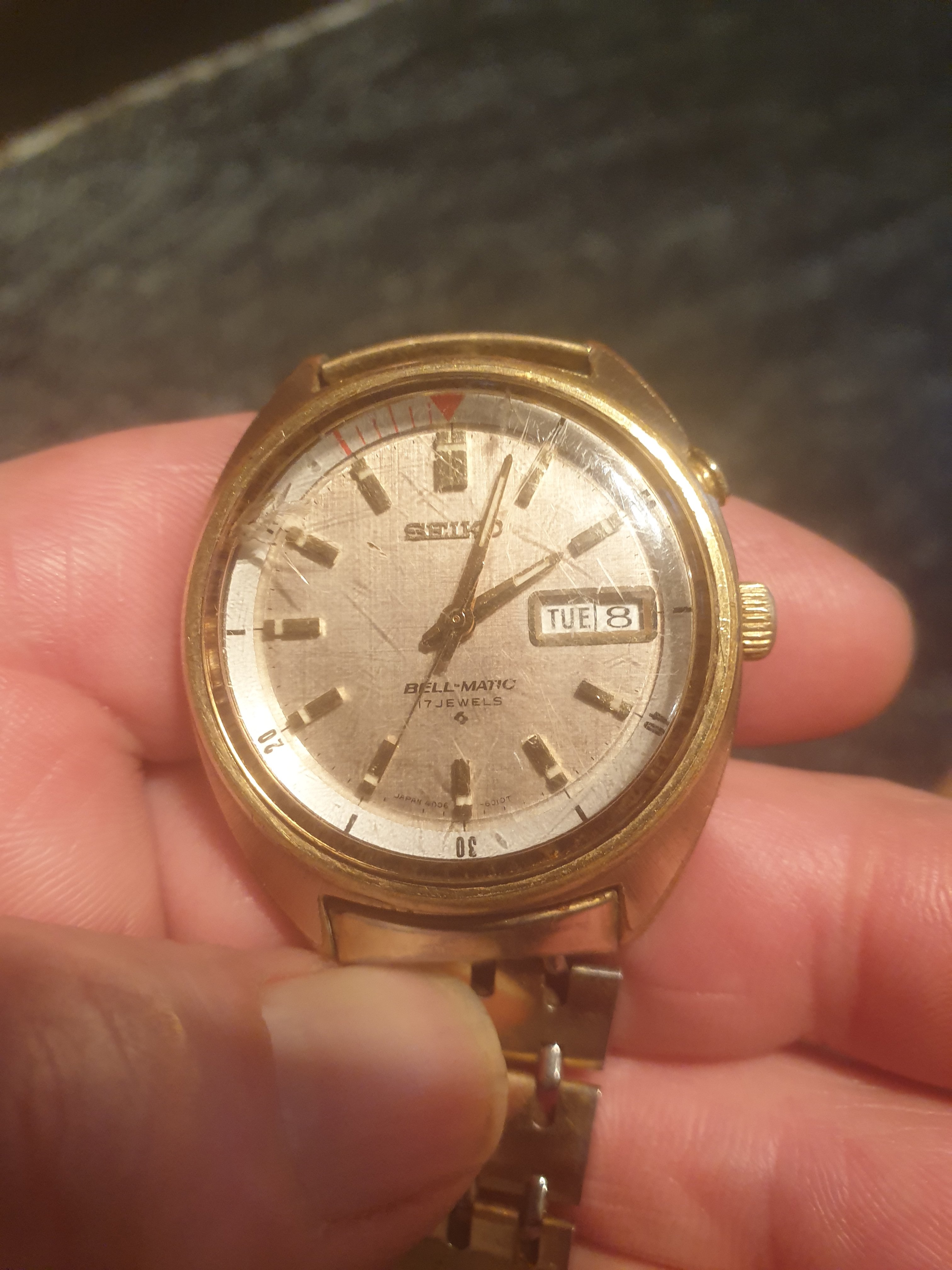

Hi , just looking for a little help on finding a crystal replacement for the above. There is one for sale for a 4006-6010 on e bay and wondering if one of the experts here could tell me if this one would suit. Its 32.6 mm . Thanks.
15
14
4006-6010 and 4006-6011 are the same case, the last digit refers to the geographical area it was distributed to. So the crystal you found should fit your watch.
http://cgi.julesborel.com/cgi-bin/matcgi2?ref=SEK_CS^4006-6010
The original crystal is a 325T02ANS0 or 325T02ANG0 depending whether you have a steel or gold plated case.
Post some before and after photos 馃榾
15
14

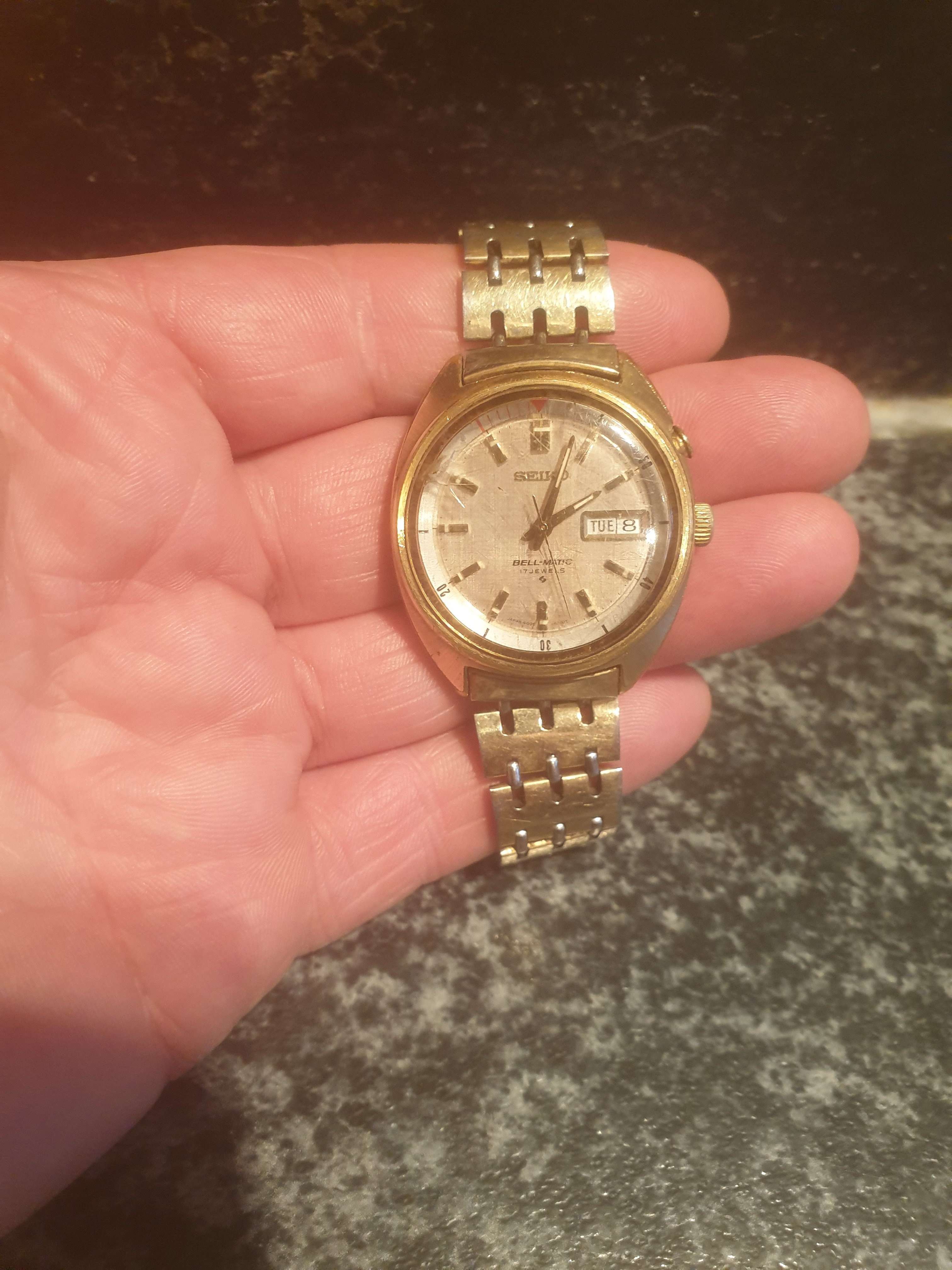

Nice watch, will look great with a new crystal!
Make sure you get 325T02ANG0, with the gold colored tension ring to match your case (or an equivalent reproduction crystal, although the original seems to be available and inexpensive).

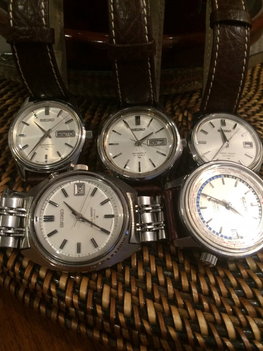

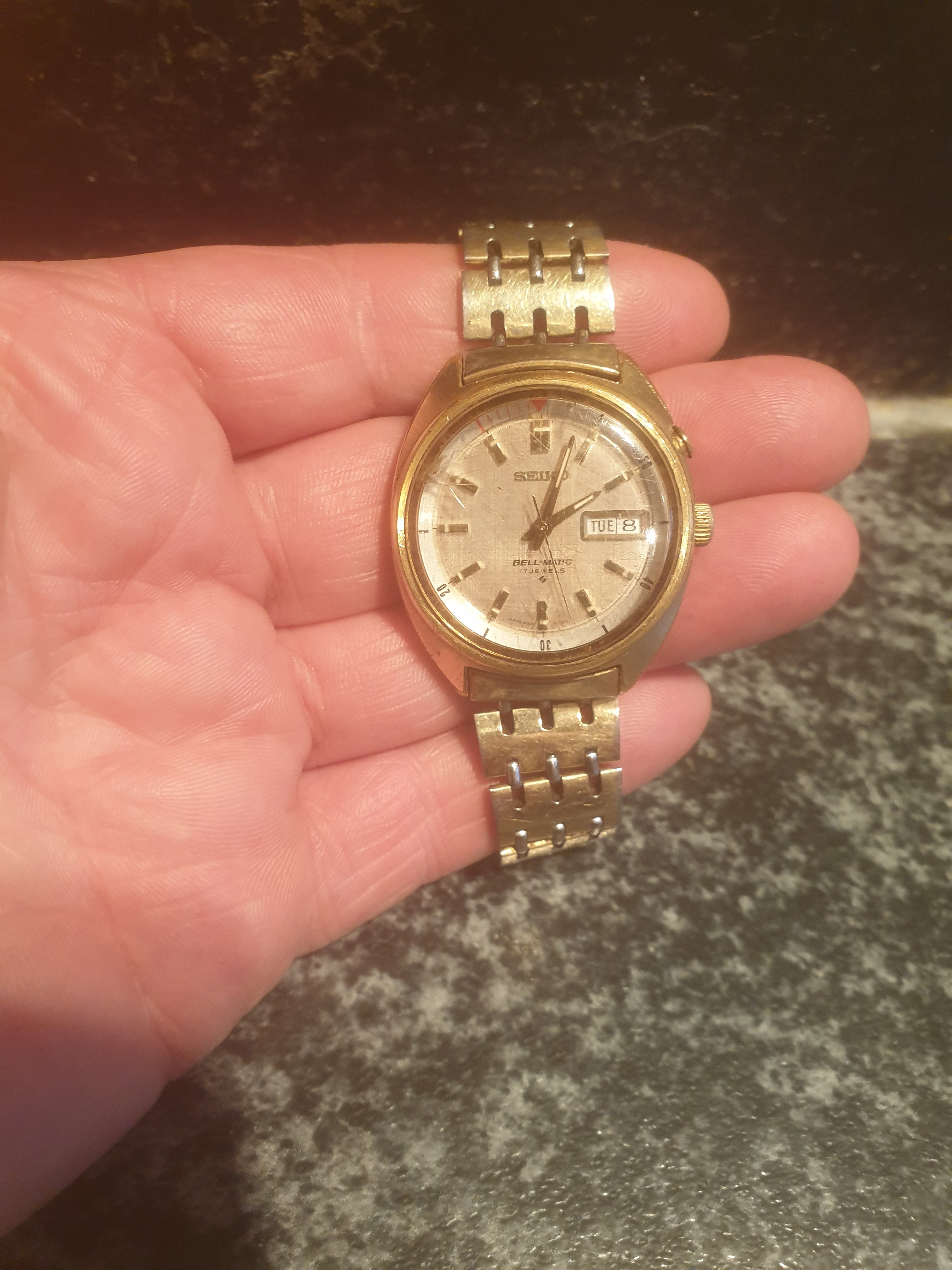

Aaaah-Bellmatic. Have one of these almost in met condition with the original bracelet together with the "White Dial" brothers in arms.

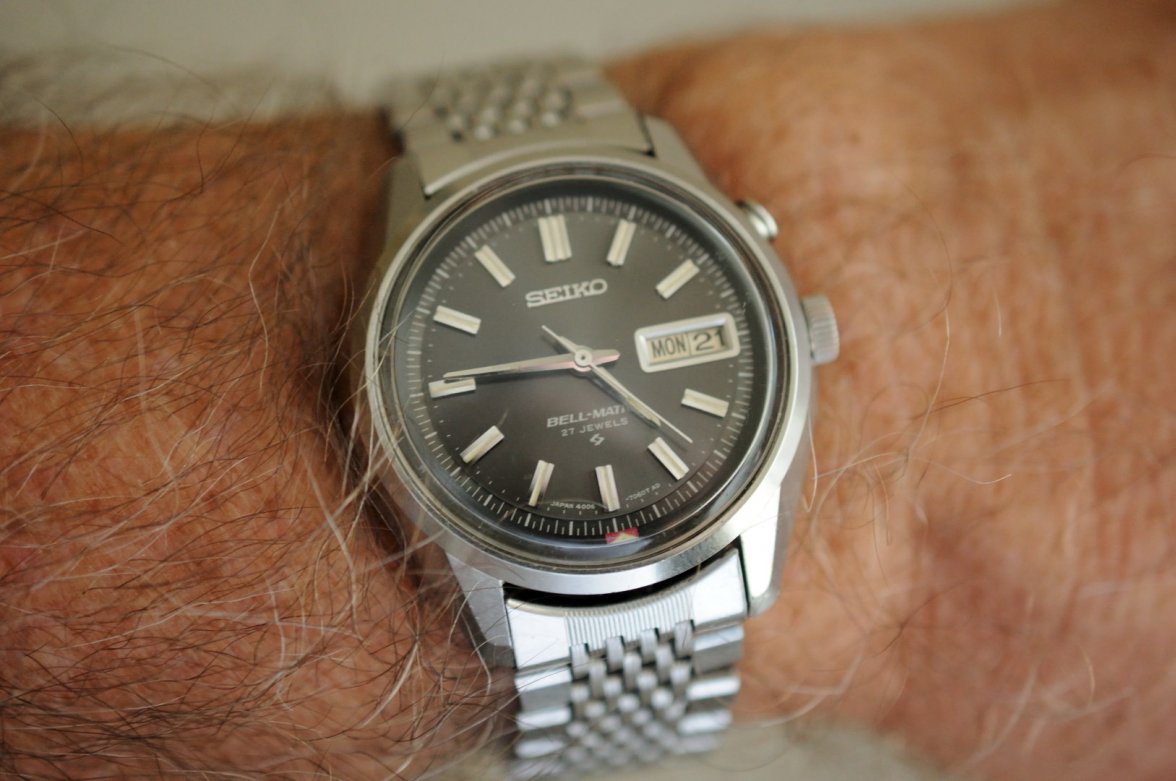

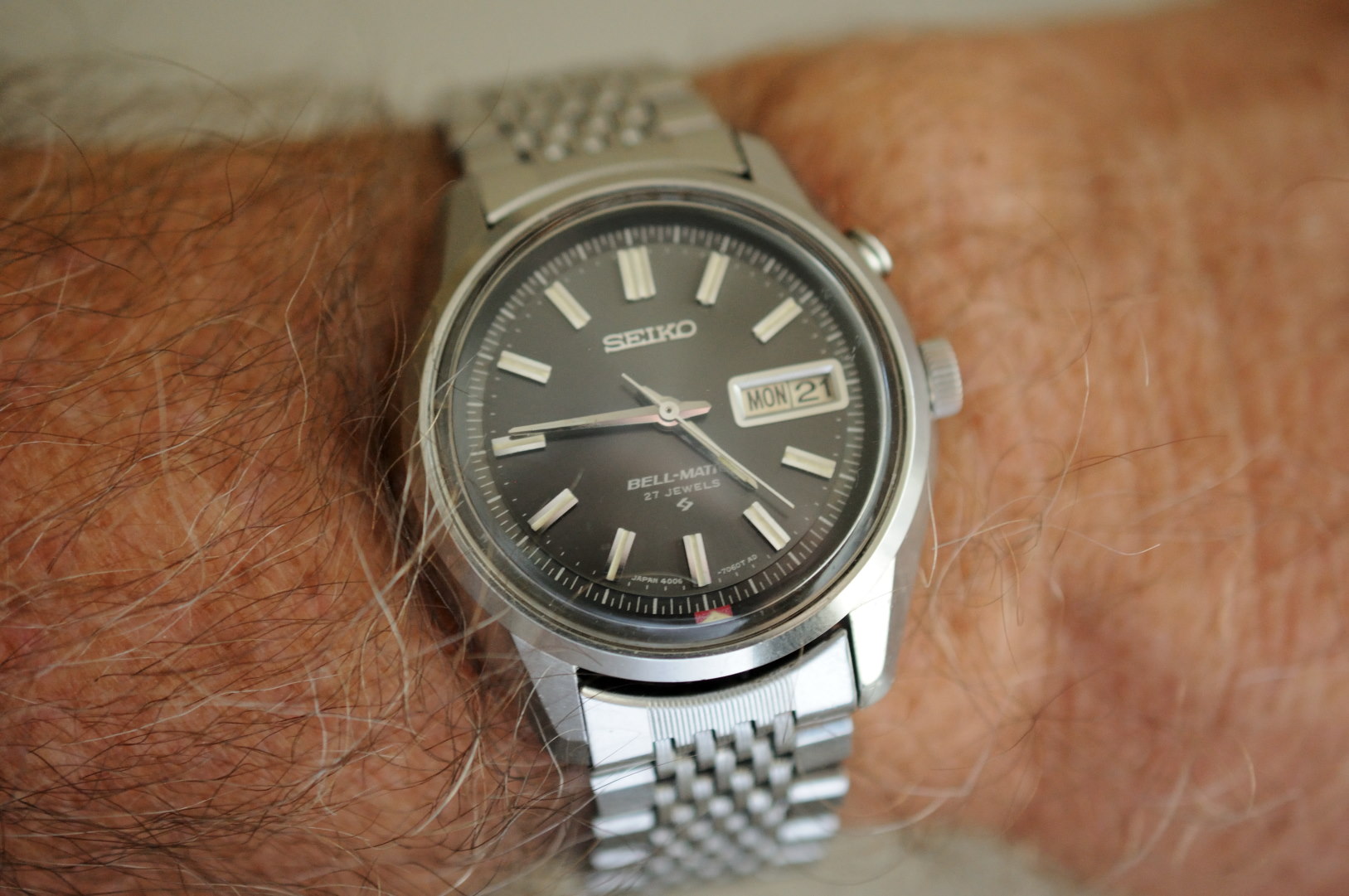

I have one with an original bracelet and a dark gray dial:
4006-7010

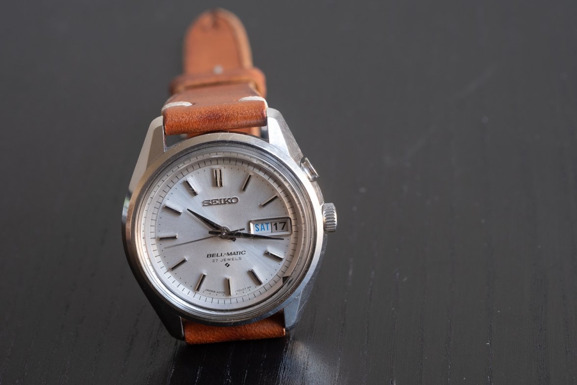

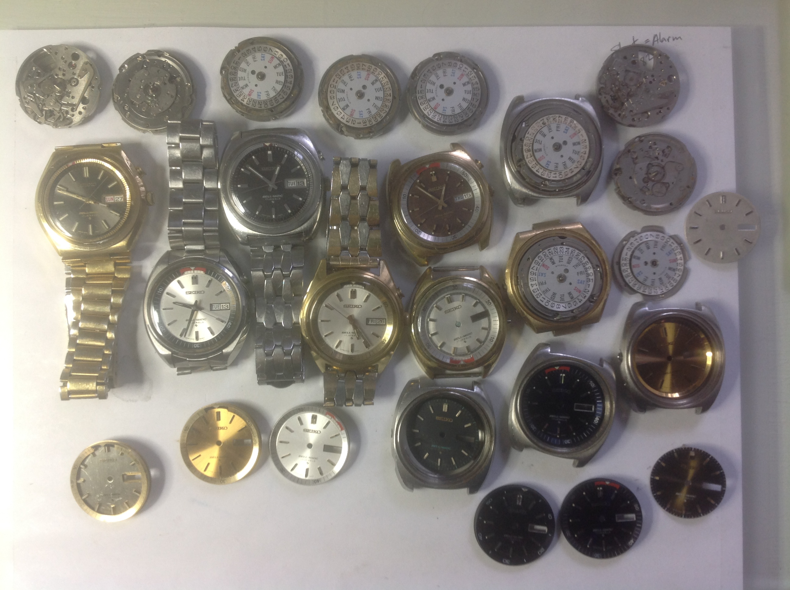

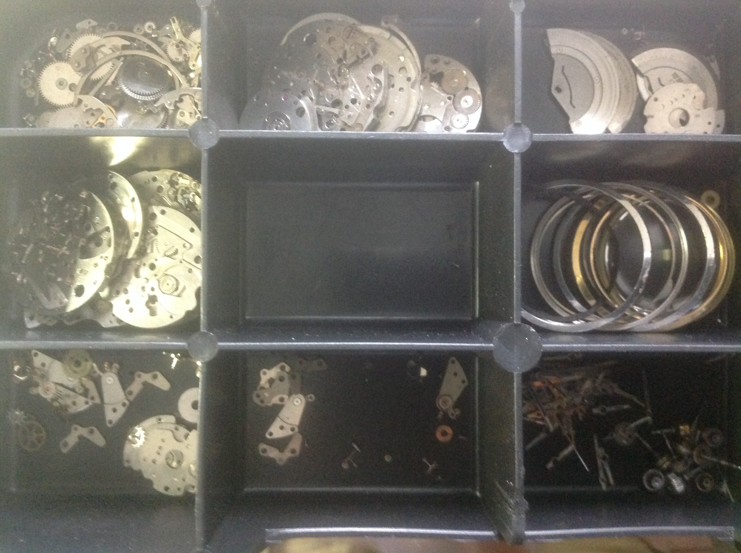

I really like the bellmatics. I have 6 that are running and enough parts to assemble about 6 more.
