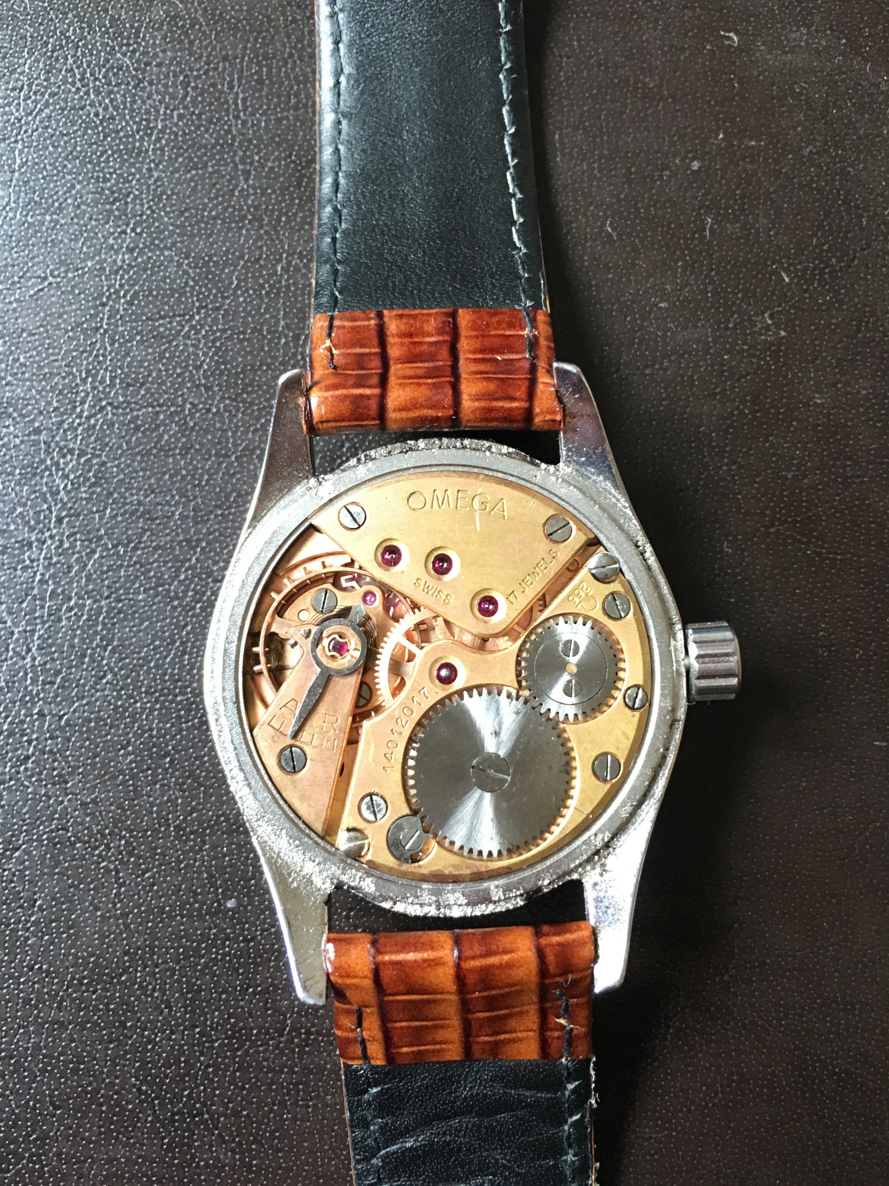

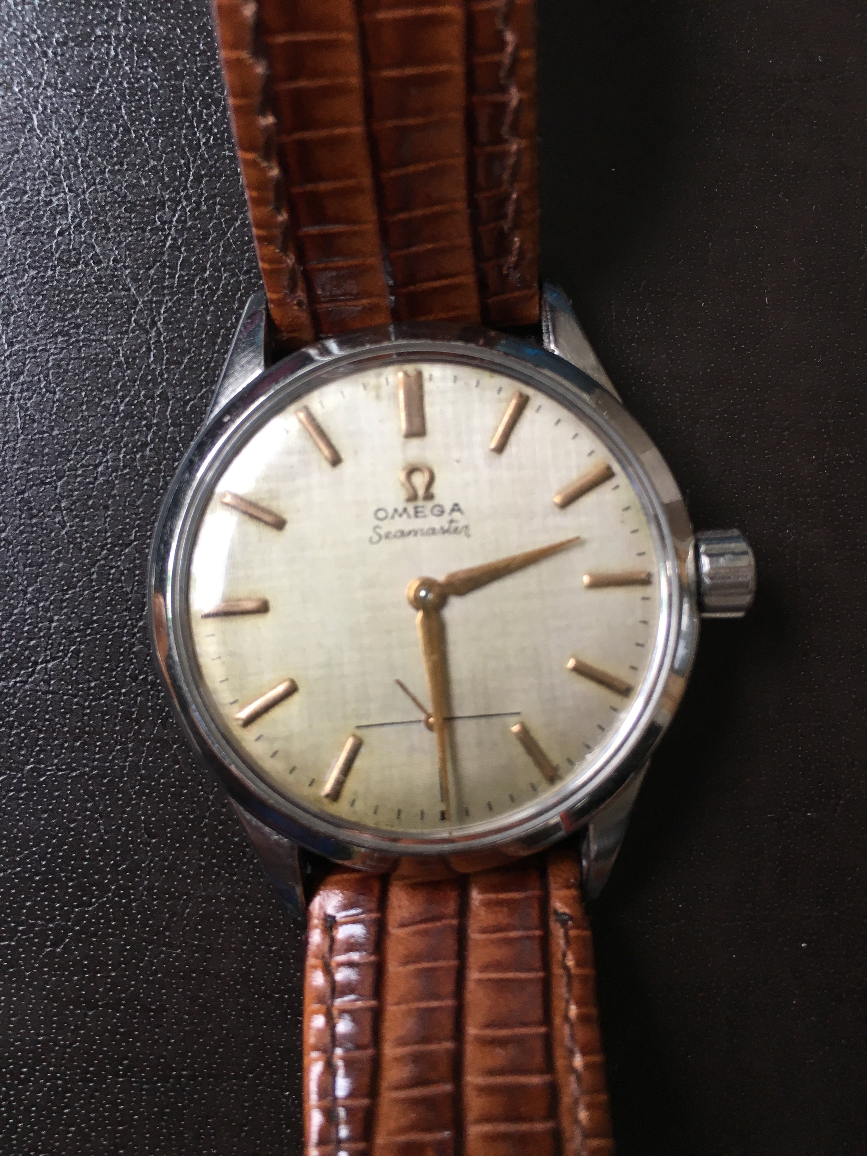

Seeking feedback on my Omega Seamaster Ref 2750-3 dial and crown

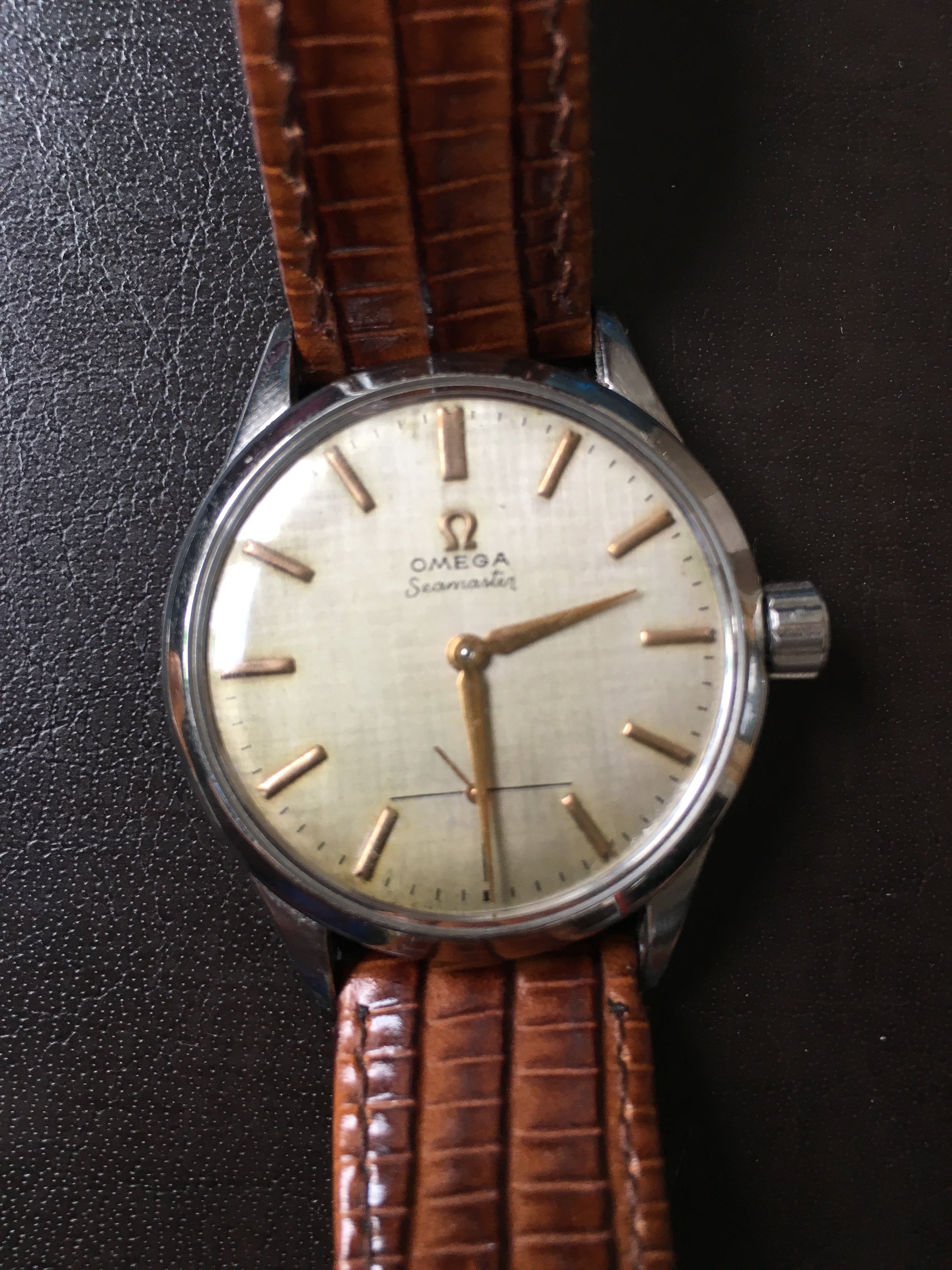

Hi folks,
I recently picked this Omega from a greymarket dealer in Ireland.

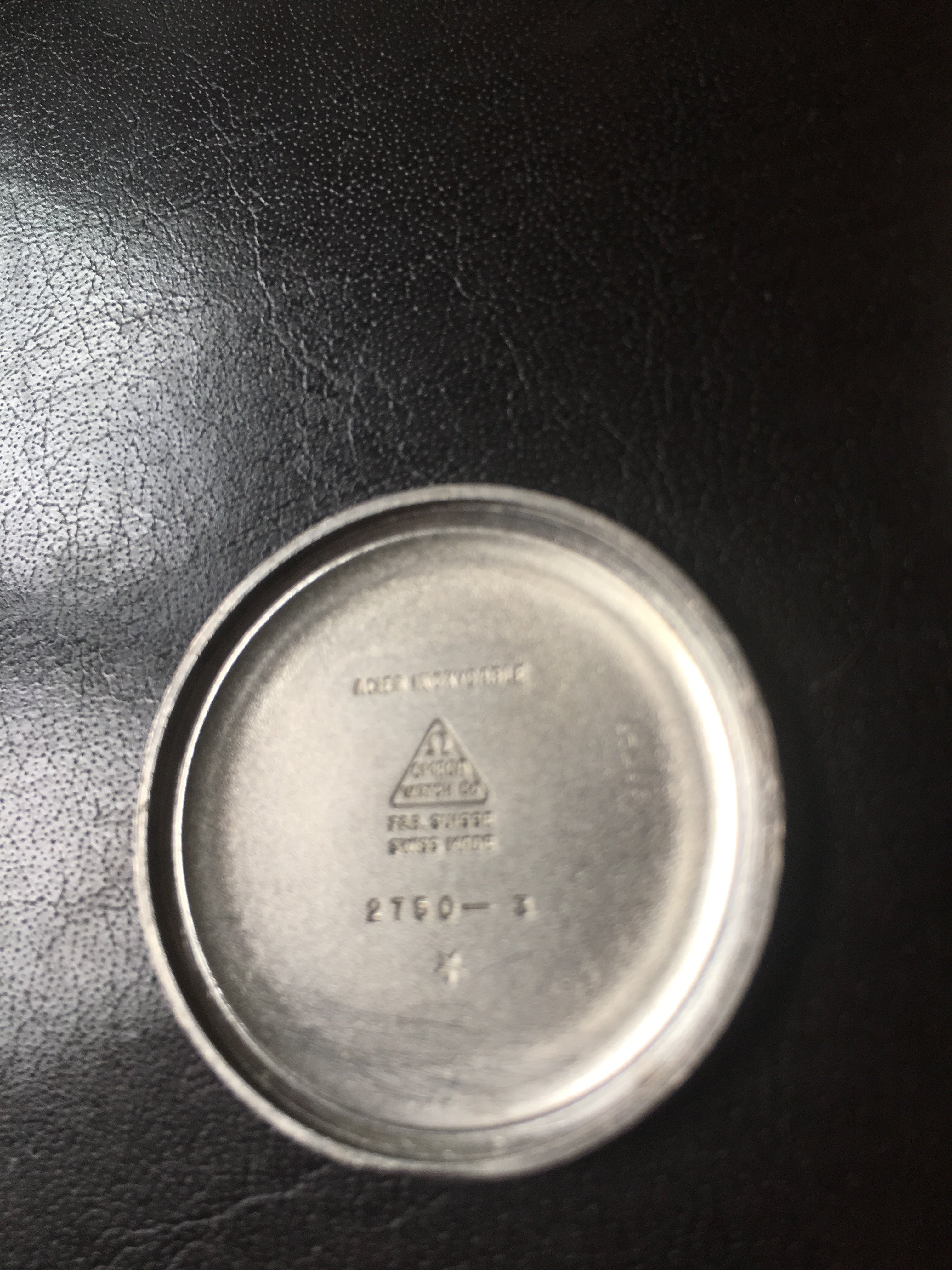

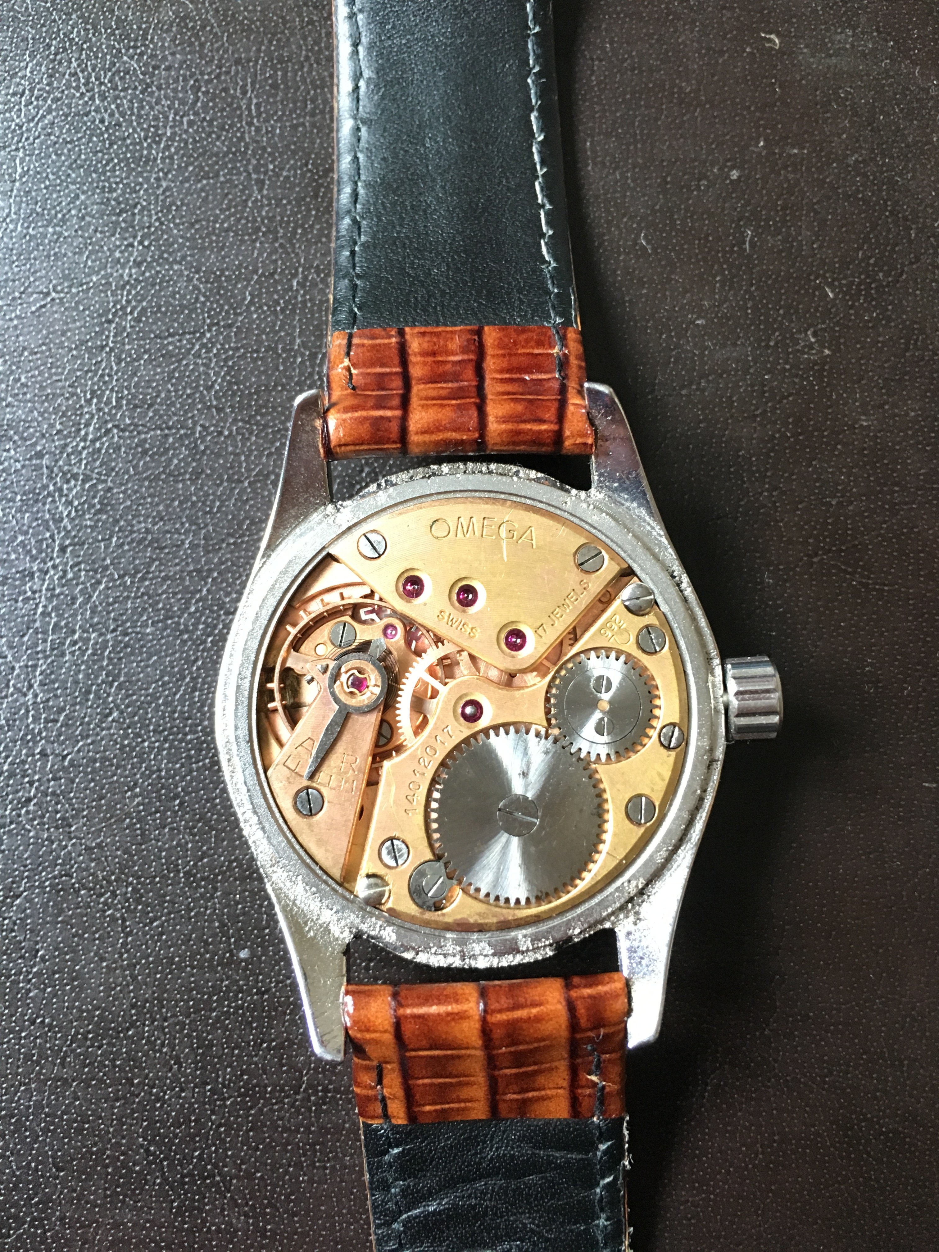

- From my research to date I can tell you that this watch is a ref 2750-3 steel case with a cal. 266 movement.
- The face has gold batons and with gold hands and a sub-second dial.
- The case measures ~ 34cm without the crown and the lug width is ~ 18cm
- The serial begins in 1401****.
- I understand this watch can be dated to approx. 1954.

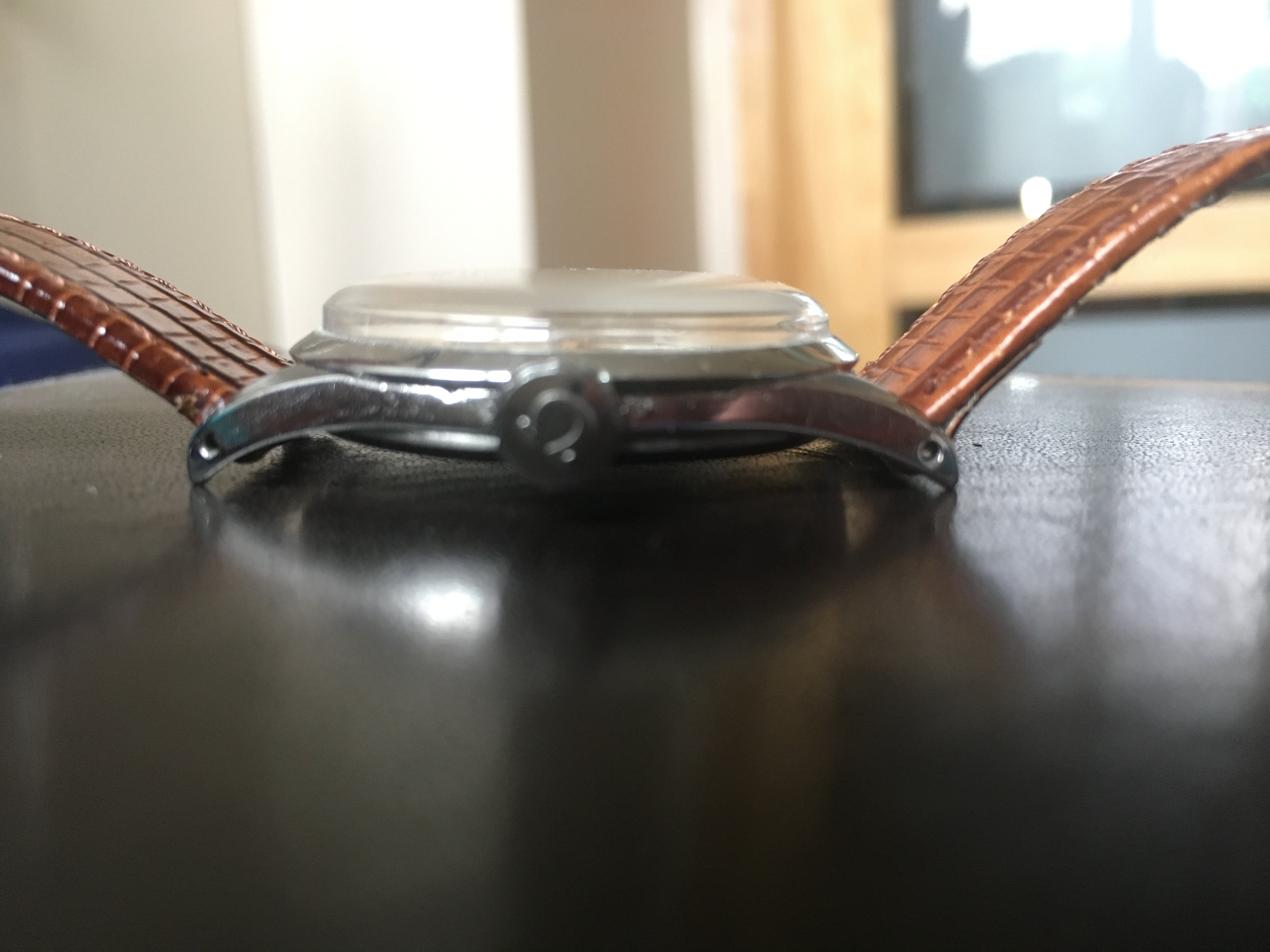

Some concerns I have are, there is no 'Swiss Made' reference on the face. The crown, although branded correctly is quite large.
Keen to hear everyone's thoughts on this piece. I hope it's not a ringer!
13,493
31,814
Reference 2750 is not a Seamaster and even if it were the dial is poorly refinished, crown is incorrect as well, doesn't even look genuine, case also has some very heavy pitting.
I would return it if you can, ask questions first next time, sorry.
1,501
5,694
Thank X350. I'm so disappointed.
It happened to pretty much all of us. Learn from your mistakes, and if you have questions about a Watch ,we are glad to help in the assessment process before the purchase. Good hunt, may the next one be a piece that makes you happy.👍
