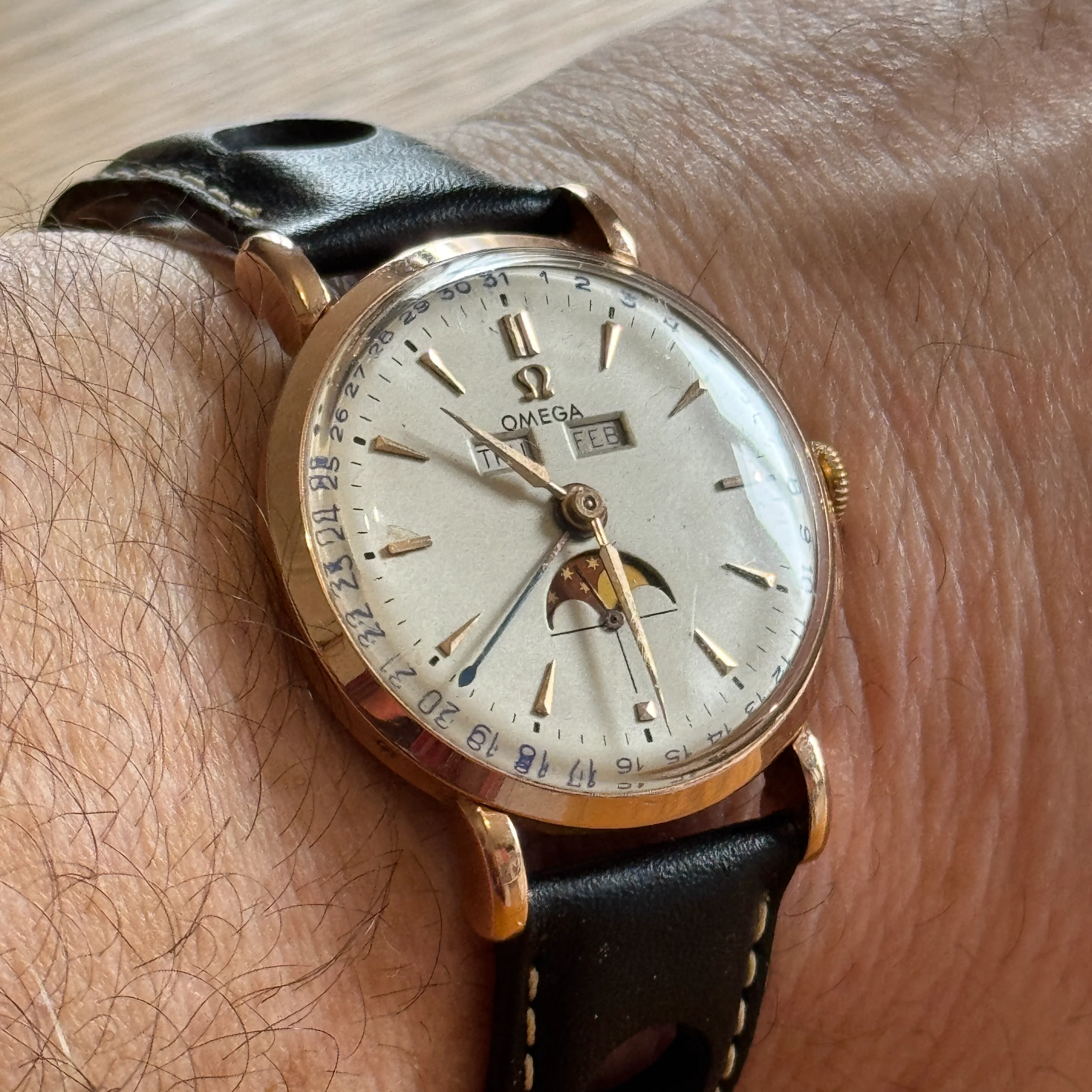

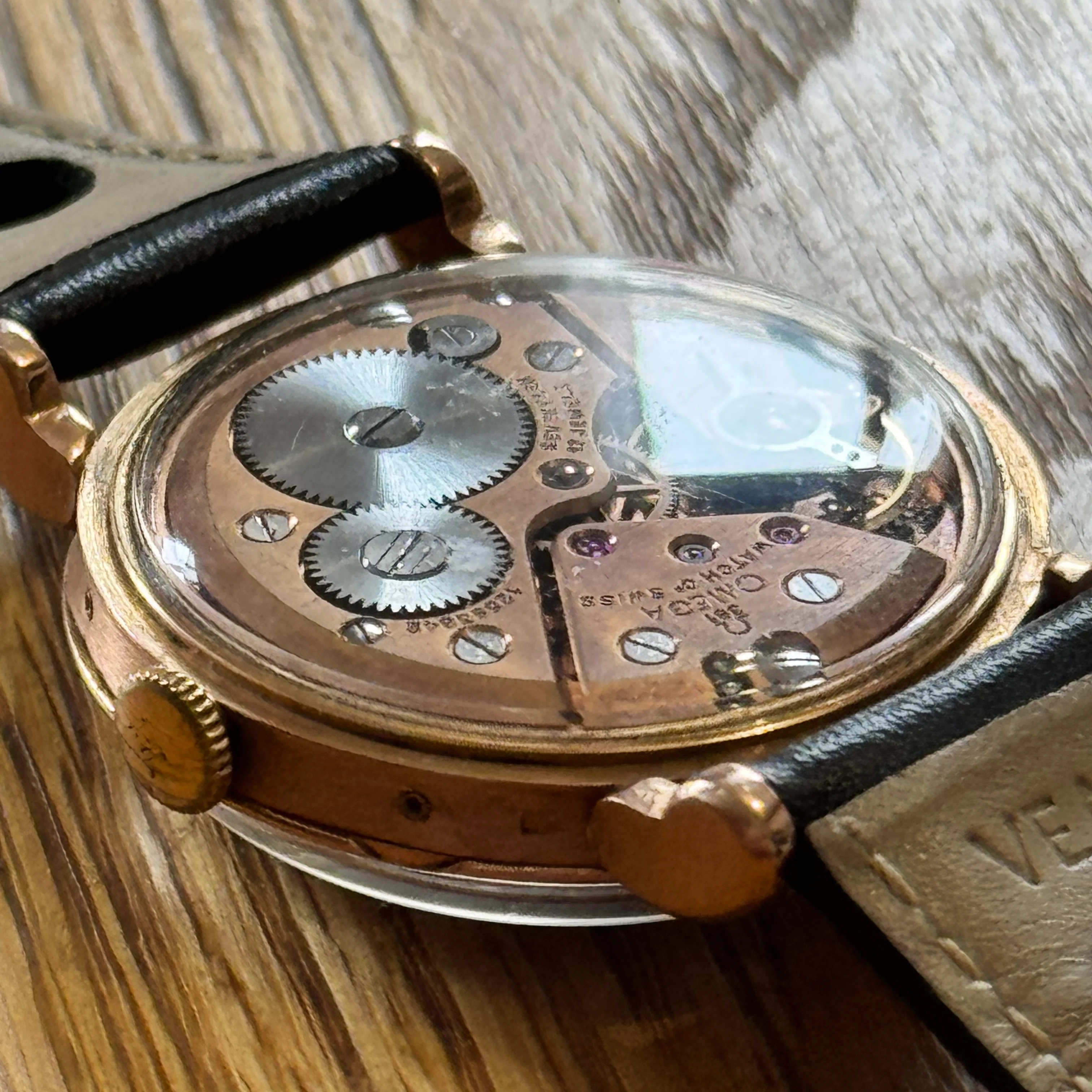

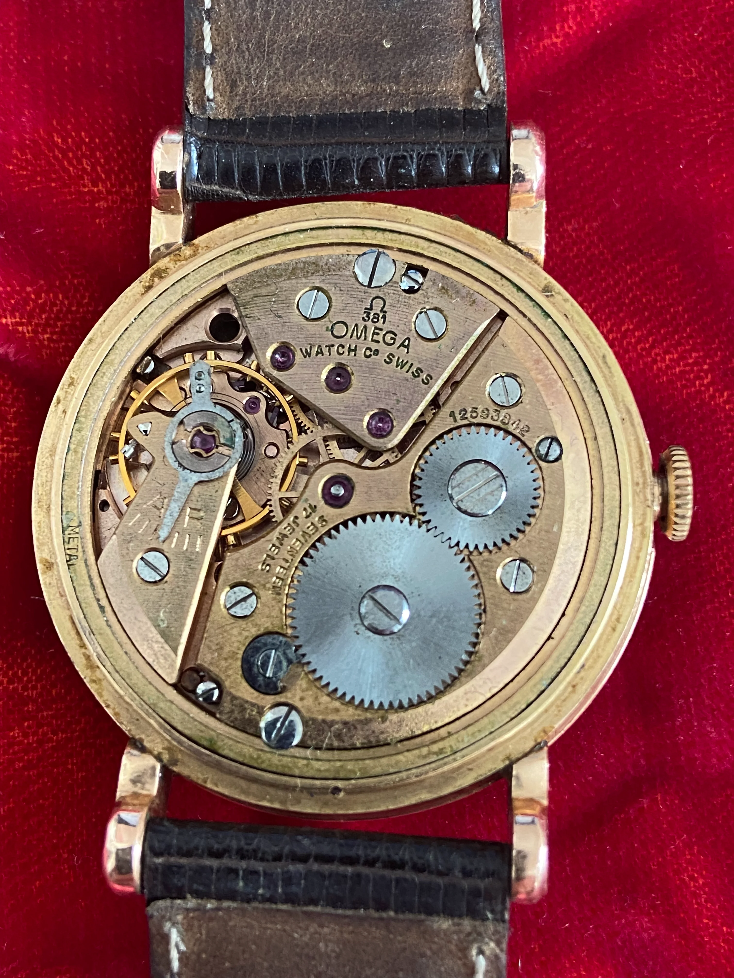

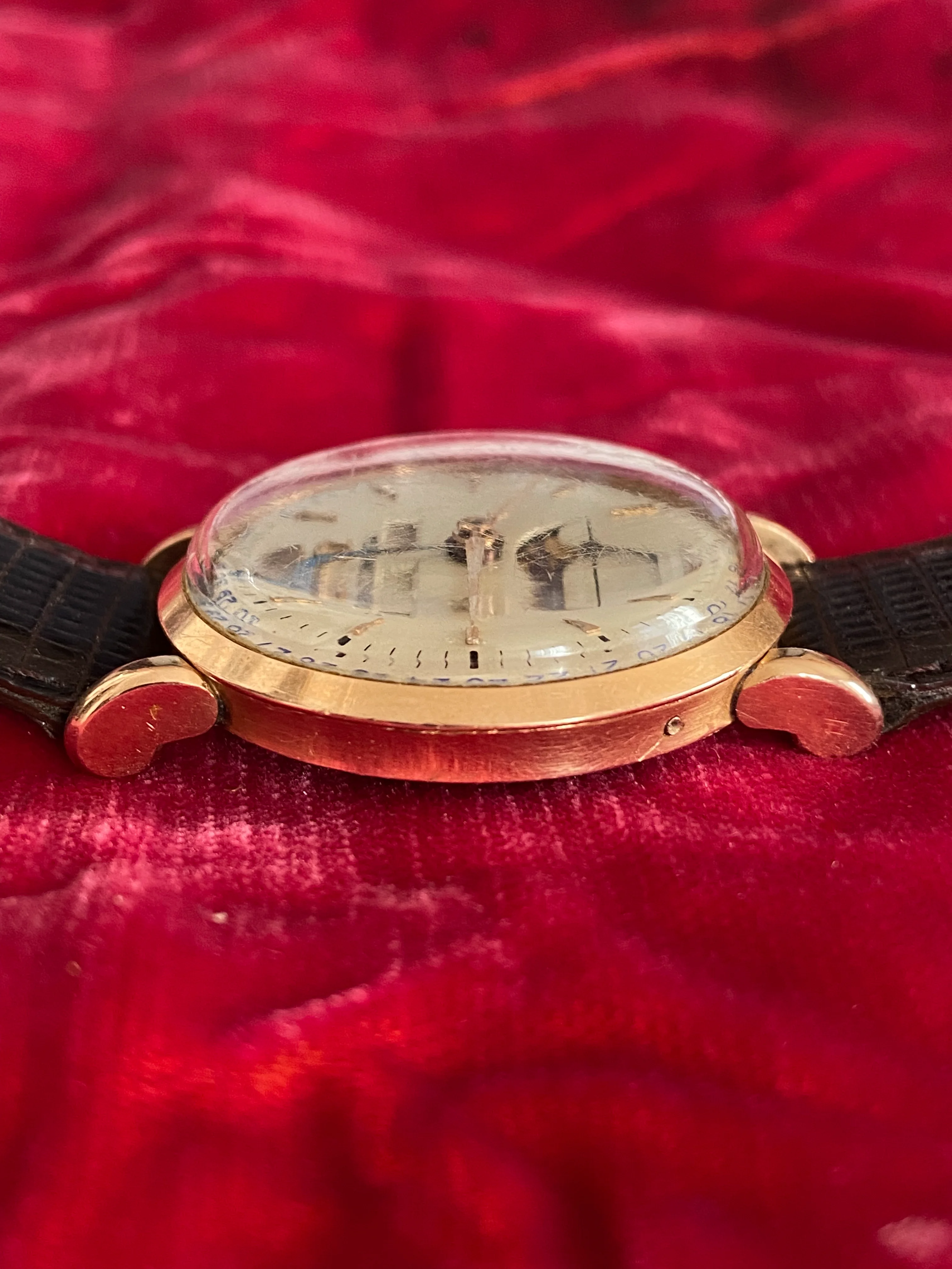

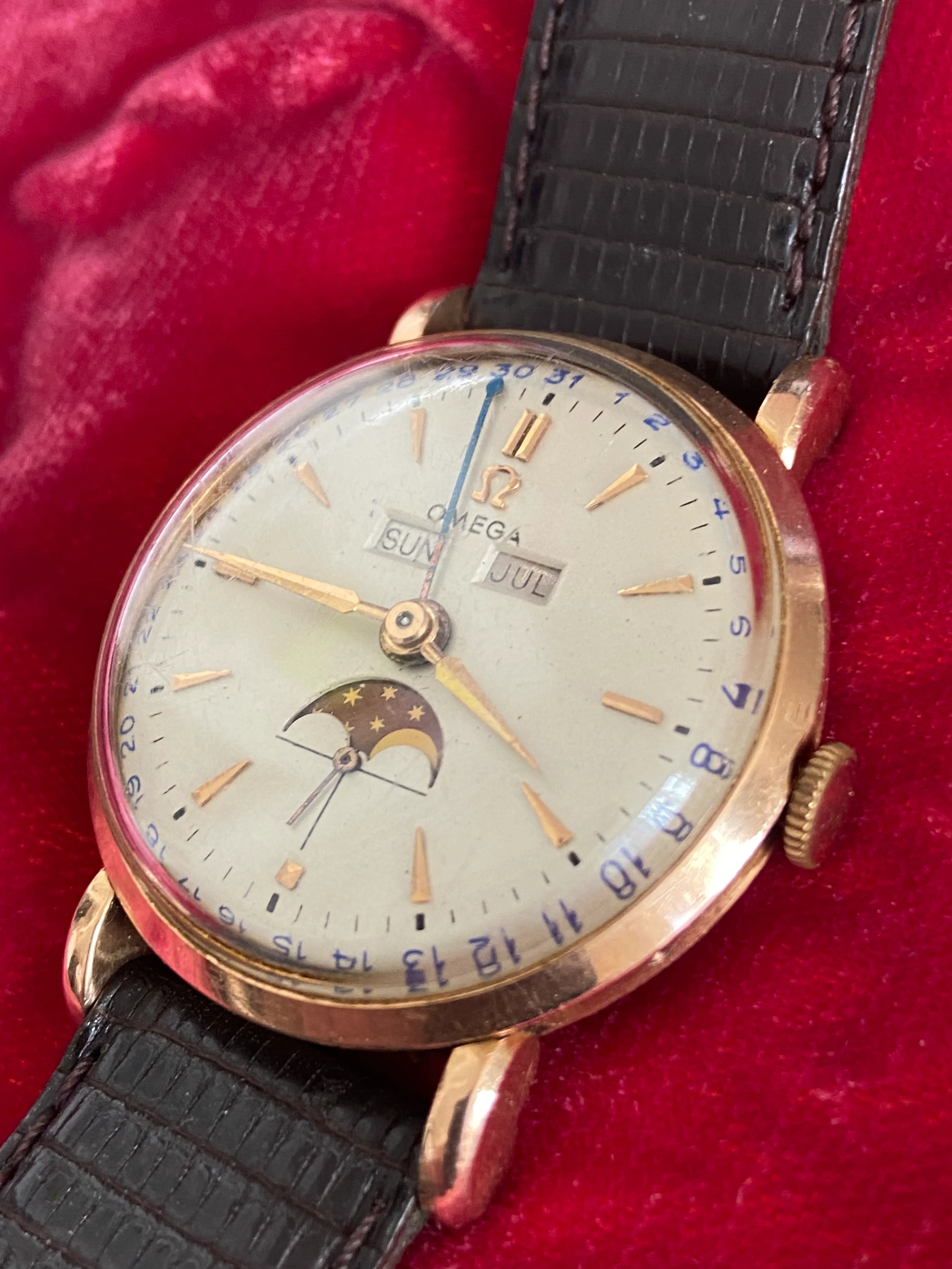

Hello, I'm in France and have a 1950 rose gold Cosmic Moonphase 2471 (my father got it from his uncle around 55), but... the gold backcase is lost for decennies ! I would like so much to have a backcase back, maybe a staintless one would be a good replacement. I'm looking for this back for years, no result. The watch currently has a nice transparent back, glued on by a watchmaker. Do you think I can find an original background one day? Any ideas? Thanks a lot. Regards from Paris.

This will be very hard if not impossible IMO unfortunately. Have you contacted Omega theselves?

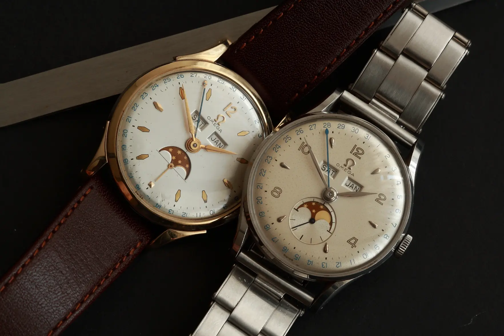

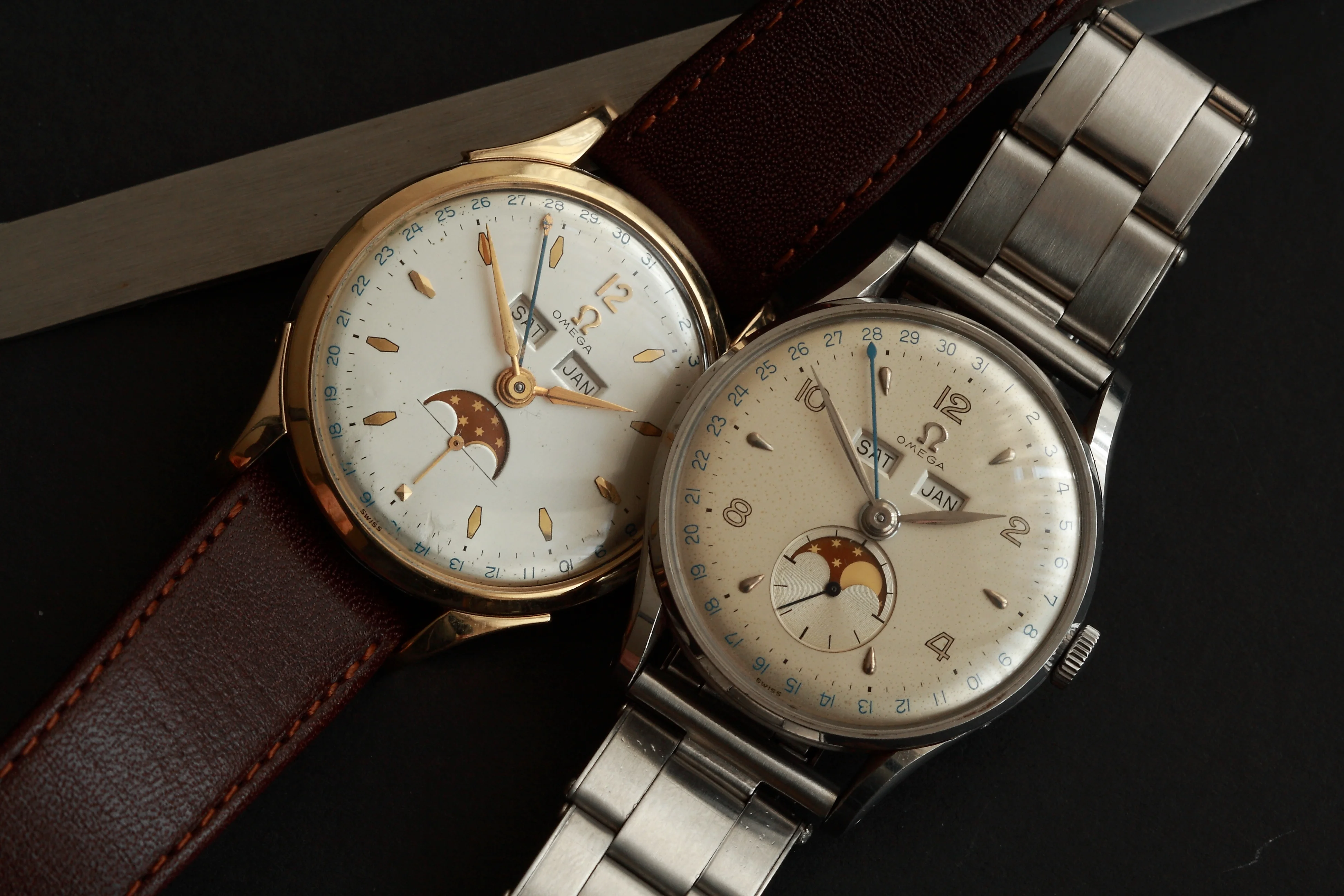

Your watch is not a 2471, ref 2471 is a steel case with steel bezel (although they are also sometimes seen with a gold bezel) and a totally different design. What you have is a solid gold ref 2473. Finding a case back will be as good as impossible.
2471 below on the right and a 2606 gold top on the left
6,830
10,653
Best bet will be buying a donor 2473 with a decent case and poor dial
