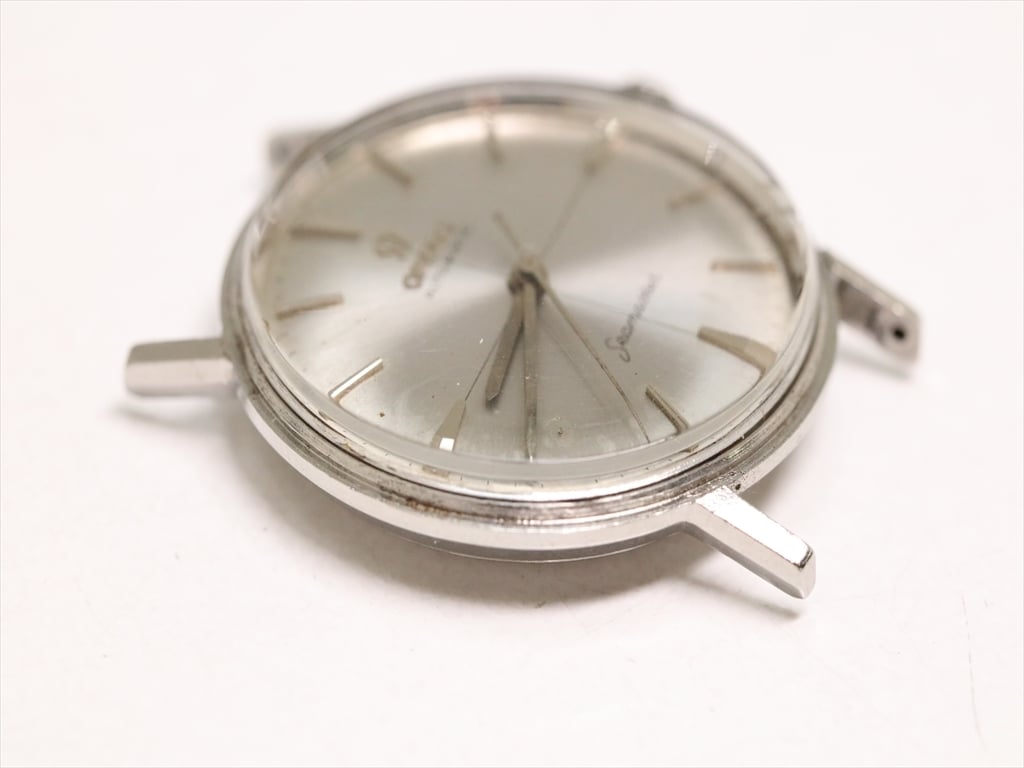

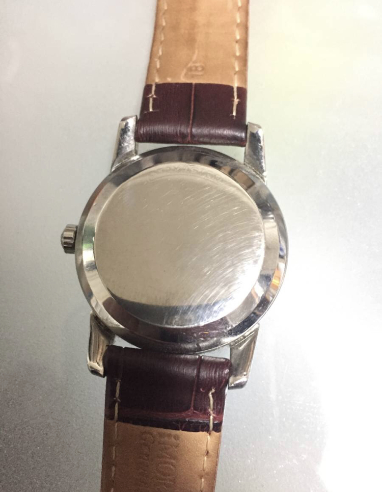

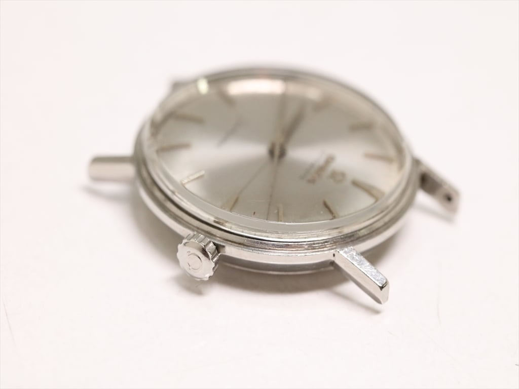

    Hi, an listing came up with for a seamaster which I think is from the 1950s. Only limited info were given. I noticed it doesn’t have any stamp or marking on the caseback, and I believe it’s a front loaded case?
    6E870B08-4CA5-41B6-948E-688B06F2E87F.jpeg 667F6383-B373-4B15-9215-90F3176767C5.jpeg C3DE6038-7948-41AA-AC69-AC433B3FCC13.jpeg

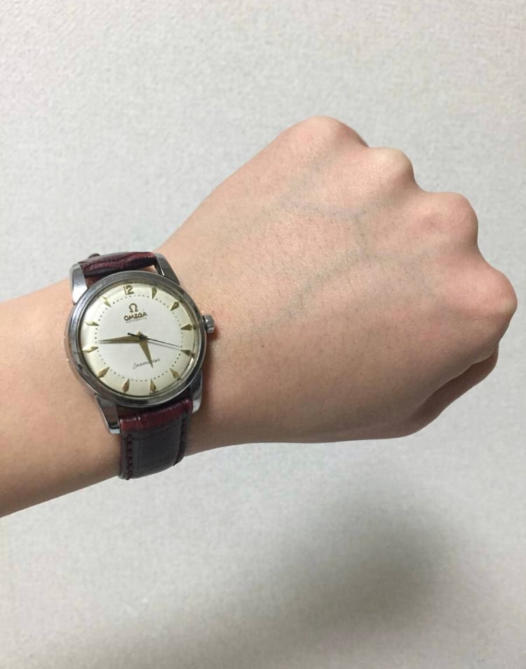

    Another one I found is as below, which has a slightly better condition. Have asked for a photo of the movement and inner side of the caseback have haven’t heard back yet.
    4AAAFDDD-C672-4074-9B5F-0CF0BE445D94.jpeg 8D3EC22E-6C95-4552-BF17-745001645B44.jpeg B701CF8E-4C88-4589-9B6D-B9A98D3E5722.jpeg CF2169BE-D4FF-4207-885B-F748464DF677.jpeg

    Your first example is a redial.
    There are markings on the back they are just worn badly.
    The second is in bargain condition but the dial is original looking.

  3. sky42856 Apr 26, 2019
    10
    Thanks! Just for my learning, what gave away that the first is a redial? Also did omega make any caseback a with no stamps back then?
    Thanks
  4. X350 XJR Vintage Omega Aficionado Apr 26, 2019
    12,586
    29,836
    First watch is not a front load case, plain case back is correct. Second watch is a front load case and is missing it's bezel.

  5. ahsposo Most fun screen name at ΩF Apr 26, 2019
    3,745
    19,992
    First, look at the dots on the minute track. They vary in size. The "automatic" font is a clue also.
    sky42856 likes this.
  6. ahsposo Most fun screen name at ΩF Apr 26, 2019
    3,745
    19,992
    Again there are marks on the back of the first watch; SEAMASTER is on the periphery upside down at the top of the picture. Just polished or worn away.
  7. ahsposo Most fun screen name at ΩF Apr 26, 2019
    3,745
    19,992
    Or maybe that's WATERPROOF, hard to tell...
  8. sky42856 Apr 26, 2019
    10
    Thanks! Do you think it would be hard to find an original bezel (or an omega matching bezel with the correct look)?

  10. X350 XJR Vintage Omega Aficionado Apr 26, 2019
    12,586
    29,836
    Yes.
    Unless you really know what you are doing, bargains rarely are.
