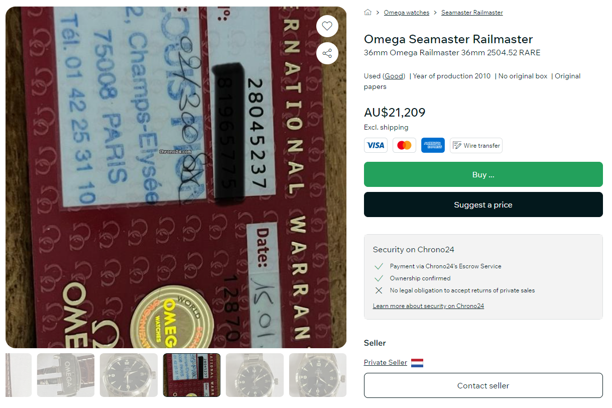

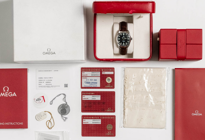

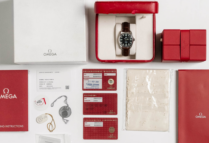

Hi everyone, my 28045237 which I luckily got on ch24 two years ago was sold in the UK in nov 2009 and bears the serial number 84681xxx (I have the papers)
As far as catalogues are concerned, funny to see that the 36mm version is absent from the 2008 edition (which i have) but present in the 2007 edition...Maybe they stopped production during 2008 and distributed it until out of stock...

I apologize, the 25045200 WAS in the 2008 catalogue, not sure about the 28045237...(didn't buy it so far)
